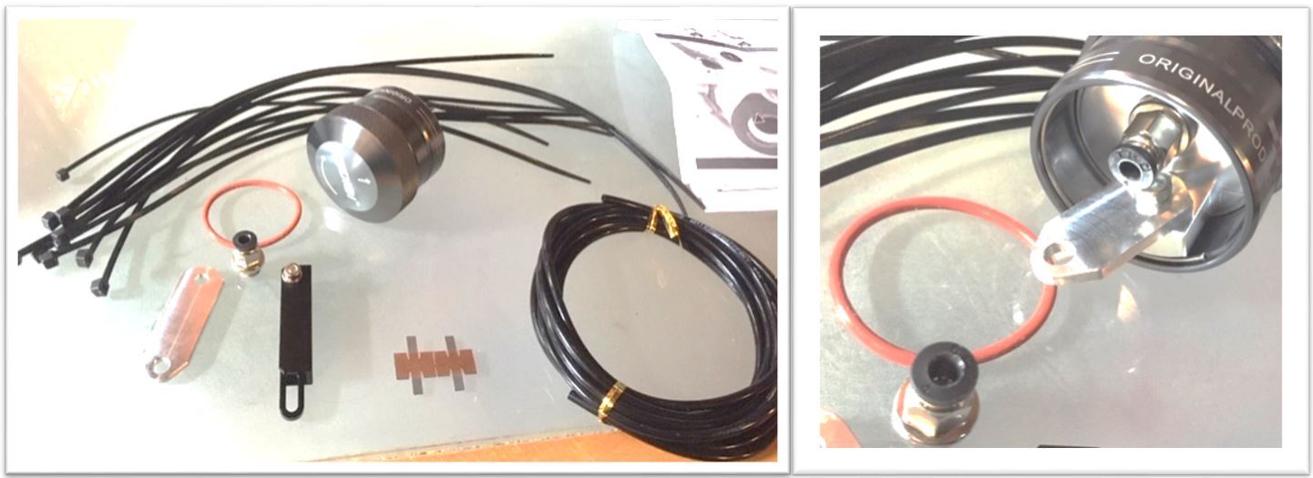

  5. Hubaxe
    Mar 25, 2020
    1,718
    Aix Les bains - French Alps
    Mine just arrived. There are extra tube junction and seal ring. Will be on the motorbike soon. The overall impression is very good.

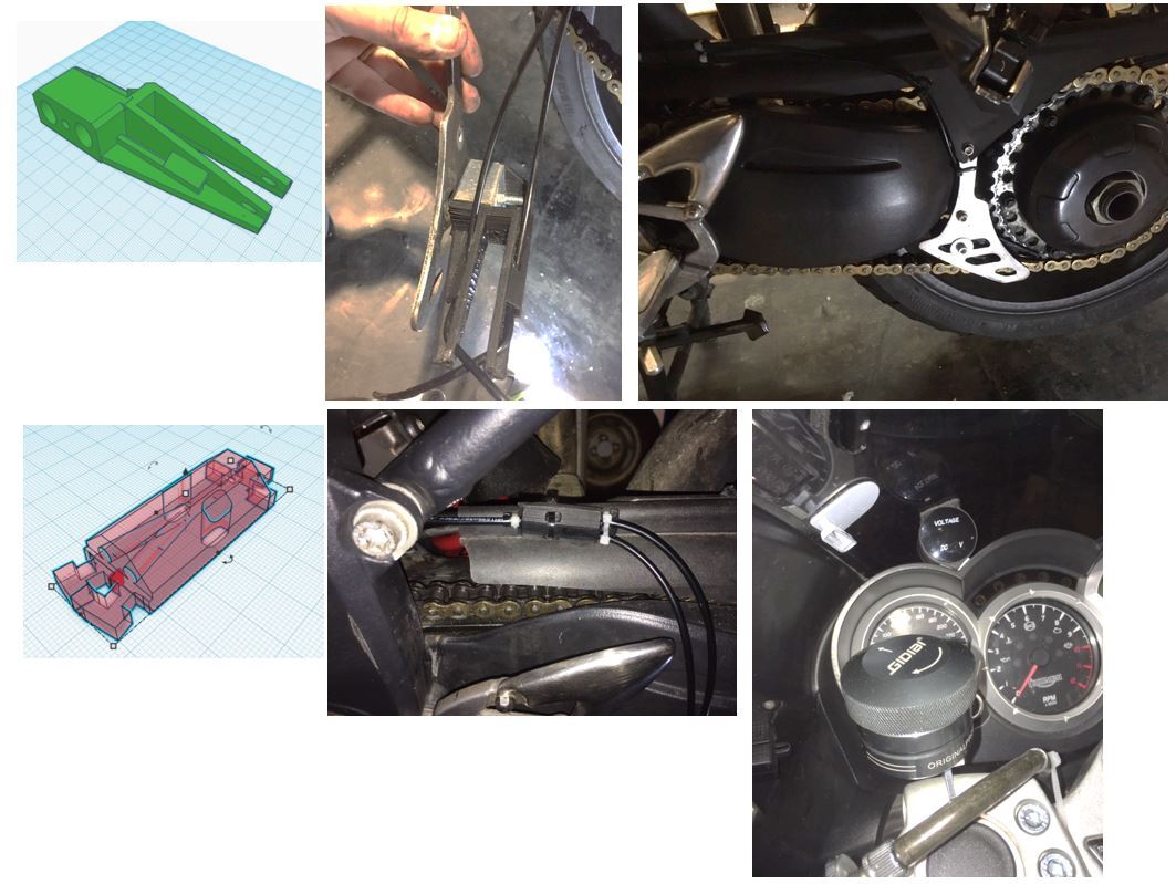

    Here it is, I finally completed the oiler installation.
    I designed and 3D printed a 2 sides oiler that fit the Sprint ST 1050 and can be installed properly. Pictures are not nice, but that works.
