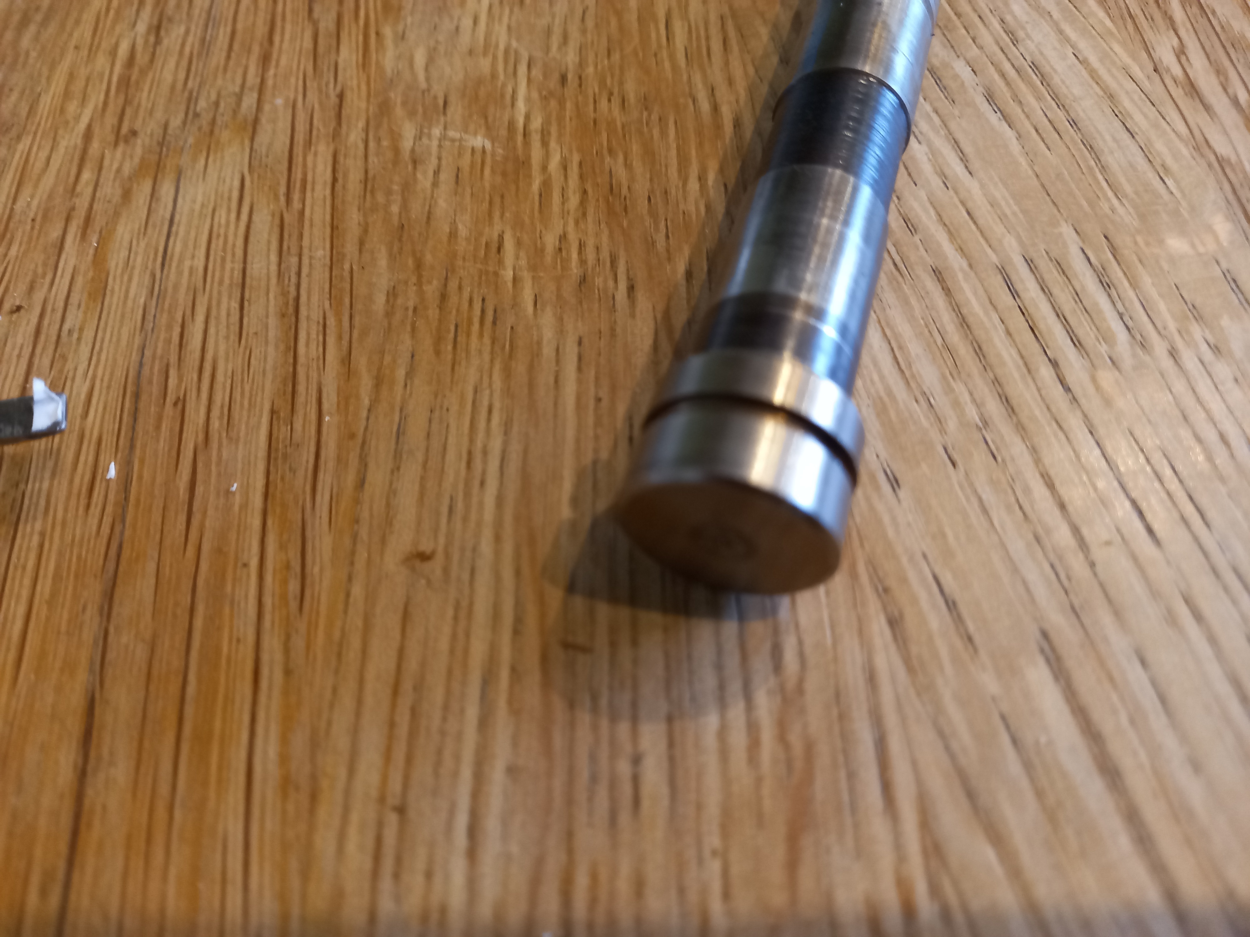

    At long last with all the issues i had with the head and a oversize right hand crank end the crank has finally been ground and balanced and should be back soon, as its nice n warm out in the workshop i decided to inspect and clean the rocker shafts and fit two new ends to the rocker shafts that had been butchered years ago.

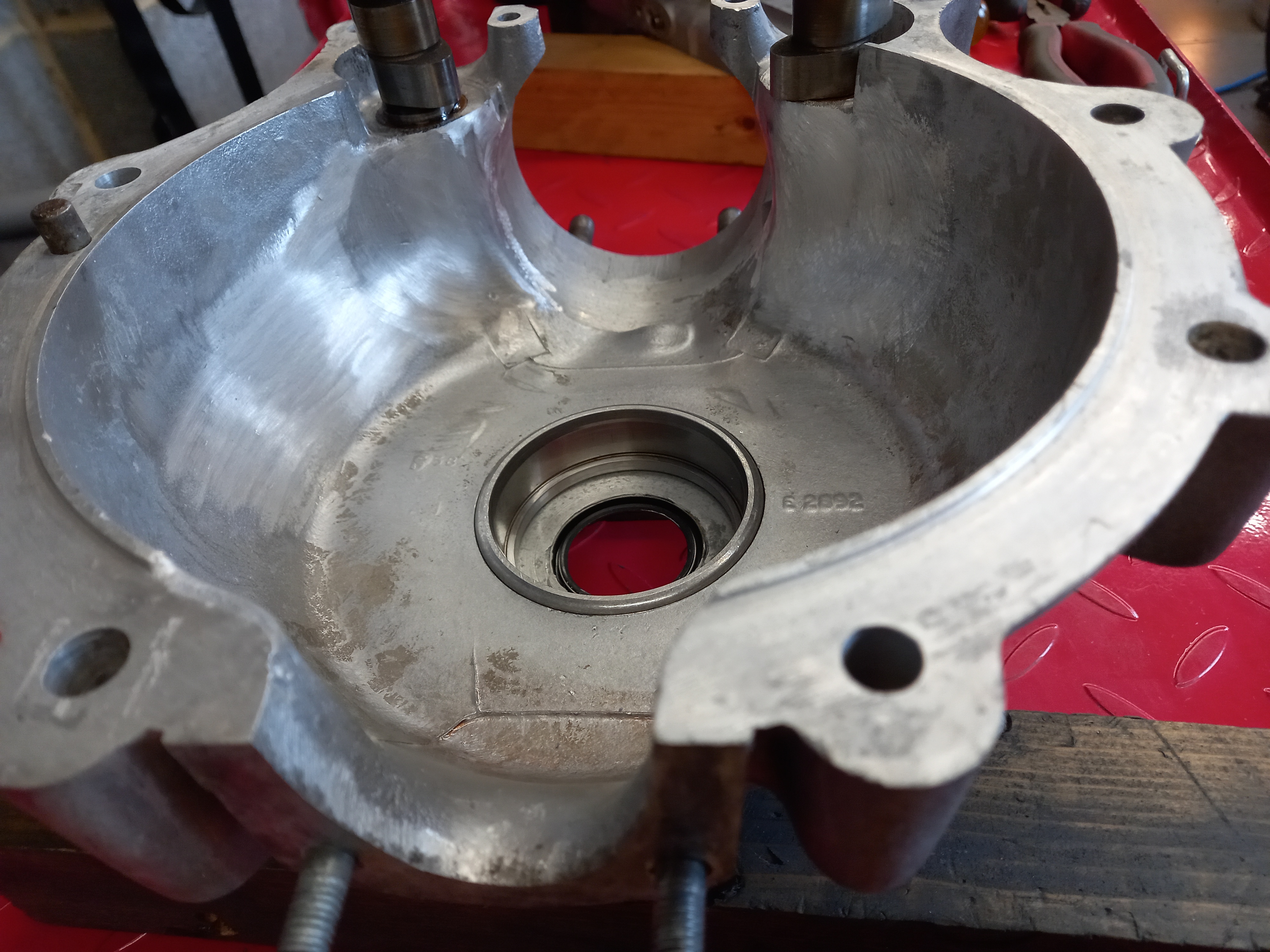

    Well at long last i have all the parts back after Pat at Seager Engineering finished off the crank grind, balance and other work to the oil feed end and machined the outer cover for a seal instead of the original bush. Spent a few hours this week assembling the bottom end when it was warm enough in the afternoons to do so.

    Lovely job Sir. Does the work on the oil feed side of the crank require smaller inner diameters in the new bearings or has the work kept the diameters at the original size?
    Just so nice when the motor starts to go back together. Particularly given what you had to do to get it apart.
    #30
  11. darkman
    5,158
    7,661
    The crank end had been worn along with the failed bush but size wise they are the same :)
    Edit must read reply's more slowly lol, yes the odd sizing issue was dealt with but it should have also been the same as all one piece cranks on 650's with the bearing fit and Pat is not sure what had gone on with it previously, another mystery :-(
