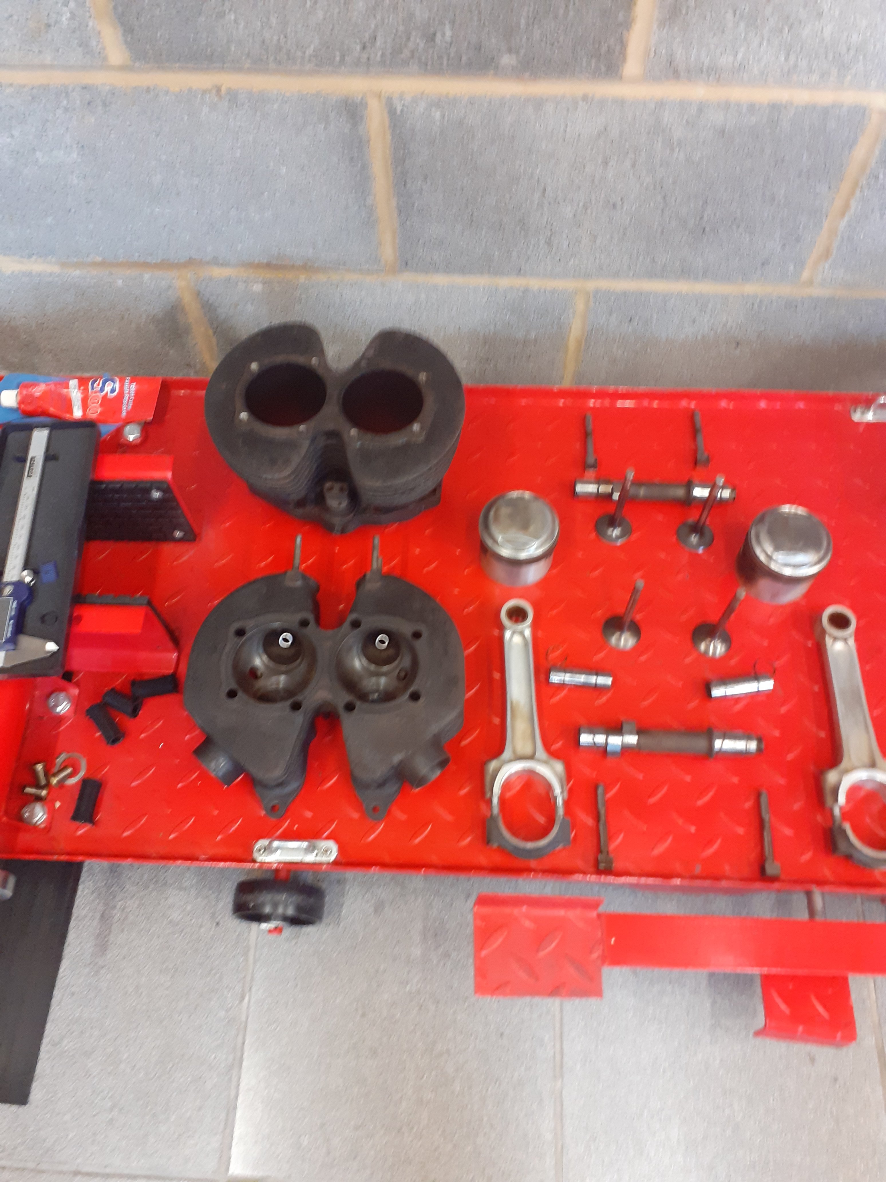

  1. darkman
    7,657
    Strip n rebuild of a 58 6T engine for a friend to help pass away the winter. All striped down a few days ago.

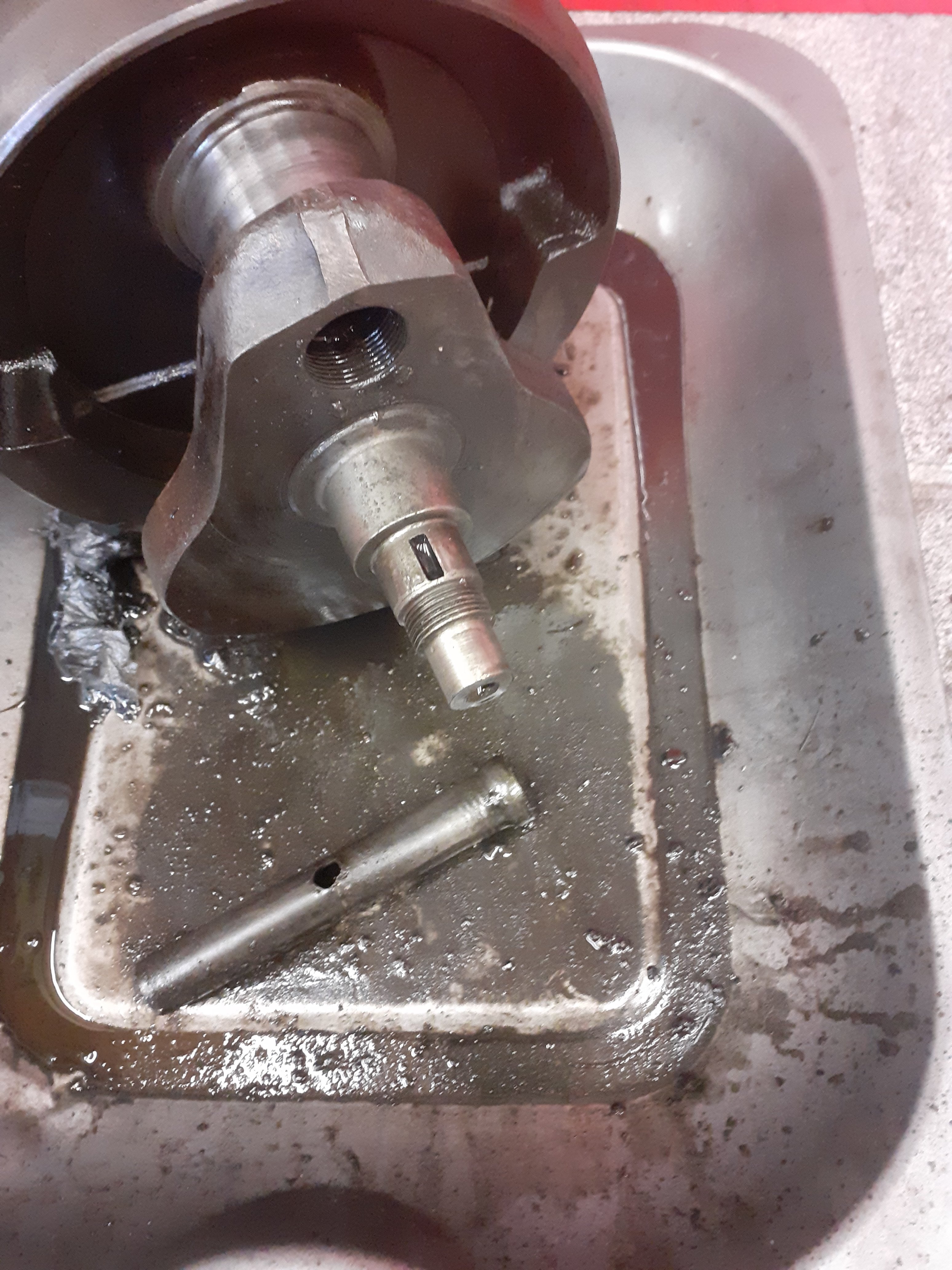

  2. darkman
    7,657
    Final job today was to strip the stubborn mains and remove the clogged sludge trap.

  7. darkman
    7,657
    Bit of a different challenge for me on this one as the owners bike is very original with just the correct amount of patina for an old bike made in 1958 and well used so although the insides will be some new parts and some polished i have to leave the outside as original as i can.

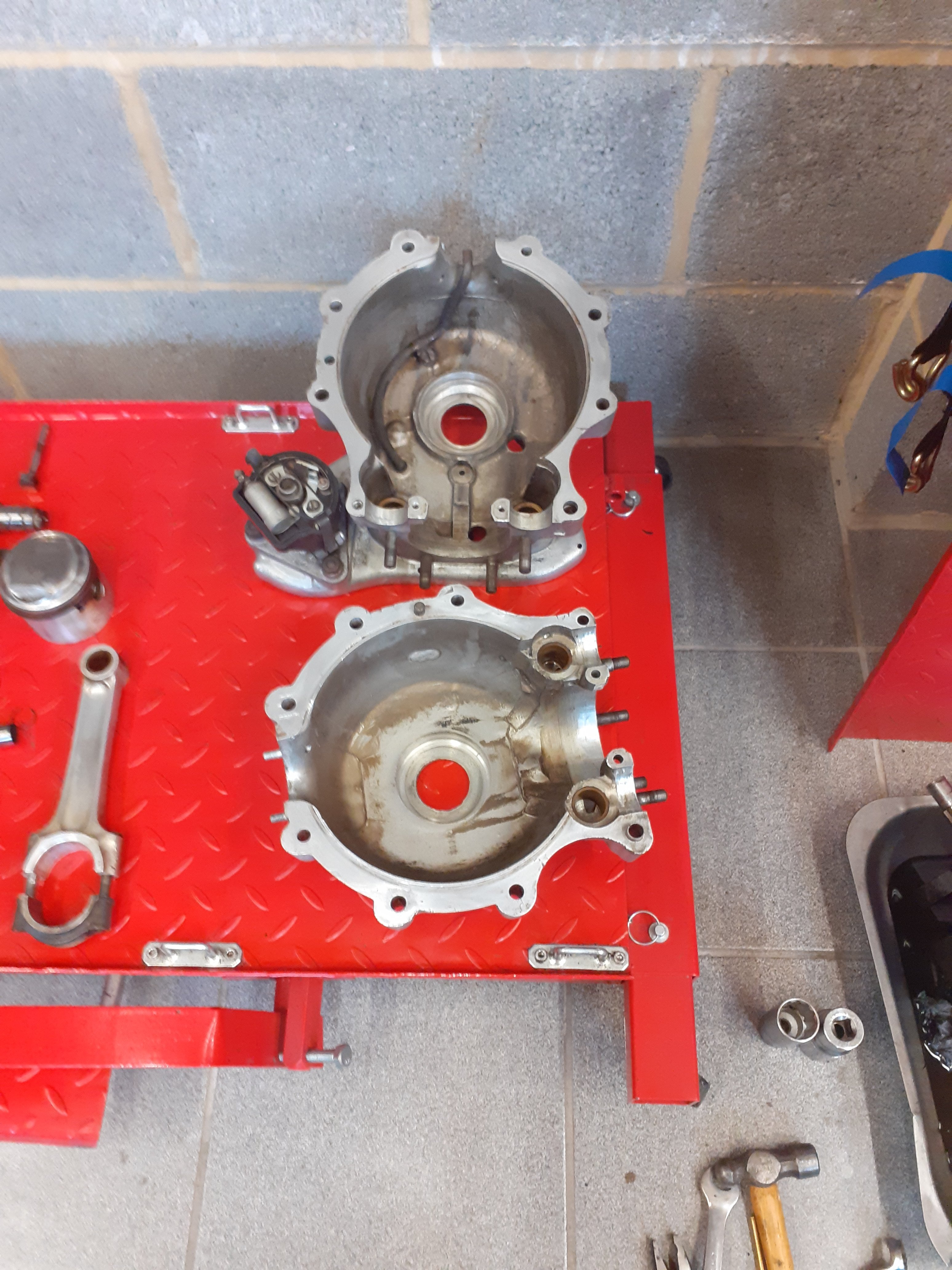

  11. darkman
    7,657
    Sludge trap out, head decoked and steam pressure cleaned the cases and bits, rain stopped cleaning so crank will have to wait for dry weather. Was hoping to get away with just shells and main bearings but now its all cleaner i think its a crank grind as well.
