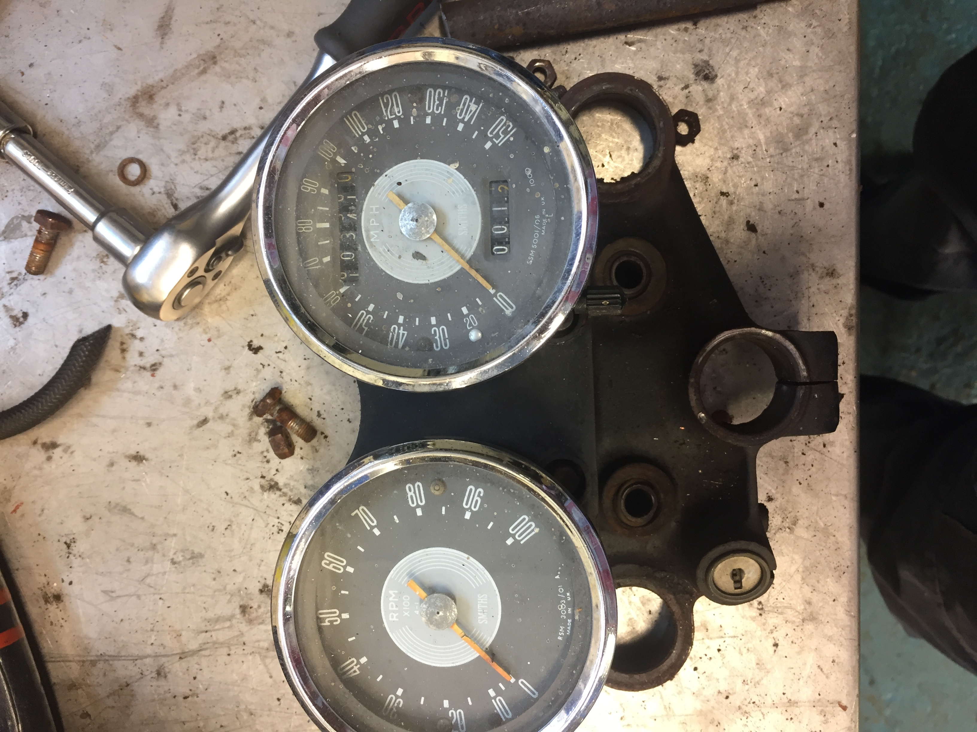

    Any recommendations for speedo tach refurb ? Mine are looking a little tired and doubt they work . I could go for new but depends on refurb costs and it would be cool to have originals .
    #61
  2. darkman
    5,156
    7,659
    I have used Ashley Pople for clock refurb, original clocks are the first thing most people look for :)

    270
    Witney
    Thanks for that , will give him a try , I assume thats new bezels , painted cases and new smiths face? I thought of having a go myself , but couldnt see new faces available with the Smiths logo in grey .
    #63
  4. darkman
    5,156
    7,659
    They will do whatever you ask of them, grey faces are a rare find so again ask, i paint my own clocks after refurb so as they are perfect.

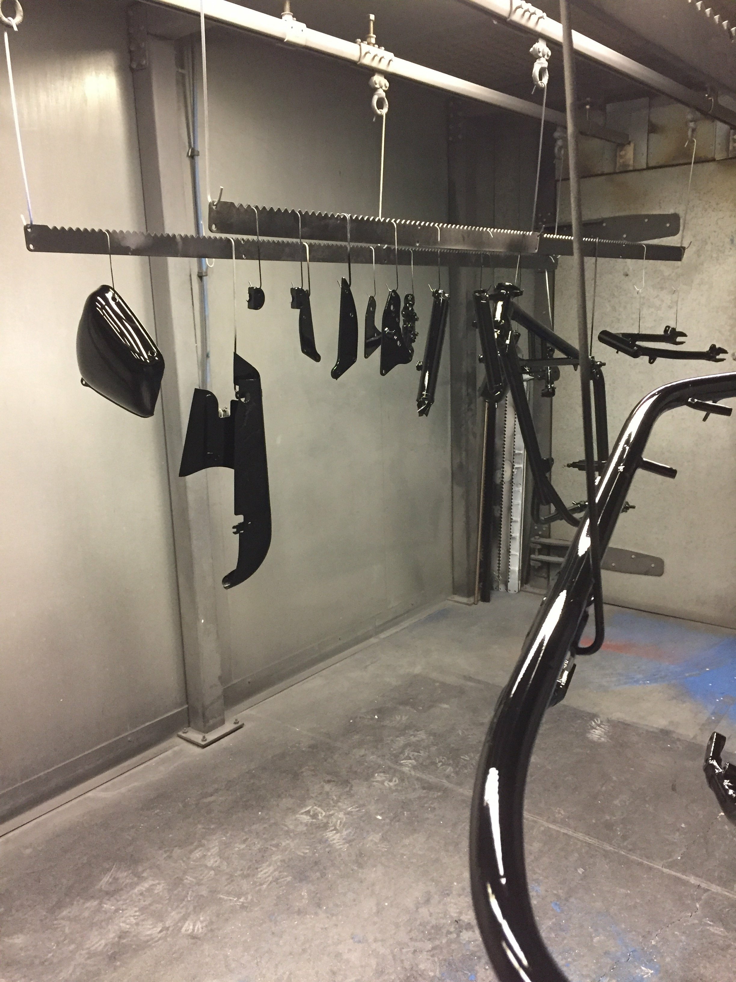

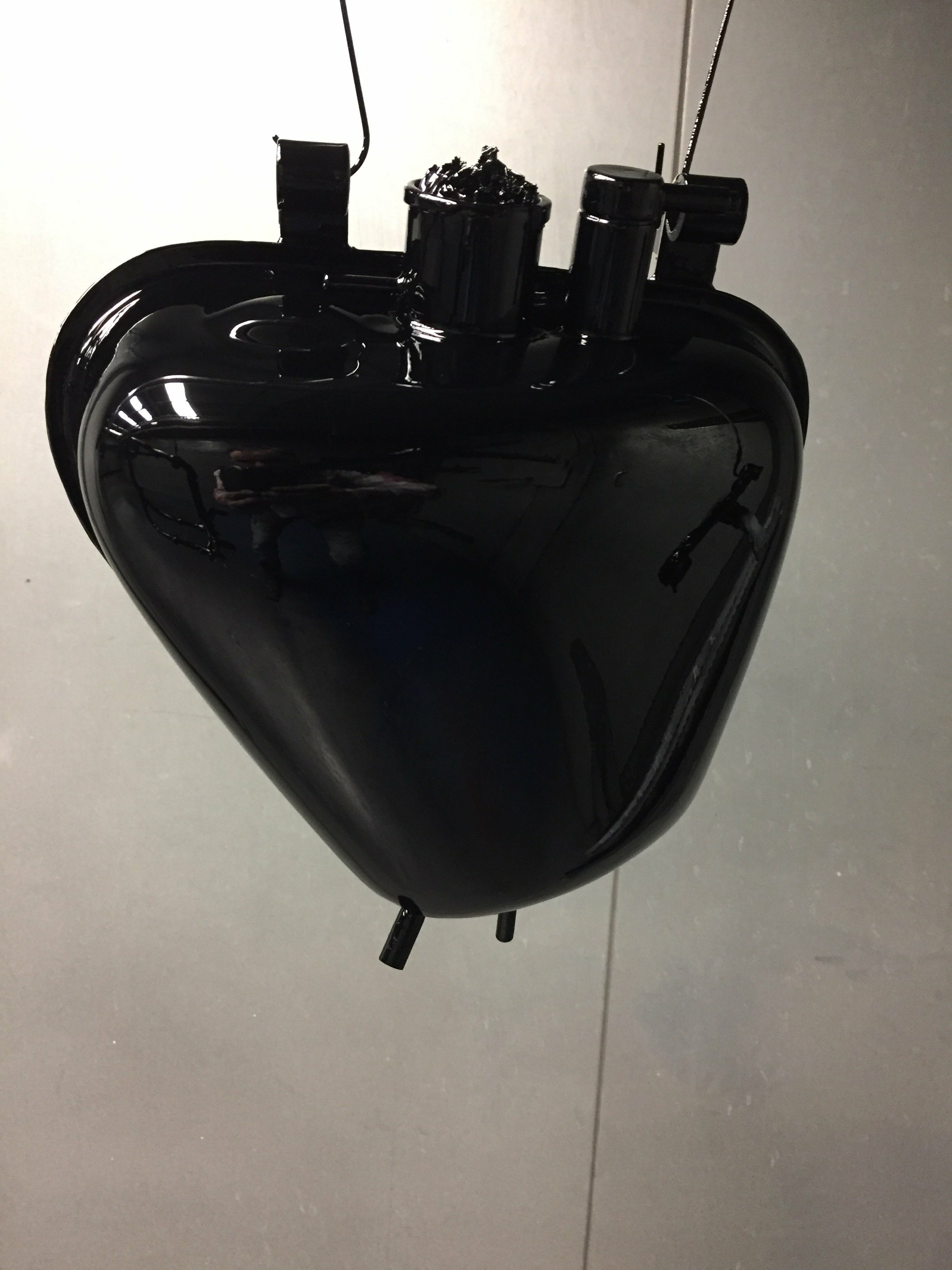

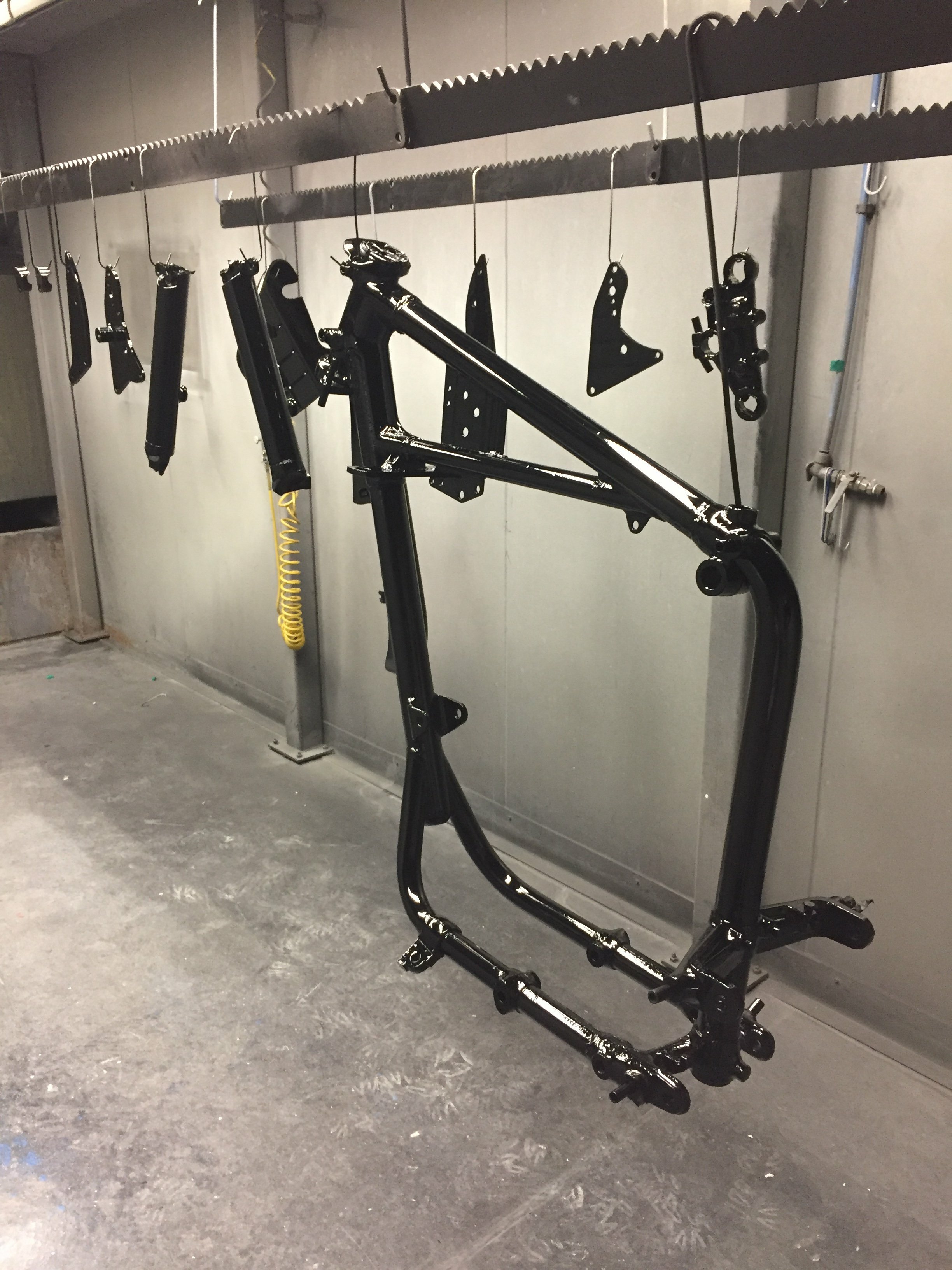

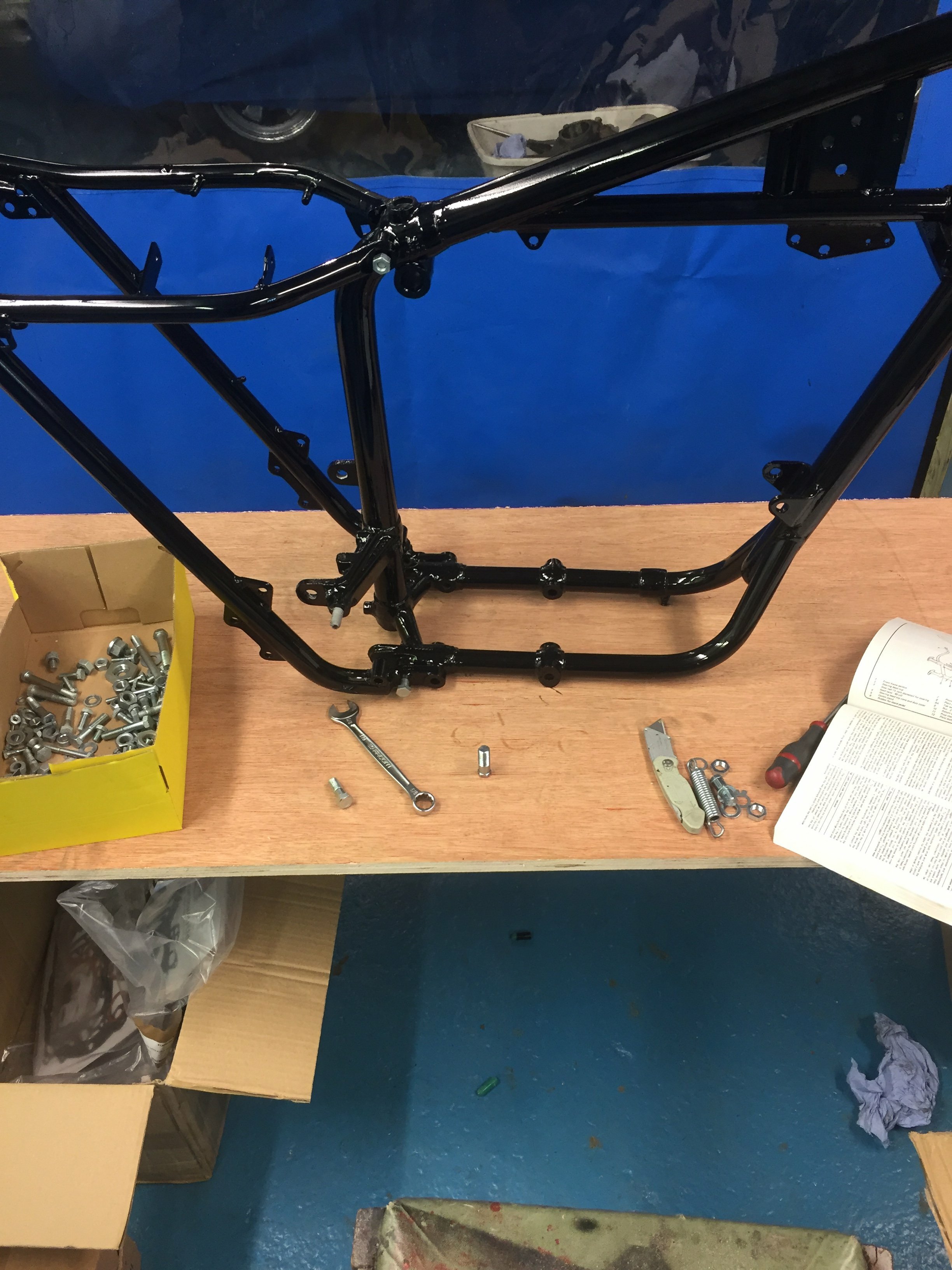

    I managed to get some black on all the important bits tonight after everyone went home at the workshop . I still have a handful of other bits and also the mudguards and the tank of course which will be done later on in the build when it’s needed .
    Feeling good now with most of the hard work or rather less enjoyable jobs behind me .

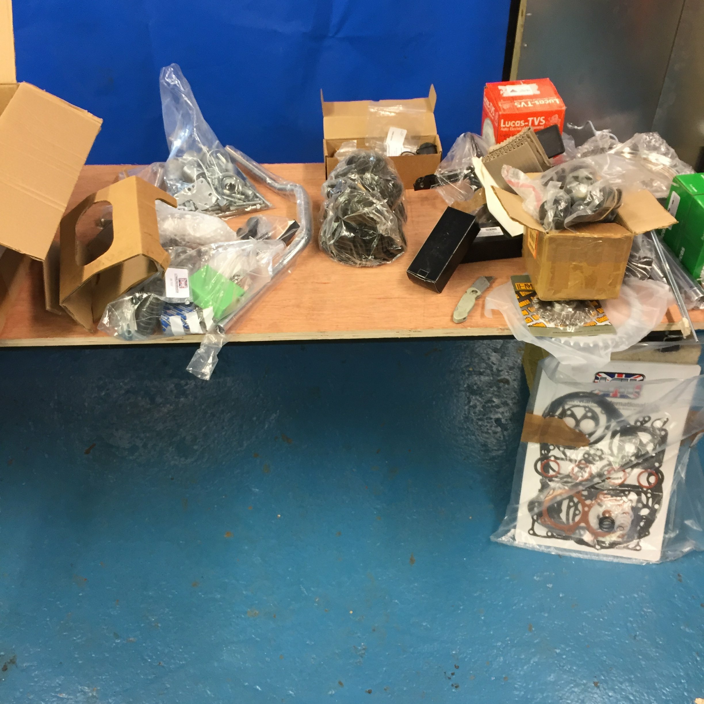

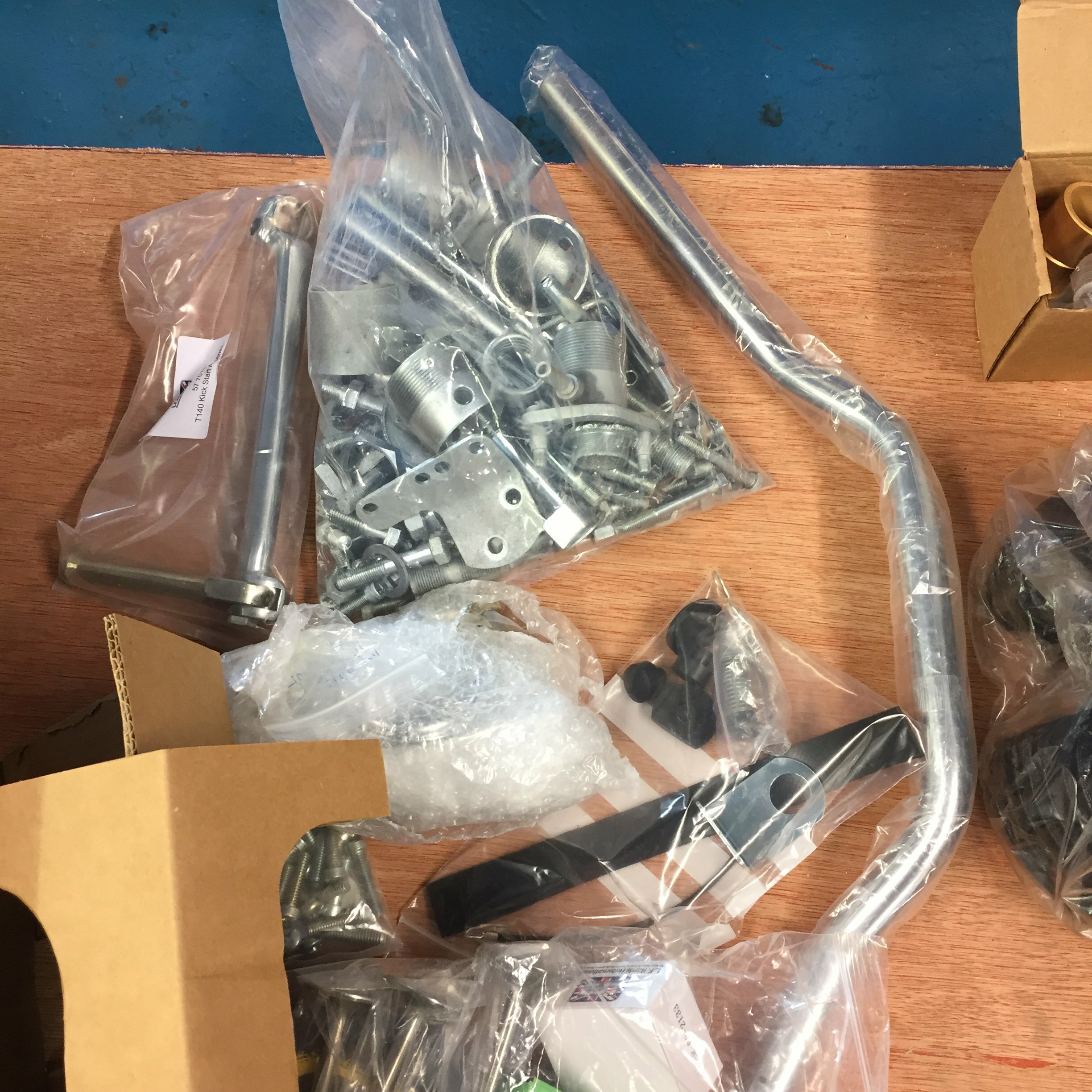

    Lots of new shiny stuff arrived this week :)
    Got my bits back from the platers too .
    Other jobs , made a work bench in anticipation from some 18mm ply on top of a frame made from 40mm box sitting on 4x 9" hollow concrete blocks . I did think of buying a spangly new ramp but tbh I could do without spending out and didn't want to have to store it when finished , I can tuck this away somewhere and the blocks can go back outside somewhere .
    #75

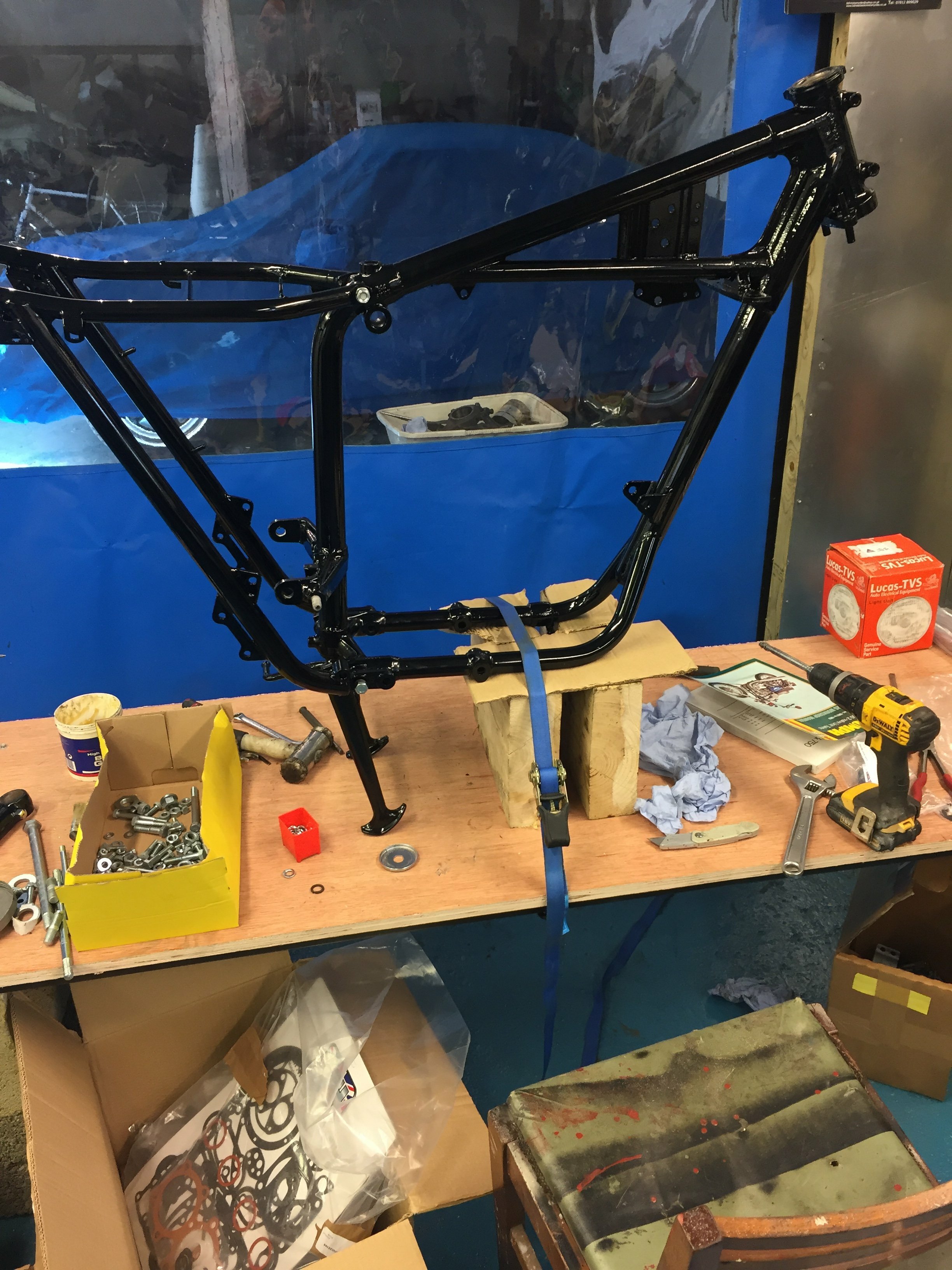

    I couldn’t resist bolting a couple of bits on this afternoon .

    Hey thanks , shes coming along steadily this week , I cant get too far as still waiting for the crank to be balanced , its in the queue so hopefully by the end of next week . Wheel rims are at chromers together with a couple of other bits so another 2 wks for those and speedo/tack at Andy pople (thàmks darkman ) hope to reassemble the forks today .
