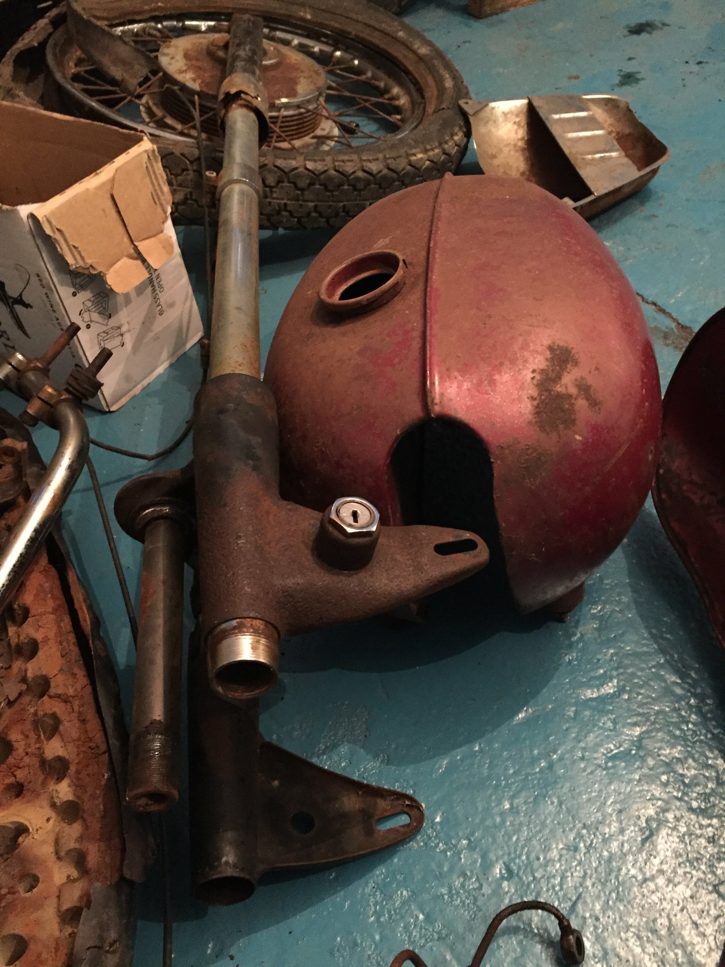

    This is my new bike project a 69 Bonneville returned home from US. Plan is to rebuild to pretty much standard trim , may switch to UK spec but would like to see the two models side by side to decide as not really a triumph expert as yet !
    I have restored quite a few cars from ground up and currently halfway through an old MG but with the bike in my workshop I couldn't resist to get cracking .

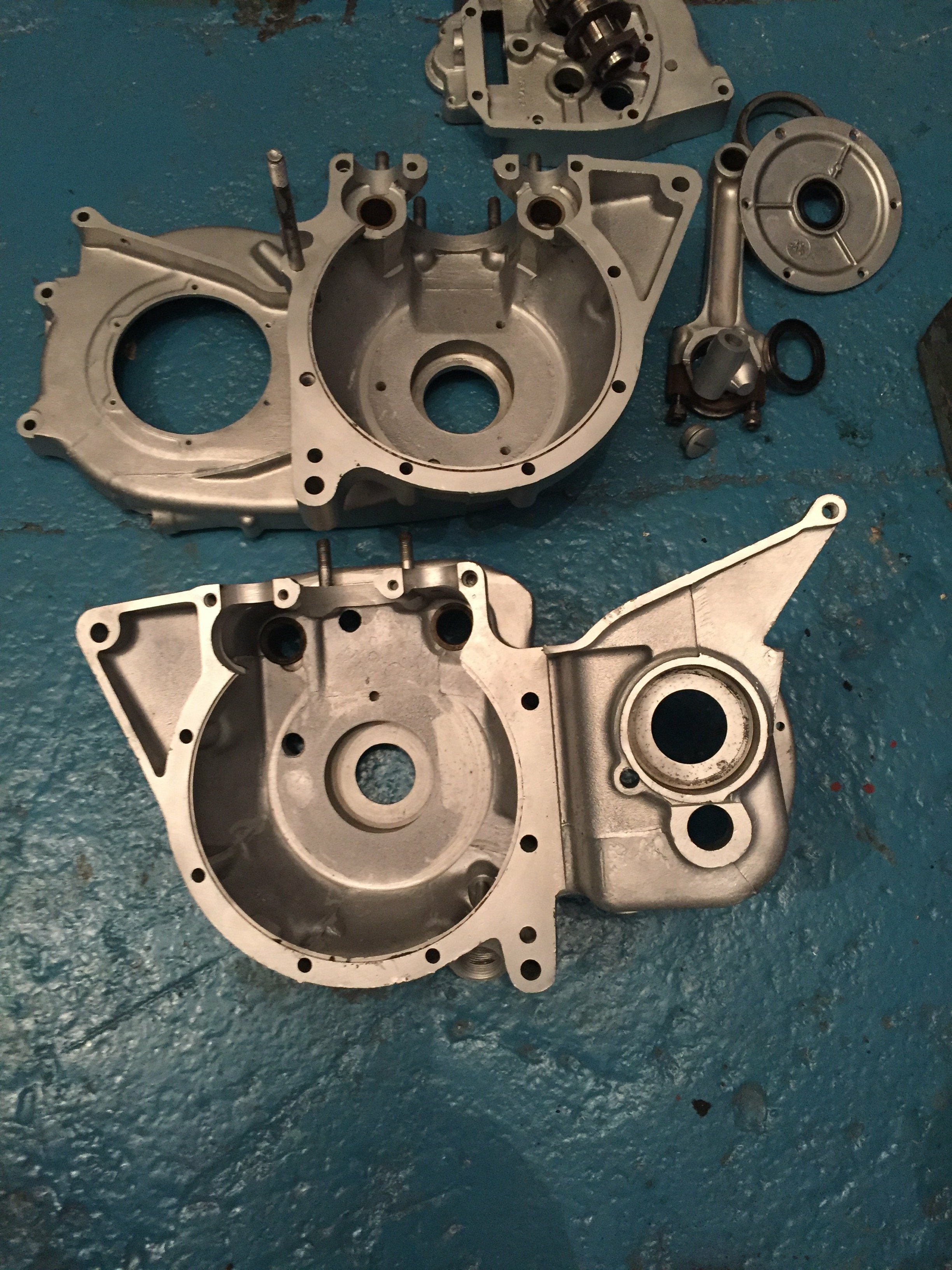

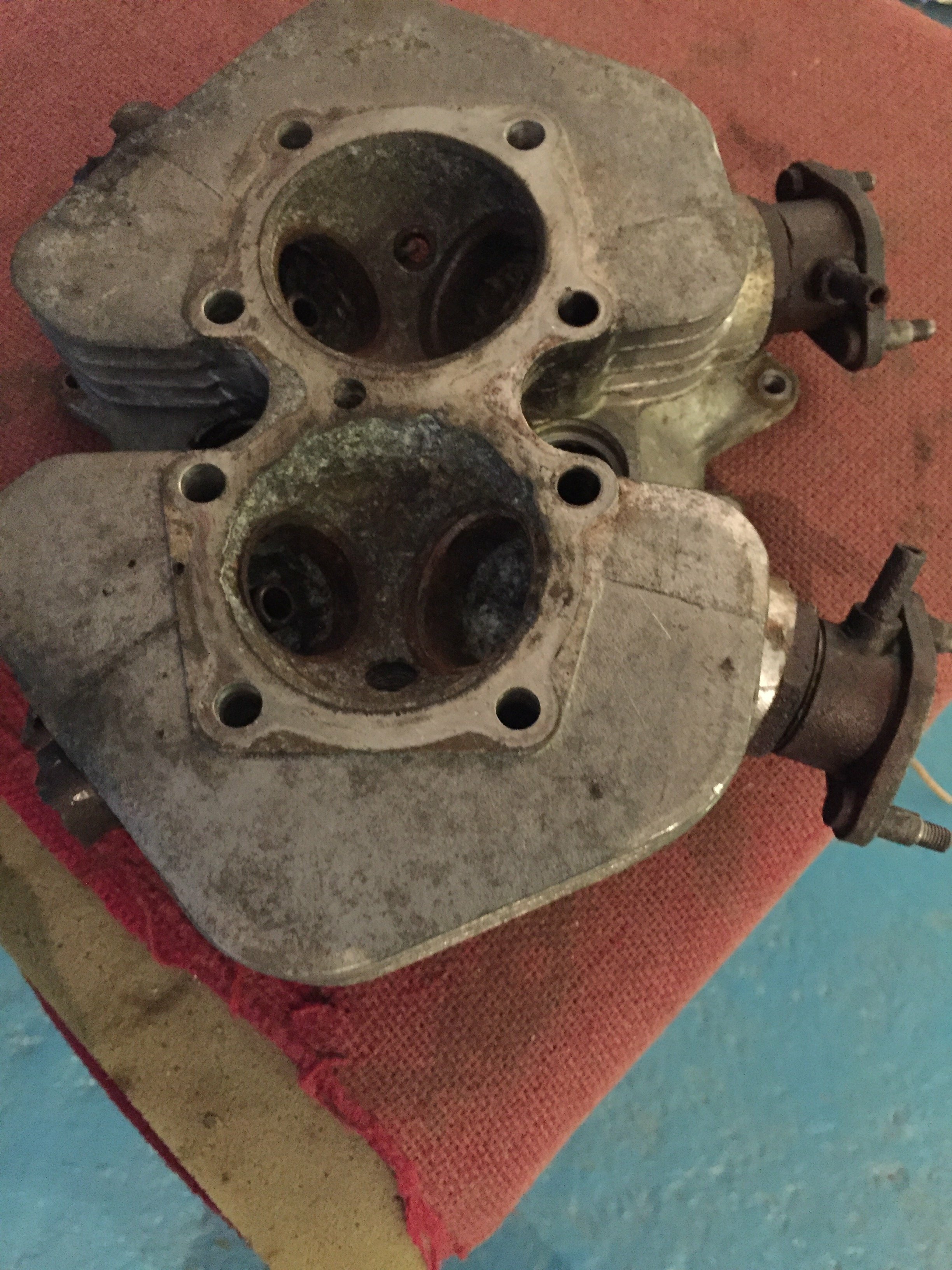

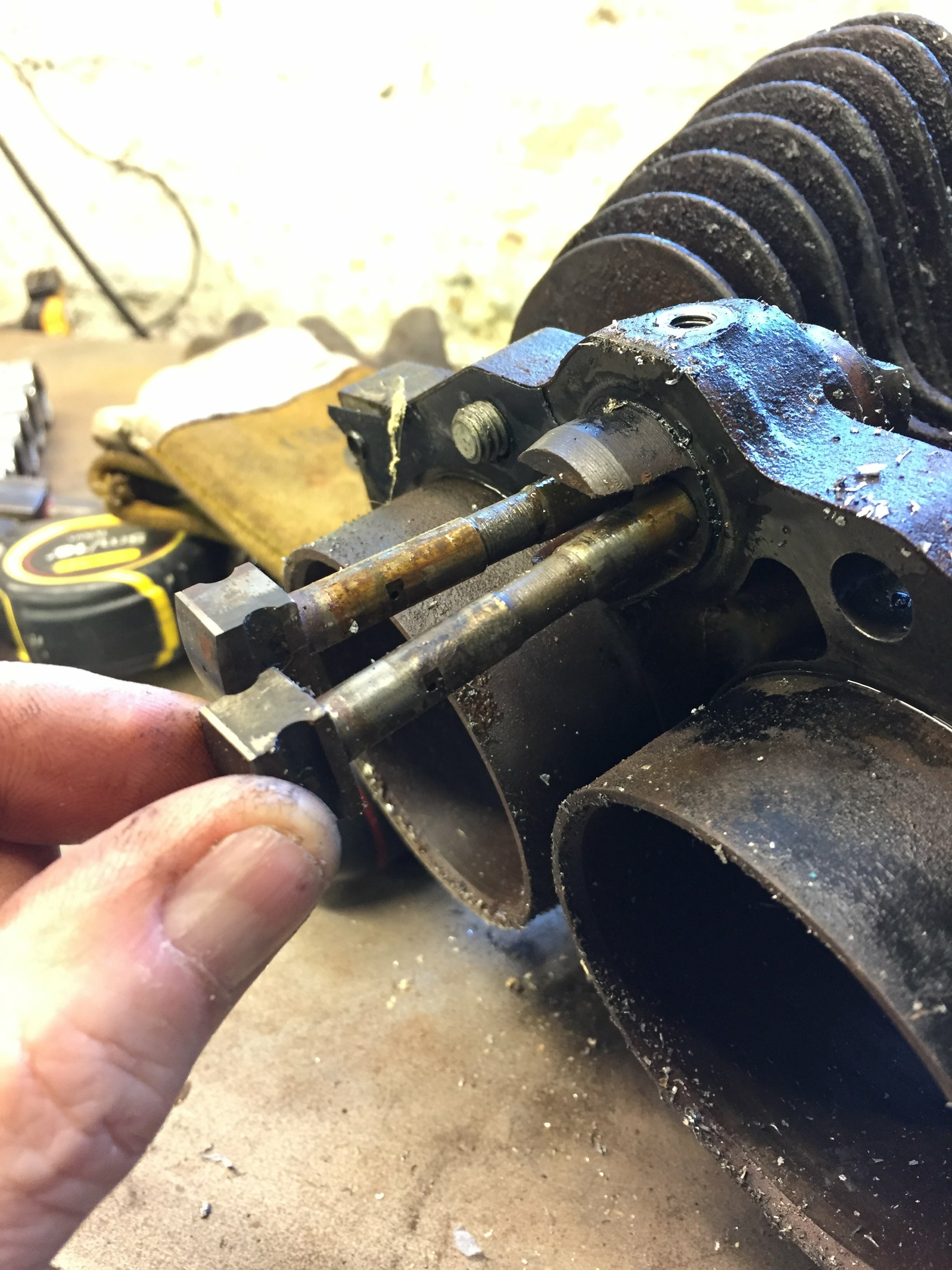

    The engine was sized and no amount of soaking , well a week anyway made it easier . I tried heat , and various sized hammers . The bores looked toast from corrosion so had to drill and chisel the pistons out. Not the best of starts !

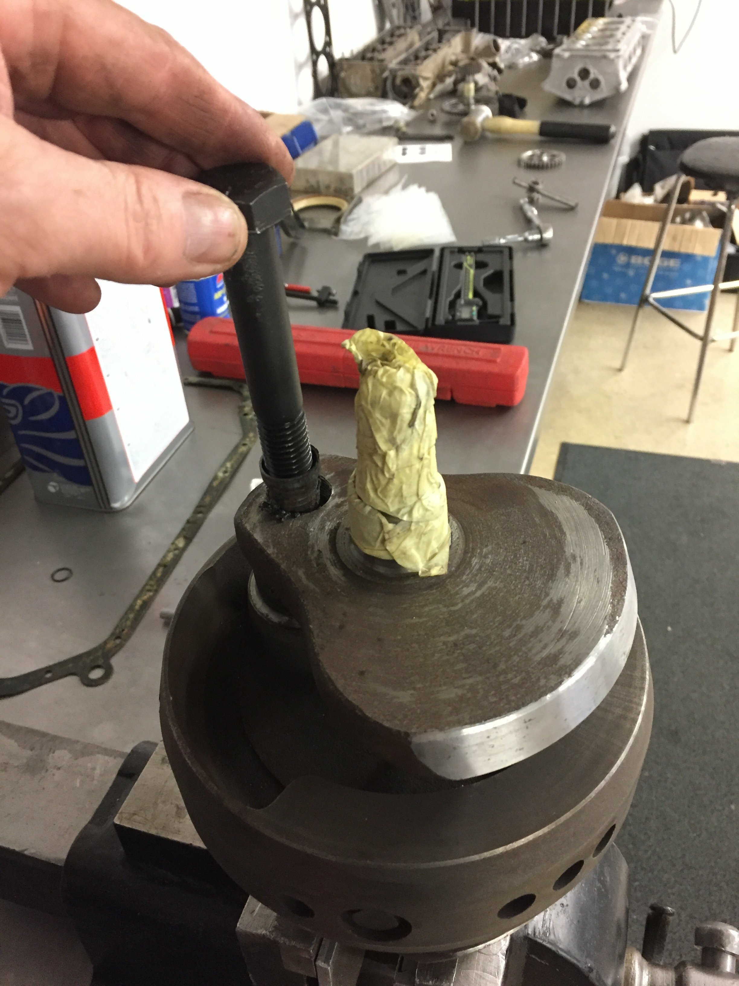

  3. joe mc donald

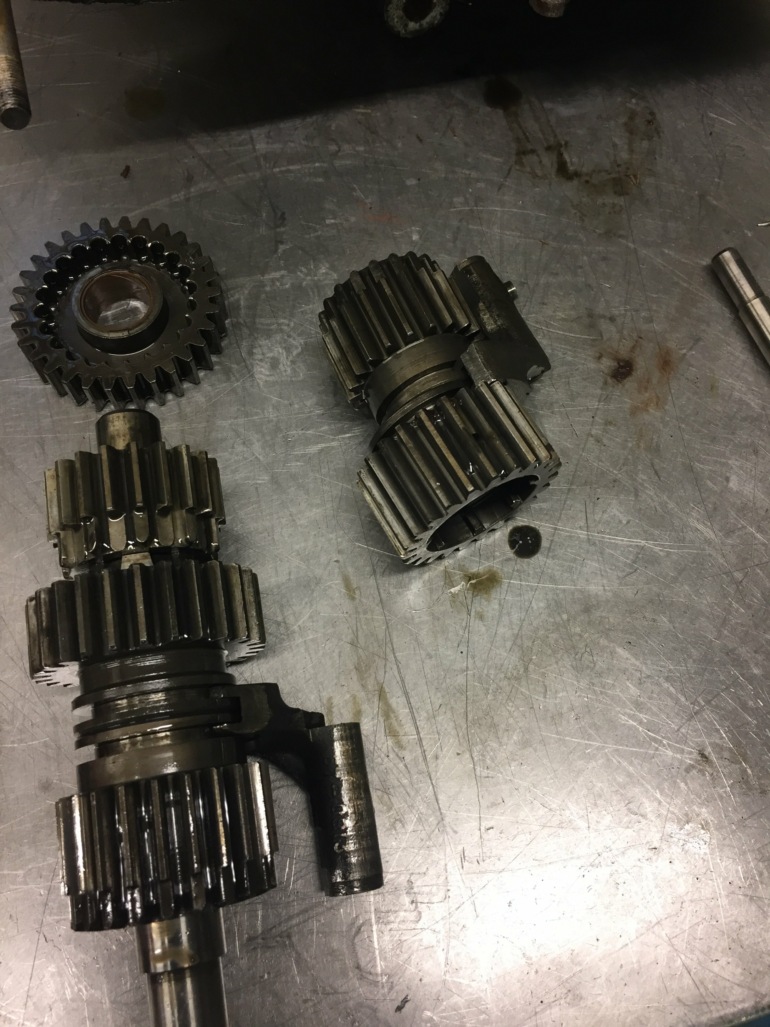

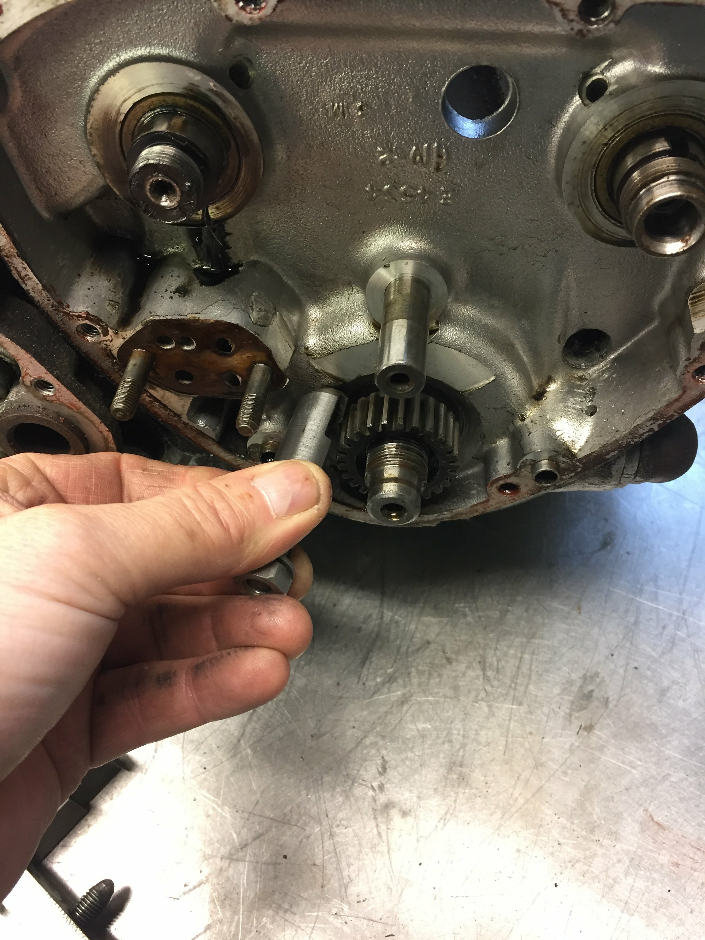

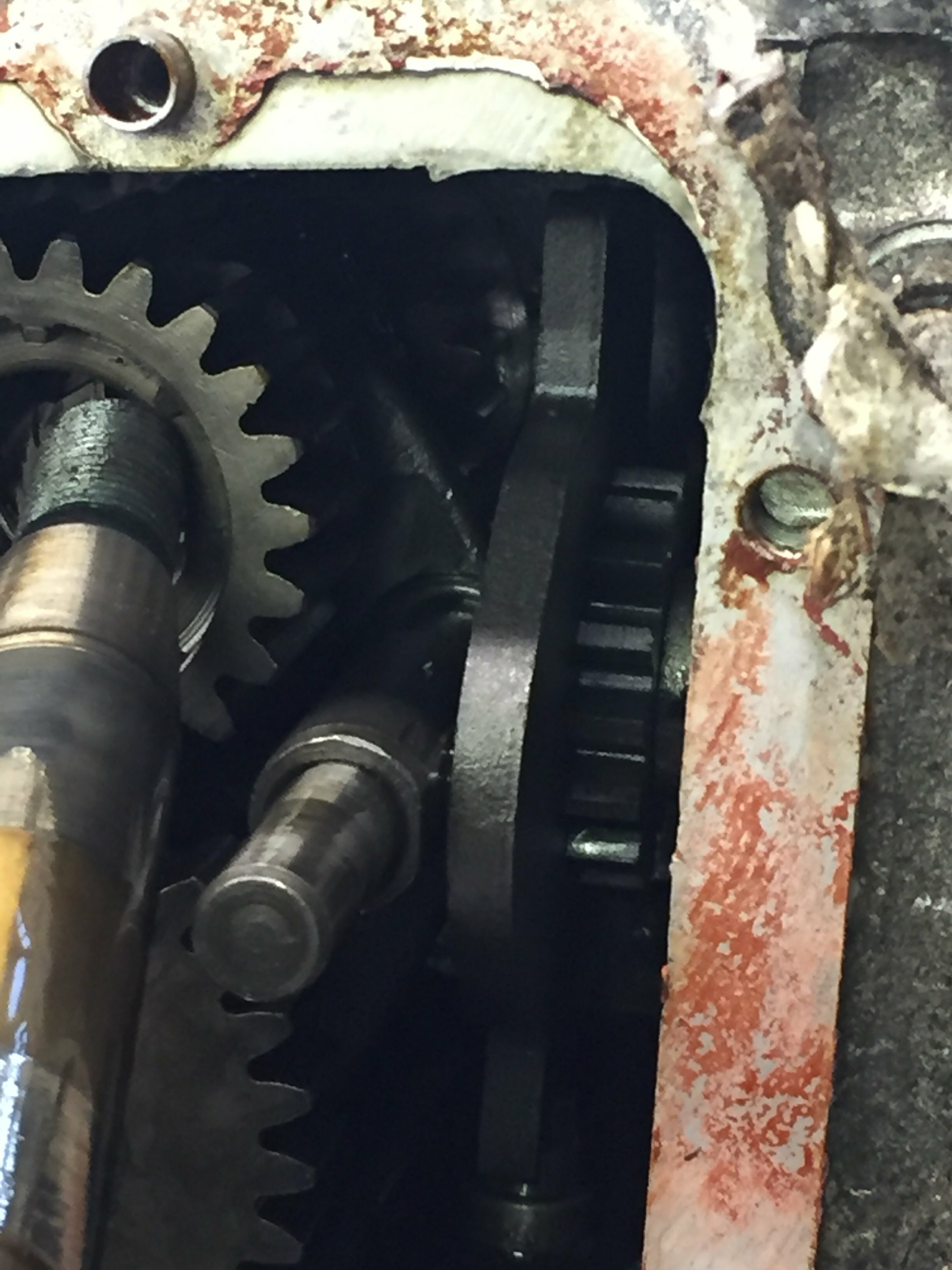

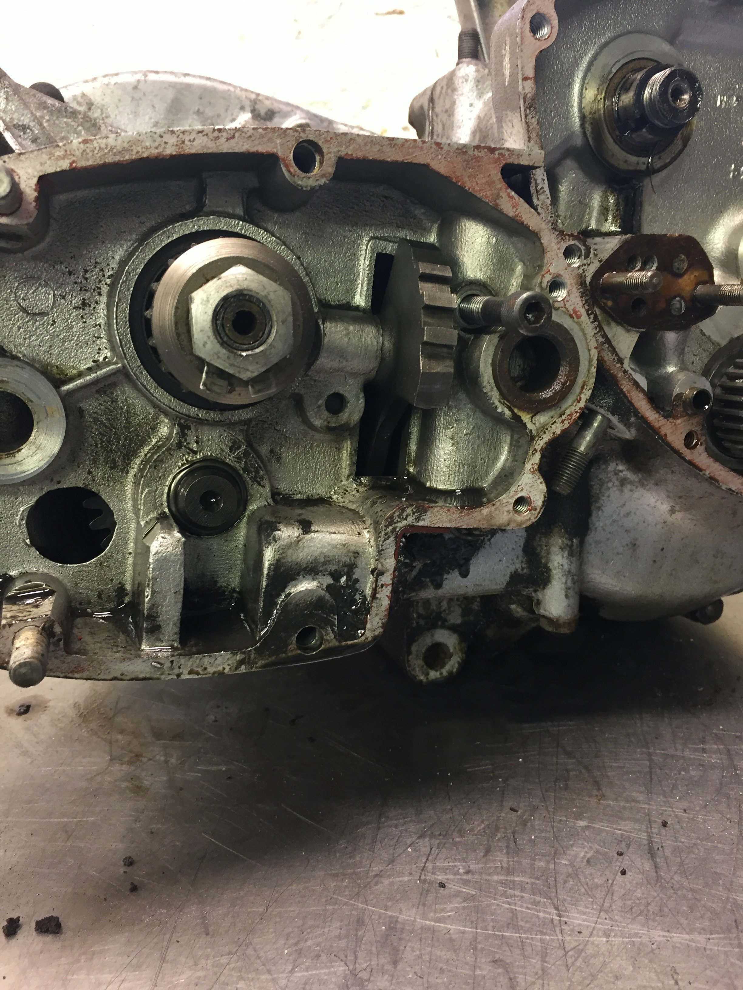

    The rest of the engine strip went a lot easier ,everything appeared to be on initial inspection in rather good nick.

    Hey thanks Joe , I removed the sludge trap and cleaned that little monkey yesterday, big ends are standard and quite tidy but stained so may opt for regrind will see if machinist think they will polish up ok .

    I have cleaned the engine cases with very fine glass bead and they are looking very nice . I have some new rods ready for rebuild time . I am just waiting to see if my cylinders will clean up at the machine shop , I am kind of thinking I am probably wasting time and that they look doubtful if taken to 60 over , perhaps plus 80 may but read somewhere that 80 over is not ideal .

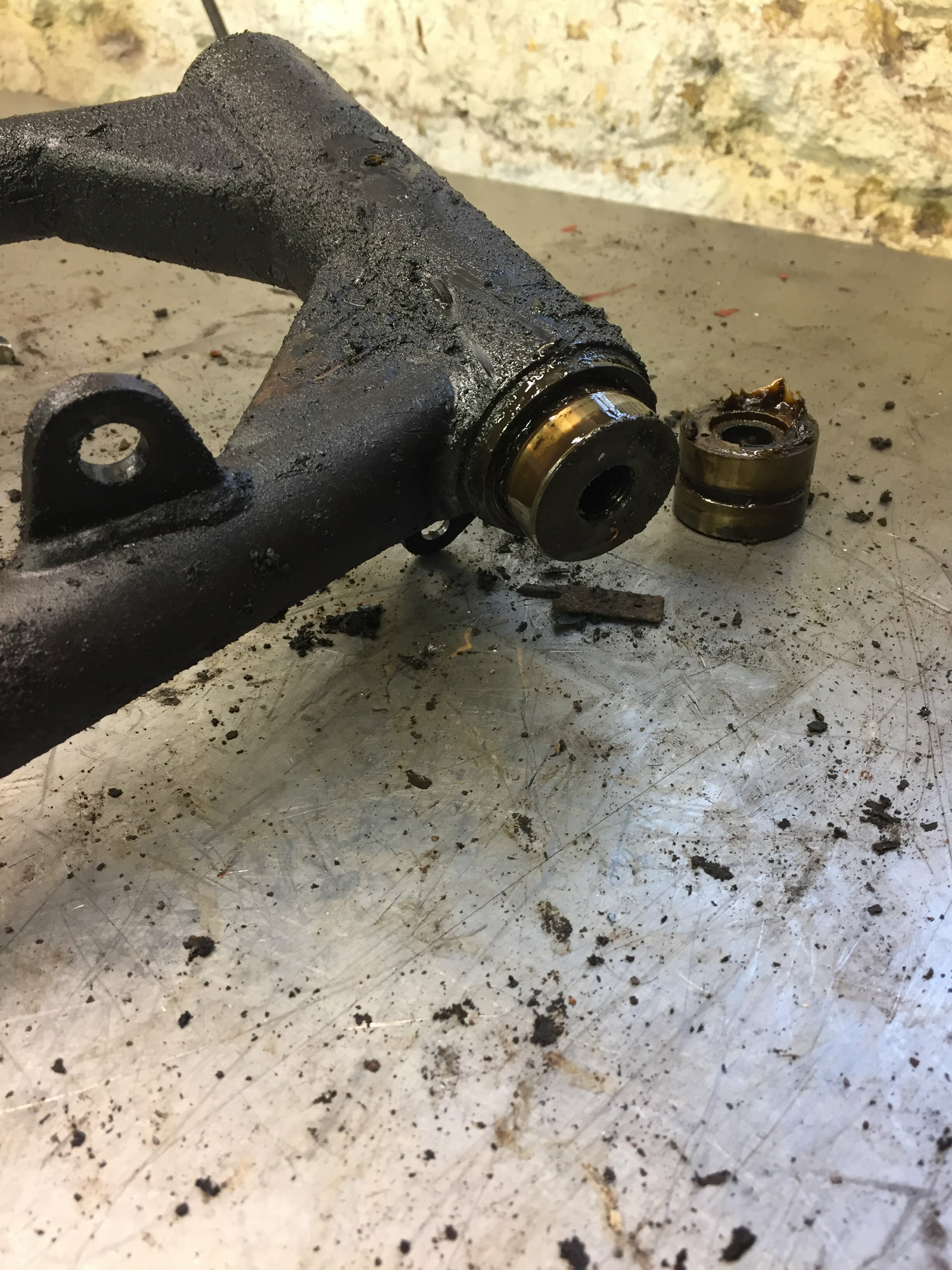

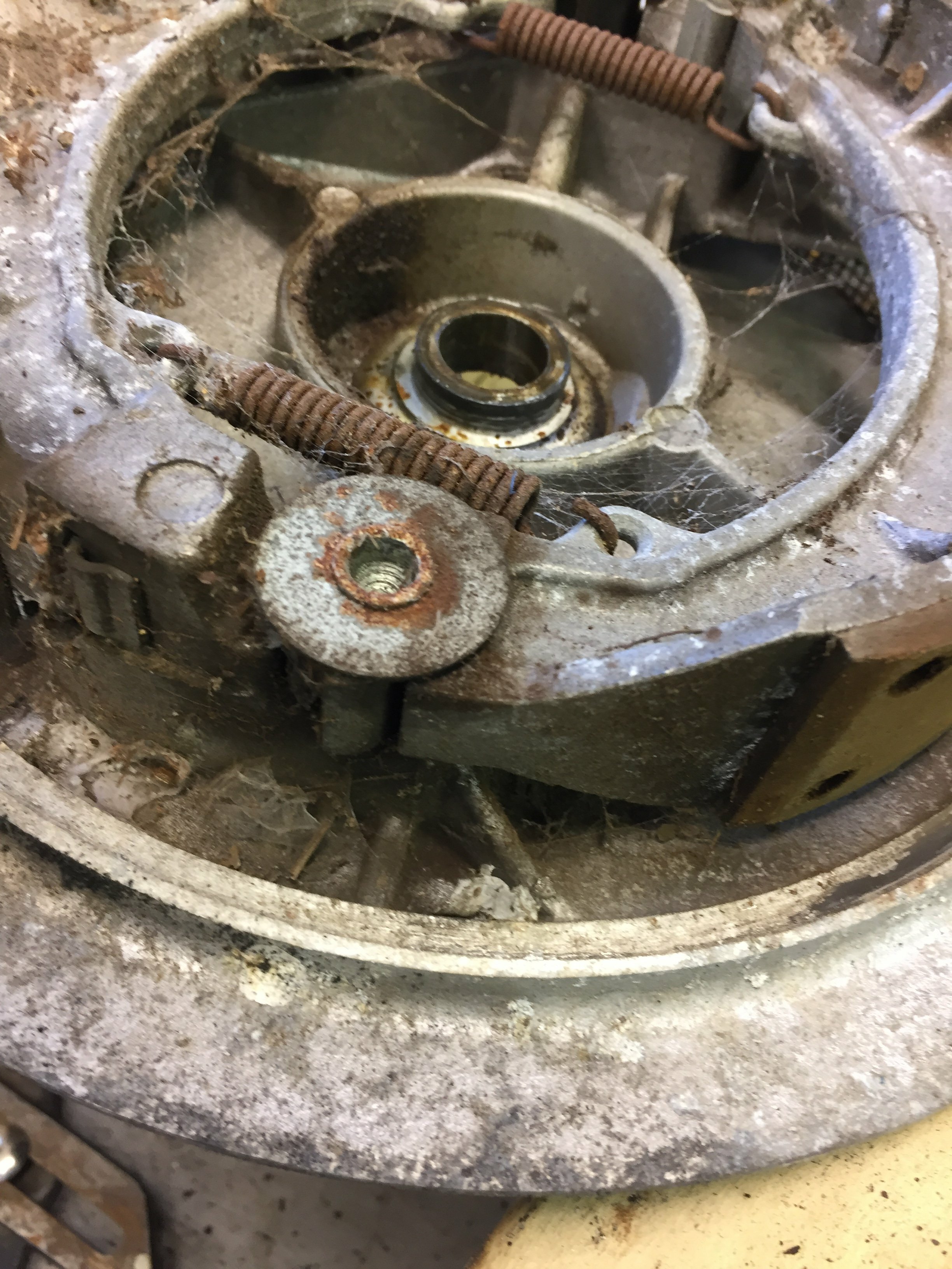

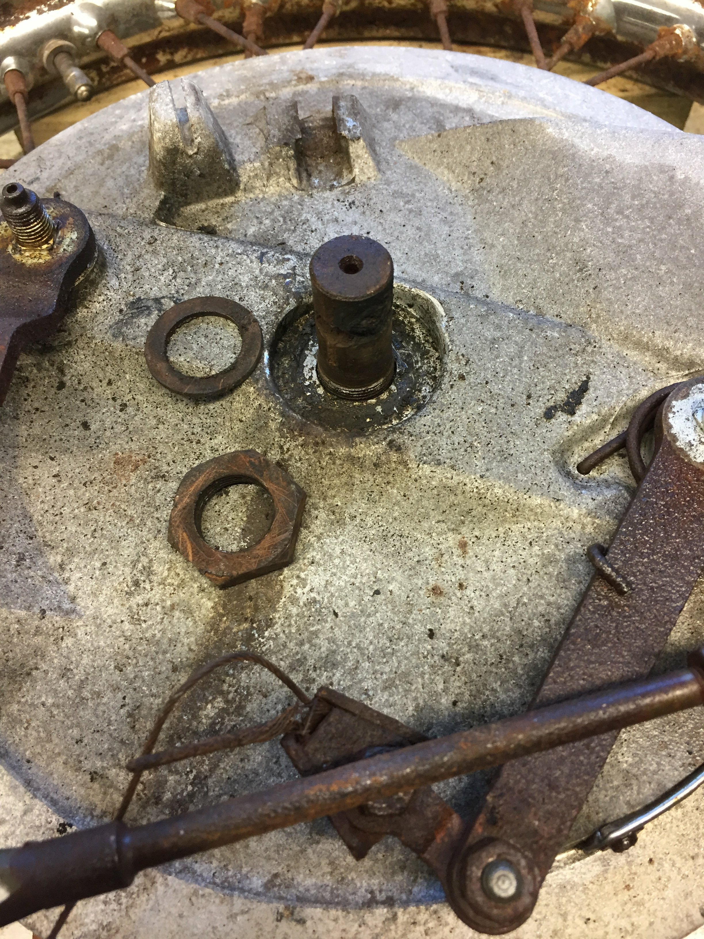

    A few pics mainly taken so I can remember how the thing goes back together !

    Crank looks to be in good order , cleaned the sludge trap and temp refitted so it can be balanced when I have the pistons .
