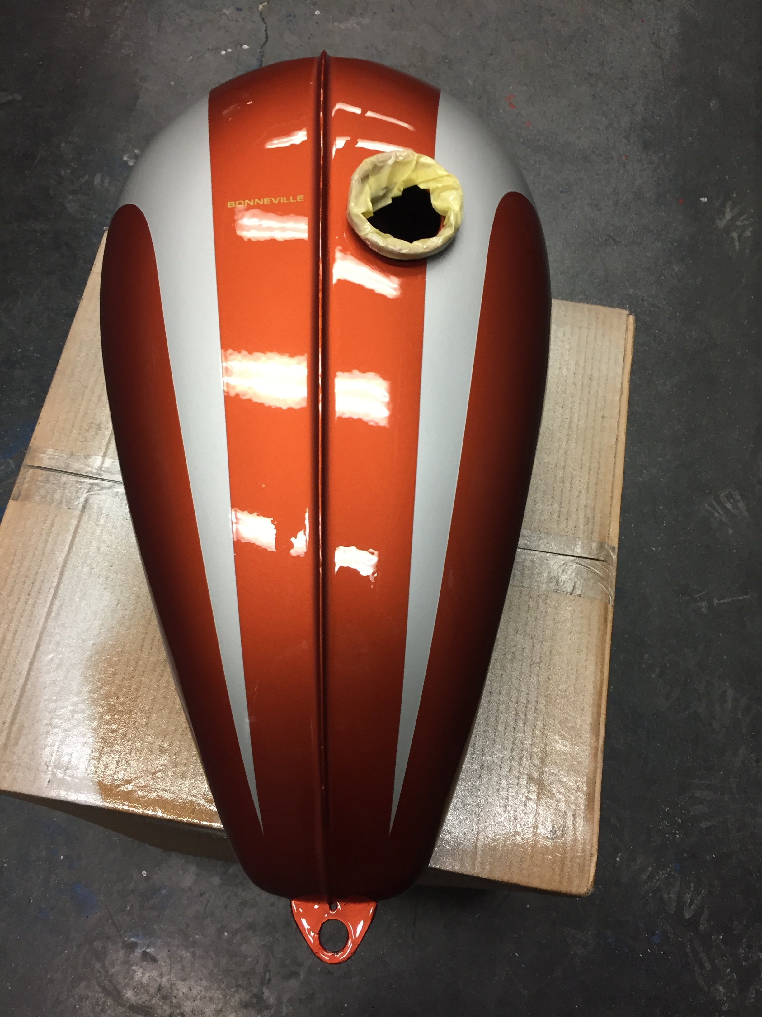

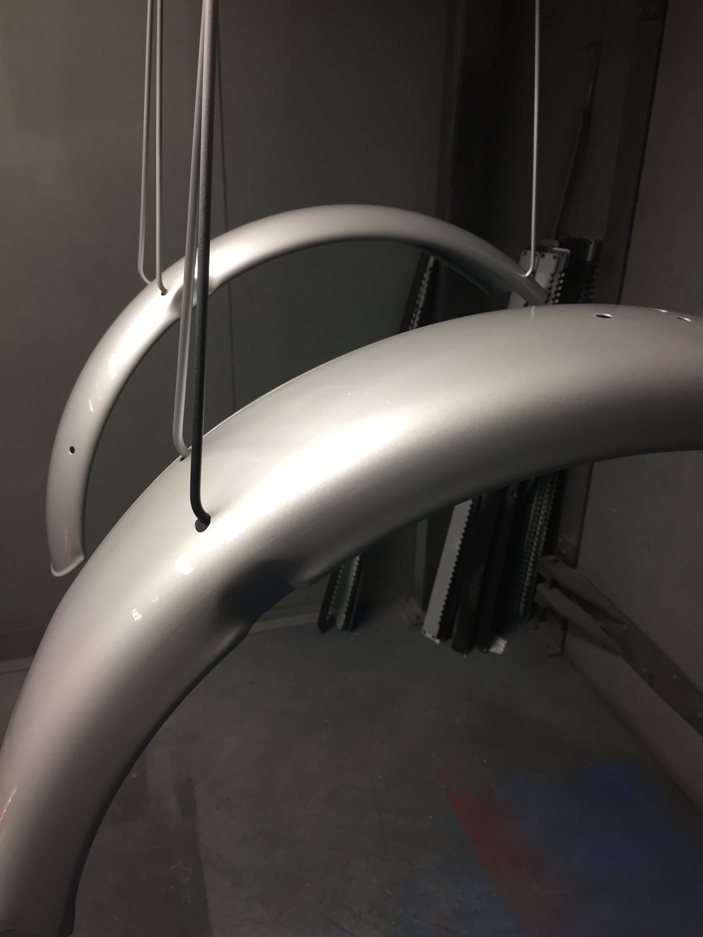

    Got some paint on tonight , laquer has been on for 30 mins so far ,my decal hasnt pickled :), still tacky when left so hoping it hasn't floated to the top by the morning ,
    #241
  2. darkman
    5,158
    7,660
    Very nice :)
    #242
  3. Tibster
    Tibster Well-Known Member
    Feb 10, 2019
    200
    270
    Witney

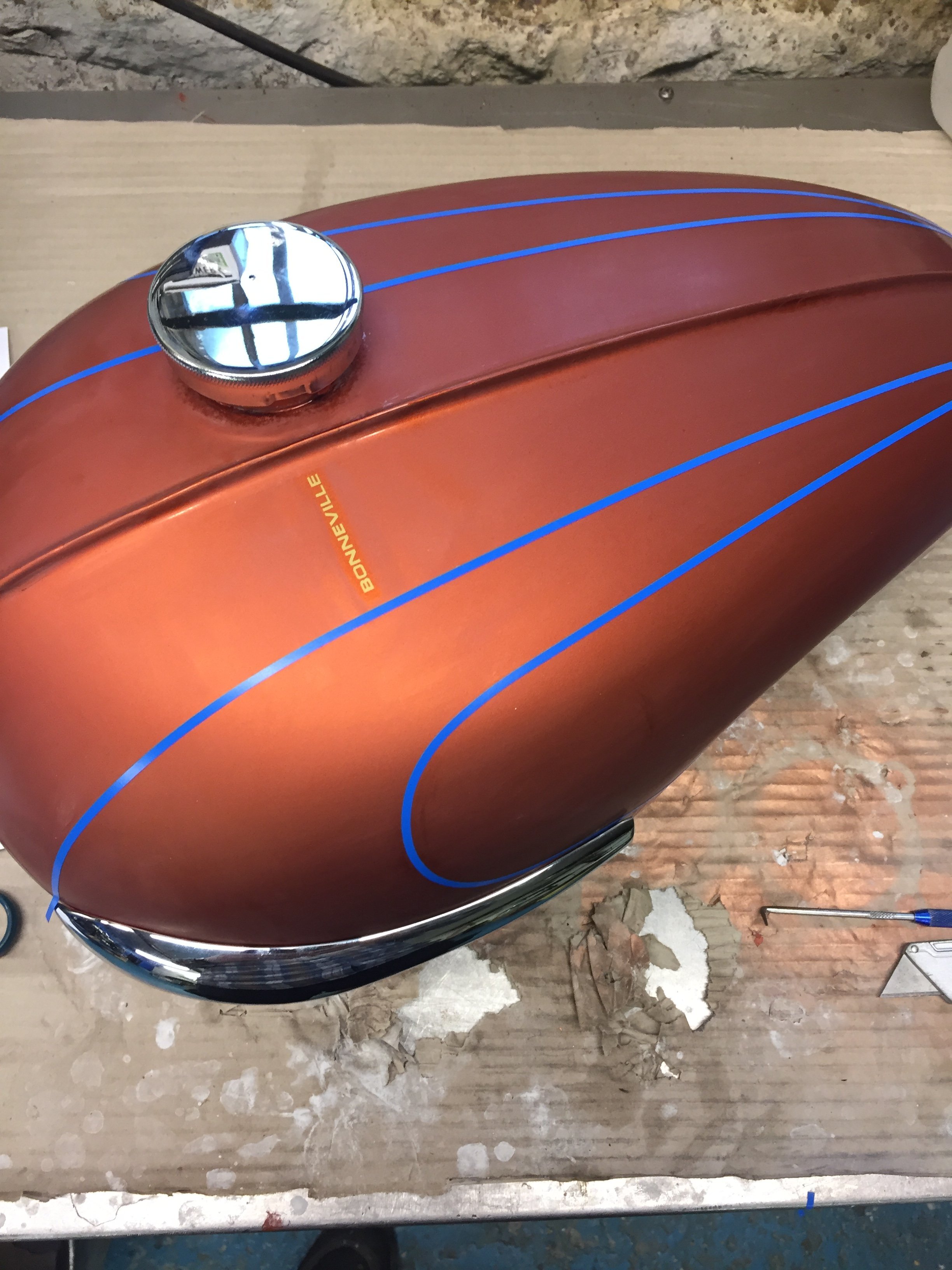

    Thanks darkman, very pleased with it, the water slide decal handled the laqer thankfully , I misted it firxt and let it tack off a little more than usual before the following two coats . Other things that may of helped were the fact that the first coat of paint on the tank had been on there a good couple of weeks and I also put the water slide on two days previously allowing it to fully dry .. or was just lucky !
    Think I will flat off next with 1500 then polish then finaly pin stripe . :)
    #243
  4. darkman
    5,158
    7,660
    Nice work, i never flat top coat as i like gun finish but that's just me lol.
    #244
  5. Tibster
    Feb 10, 2019
    200
    270
    Witney
    I will flat it as I do have a couple of small inclusions , I have to paint in an albeit v clean powder shop, flatting should soften the edges and make striping a little easier I hope as may attempt myself but not sue yet . I know what you mean though , if I had a perfect fininsh I be tempted to leave it to.
    #245
  6. darkman
    5,158
    7,660
    It's going to look fantastic when done :)
    #246
  7. Tibster
    Feb 10, 2019
    200
    270
    Witney

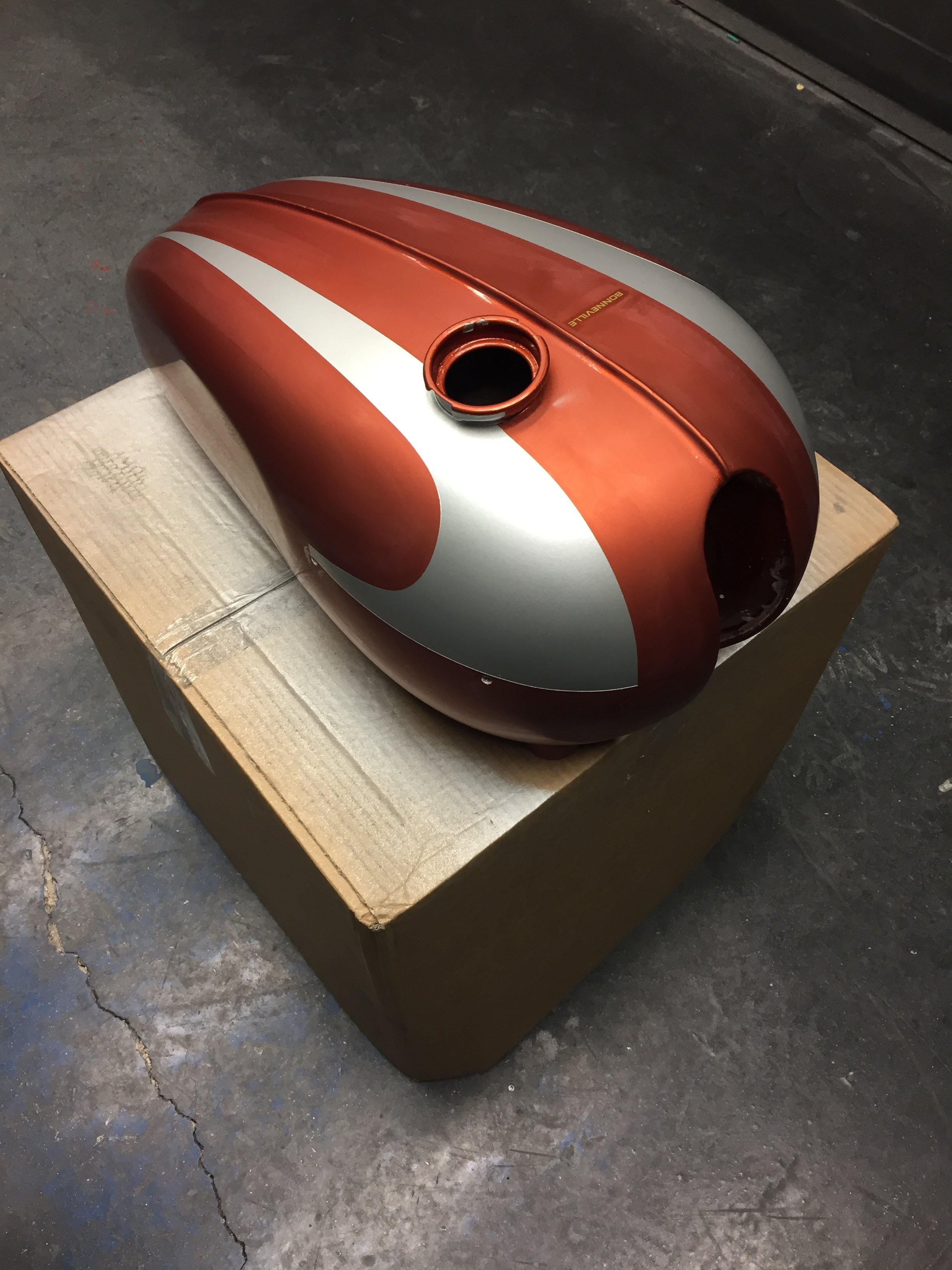

    Yeh cheers , think it will . Just flatted top areas of tank ready for a polish monday when I can borrow bro's polisher . Guards flatted too ready for masking and adding colour stripe . Will be bike transforming when these go on fof final fit :yum
    Oh and I cleaned up the petrol spout ;)

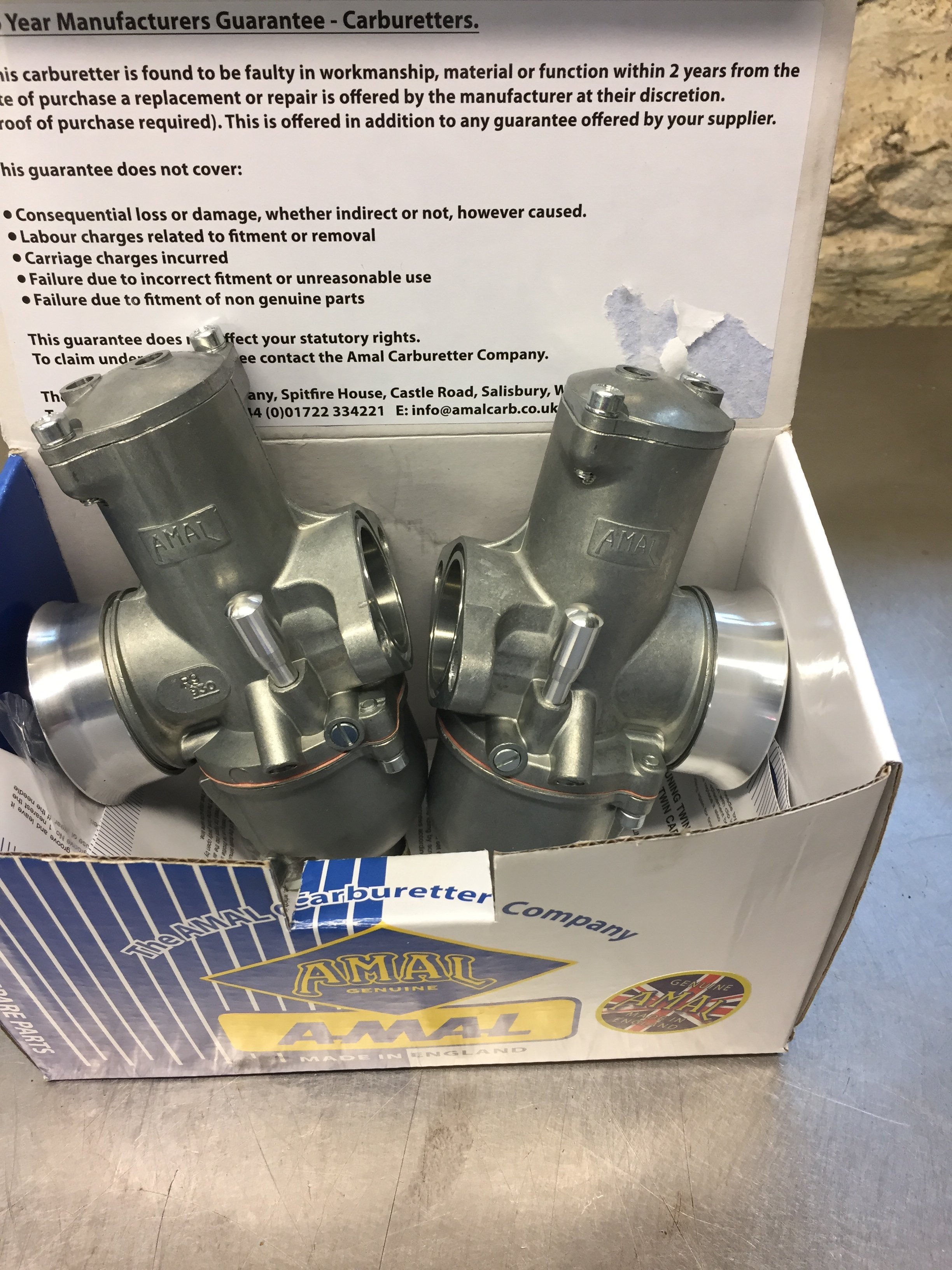

    These beauties turned up in the post . Awaiting some spacers before I can fit them though .
    95D75787-EF23-4765-A5BD-96E76BC42E85.jpeg '
    I decided to fit a new pair , I was going to rebuild my old ones until the centre jet assembly stripped out the alley threads in the main body :(, a shame but would of cost about £60 in parts and tbh I want the bike to run nice without the hassle of unknown worn parts so decided to fork out more bucks , hopefully nearly there now so the wallet can get some relief .

    Very nice, well worth the big spend :). Spacers ?

    My parts book shows a spacer 3mm I think

    Book shows carb spacer but 69 manifold has welded studs that are not long enough for spacers, so in reality 69's don't have them.

    Thanks for the pic , I did offer up without spacer at first and it looks like it would work with or without spacer , they were only £4 so will see when they turn up if they appear to be of any use .

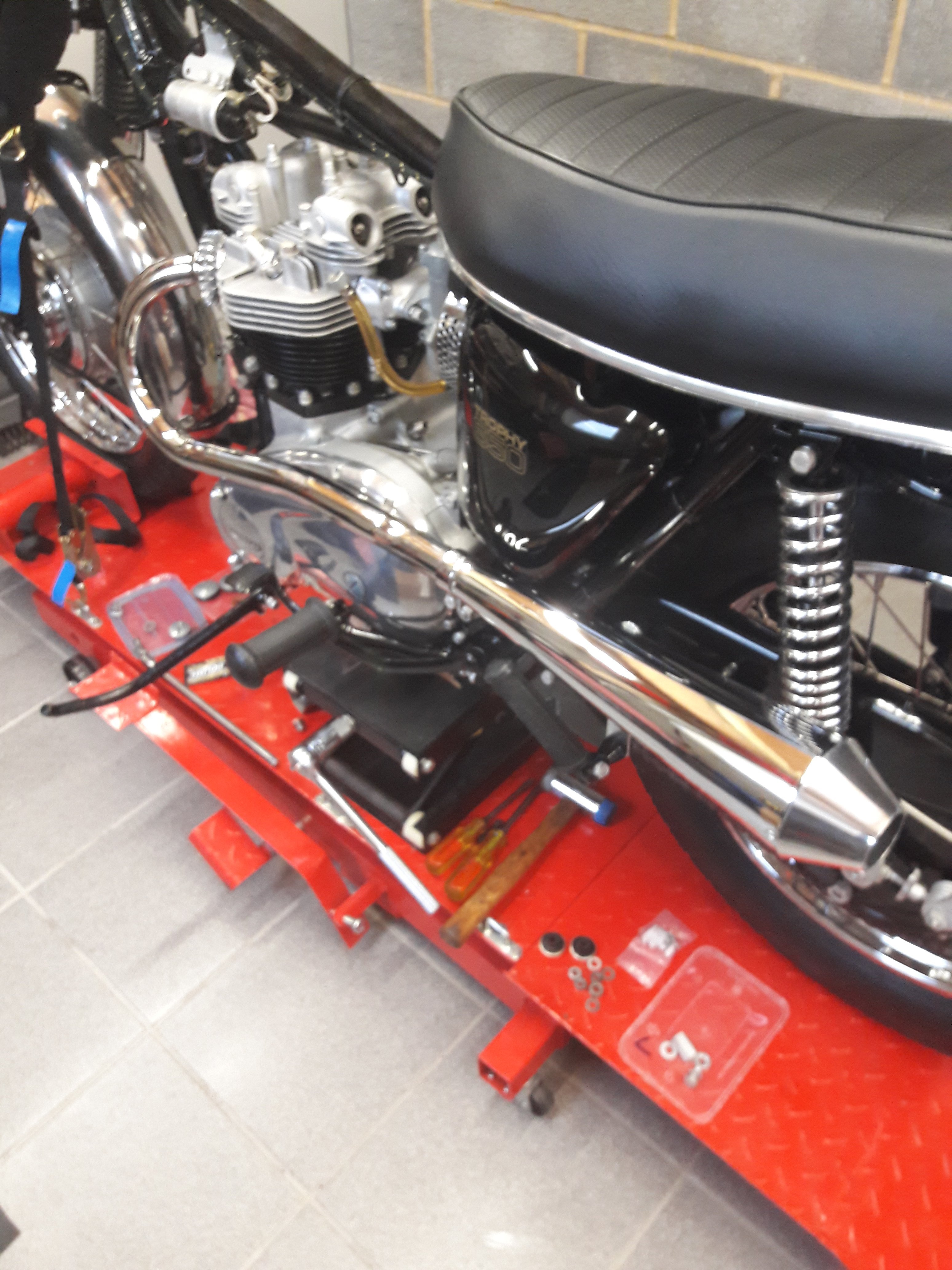

    cheers , will go search :), bit of an ask but do you have any pics of your bike with tank off showing wiring routing or a link to one . Is it best to wire it negative earth ,think I might .

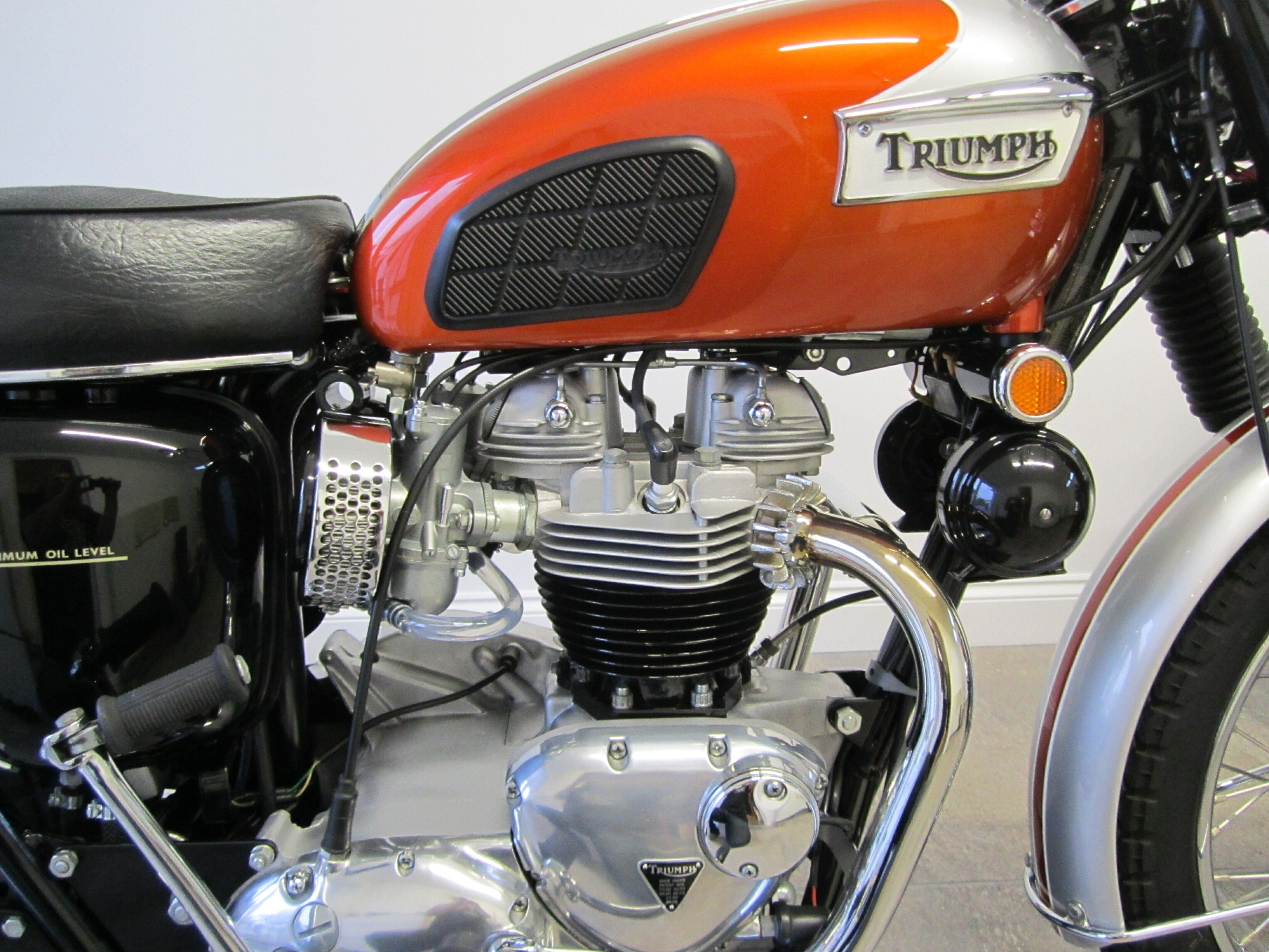

    I dont want to sound a cheapskate but after more searching for rectifiers I can see a Podtronics version would be cheaper , are they well regarded ?,I see they are American which I usually take to be a good sign in terms of quality .
    Sorry for the questions but is it a single phase unit I require , Stator has 2 wires is this the clue ? .
    #259
  20. darkman
    5,158
    7,660
    Yes single phase, i only use poss earth and Boyer so have no idea on Podtronics sorry. Couldn't find a T120 one but have my TR6C pic.
