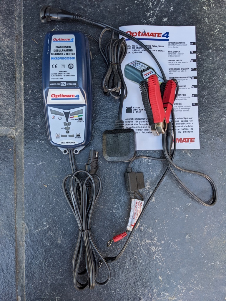

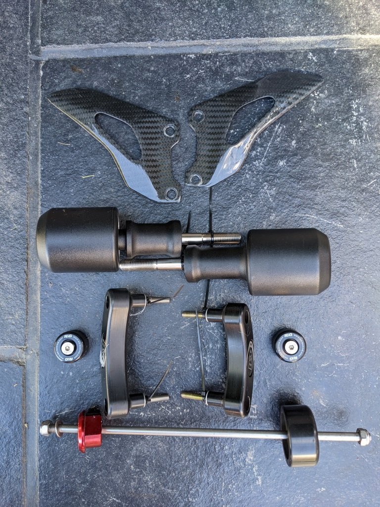

    I've sold my Speed Triple 1050RS & have the following items for sale. Items are in excellent & unmarked.
    • EvoTech Rear Spindle Bobbin £30
    • EvoTech Frame Crash Bobbins £45
    • R&G Left & Right Engine Case sliders £45
    • R&G Bar End Sliders £8
    • Carbon Heels Guards £ 30
    • Optimate 4 £30
    UK only please

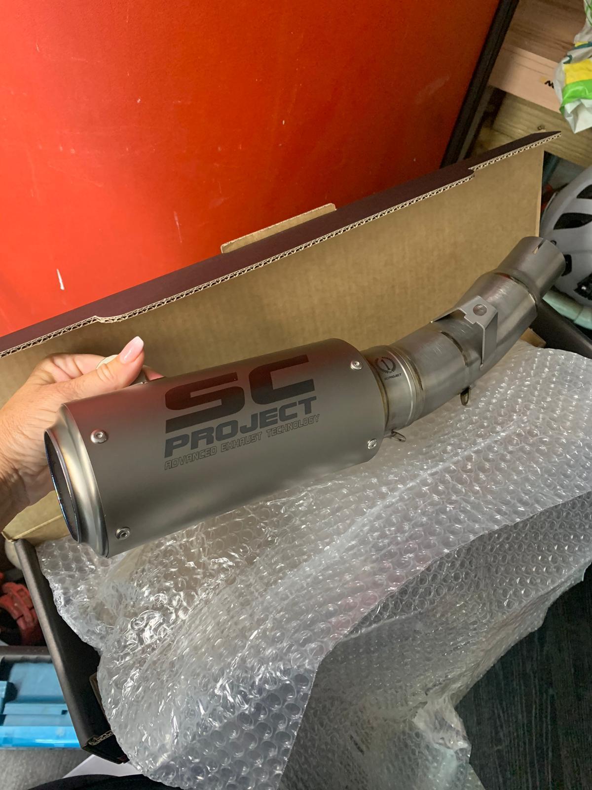

    Sorry to raise an old thread but to any of those still here who have fitted alternative silencers, Did they mess up the fuelling?
    I am looking at fitting the SC projects tail pipe on y 2018 ST RS but don’t want to spend £500 and mess it up. I would run the pipe with the dB killer in it.
