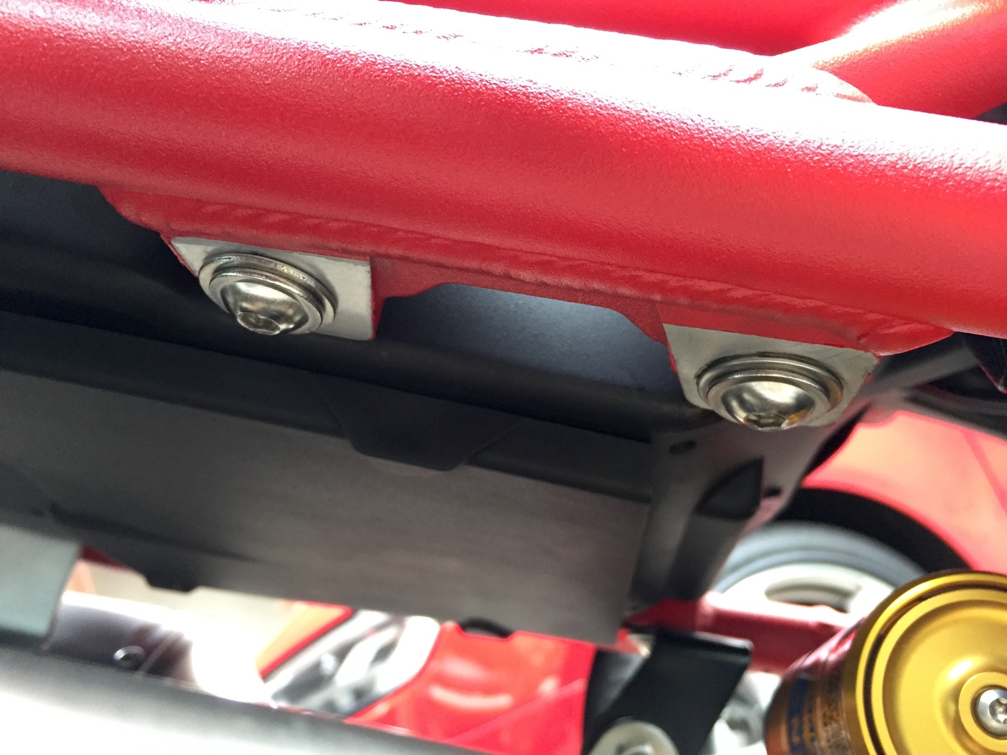

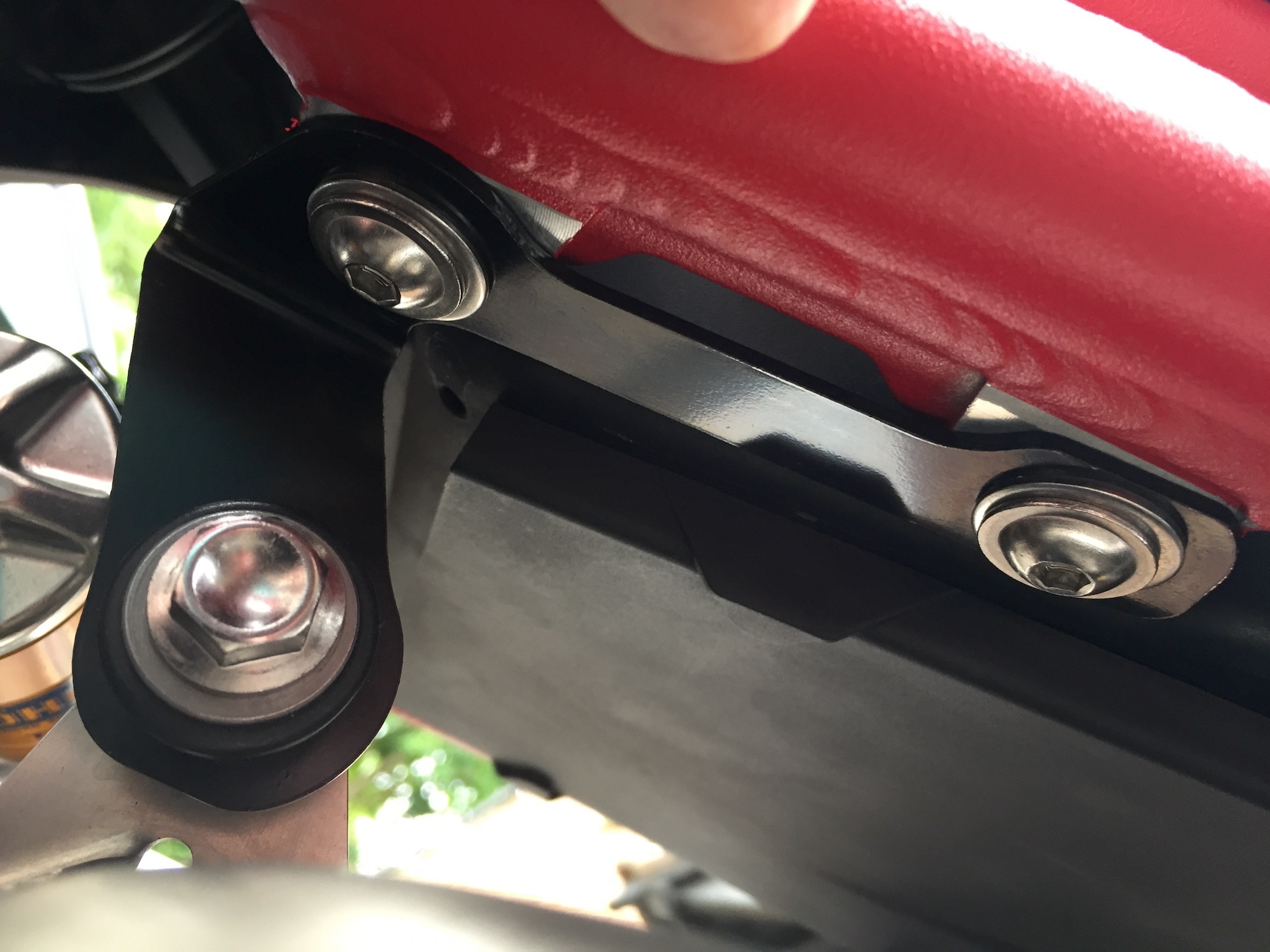

    MrTriple, just curious: did you put back in the original screws for the pillion pegs? I'll definitely remove the pegs but not keen on leaving the holes exposed, so your solution looks clever.

    Without the thickness of the pillion peg brackets, you'll definitely need to buy shorter bolts and perhaps washers to go with them...but that's easy:
    M8 x 16mm flanged button head bolts
    https://www.ebay.co.uk/itm/M8-8mm-F...L-KAYS-/361137933592?var=&hash=item92cbc333f6
    M8 Form C washers
    https://www.ebay.co.uk/itm/FORM-C-W...DE-RIM-/150939016233?var=&hash=item68ce53dc40
    Here's a close up of my old 2016 R (with the hanger for the Arrow cans):
    One of the cheaper modifications that you can do :yum

    Thank you so much MrTriple! That is a great tip. I just ordered the bolt and washer :)

    Ordered some of them too, look better than the non flanged and normal sized washers I was using.
