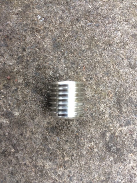

    Insert has no hex or slot got one out with threaded bar and lock nuts but other one wont budge
    pictures of the i got out m5 internal m16 external
    pictures of the i got out m5 internal m16 external dont look like there is any thread lock used

    Removed with the help of a torx bit and hammer that one was thread locked for some reason
    only problem is the inserts for the mirrors dont fit to big hole in bars only 14mm
