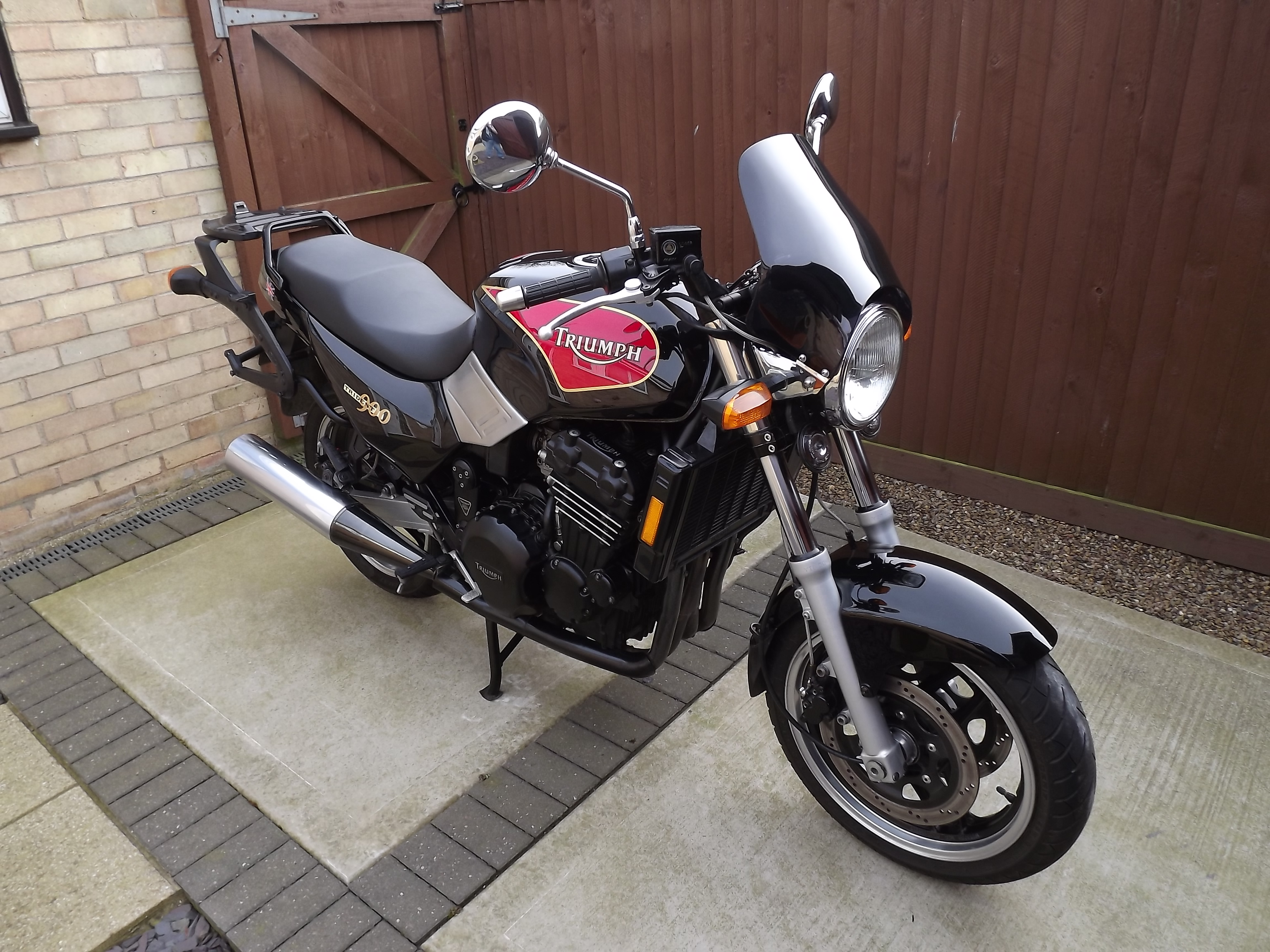

    Hi Steve,
    Put the freer flowing mufflers back on and do the following mod to your carbs, pull the top caps off (careful you don't tear the diaphragms) lift out the slides, you will find a drilling to one side of the needles, if you drill this out slightly bigger and lift needles (I did by 30thou or so) throttle response power & fuel economy all improve ! And I could lift front wheel @ will in 1st to 3rd from 4500 - 5000 rpms off the throttle, no clutch work needed ! Overtaking in any gear improved considerably, no down change needed ...
    Cheers Mick ( capt )

    Now there's a thought!
    Thanks for that, Mick. I shall have a look at that in the not too distant future.:)
