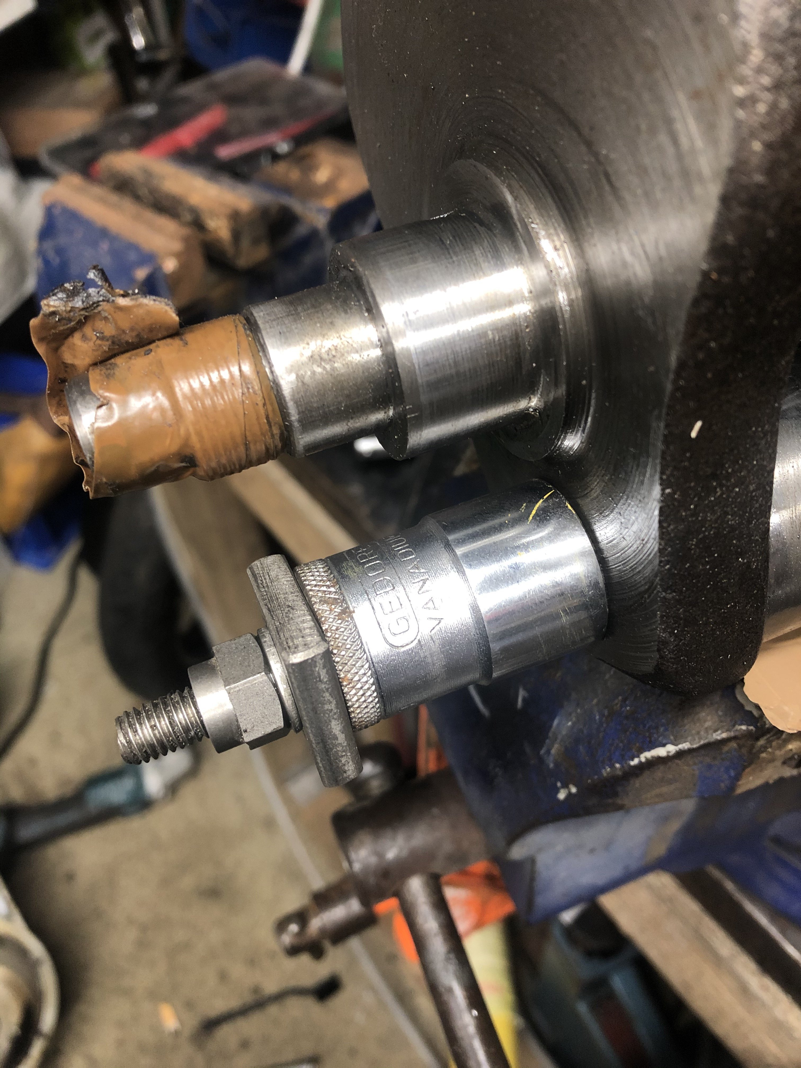

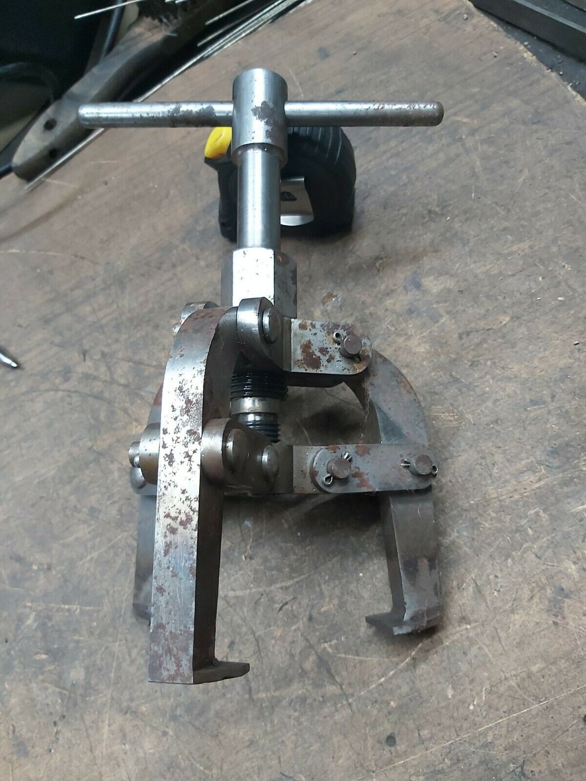

    A selection of chisels will do the job if you are careful :)
  2. darkman
    7,658
    My latest old school puller :)

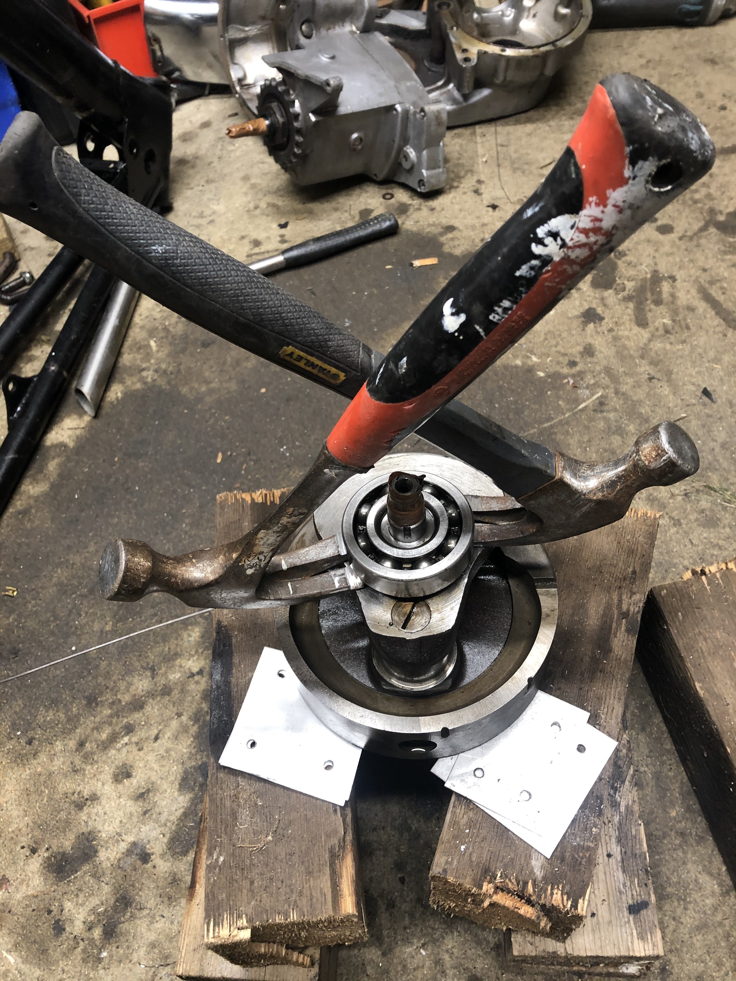

    Ah, I understand. The bearing has come out of the casing and is still on the crank. My bad, sorry, I thought the bearing was still in the casing.
    Here's John getting his off with a wedge - almost at the start of the video. That puller should do the job once you get the space
    You can look forward to the sludge trap soon, o_O
  5. Jim Hargreaves
    Jim Hargreaves Well-Known Member
    well I improvised, I searched through my workshop to see if there was anything I could use and dual claw hammers was the best thing I could come up with and it worked a treat, a little bit of heat on the inner race a bit of pressure from the double hammers and off it popped.
    Sludge trap hear I come

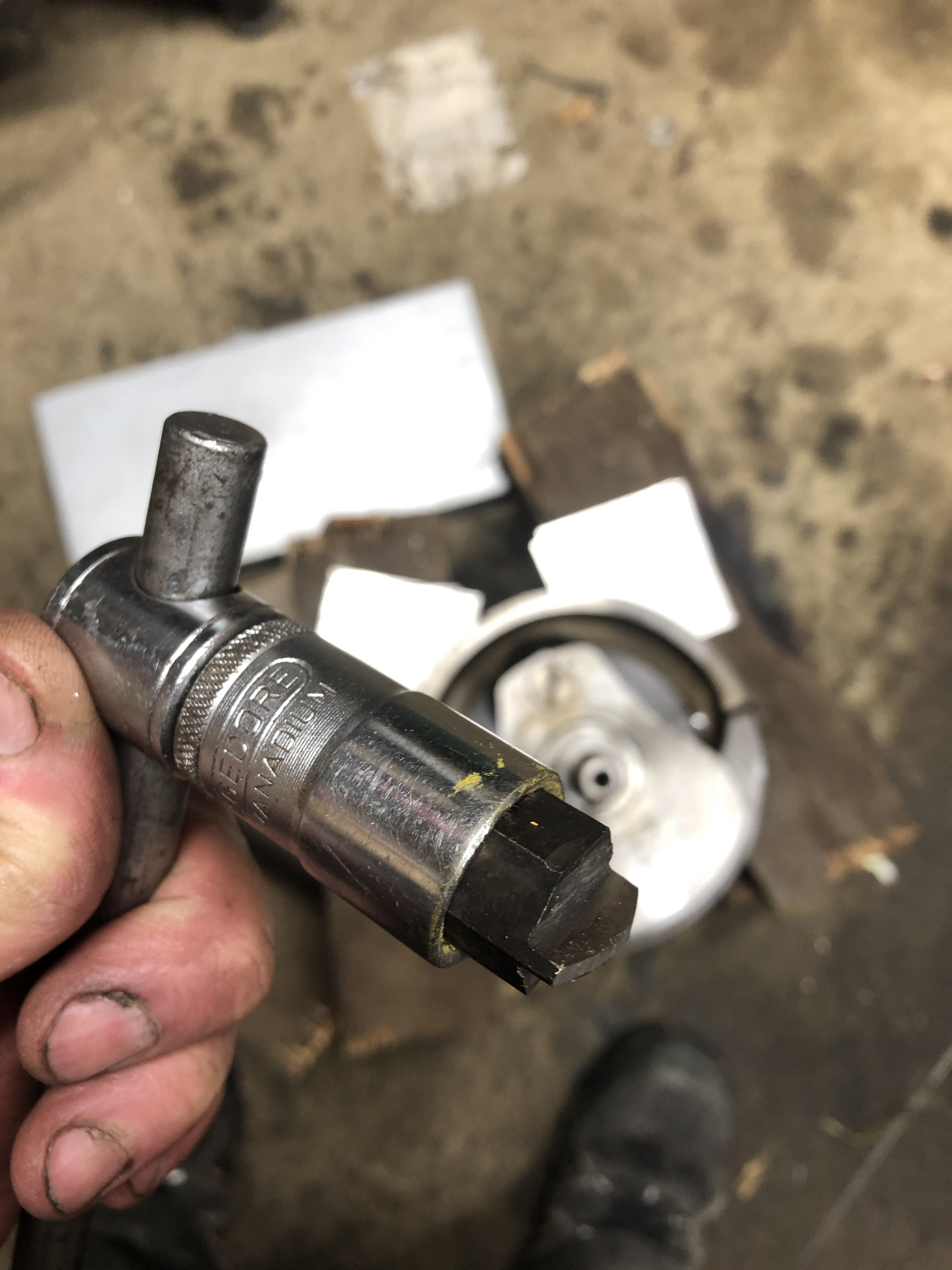

  8. Jim Hargreaves

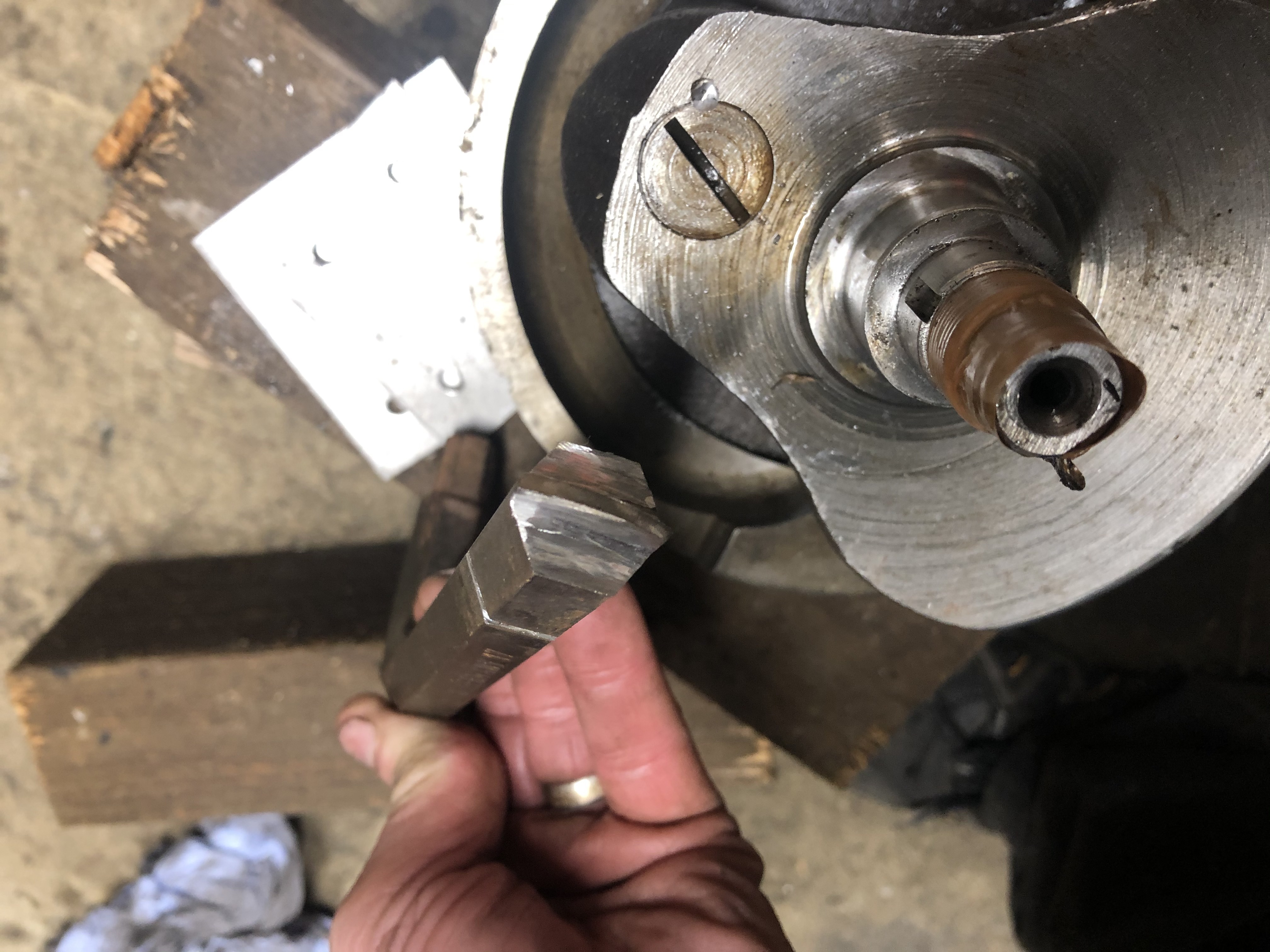

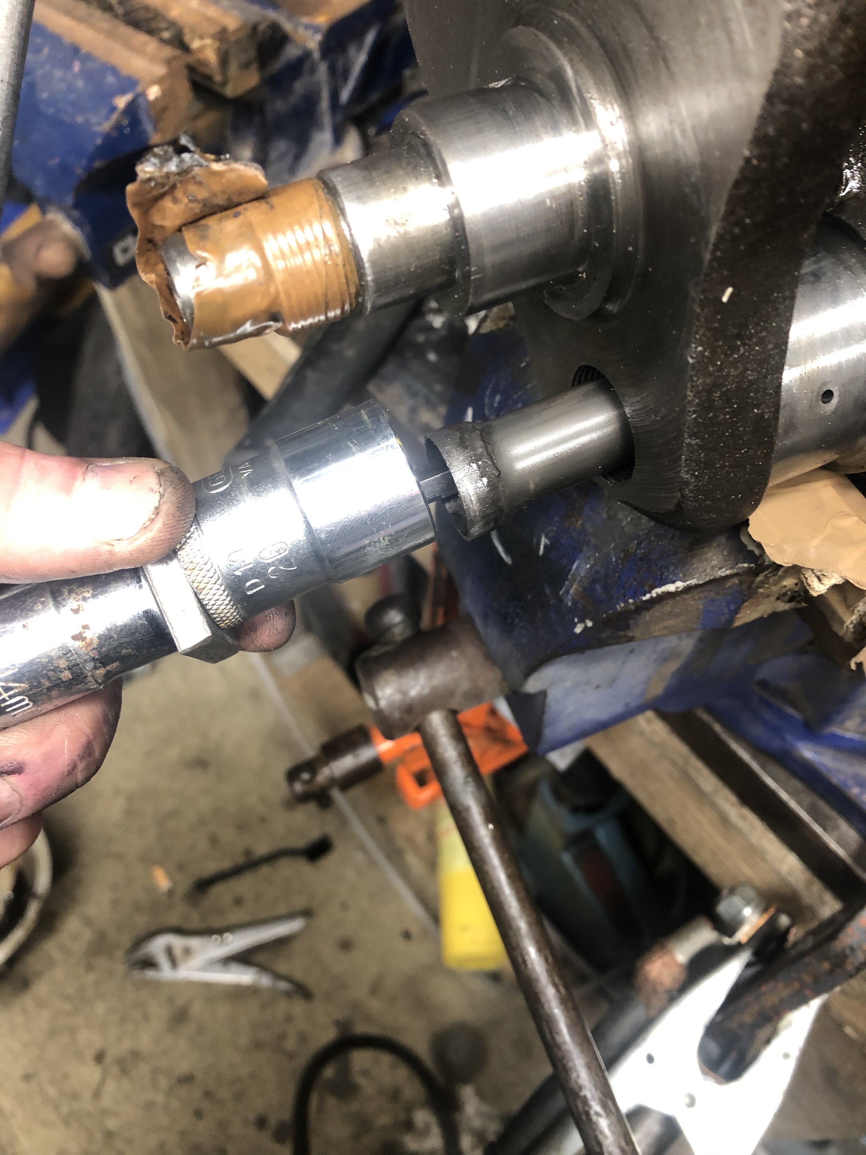

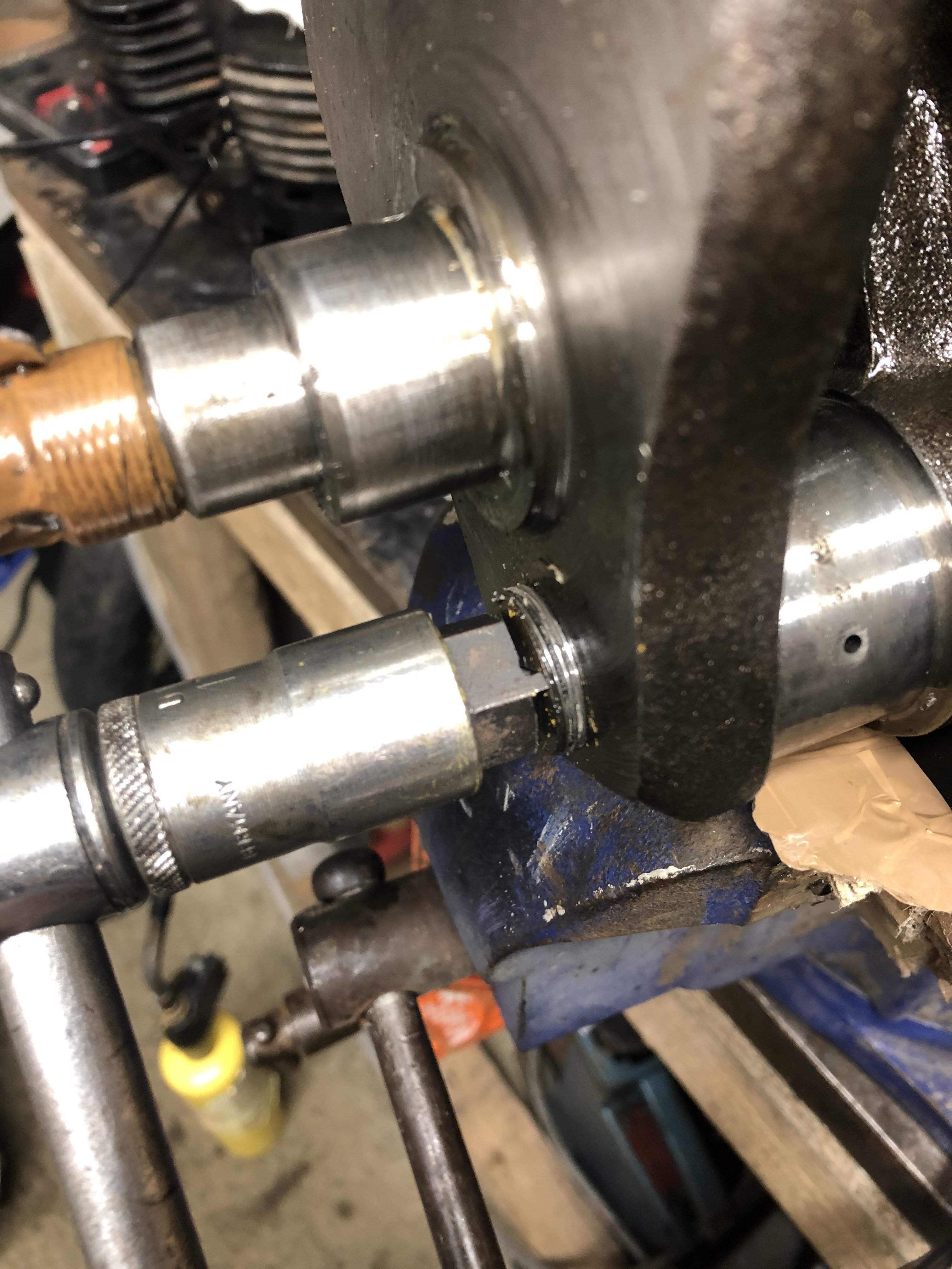

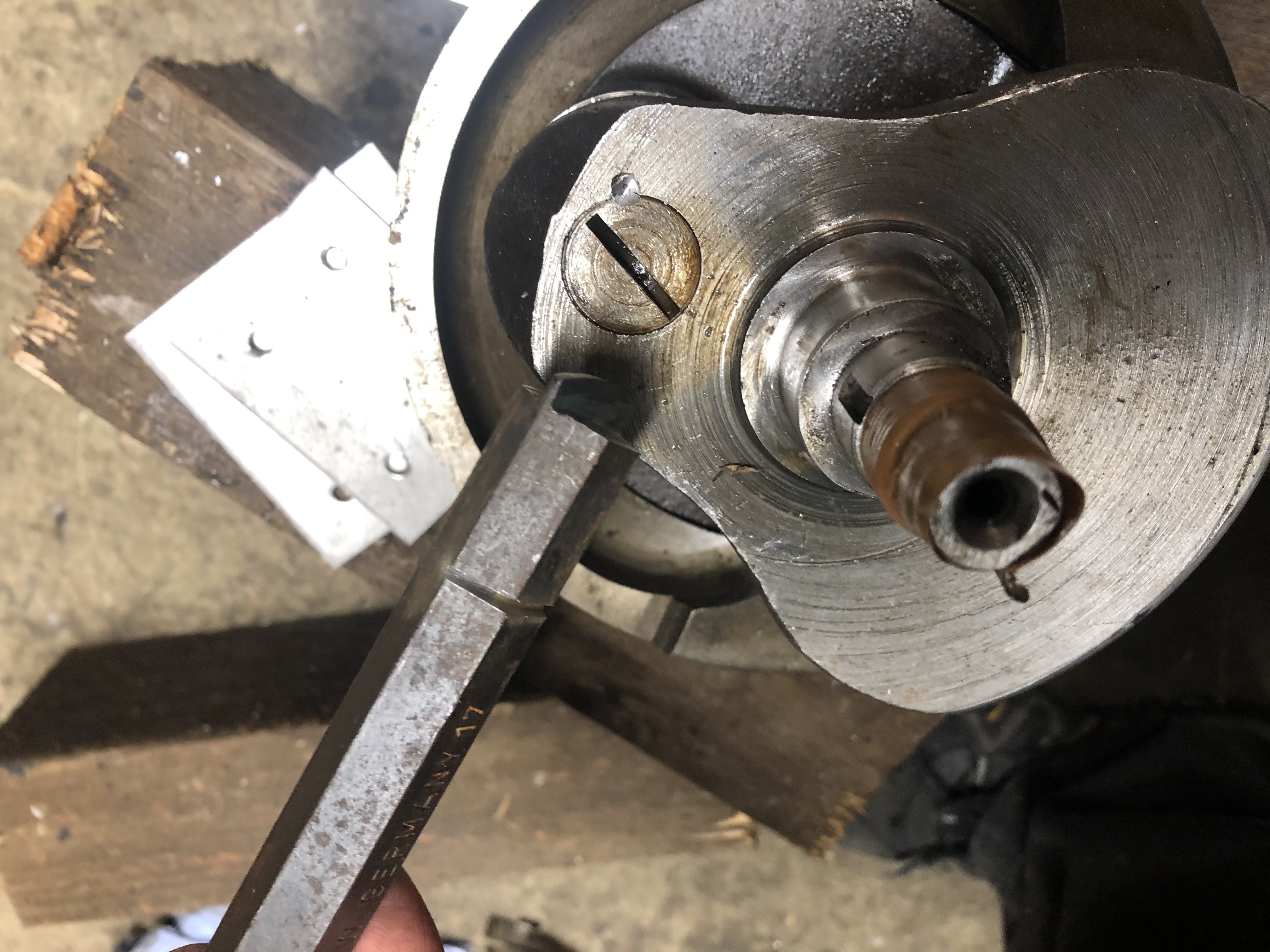

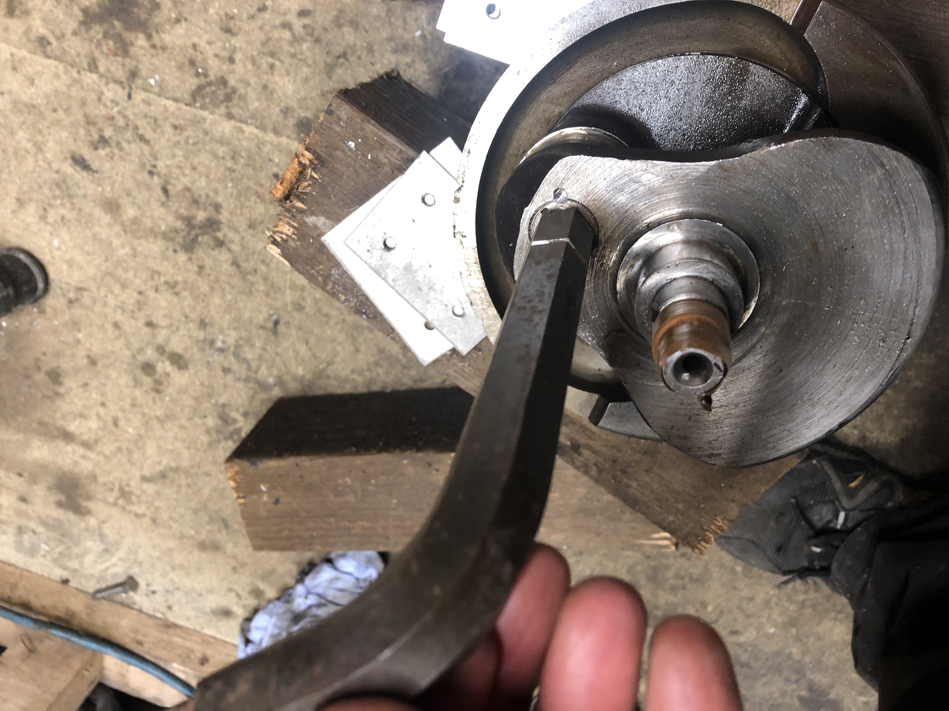

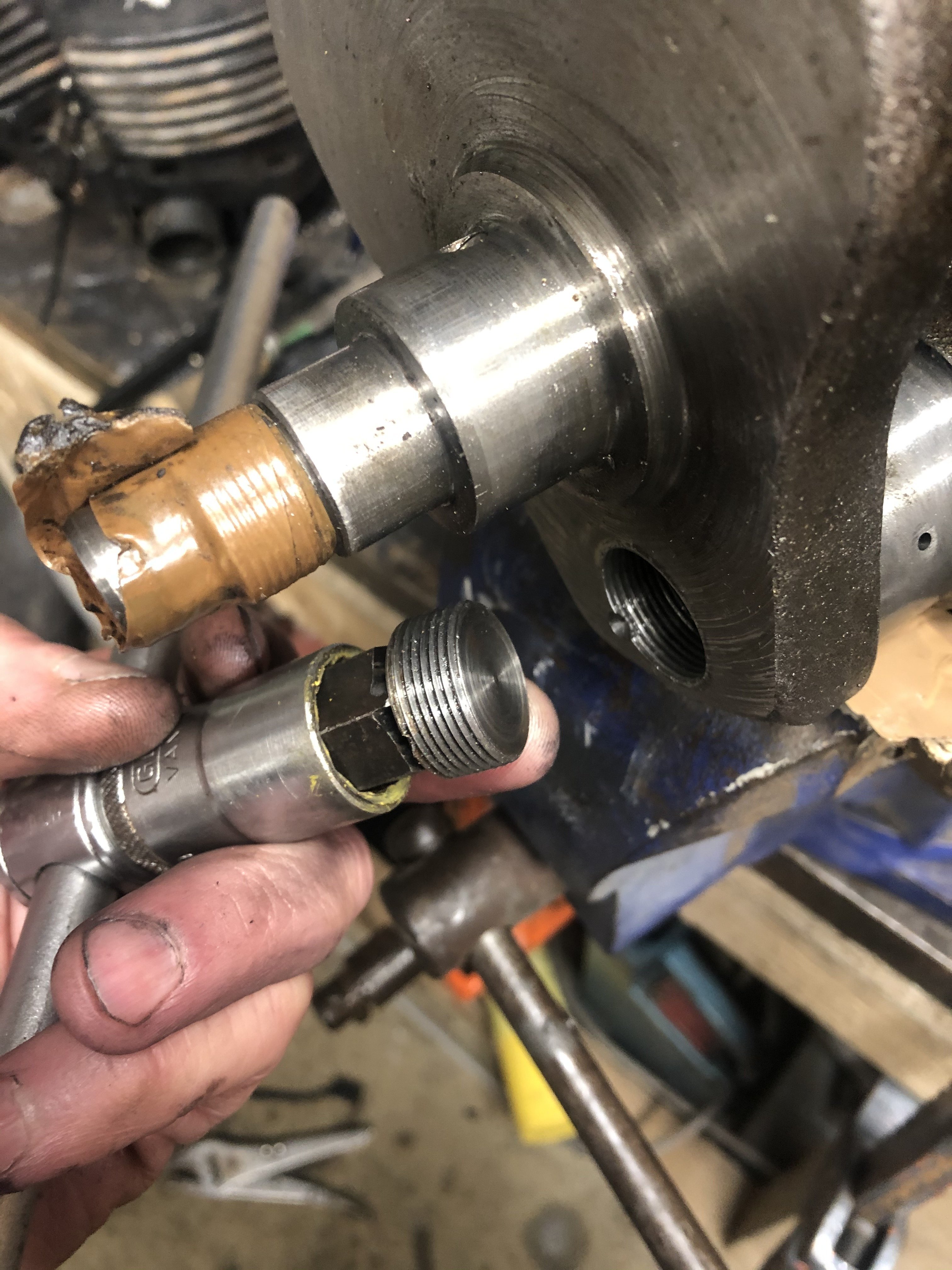

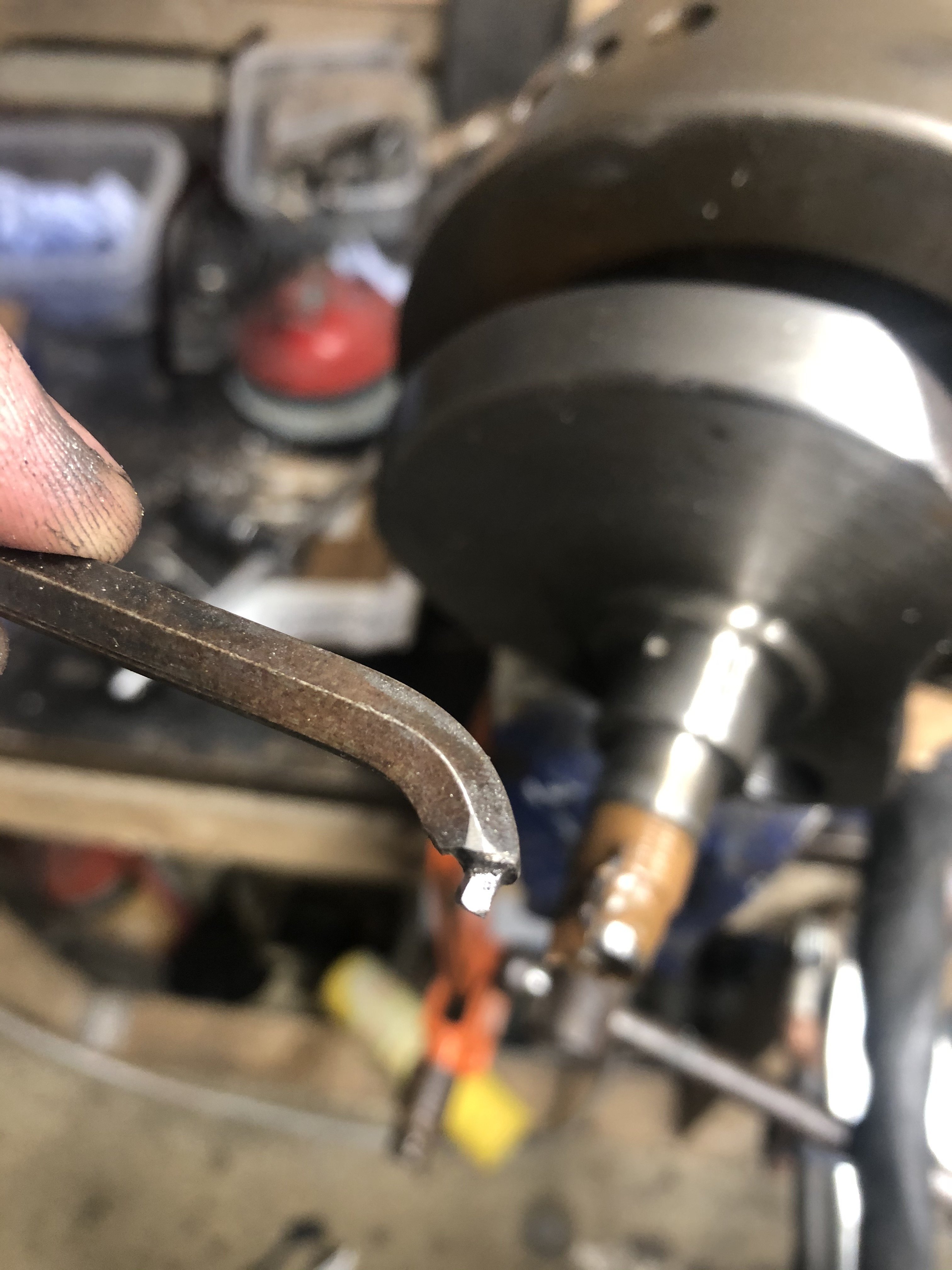

    A bit more scrap heap challenging to get the sludge trap plug cap out. I managed to find a 17 mm Allen key chucked in to bottom of a tool box an with a little bit of help from an angle grinder Voila sludge plug tool.

    Plug out - hooray, is there much muck in there? Another challenge getting the tube out. I've got a piece of steel with a shallow hook that I wedge into the central bolt hole - then hit an attached pair of mole grips sharply with a hammer. It's always worked so far. Some put a thread into the tube and then wack the inserted bolt.

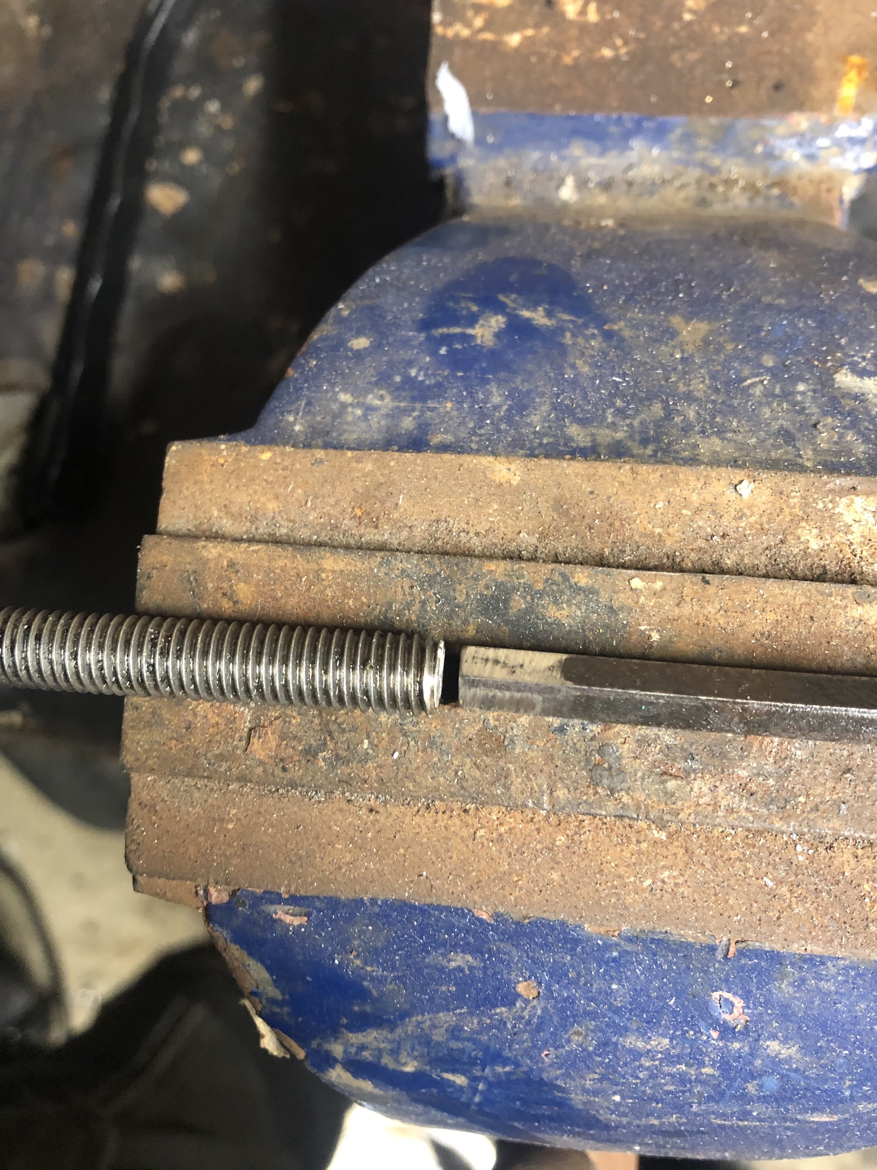

  10. darkman
    7,658

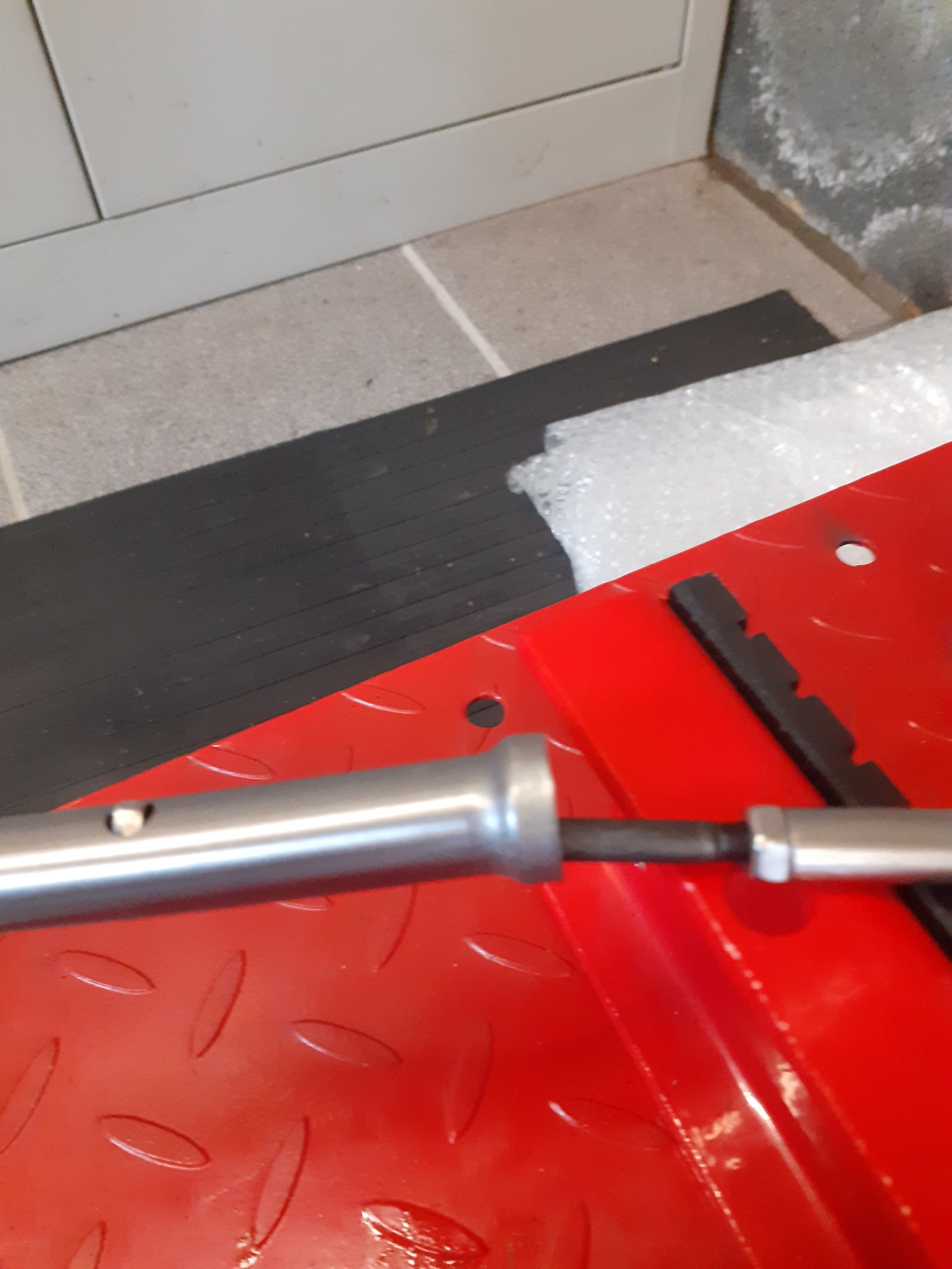

    Best way to do it :) my homemade slide tool.

    Sorry having trouble uploading photos these should have been with my last post
  12. Jim Hargreaves
    Thanks for the tip I’ll see what I’ve got knocking about to make some kind of version of your tool.

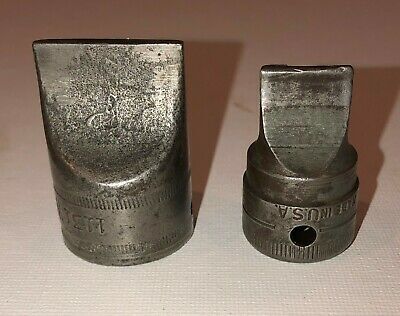

  14. darkman
    7,658
    More ingenuity :) Draglink sockets are the way to go, have been using them for years with the trusty airgun :)

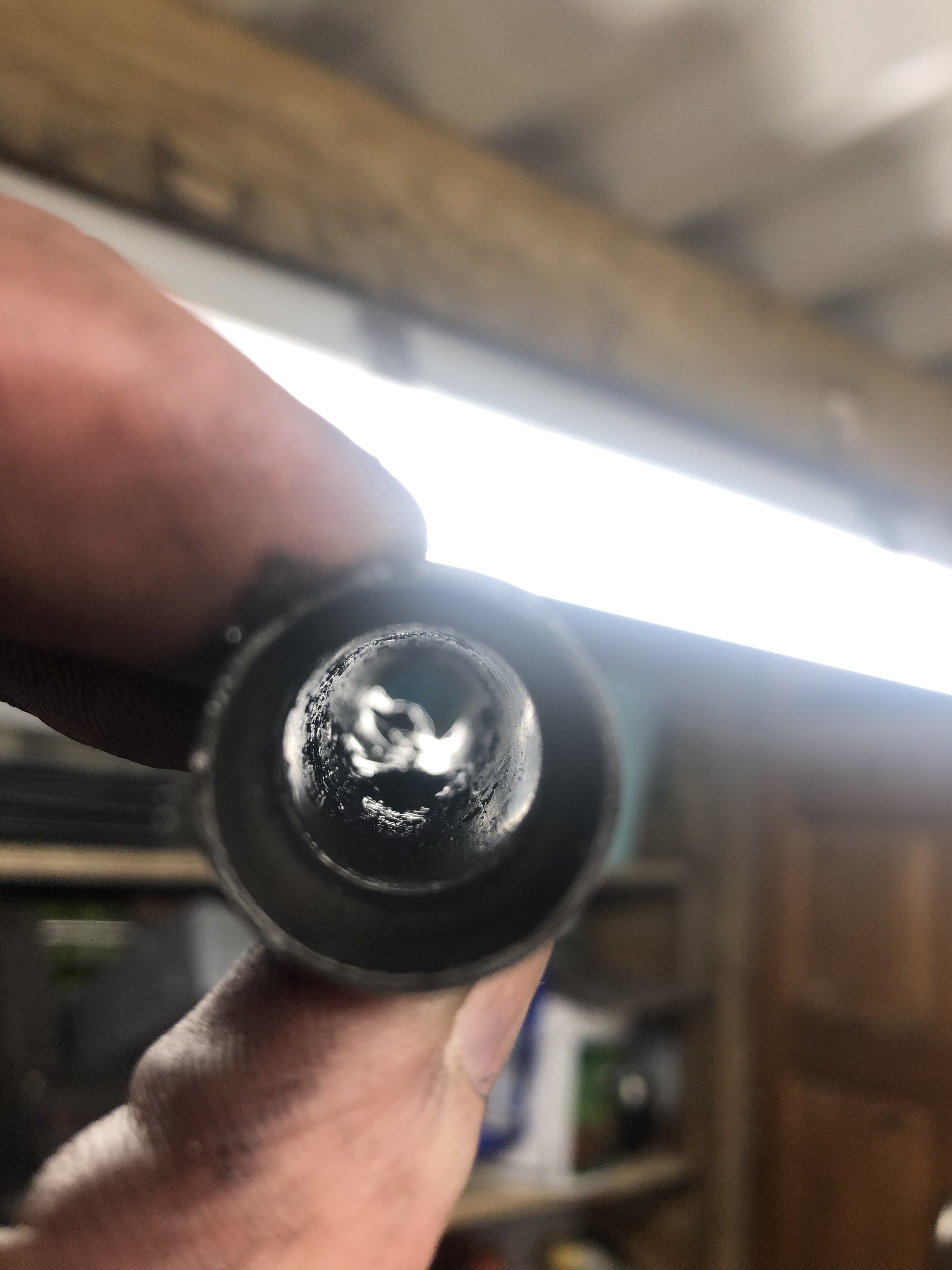

  19. Jim Hargreaves

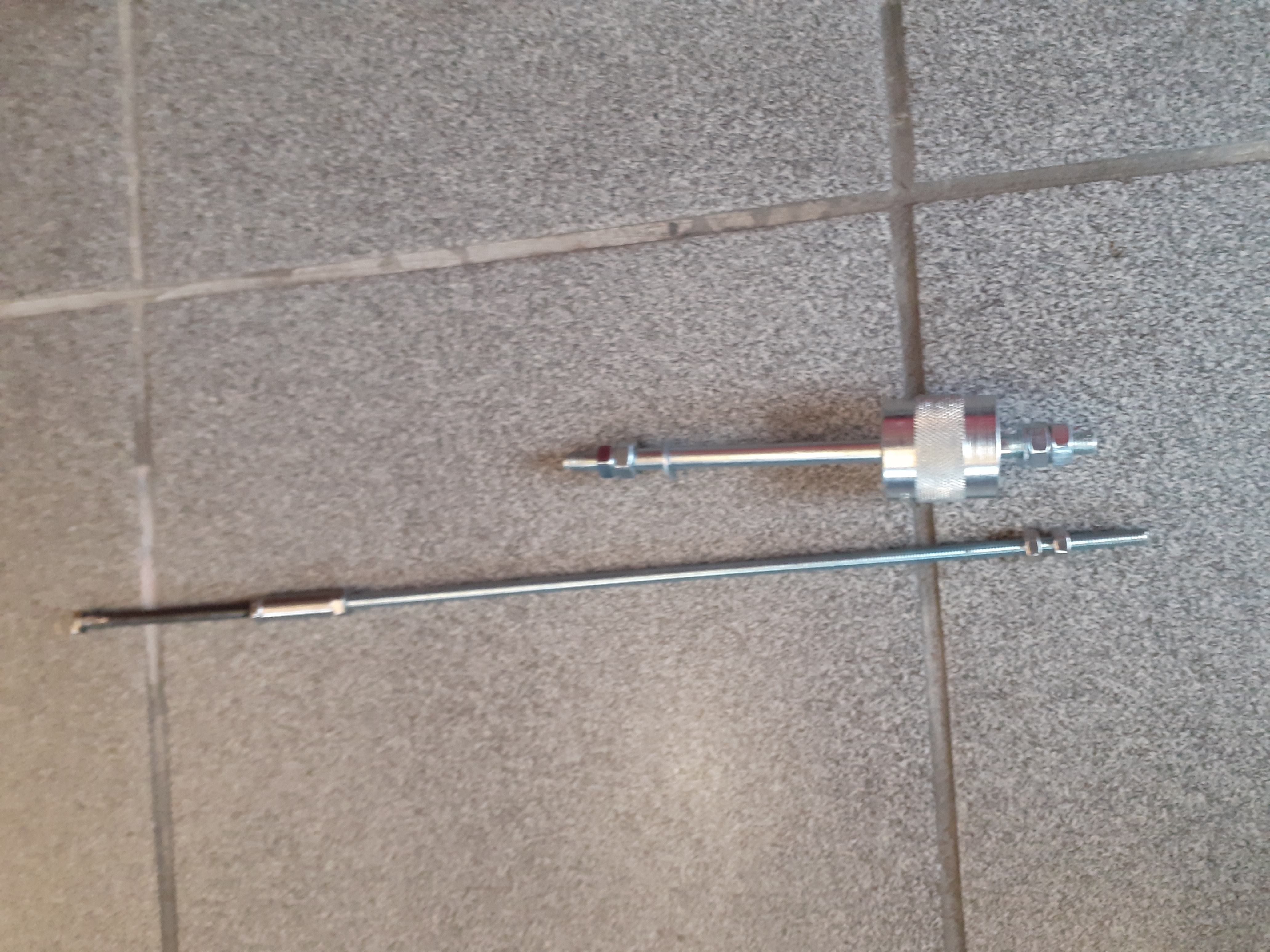

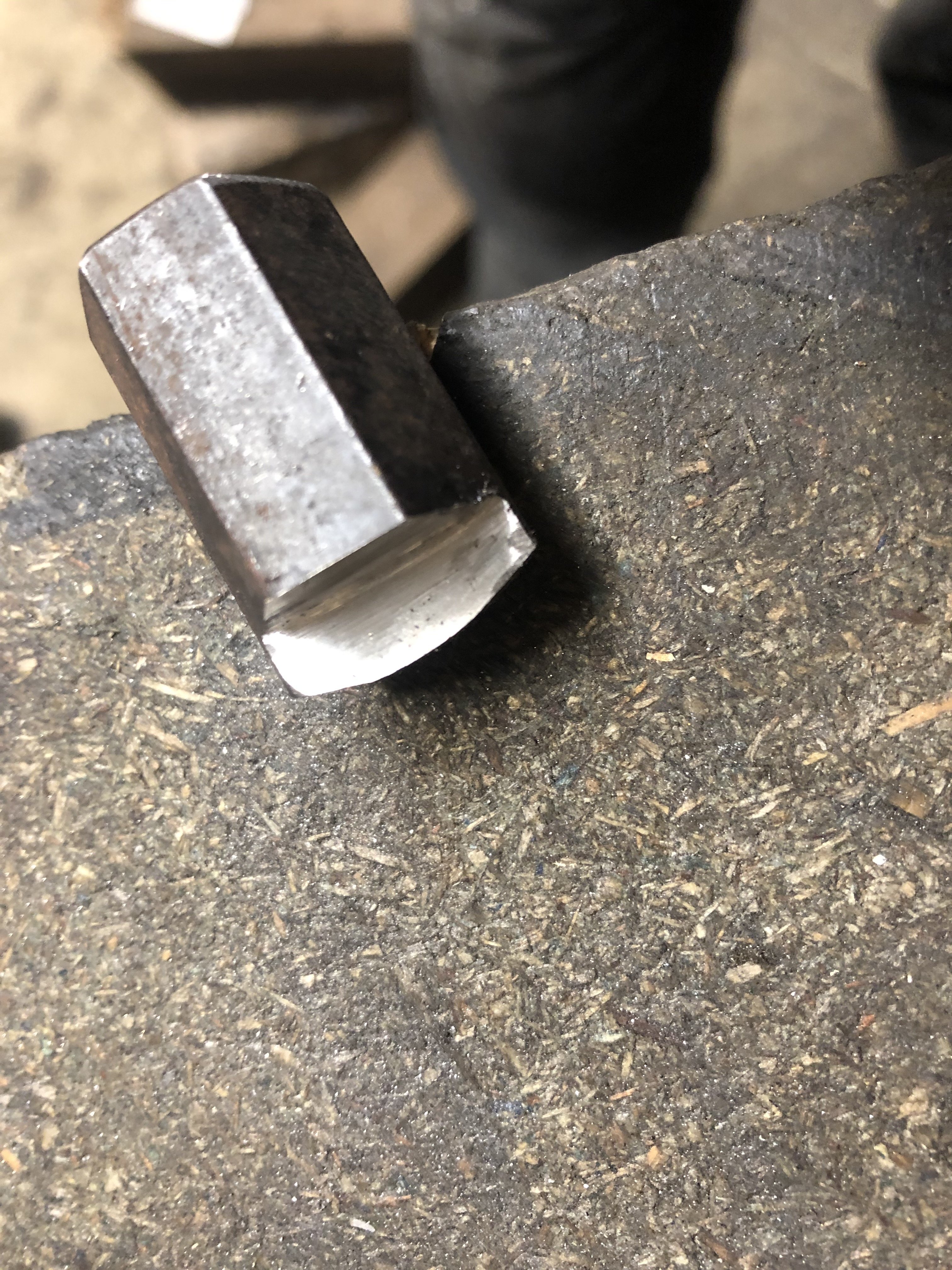

    Sludge trap is out. After all the hassle of getting it out it was virtually empty just half a peanuts worth at the entrance and a couple of small lumps at the end but at least I know it’s empty now. No wondering if I’m damaging the engine or if the oil is circulating so I’m happy.
    Darkman I made a sludge tube puller it’s not quite as fancy as yours
  20. darkman
    7,658
    Excellent job :) doing it this way saves the tube.
