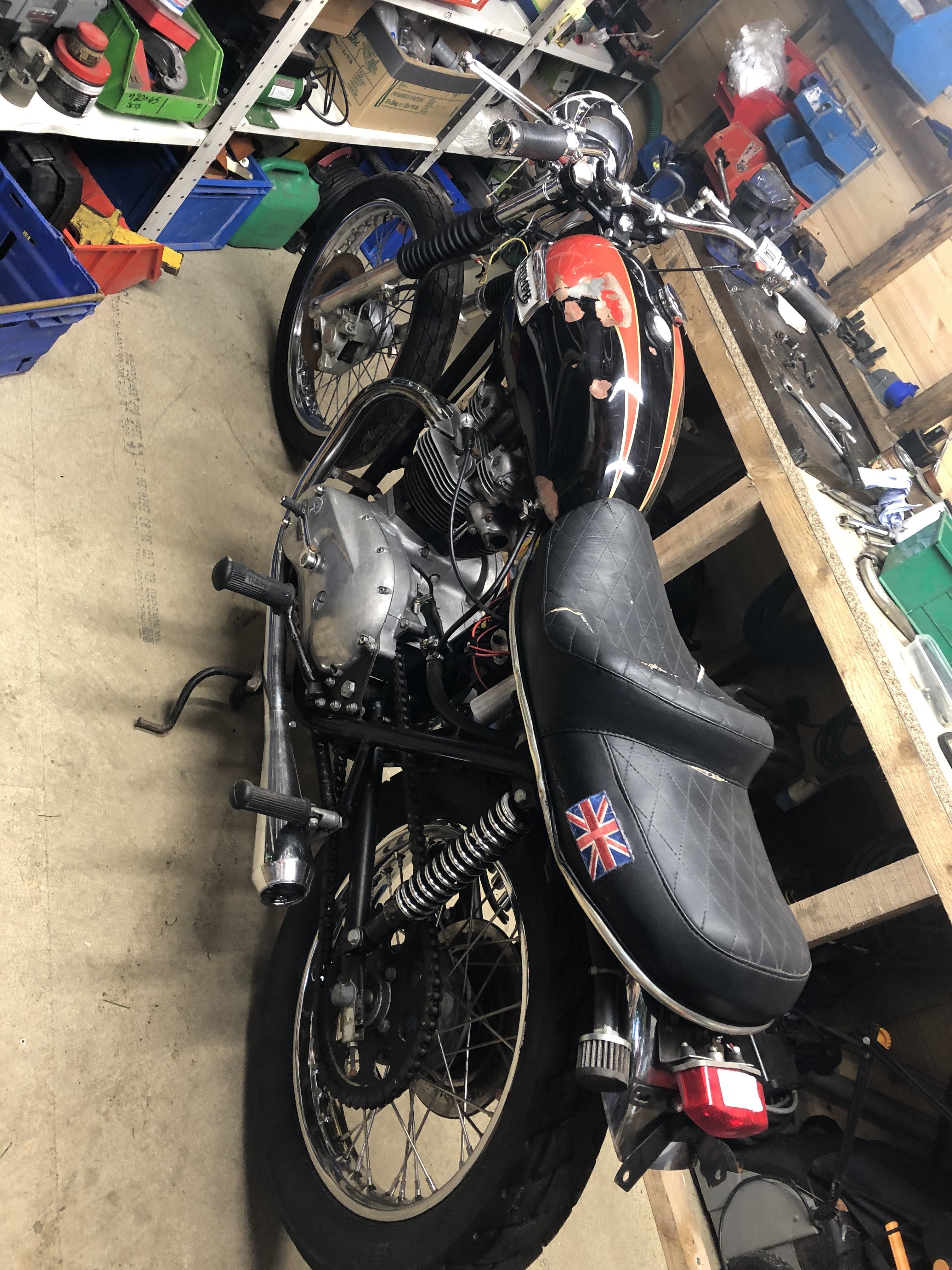

    Hi

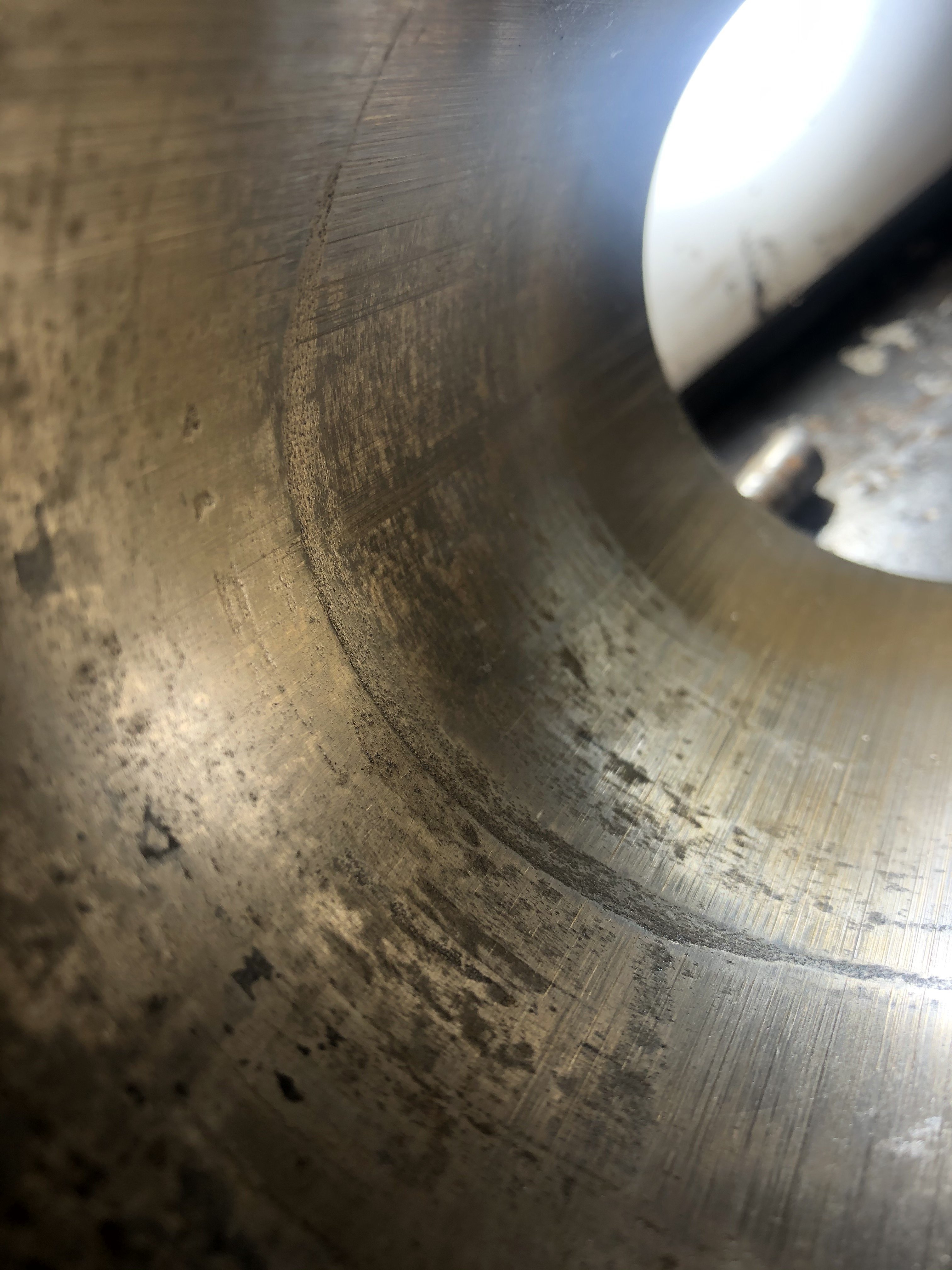

    I’m a few weeks into a rebuild. I’ve Just about got the frame stripped down so I can get it powder coated then I can start putting the bike back together. I’ve got bits and oil everywhere but feel it’s going ok but I could do with some advice on having the cylinders rebored they seem to have some rings of corrosion half way down I’m assuming it’s where the rings have sat for decades, I think it’s a standard bore the pistons haven’t got any + identification on them but I’ve got no way of measuring them. I’ve put a couple of photos of the barrels in the pictures.

    Jim
    My advice would be to get new barrels complete with new pistons and rings. It saves all the fannying around trying to find an engineering firm close enough, not too busy (nearest here has about a month waiting list) and know how to do it properly. My last barrels came from Brit Bits - great service, pretty good casting and fit was perfect.

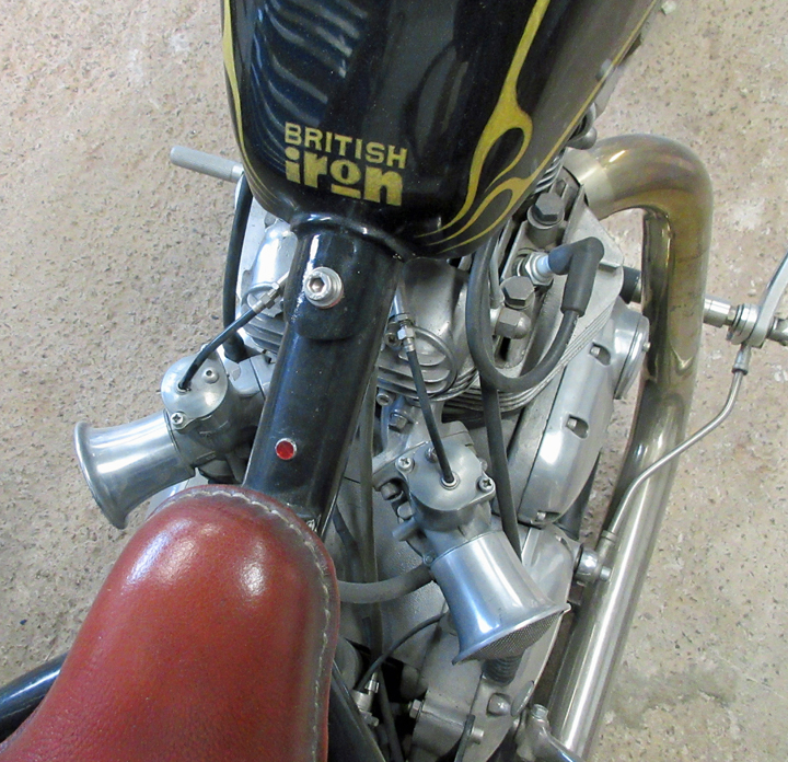

    I've got one of those Bonny engines with a single carb head, it was the thing to do in days gone by - easier to tune and less fuel apparently. I like the twin carbs though so have converted back to two carbs using ported webco castings. The carbs stick out more as the angle is greater - looks a bit weird but it's on the chop so that's ok then.

    There are two options Jim, re bore and new pistons and rings if you have a trusted engineer, £200.00 ish or New barrels pistons and rings for £400.00 inc from L F Harris :)

  6. Jim Hargreaves
    Jim Hargreaves Well-Known Member
    Thanks for the reply darkman I think the way this bike is hoovering up cash it will have to be the cheaper option a rebore
  7. darkman
    7,658
    L F Harris are the best bet at 80.00 plus vat and they do a good range of sizes :)

  12. Iron
    Iron Guest
    If you want to go with the webco castings to get those twin carbs back on (rather than replacing the head) - here's what they look like. A bit sticky outie.
