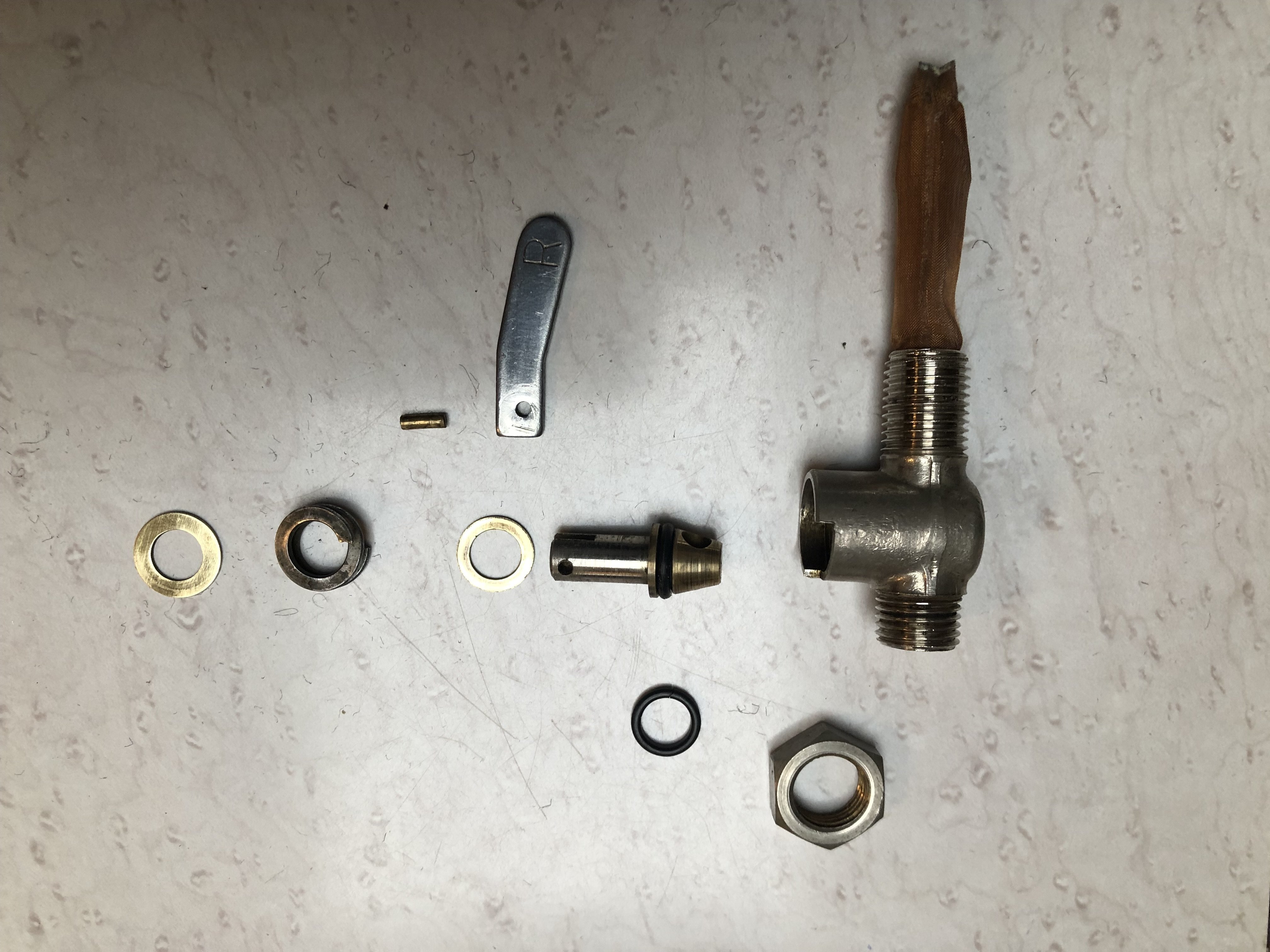

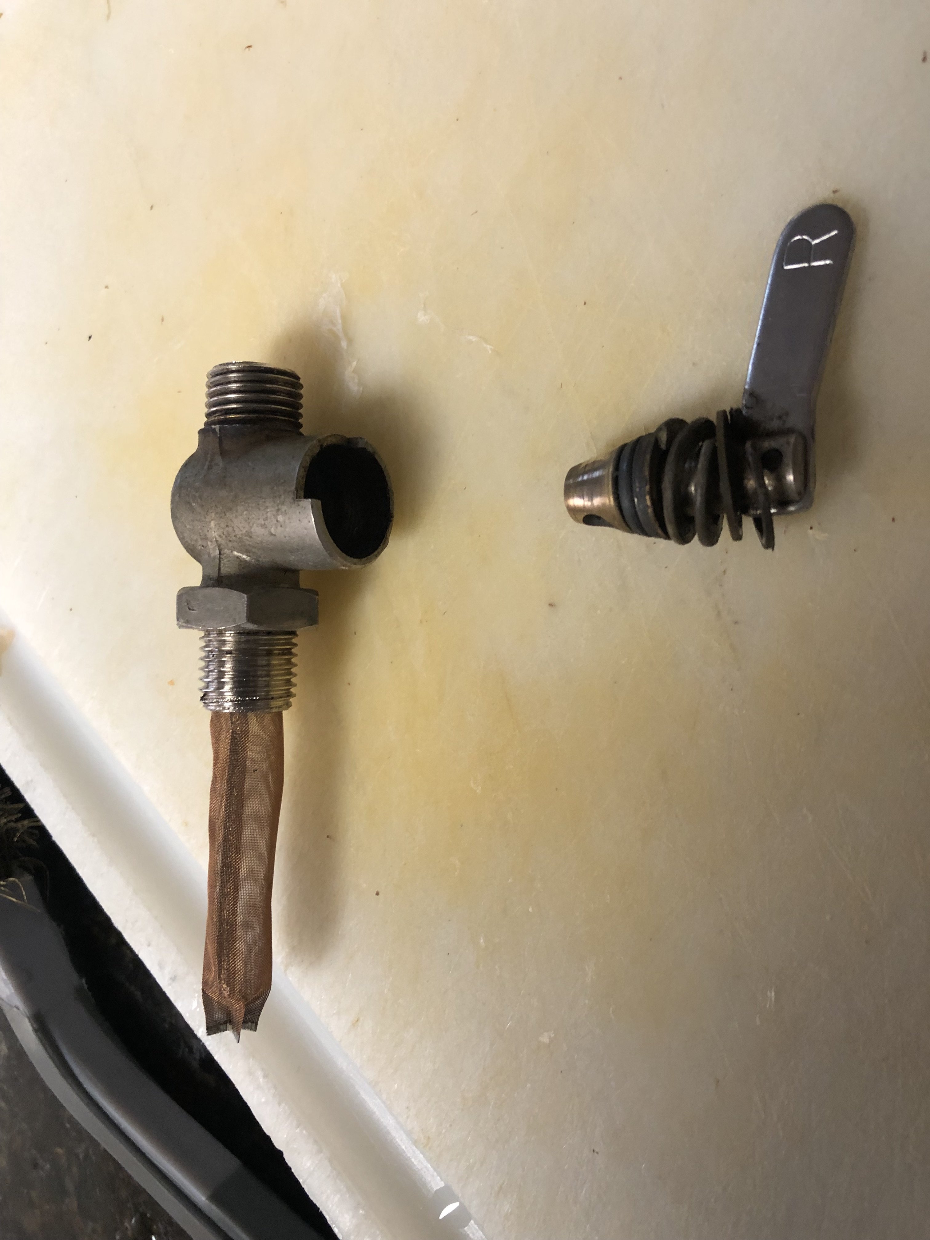

    I decided to redo the fuel lines also and when examining found that the petcocks were leaking, that is when fully closed there was still some fuel coming through.
    I was hoping I could rebuild the petcocks also, as there seems to be a rubber washer inside the petcock that could be replaced. I haven't found anything on-line about rebuilding these so I am wondering if any of you have rebuilt your petcocks previously, and if so where did you find the new internal pieces?
    Thanks for your help!

    So I never found a rebuild kit for my peacocks. I went to ace hardware and found some o rings the same size as in these old petcocks - as the old ones were hard as a rock. It was relatively easy to disassemble the petcocks, clean them with 000 steel wool, replace the o ring and put back together. Now to test them for leaks.

    Are the o rings suitable for petrol? I believe some from hardware shops are for water and home use only.

    Good question. One I will need to find out. Thanks. Perhaps I should source them from an auto parts store.

    Ok, I’m pretty sure the o rings I used were for plumbing, so I’ve just ordered some Viton o rings in the same size. Thanks for catching this sprintdave!
