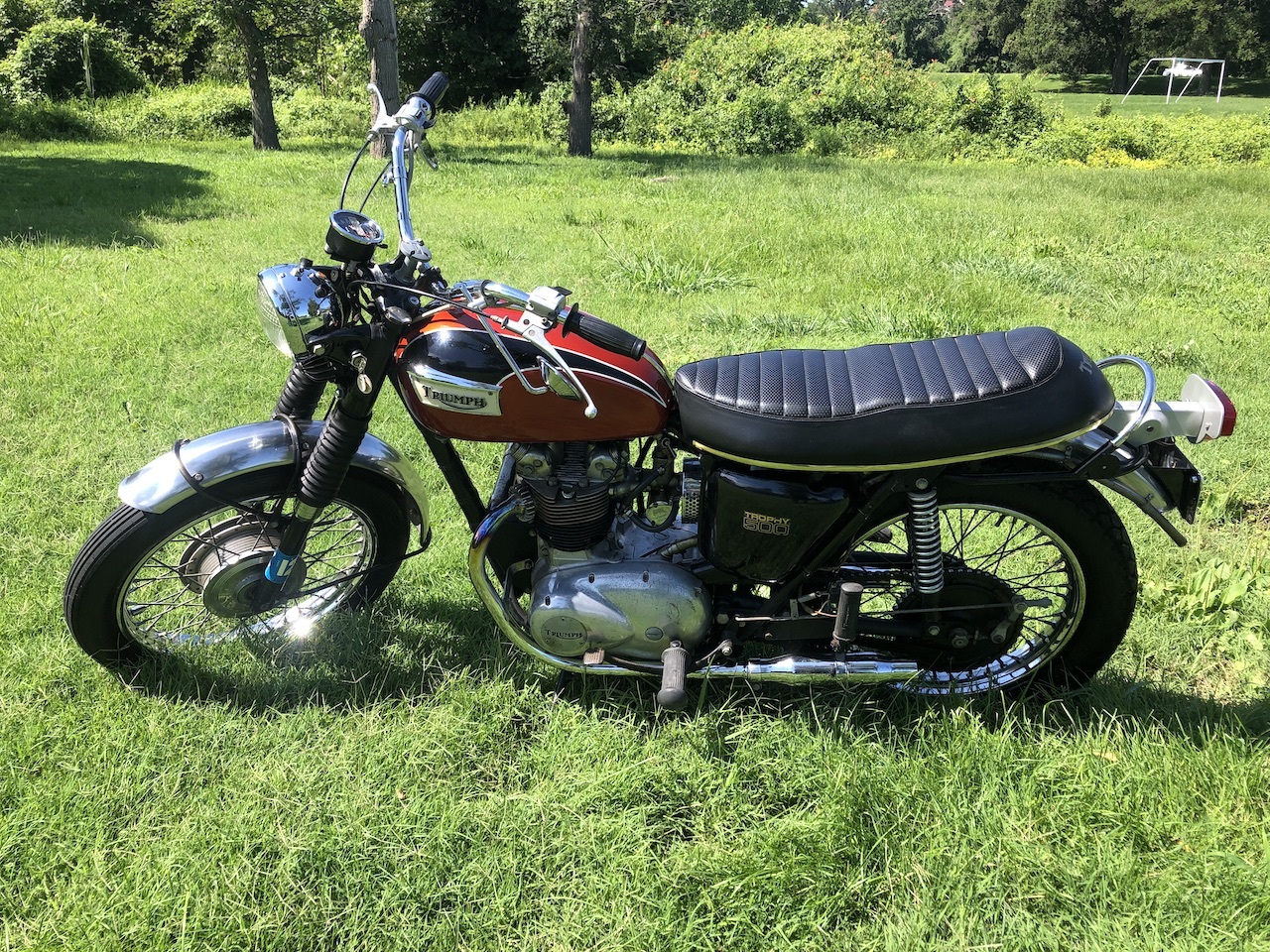

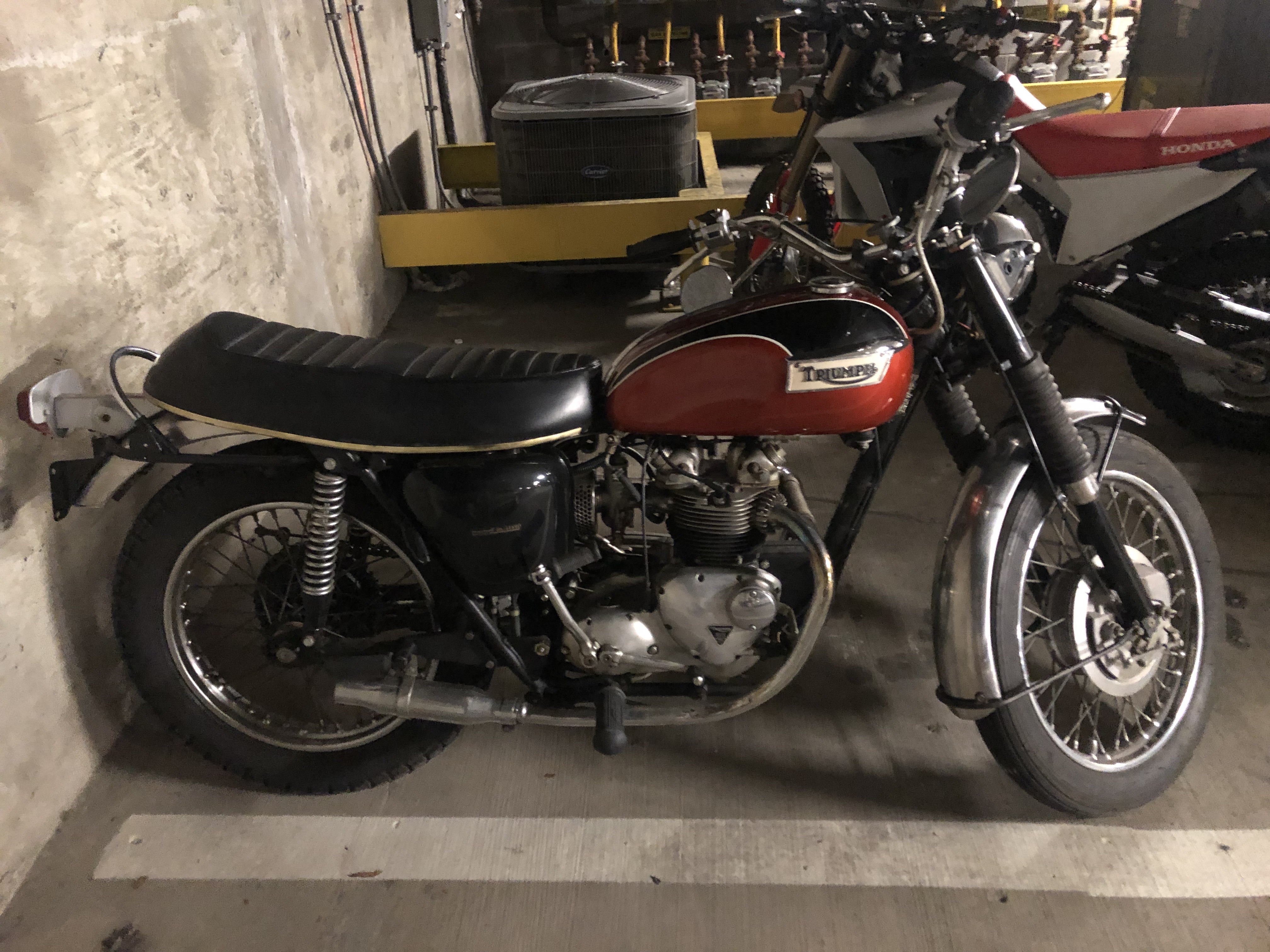

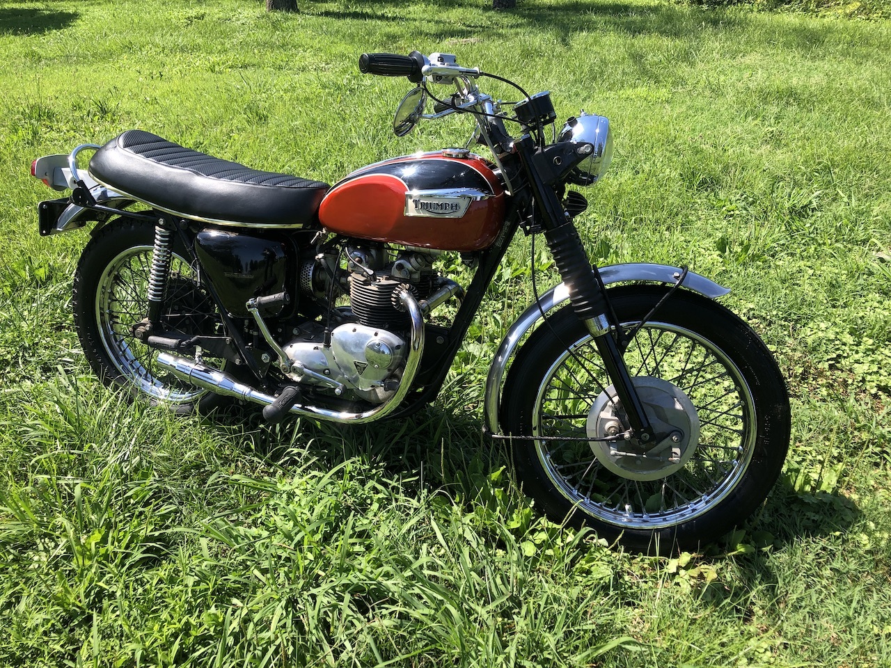

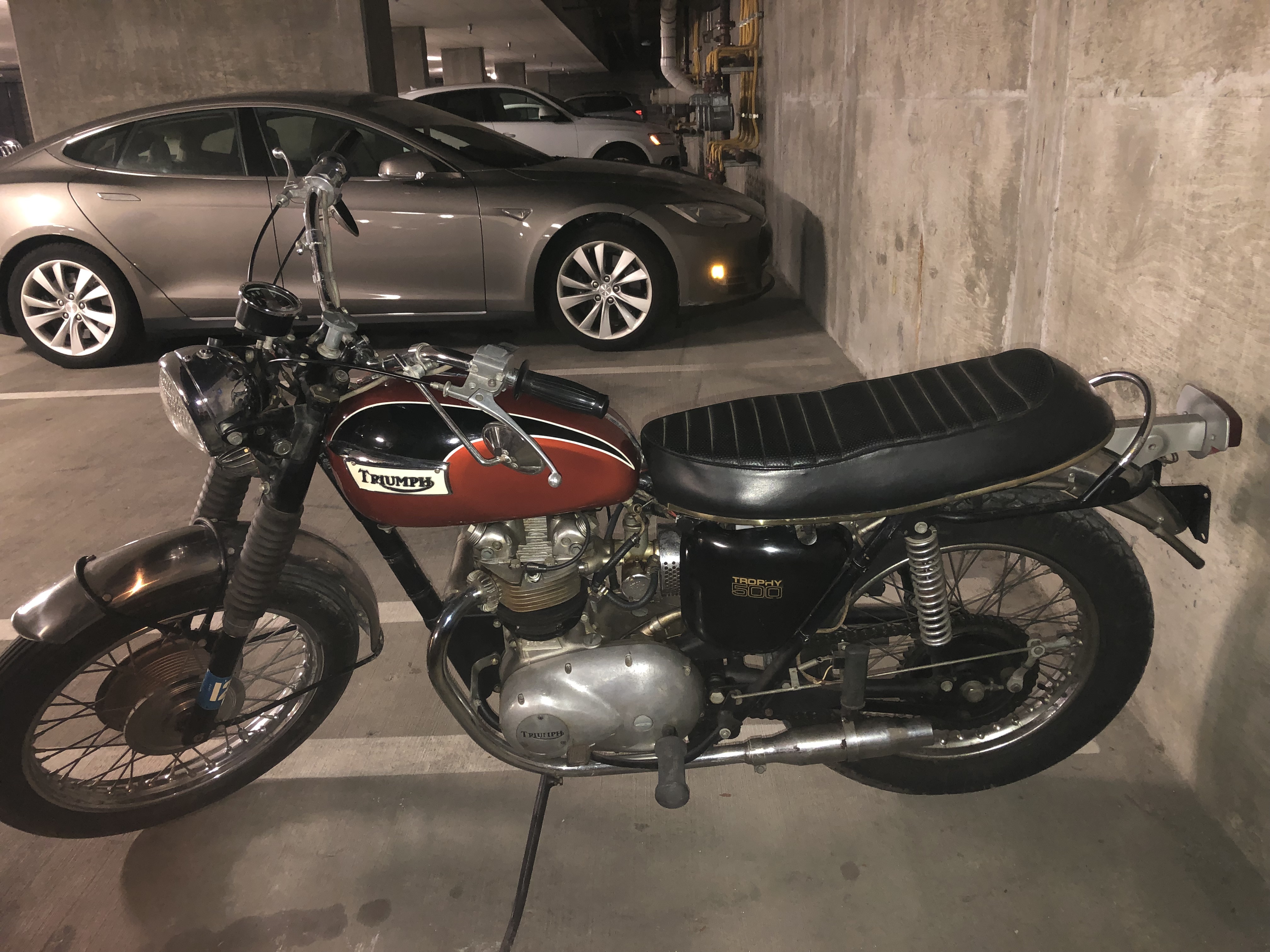

    1971 T100C Refresh
    I came upon this 1971 T100C in a serendipitous way. With a little coaxing, and the permission of the owner, I got it started and took it for a brief spin. It had been sitting for awhile in his outbuilding. It followed me home (on a trailer) so it is now mine, at least for a bit.
    There is an interesting back story to this bike that I am still discovering, but includes at least an association with the Pagans MC in the early 70’s.
    It seems to be original, except for a Boyer ignition (still have the original parts), the exhaust system (I thought these had high pipes), it is missing turn signals and side reflectors (if it had them?), and I’m not sure there is anything else different from original. With a bit of tinkering it started right up, shifted properly and idled mildly. Compared to my 750, I can see why these were/are desirable bikes, enough power and easy to ride.

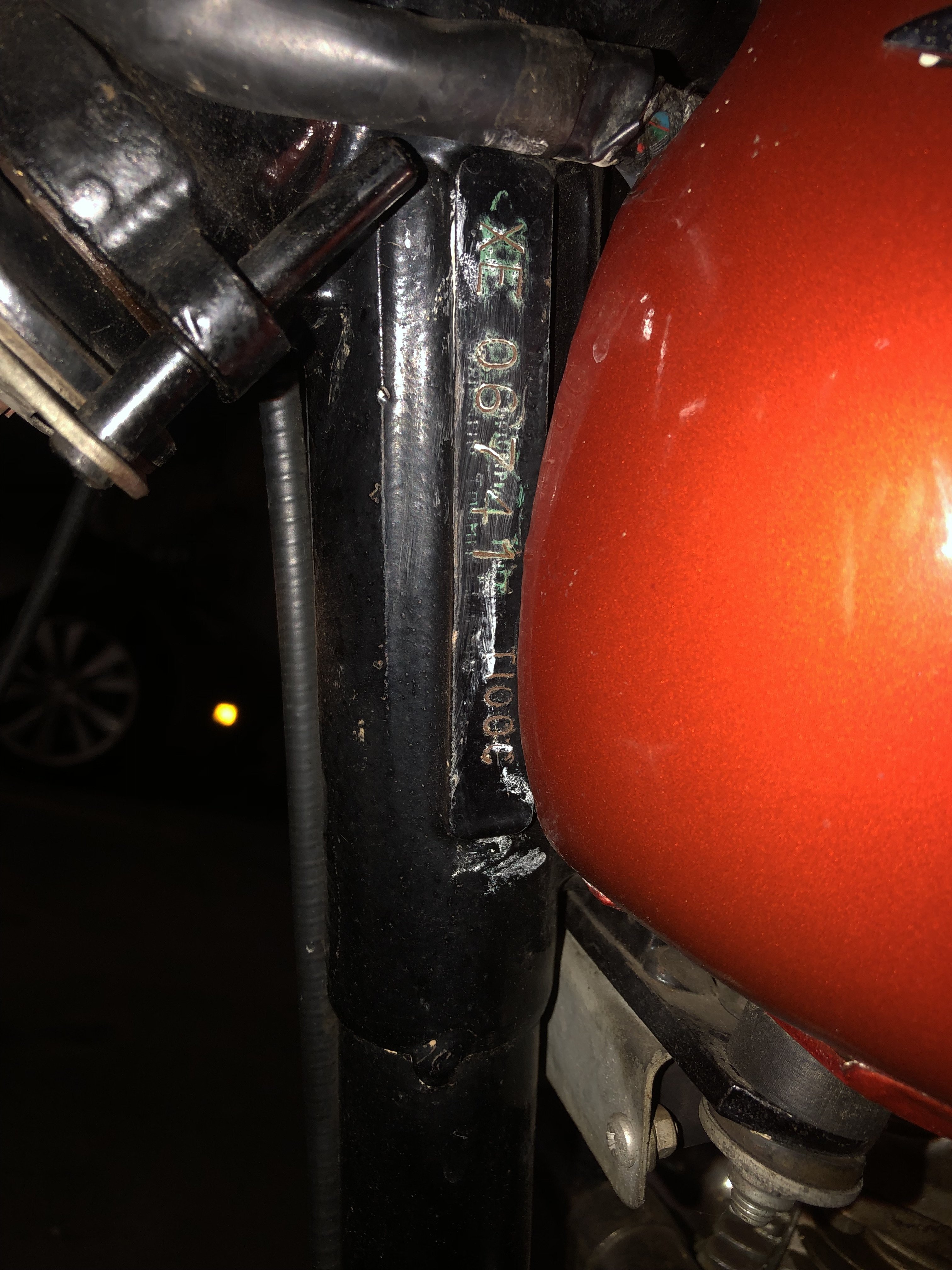

    Engine and frame numbers match: XE 06741 T100C
    I’d appreciate any information as you take a look at the photos about what seems to be original versus other on the bike. I’ll get some better photos up once I give it a wash and decide what to do with it. I think the tires are original too. Extremely low mileage. Thanks for any interest.

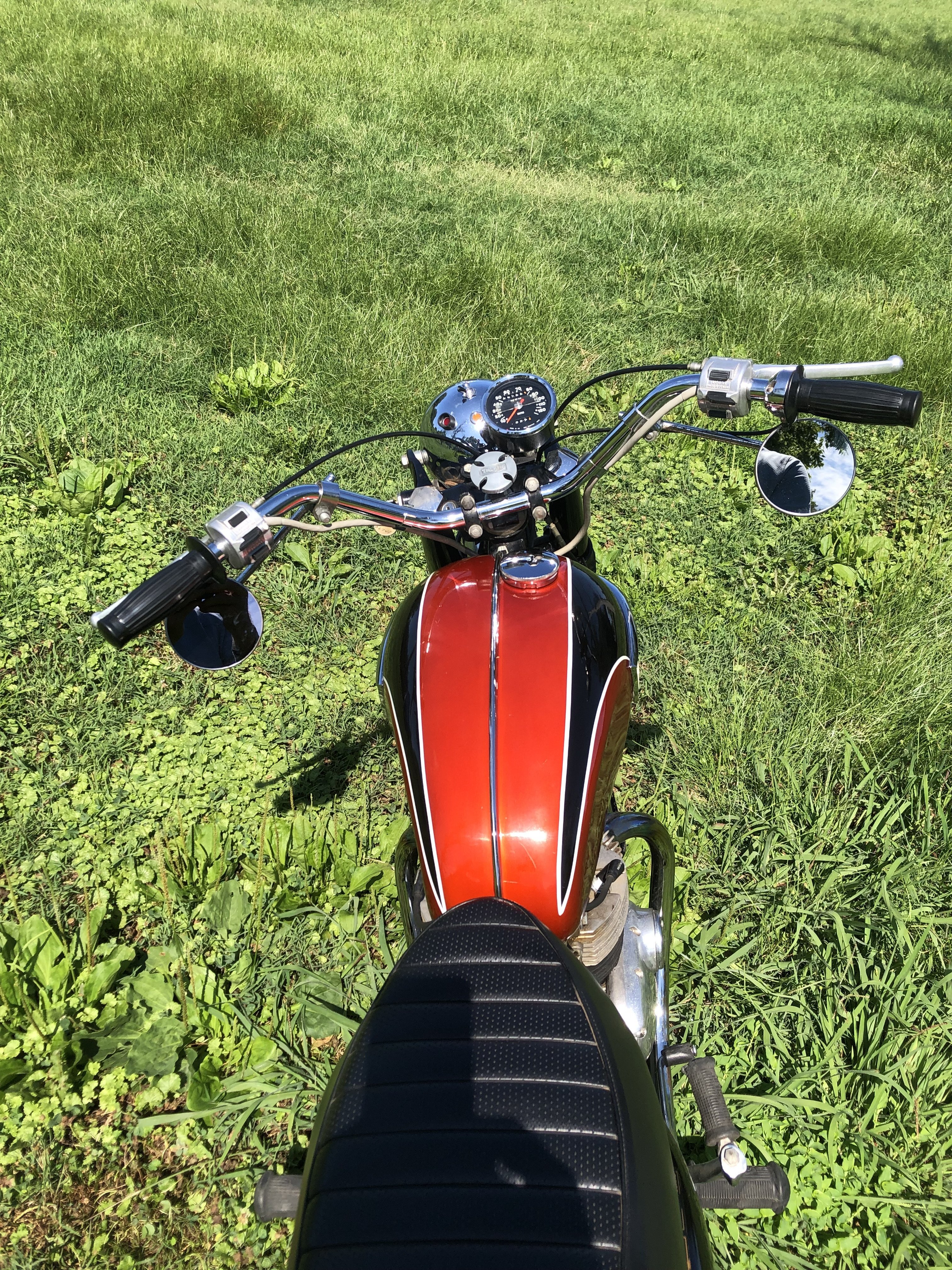

    good looking bike. im pretty sure all of them had turn signals 71-on. certainly your handlebar controls have the paddle for them. one is hi/lo headlamp, the other is turn. they mounted at the headlamp pivot and in the side holes in your tail assembly. two yellow reflectors went in the side holes of the grabrail.
    you have another monobloc. your machine would have had a concentric, but the motor does not care.
    the shorty mufflers are period 1970s. inexpensive alternatives when the stock ones rotted away.

    Speed, I have already been looking at Nortons, but this came by . . .
    So as a T100C would this originally had a concentric? Also, on the mufflers it seems the original ones would have been the high pipes on the left side? Do you know? Thanks.
  4. speedrattle
    speedrattle Senior Member
    Feb 19, 2021
    1,192
    appalachia usa
    1966 . . . or so . . . was the last year for the monoblocs. the concentrics were used exclusively from 67 on, i think, until the amal mk2s around . . . 1979. . . ?
    the concentric is not a better carb, they say.
    i dunno about the pipes. id have to look at the parts book, but certainly the T100Cs on the net appear either way.

    A few nice pictures here that will give you a good overview of how an original would (probably) have looked...........
    https://www.mecum.com/lots/LV0118-315578/1971-triumph-t100c/
    Yours has aftermarket rocker box caps - the Amal and the pipes have already been mentioned - but the rest (aside from those major differences) looks very good. Nice bike. :):)

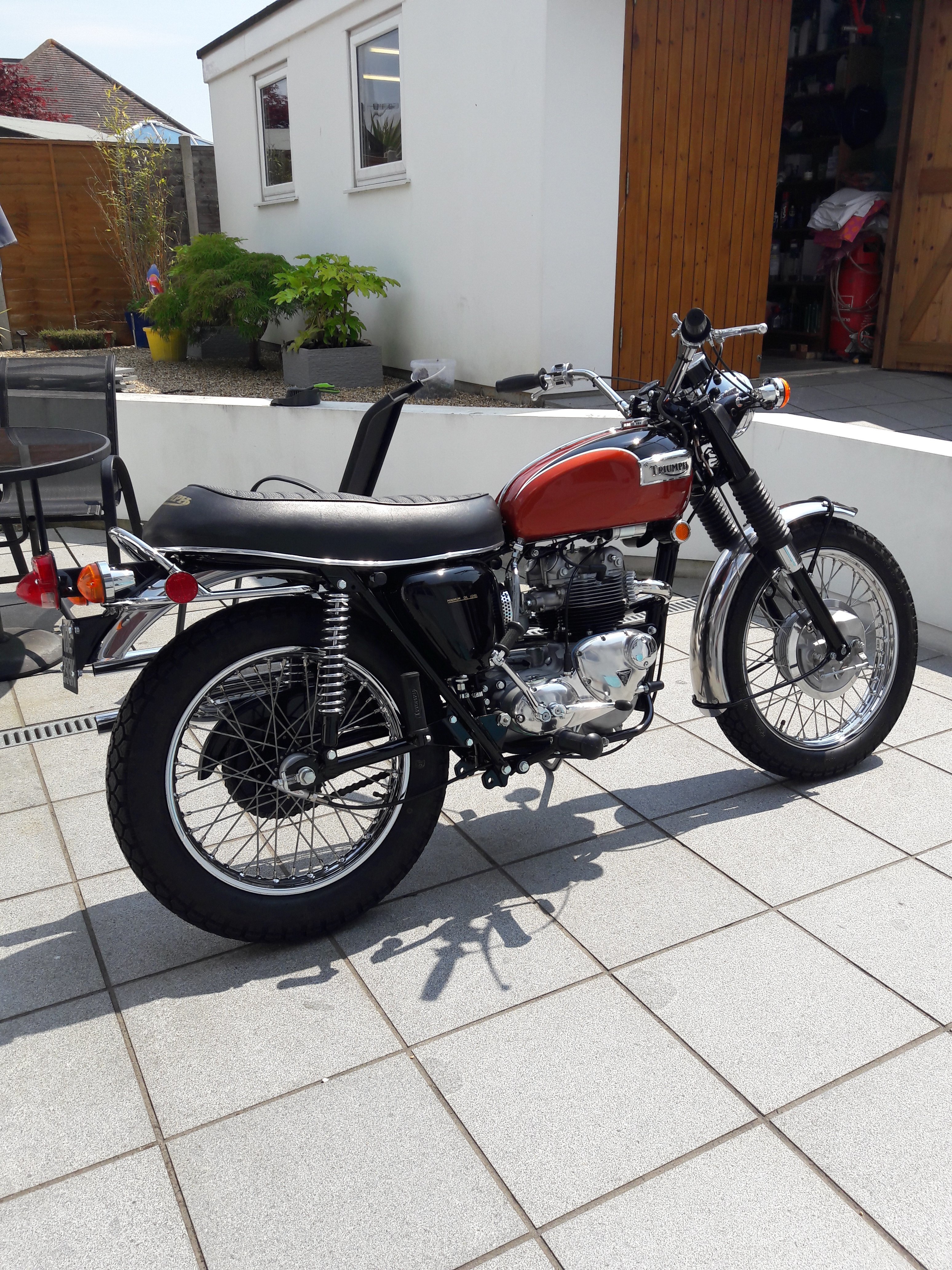

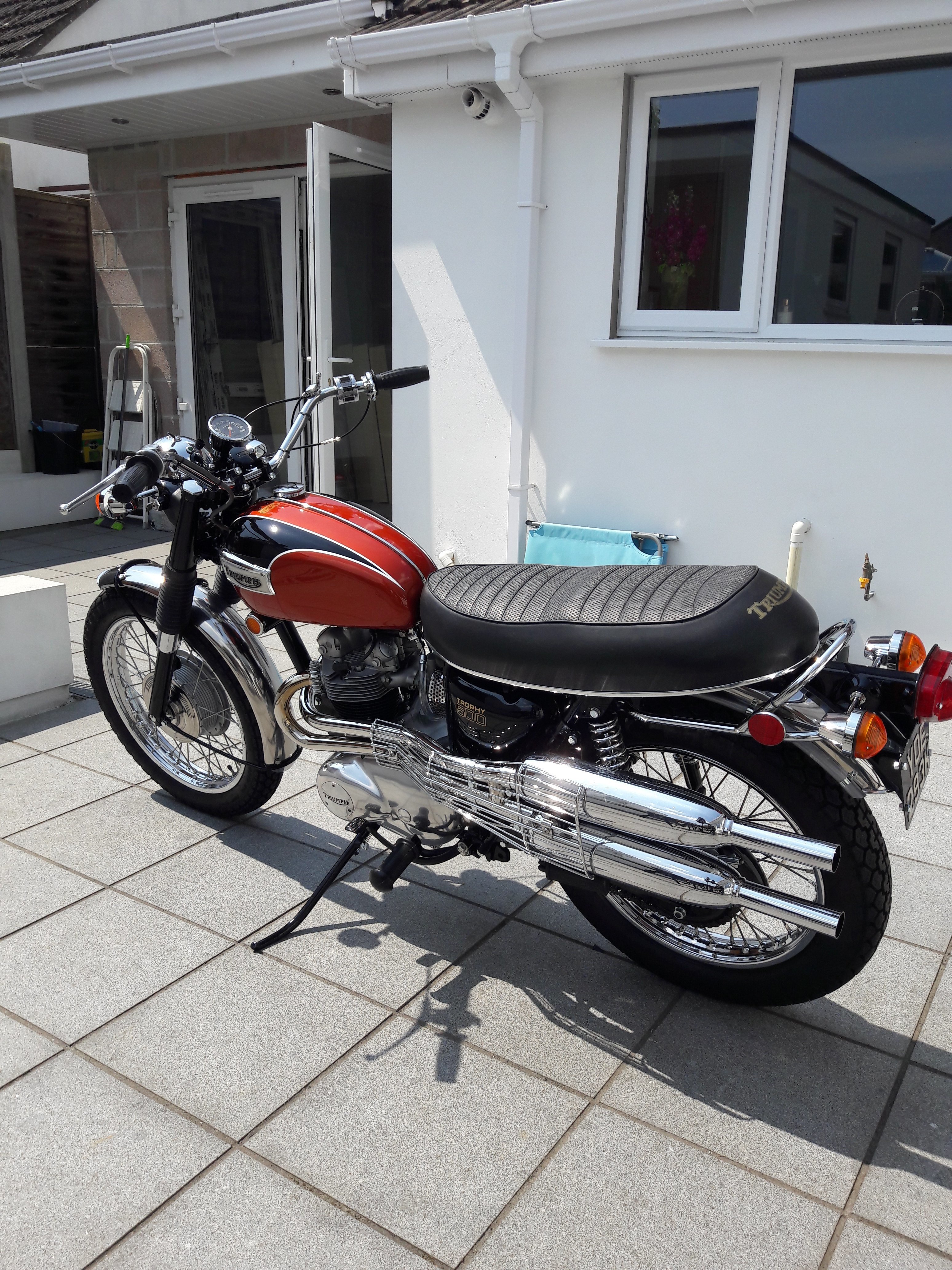

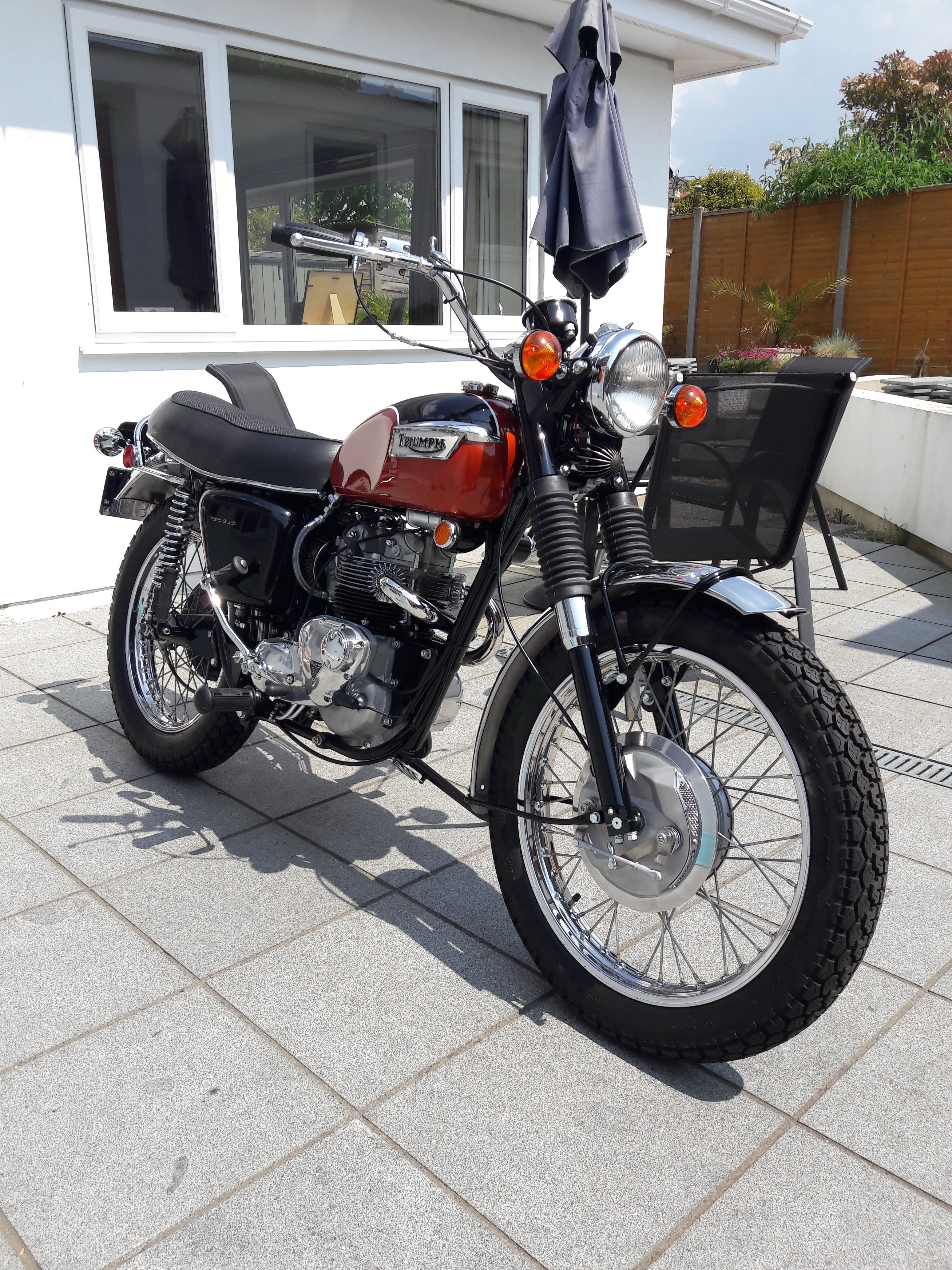

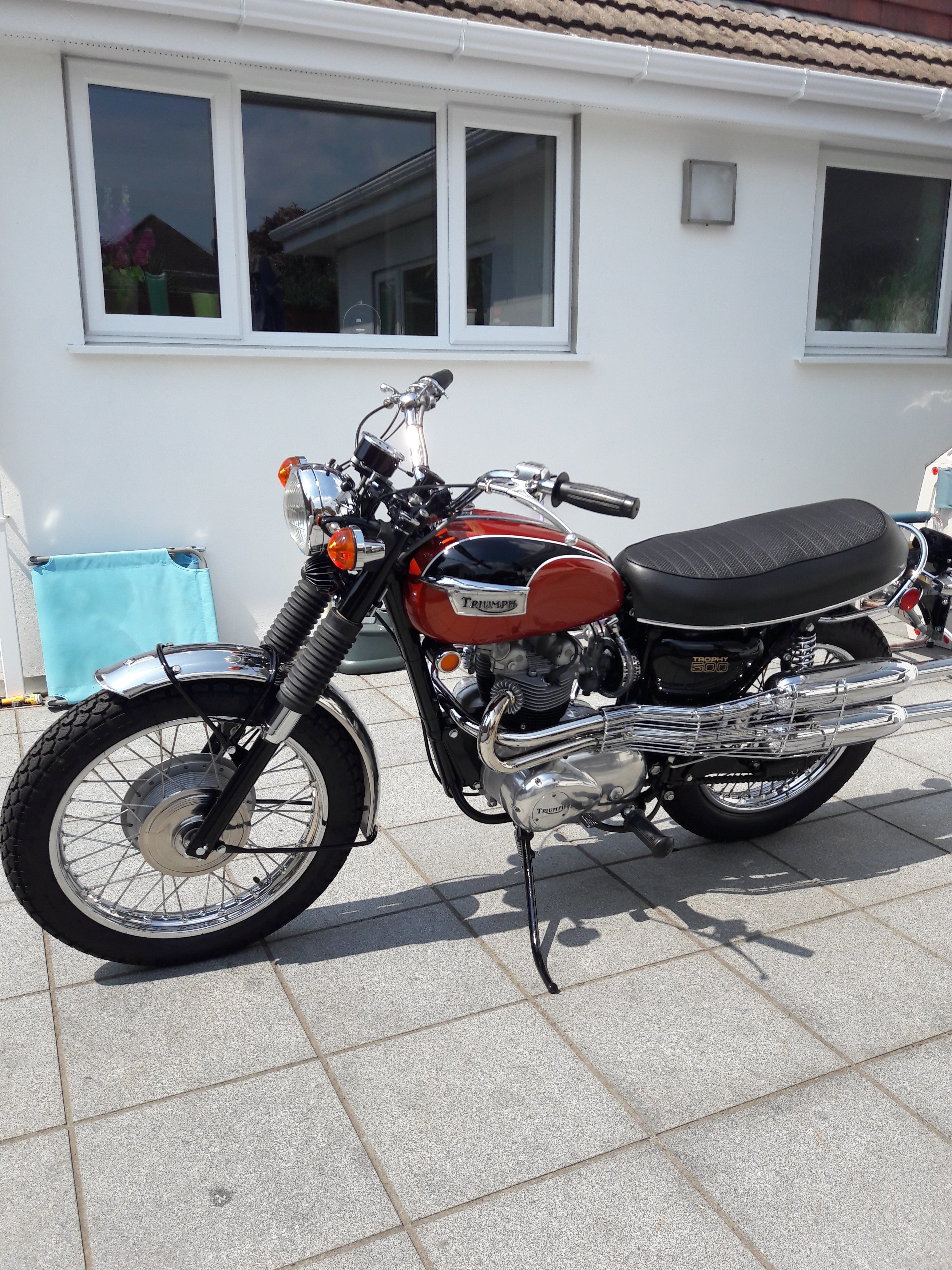

    Amazing find :) i would find some original high pipes and keep it as the chance of finding another clean original one is slim. some pics of Su's 71 C.

  12. darkman
    7,657
    But yours is original and with a little detailing would be amazing :)

    Ah, Sundance! You don't know the half of it ......
    @darkman takes a pile - often a very small pile - of rusted, dented, beaten and broken parts and magically creates a work of engineering art that any former Triumph Meriden employee would be proud to see and touch! His restorations are pinpoint accurate and would make the Mecum bike owner cringe with embarrasment and jealousy.
    What's more, he then rides them ....... hard!
    Some people, huh? :rolleyes:

    OK, ok. So this is a darkman restoration? Well, amazing and gorgeous again. I am a bit new to this "game" so forgive my ignorance. So, then, the bike I have - assuming it is mostly original, and in pretty good shape, ridable, etc., is a good thing! It seems then it'd be most favorable to not disturb it too much as long as it runs nicely and is safe. Then, perhaps, find a few pieces that might bring it into a more original formulation. On that line, I was looking into the parts book on this and it seems that the type of air filter I have on this one, is round, and is not an import type (to the USA that is). Similarly my bike has an 18 inch rear wheel and 19 inch front. The Haynes owner's workshop manual shows the T100R has 2 18 inch wheels, the T100C (East Coast models only) has 2 19 inch wheels, the T100S has 2 18 inch wheels. So it is a bit confusing. Any comments on the wheels and air filters - thanks!

    18 rear 19 front wheels standard for your bike and round chrome filter as well. Wheel rims if original should have Dunlop, Made in England, WM2 19" MB11 and WM3 18" MB10 :)
