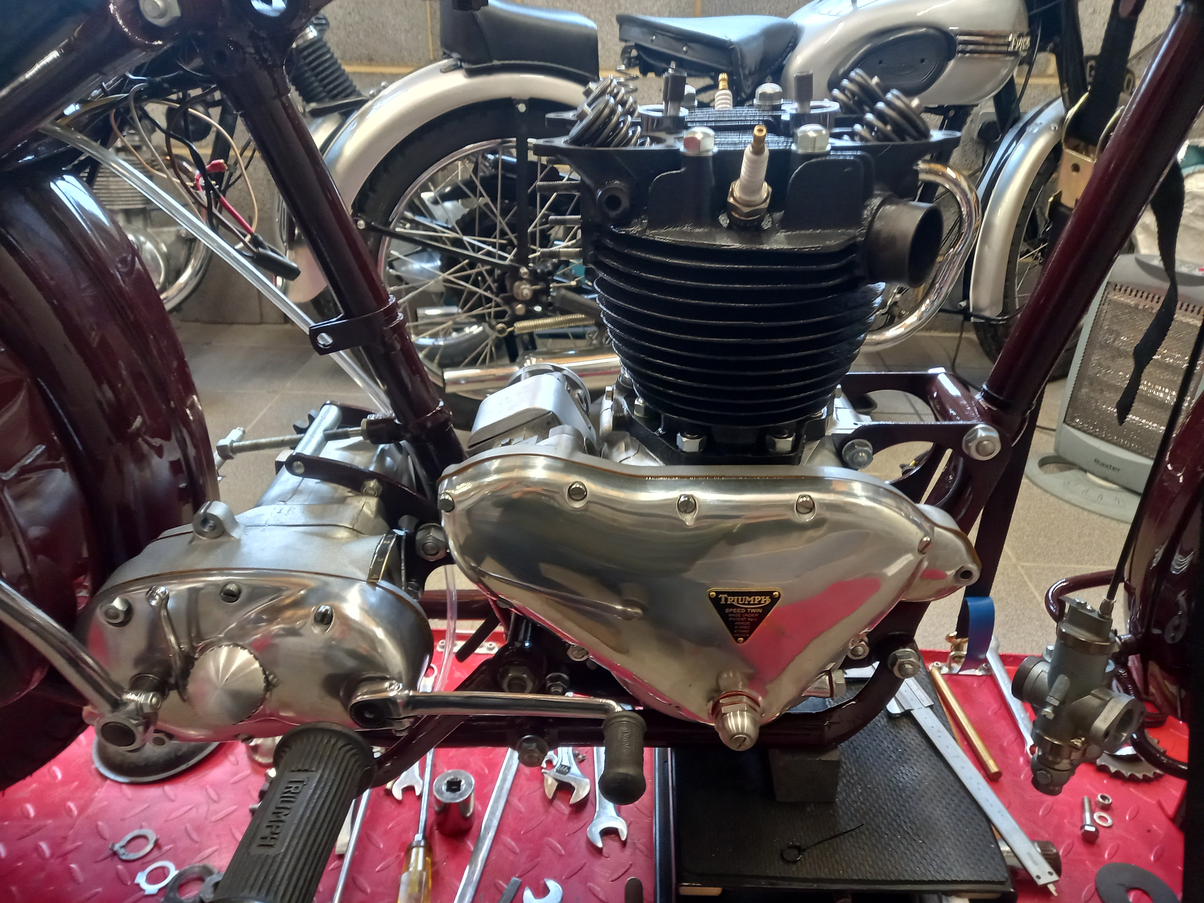

    Polished rocker boxes and rebuilt them, sorted out the pushrod tube seal crush and fitted the rocker boxes :) tighten head down and set tappets.

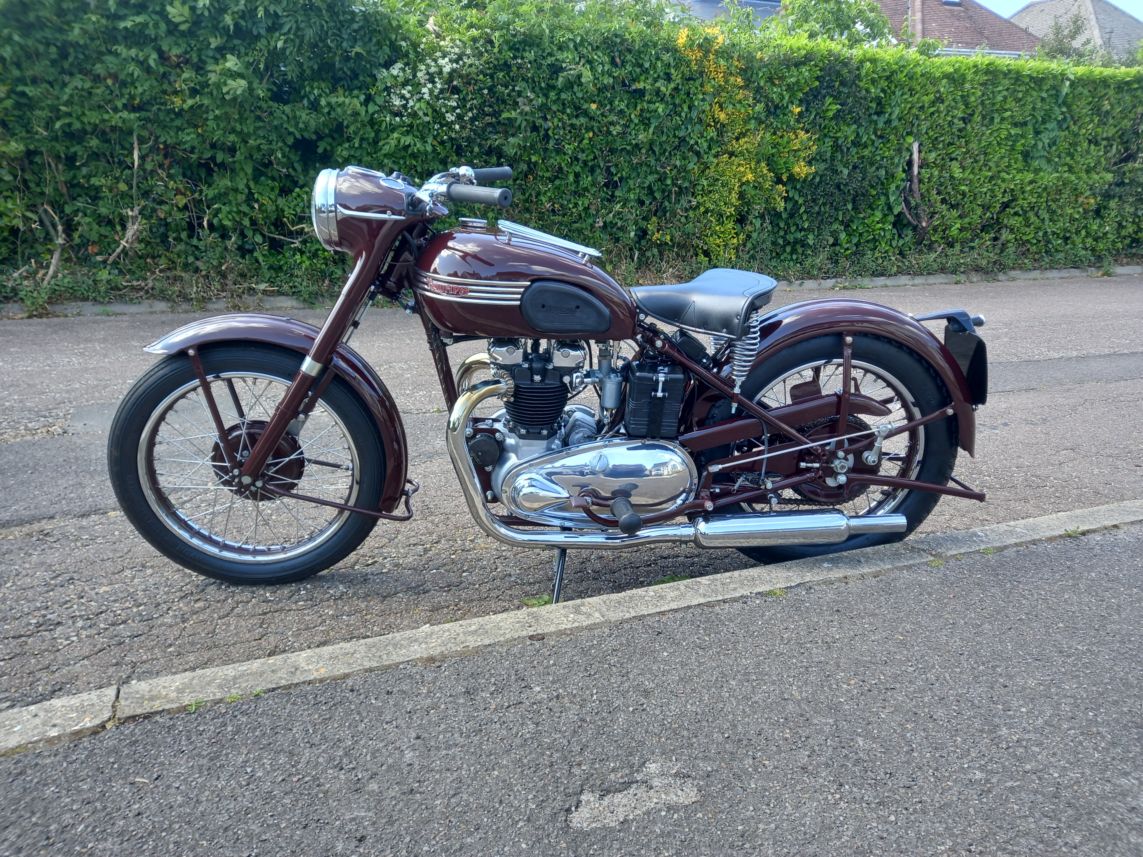

    After a long wet winter and getting the driveway and garden sorted i finally managed to get Su's 5T finished [​IMG]

  10. DaveQ
    DaveQ Senior Member
    Jul 28, 2022
    178
    335
    Surrey. England
    That is one great looking bike. :cool:
    #70
  11. Wessa
    14,101
    11,907
    Wow that looks brilliant, what a fantastic job :)
    #71
  12. Iron
    Iron Elite Member
    Dec 29, 2021
    818
    2,755
    943
    Bob Ross Studios
    Very bloody pretty. well done that man. Beaut :)
    By the way, do you have pharaohs buried in the front garden?
    #72

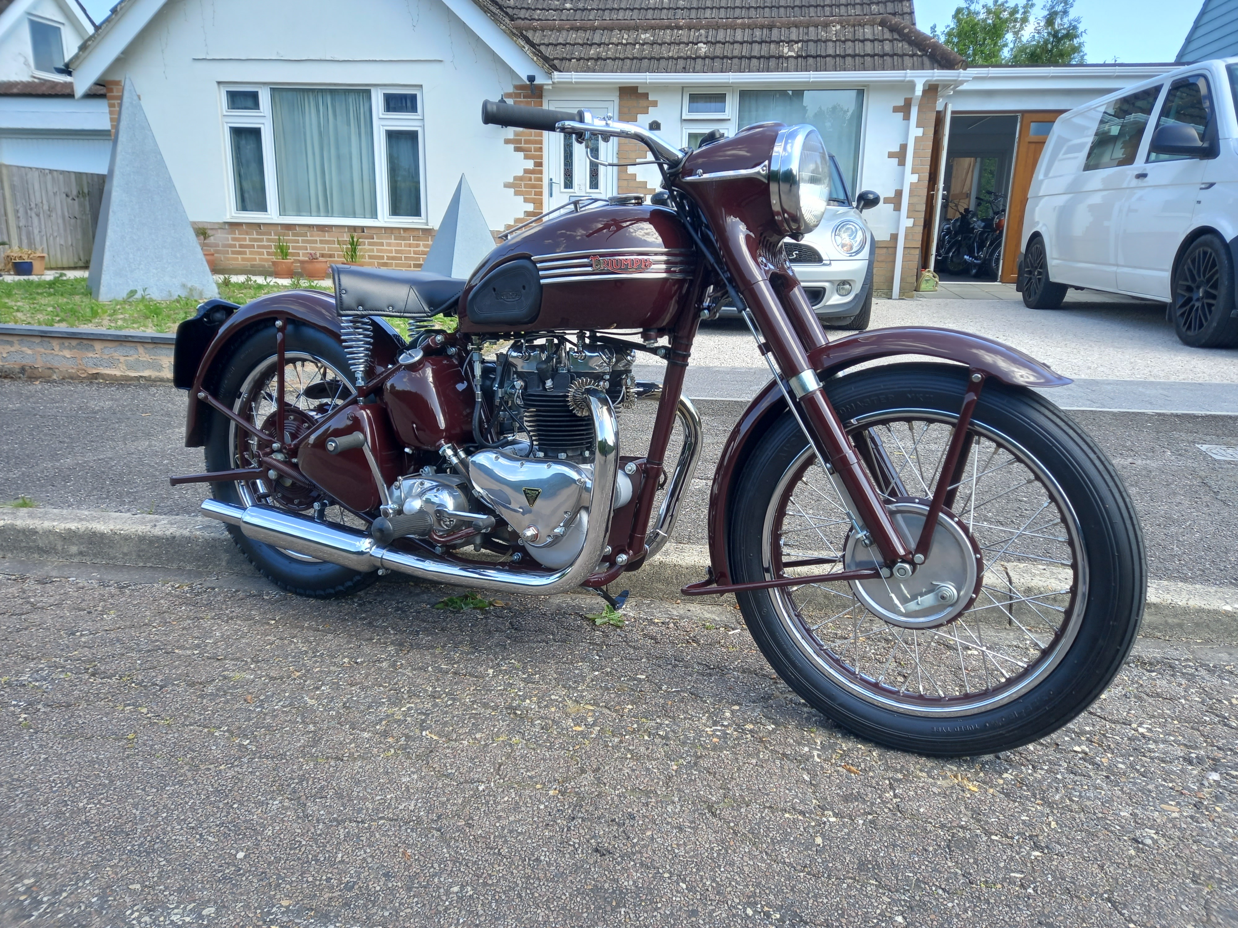

    i will look them up,i like a good restoration thread.i gave my T120 a cosmetic restoration, just finished in time for summer bimbling around the villages.to my shame i never took any photos during restoration,have owned this since 1978..[​IMG]
    #77
  18. darkman
    5,158
    7,660
    Very nice UK spec T120 GM :)
    #78
  19. greasemonkey
    greasemonkey New Member
    Jun 13, 2023
    7
    11
    bedford
    thank you,first time i have sprayed 2Pac.always used cellulose in the past but apparently E5 petrol eats it.came out nice though:)[/QUOTE]
    #79
  20. darkman
    5,158
    7,660
    [/QUOTE]
    If i use cellulose base colours i just clear coat with 2k lacquer for that reason :)
