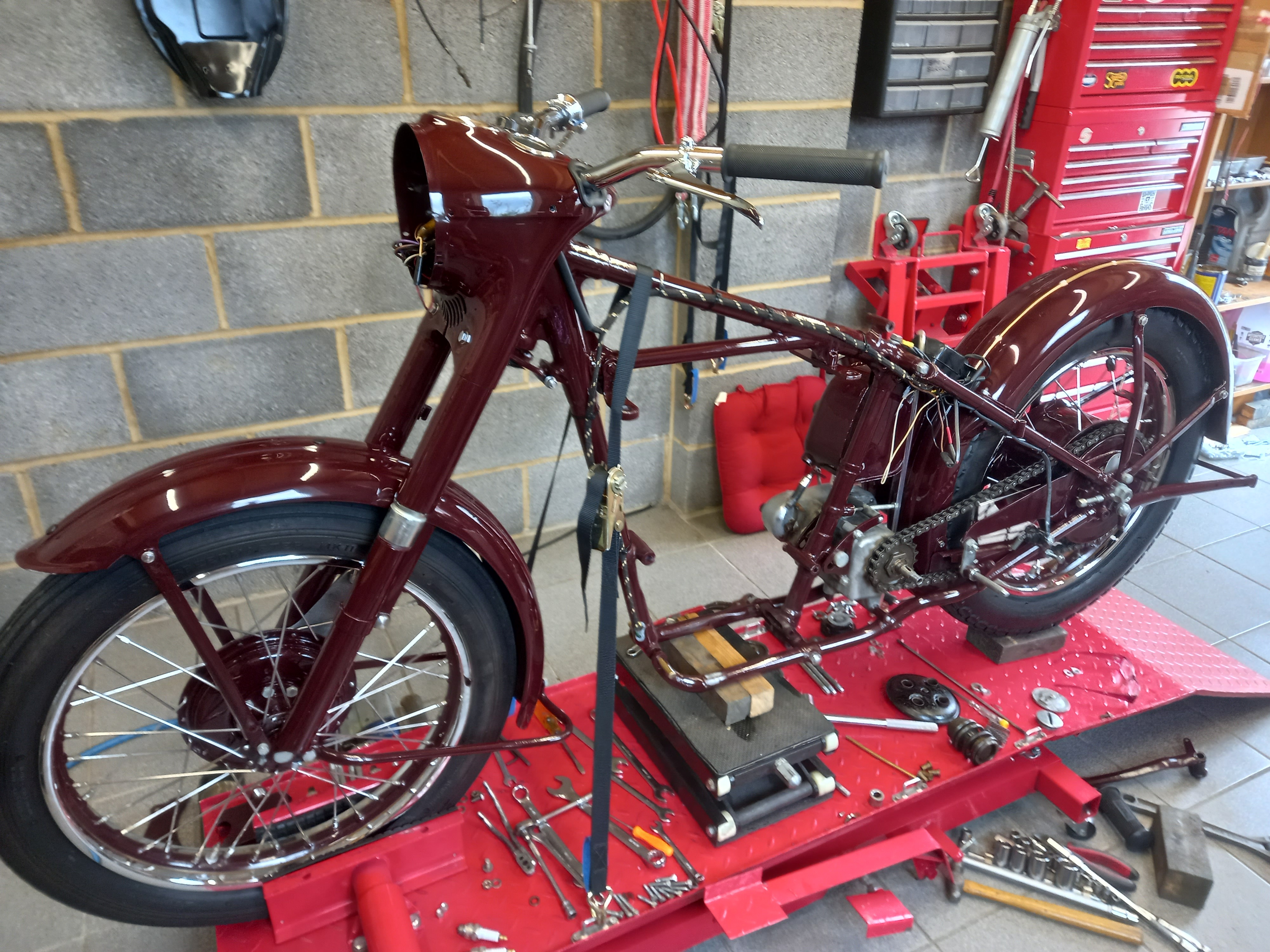

    Su's next project a 1950 5T speed twin, i have spent the last two weeks flatting and polishing all the painted parts as they had accumulated many years of dust and over spray etc ingrained into the paint, a few part that are not good enough i will respray. Next job is to strip and inspect all the engine and gearbox parts ready for its rebuild.

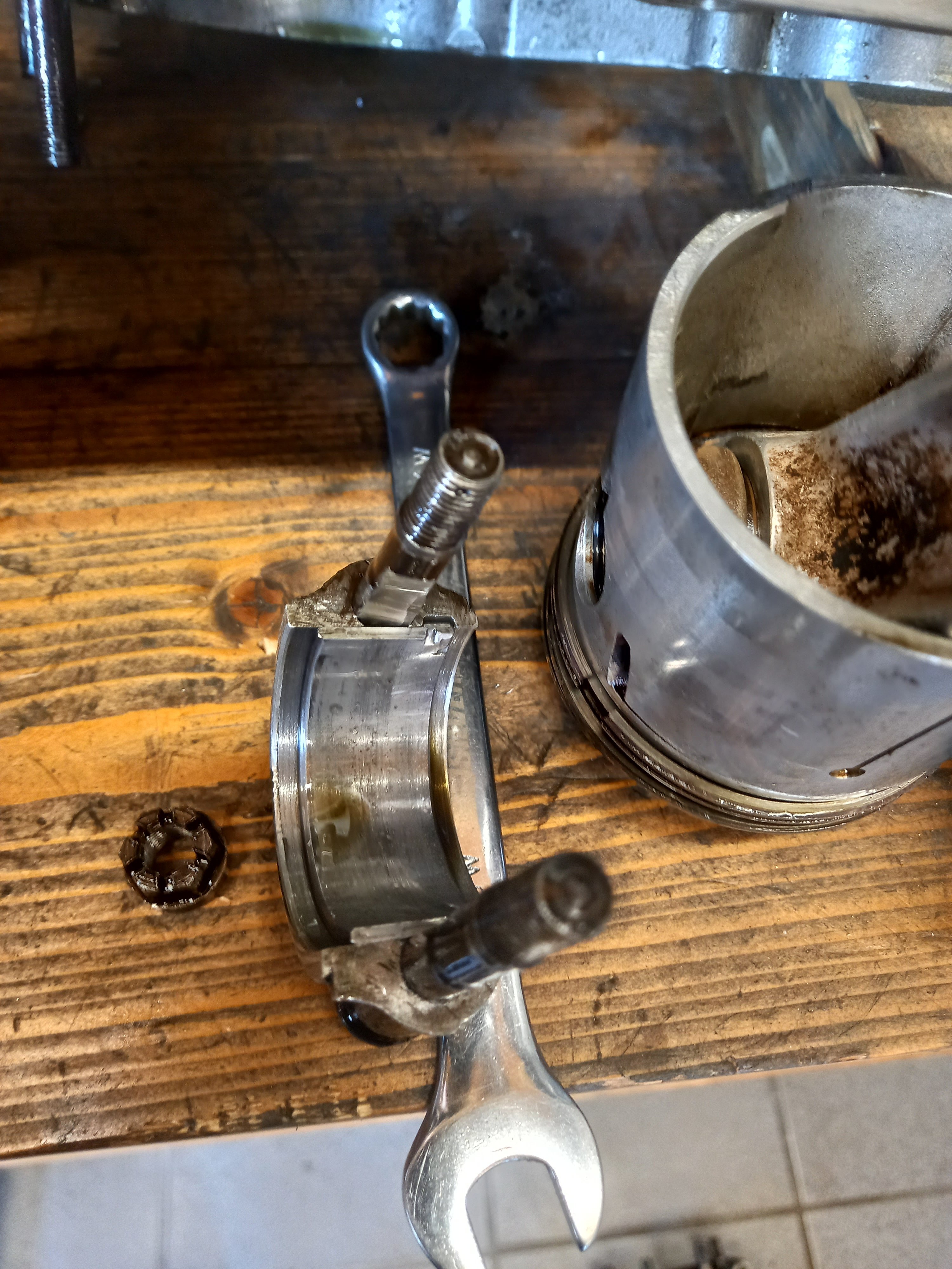

    Well i expected the white metal big ends to have play but had another expected surprise, when stripping the engine i had removed some Hylomar from around the drive side main bearing outer crankcase area and found a crack in the case and sure enough on stripping the engine found more bodged centre punch marks made in an attempt to hold the bearing in place :-( Good old 90's engineering for you lol.

  10. darkman
    7,648
    Its just got even worse :joy:

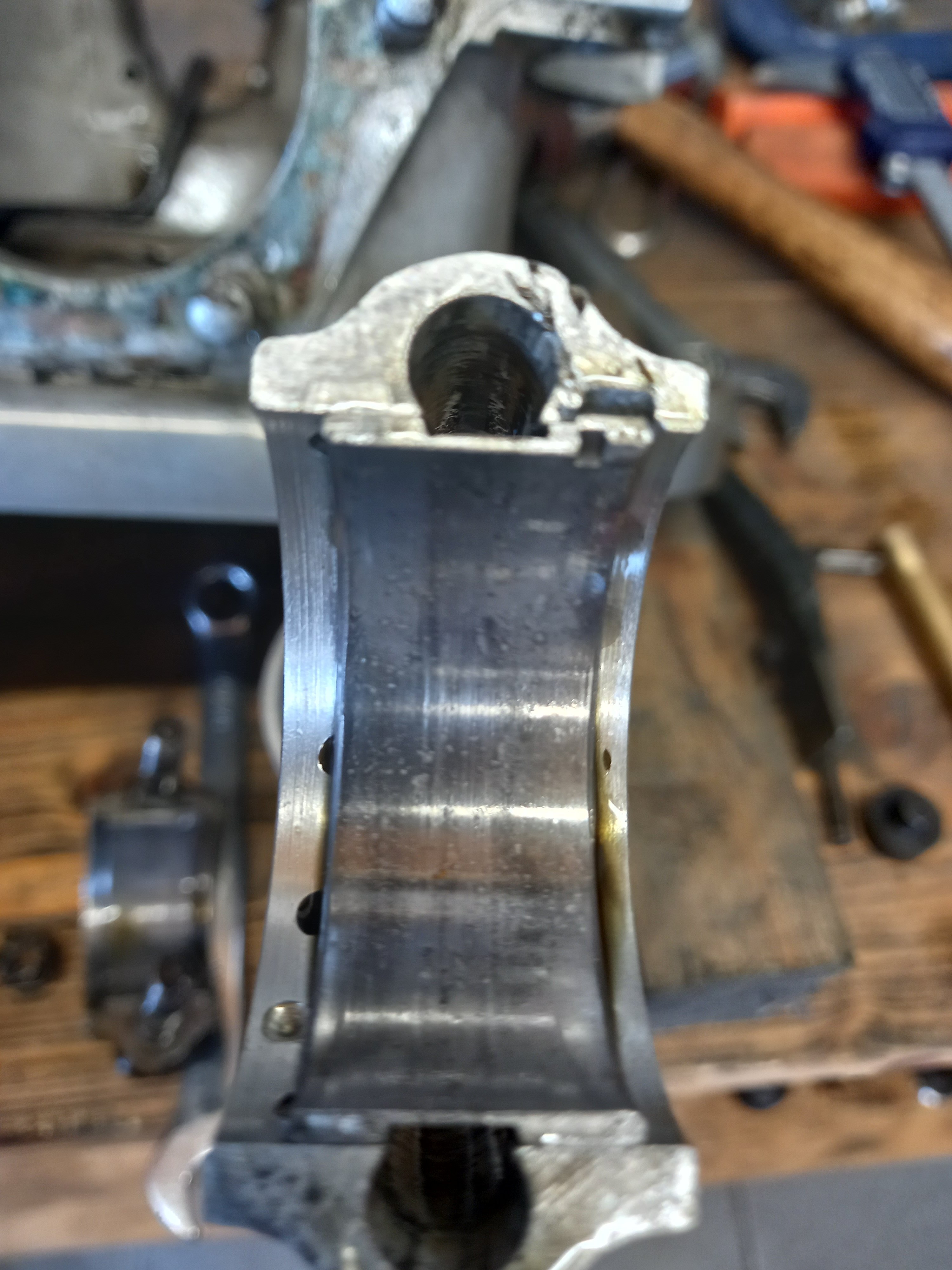

  11. darkman
    7,648
    When you think ah its just the white metal that failed and maybe the old bodger with shares in Hylomar wasn't so bad i find this pathetic effort : unamused:

    Bummer, new rods as well.....

  14. speedrattle
    speedrattle Senior Member
    Feb 19, 2021
    1,171
    appalachia usa
    jeez.
    what about the crank journals?
  15. darkman
    7,648
    I have just remeasured the journals as they look fine and they are within specs for -20 thou unit 500 shells, so some LFH 500 rods but with 6.5" centres will work :)
  16. darkman
    7,648
    Best bit is they had ground the rod bolts with a flat (see pic) to clear the shells lol.
