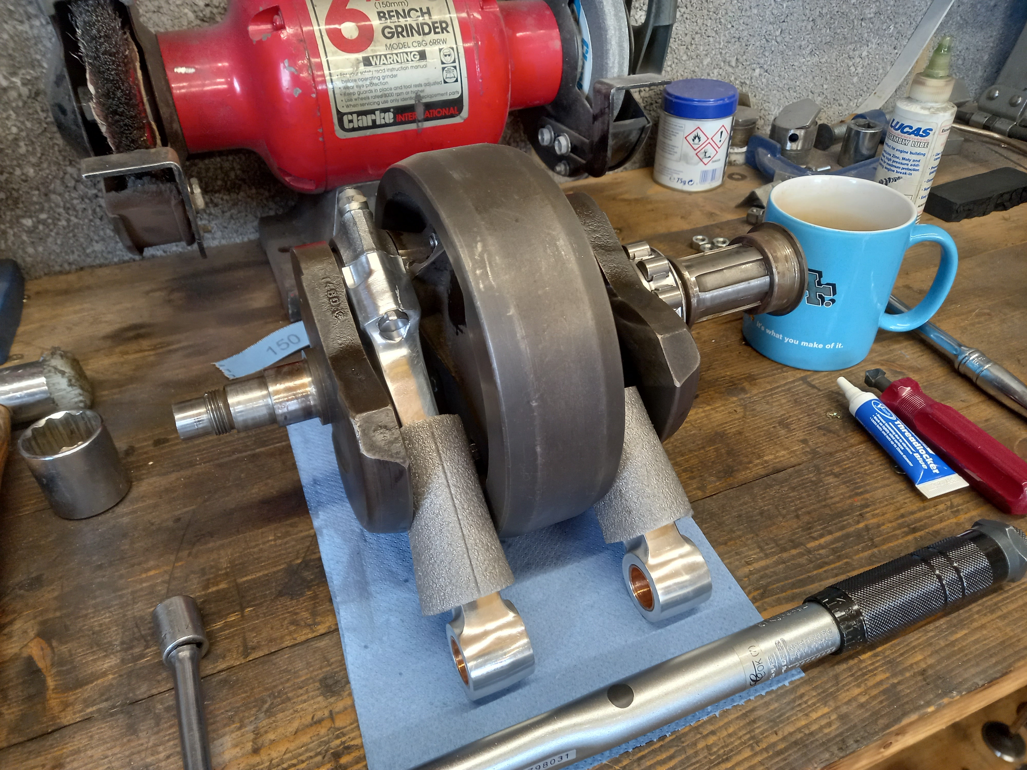

  5. darkman
    5,158
    7,660
    Long day today as i had to prep and prime all the frame and various parts for a job i'm doing but managed to rebuild the crank with its new rods n shells :) The rods are special Harris rods that take shells rather that the old fashioned white metal caps.

  6. Sandi T
    10,930
    24,370
    Very cool, @darkman! But in this photo, I find myself curious about that blue coffee (or tea?) mug. I can read part of it but am wondering what the missing parts say. :neutral:

  7. darkman
    5,158
    7,660
    Its a promotional RIZLA fag rolling paper mug in a not so common blue that Crescent Racing painted their SUZUKI race bikes in BSB and MotoGP as RIZLA is one of their sponsors Sandi, most people know RIZLA as a green colour but they do various colours to denote the paper thickness :)

  8. Sandi T
    10,930
    24,370
    Thanks for the info, @darkman. That is one complicated tea/coffee mug! ;)

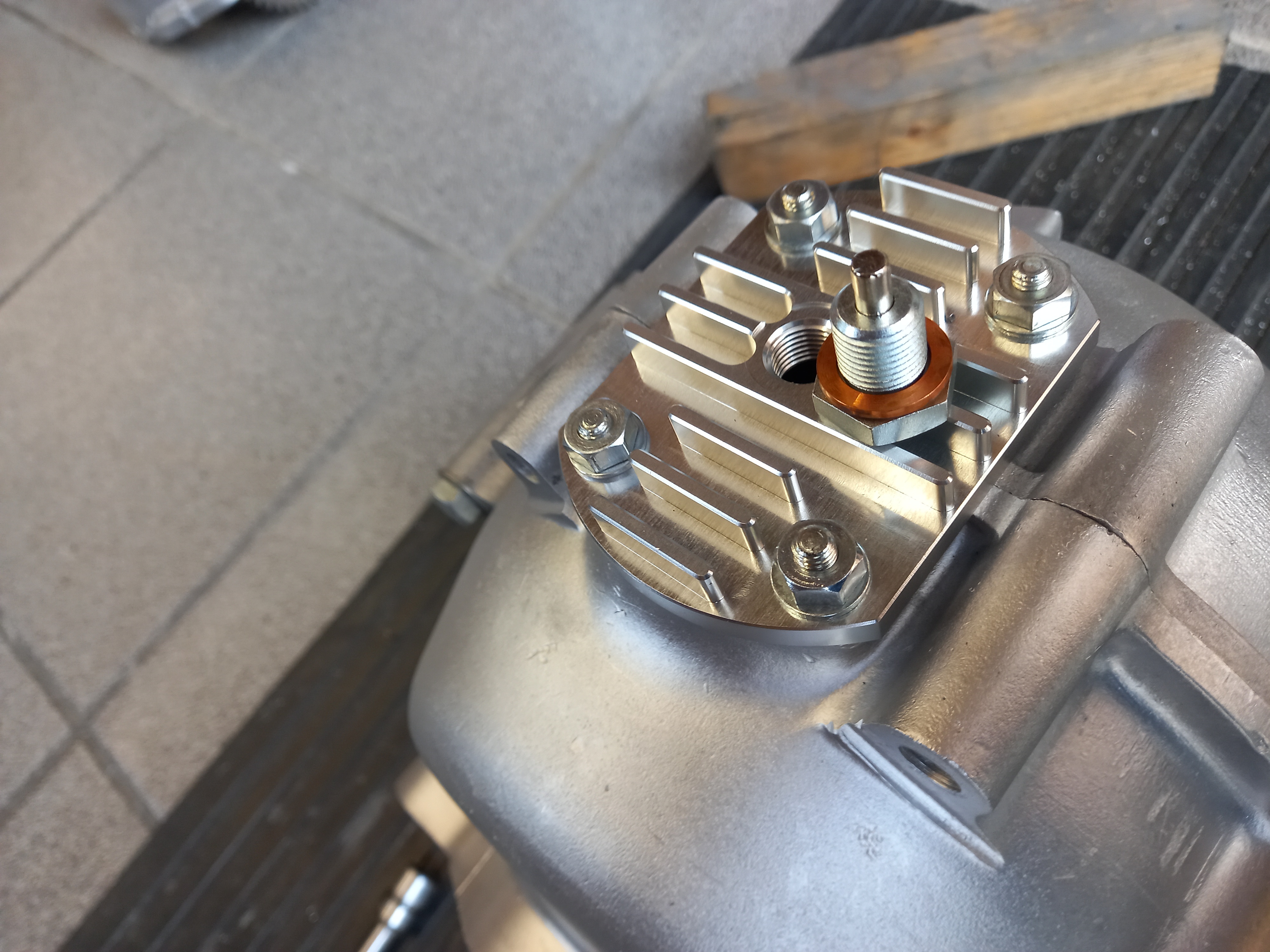

  11. darkman
    5,158
    7,660
    Final clean of the crankcases and trial fit of the new sump plate with inbuilt drain plug and magnetic stick :)

  13. darkman
    5,158
    7,660
    Original plate is just a plain cheap steel pressing that you have to remove all four bolts just to drain oil and use new gaskets so this makes it far easier with just the drain plug
    #53
  14. timboo
    timboo Senior Member
    Oct 17, 2021
    501
    310
    Cambridgeshire
    Ah ha that makes more sense now cheers for that
    #54
