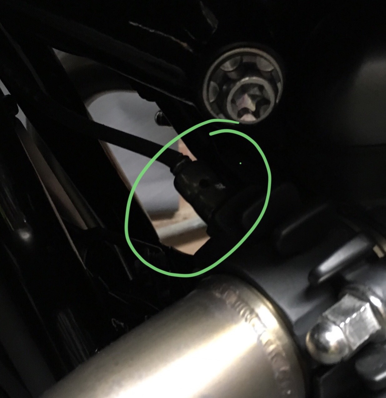

Hi Spacefrog, are you aware you’re going to have to fit a power commander or o2 sensor blanks and a remap if you fit an X pipe
Hello Glyn, I haven't seen anything about that, no mention of that in any of the youtube vids ive watched …… i also asked Motone if there was any other mods i needed to do they said this.. No ECU changes are required. Delivery is next working day depending on the time of day the item is ordered. Sam
Hey Glyn, I just asked a well known manufacturer of the xpipe i am going to fit, they replied with this … Beware "knowledgeable" people on forums. There are a couple of graphite seals, if you are careful no need to replace them just re-use. As for power commander... well if you wanted to squeeze more power out of it perhaps you could go that route, but its certainly not necessary nor worth the ball ache in my opinion. You can just fit the xpipe. You then turn the bike on from cold. Dont touch the throttle, wait til the engine fan comes on. Then time 12 minutes without touching anything. That will cause the ECU to readjust the fuel for the new xpipe setup. If you remove the o2 sensors Im not sure if the 12 minute retune will work.

Yes completely understand and the reason I even mentioned the power commander is I cannot see how the bikes Ecu can compensate the fuelling after the cat is removed without an outside influence. I get that the Vance and Hines cans and Arrow parts that are factory approved are already added to the ecu by Triumph but I doubt that the X pipe is and it will considerably change fuelling requirements. I will say no more, hope it works for you
Yes Glyn apparently the thruxton R has a very intelligent ecu and can adapt itself by the method described by the xpipe manufacturer so i think its all good and straight forward, apart from needing some good planning to do the job and care when fitting…..i know you only meant well……...
I had my V&H open pipes and Arrow headers fitted by Triumph Birmingham and watched them do exactly as you describe, waiting for the fan to kick in etc and the bike has run like a dream for the last 2 years. Same procedure with an XPipe I was told. Enjoy.....
It seems as I write these comments like I’m having a dig even as I read them back, but I’m actually trying to help . I’ll explain, a friend of mine has Arrow downpipes with open V&H cans, no O2 sensors fitted. His bike has a power commander so no problem, but I do know both of these products are approved by Triumph and are included in the many maps built into the Thruxton ECU. An X pipe does not delete the O2 sensor so how does it quantify the difference in mass flow through the exhaust I cannot understand how it can. I’m not saying it won’t work but I really cannot see how it works without the need for fuelling mods to be carried out. It can only use the Arrow internal ECU map but they don’t have O2 sensors so I don’t get it,sorry
As we’ve said before my Arrow pipes do have sensors. Triumph do, or used to approve Arrow Pipes for some models but I’ve not seen anything for the 1200 Thruxton. When they launched the 1200 they had a full system as an accessory which were dropped because of noise or emissions laws or something. I don’t know much about these things but all I can tell you is mine were fitted by a dealer, we stood around drinking tea waiting for my bike to reach temperature and for the fan to cut in while plugged into a lap top thing. That was it, job done, as I say, it’s ran perfect ever since. I quickly put the baffles in, jeez it was loud. https://www.facebook.com/video.php?v=1512591482109045
