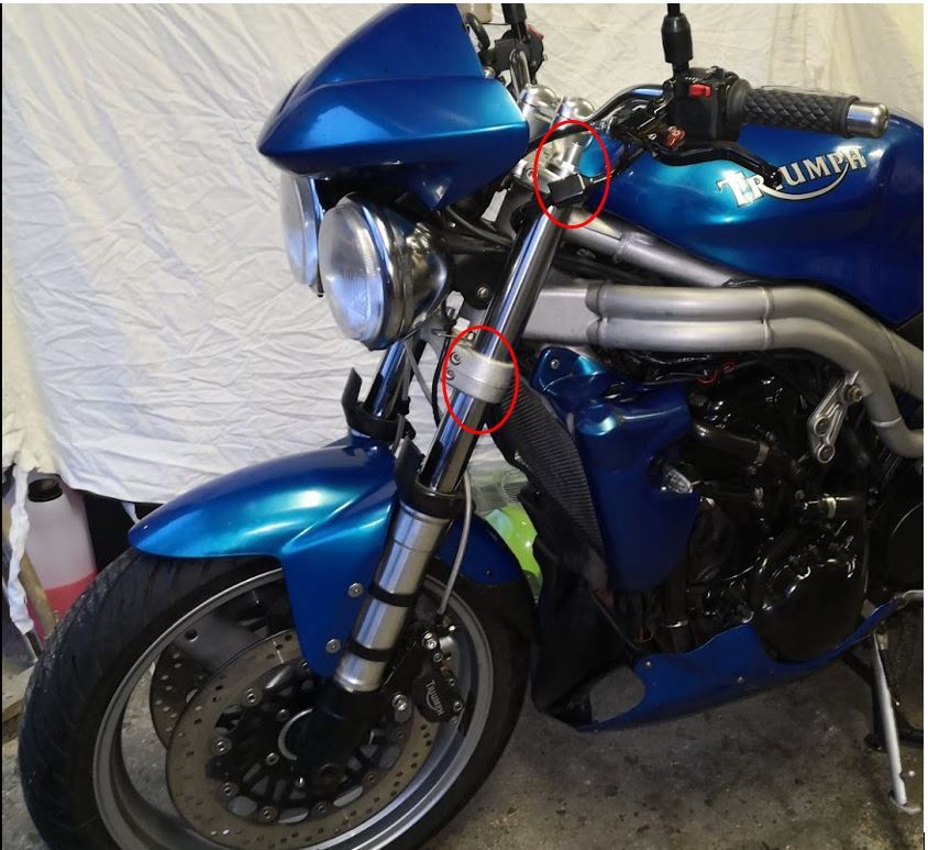

    Meanwhile, if you are still talking to me...I am going to have a go at this sag check - and adjustment if necessary... However I am confused with the front static sag; specifically where to measure between. See photo of my bike. I have highlighted in red the "bottom yoke" and the "top of the stanchion".
    Are these the correct points to measure between?
    I ask as surely these two points do not move on the bike...? The stanchion slides in and out the outer tube below...but the actual distance I am being asked to measure is static, surely?
    Or have I misunderinterpretated something? : unamused:
    Now lift the front of the bike off the floor using the same side stand method. Measure from the bottom yoke to the top of the stanchion. For upside down forks measure to a point on the bottom section that holds the wheel spindle. We will call this measurement ‘C’. Like measurement ‘A’ this will remain the same throughout.

    The measurement you want is UNLOADED from your bottom yoke (lower red circle) to say a convenient point on the lower leg or near the wheel spindle. Actual position used doesn't matter as long as same points are used for both dimensions.
    Then with an assistant measure using the same two points the distance LOADED i.e. with you seated on the bike in normal riding gear.
    The difference in the two measurements is your static sag ;).
    Seeing as you have a centre stand in the picture, take your first measurement with the bike on it, someone pushing down on the rear and the front wheel off the floor. 2nd measurement with both wheels on the floor and you sat on it.

    Ah, thank you...so, out of interest, my forks are upside down...?
  20. Eldon
    Eldon Crème de la Crème
    9,105
    #20 Eldon, Mar 3, 2020
    Apply same thought as already mentioned.
    Pick a fixed upper point above i.e. bottom yoke, then use wheel spindle as the lower point.
