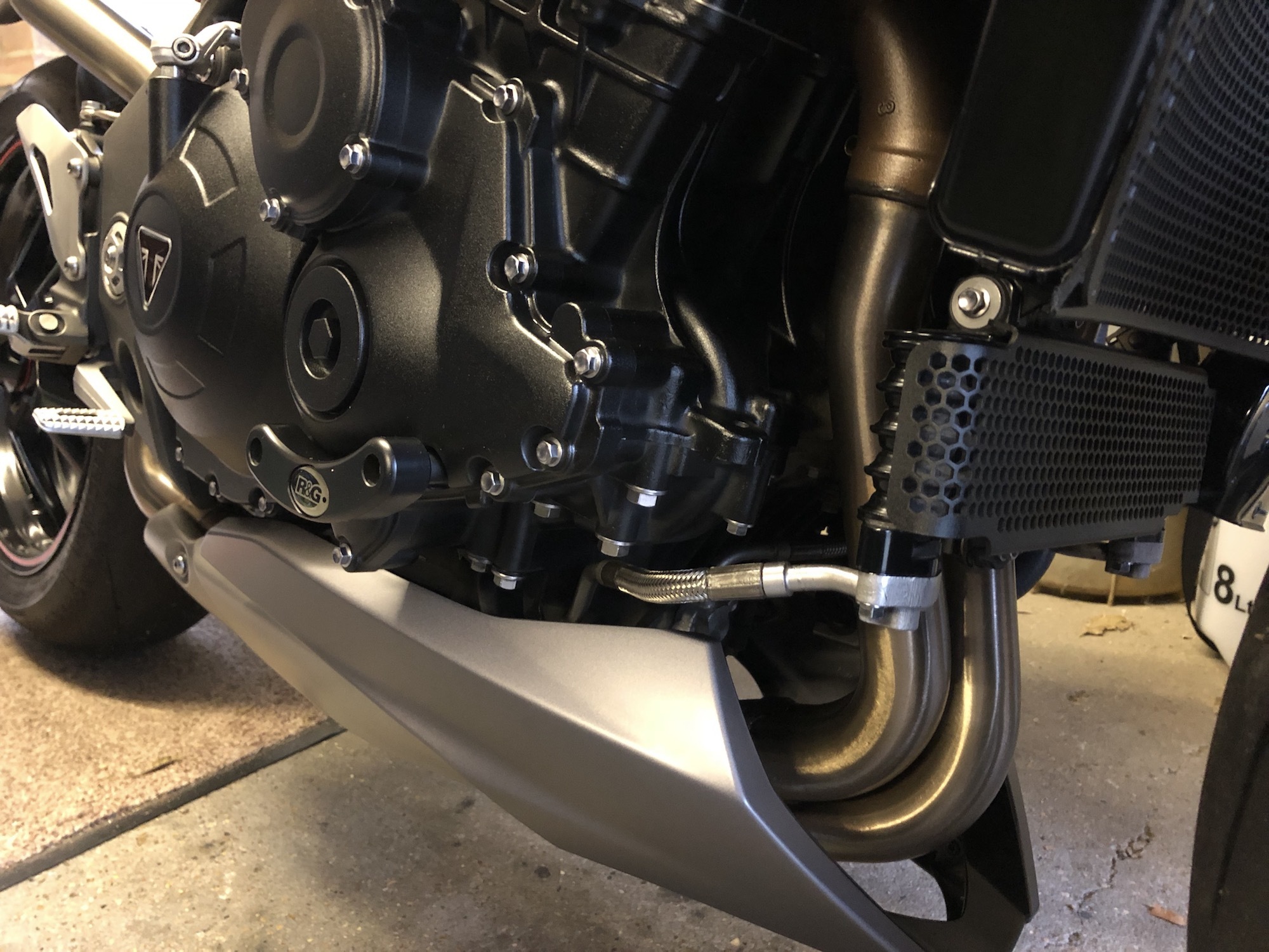

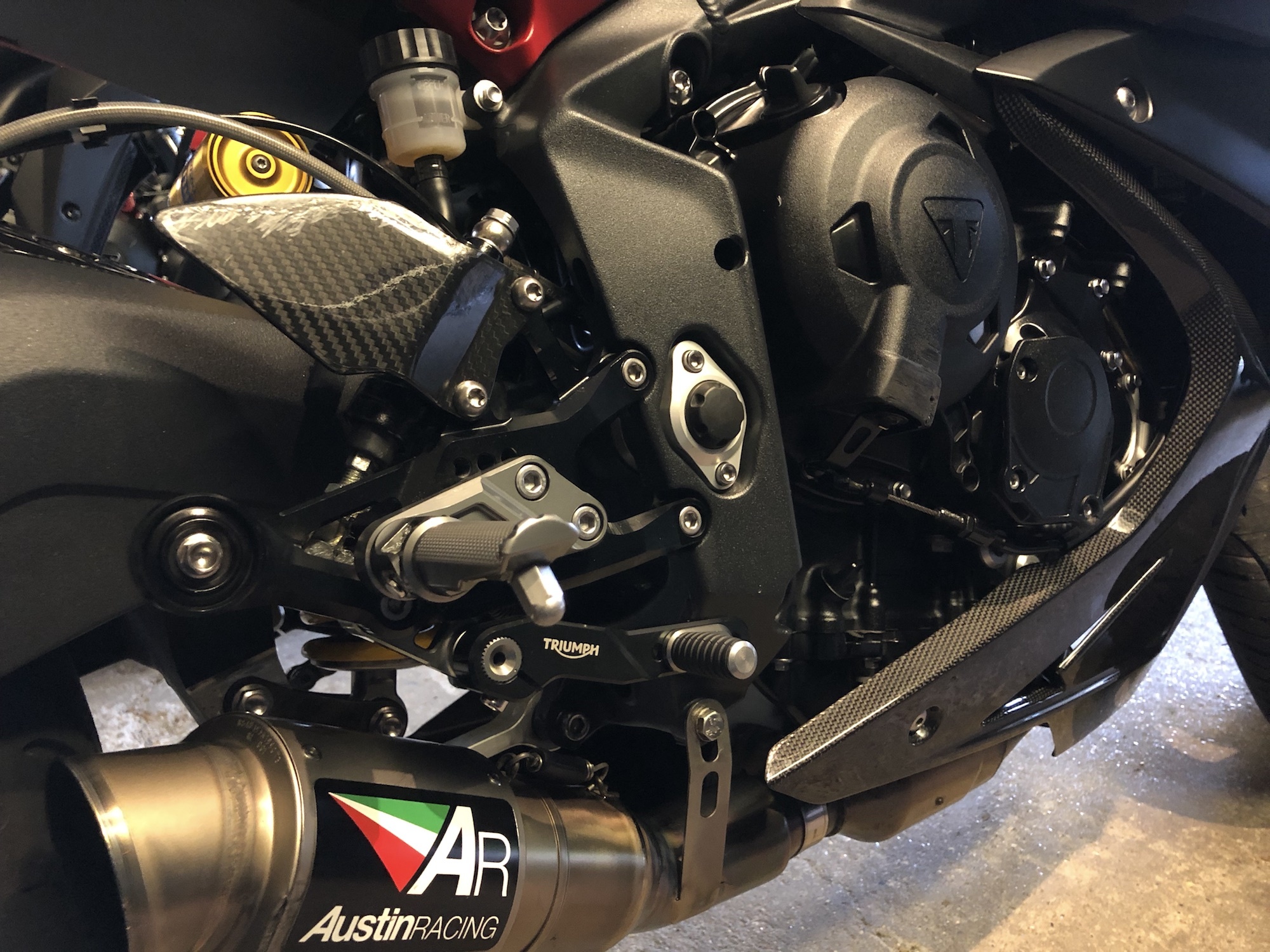

    All this is worthless without a couple of pictures...so I just popped out to the garage :yum
    The Daytona has been subjected to two years of all-weather riding and has covered 10,000 miles. My Speed is mostly dry weather and less than 4,000 miles. The headers got a bit spotted, but Cillit Bang (really) followed by ACF50 reversed the rust spots.
