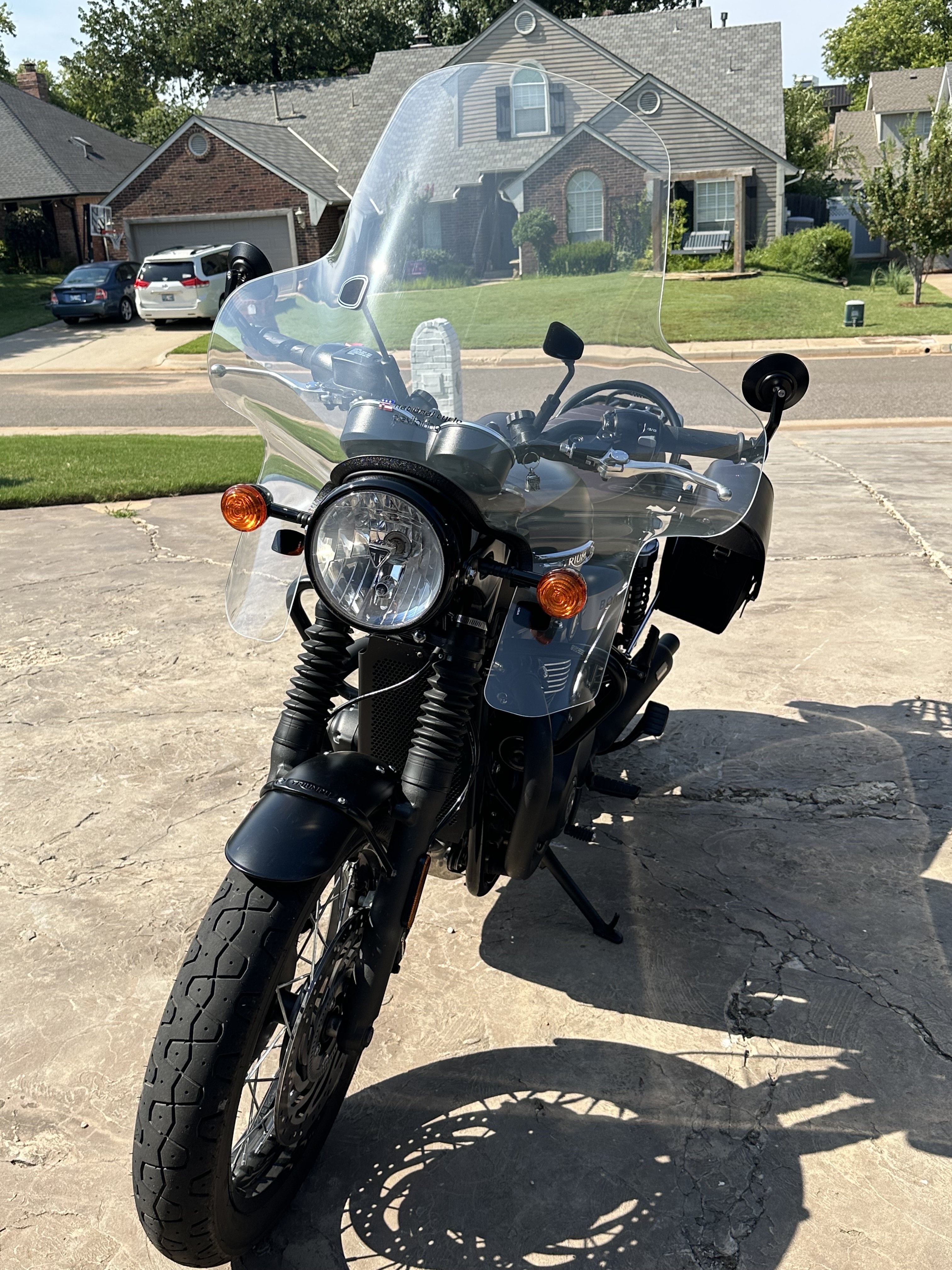

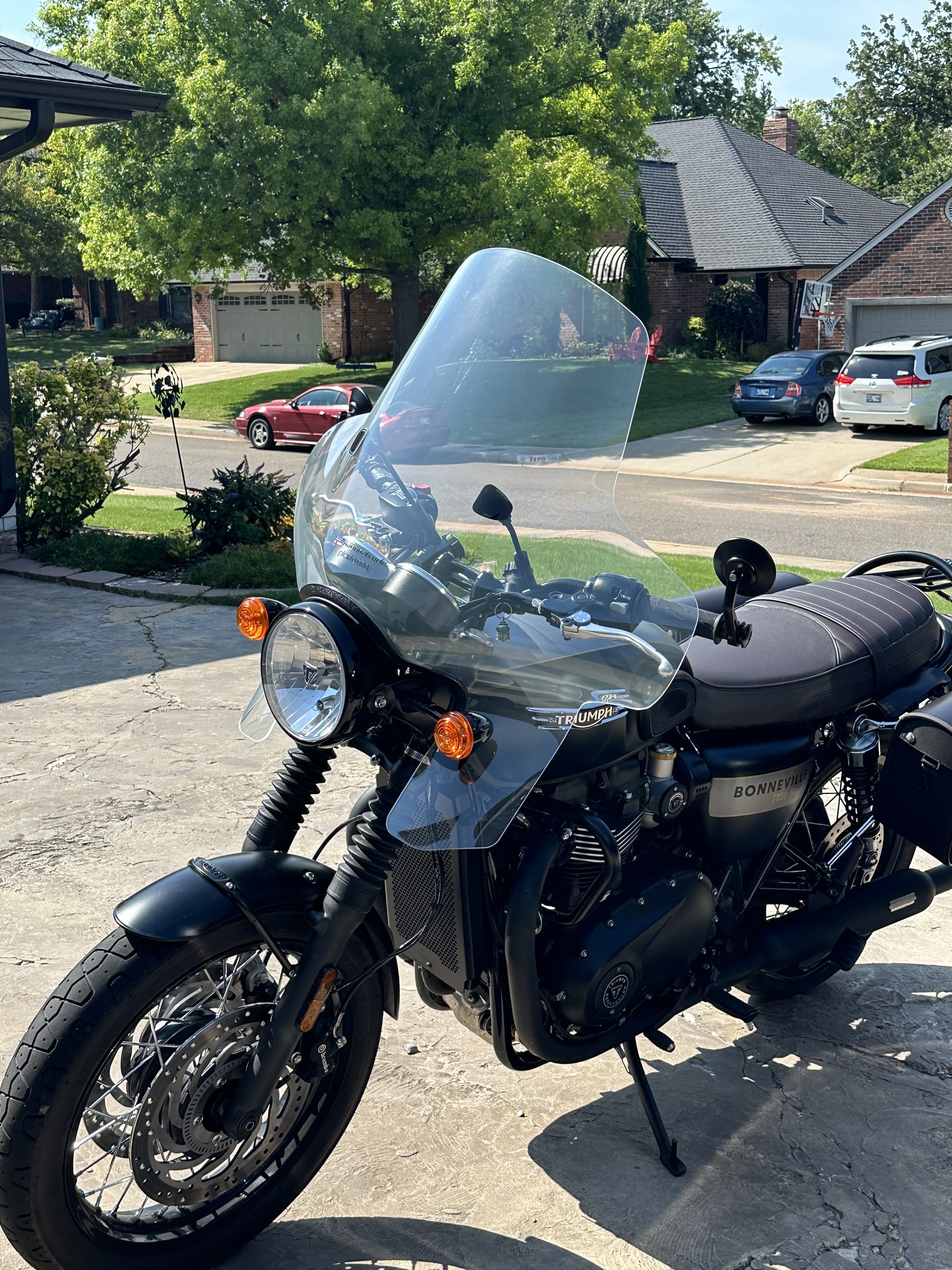

    I have a National Cycles Street shield EX. Although it’s easy on and off and looks decent, it’s not effective in my opinion - at least not for me. There’s as much wind in my face and helmet basically with it on or off. I recently ordered the plexifaring 3, it’s quite a bit bigger but it’s effective. I only have it on when I’m going on a long ride. Here’s a pic-

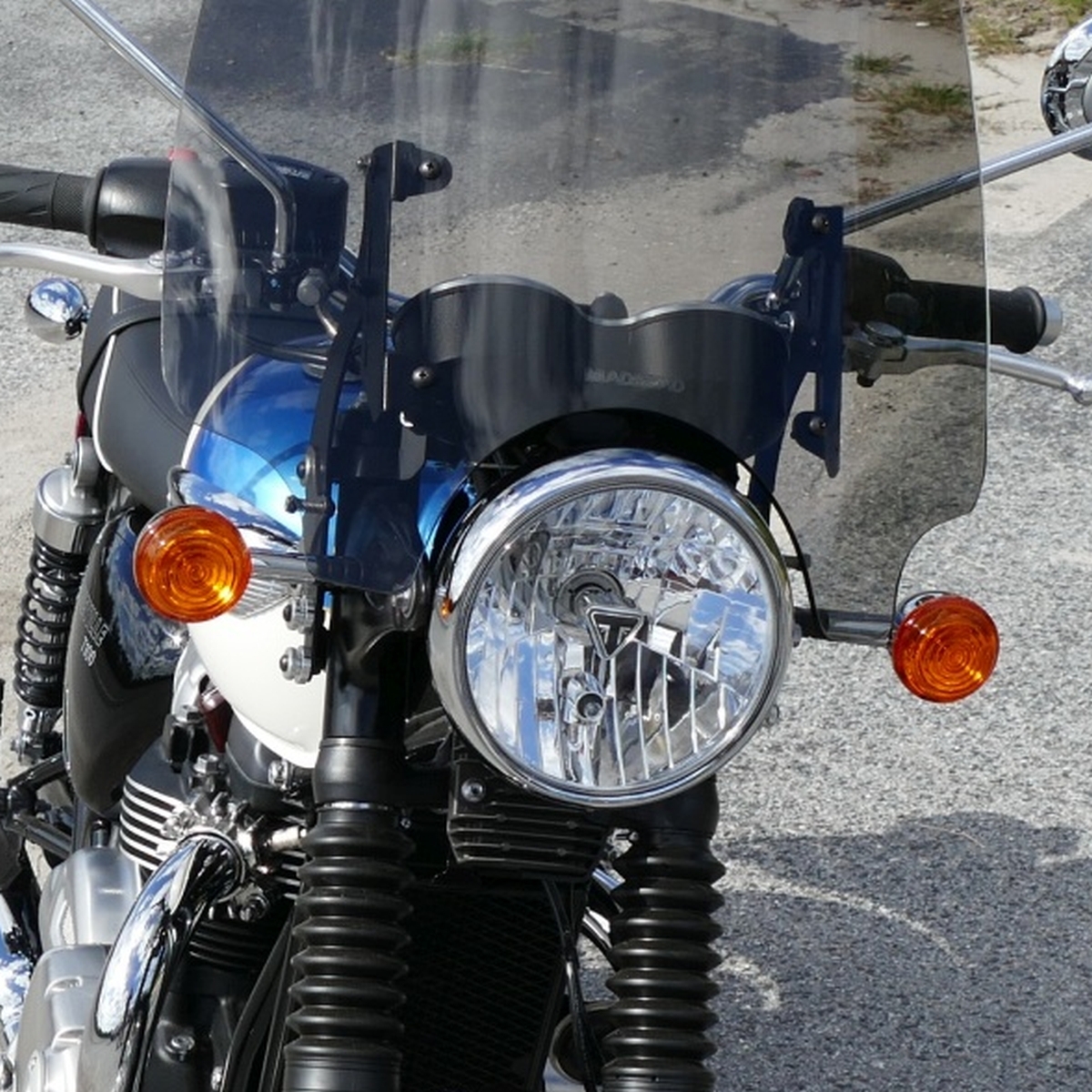

    AND, the Madstadt windshield mounts are barely visible when the shield is removed.
