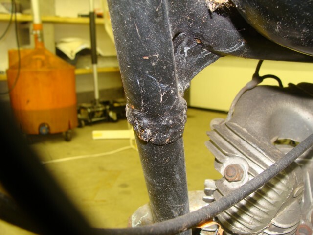

    Yes it was welded. And very poorly. I will be redoing that.

    It is, presumably, the Scrambler? That looks like a classic "high jump; front wheel landing; forks bottom out; yokes are a lever" gusset weld break! Possibly. :)

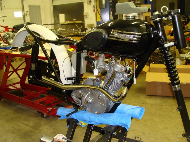

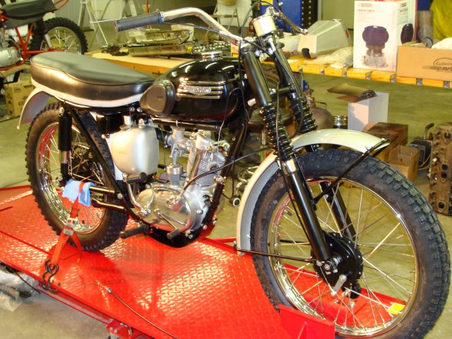

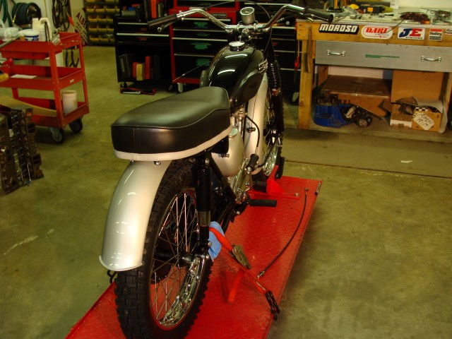

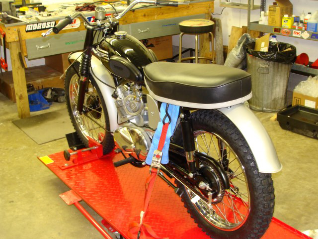

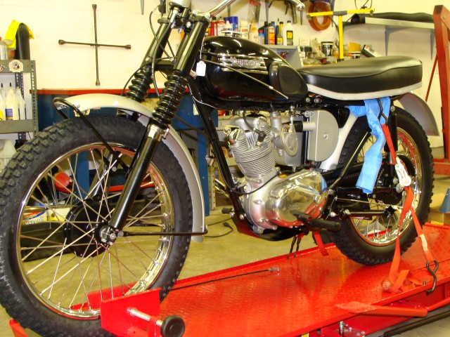

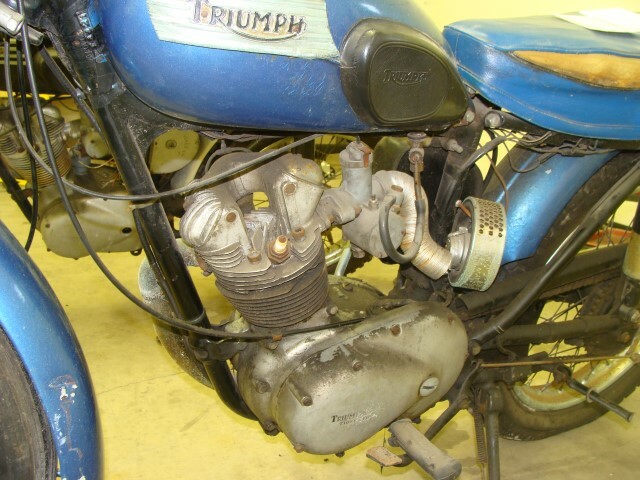

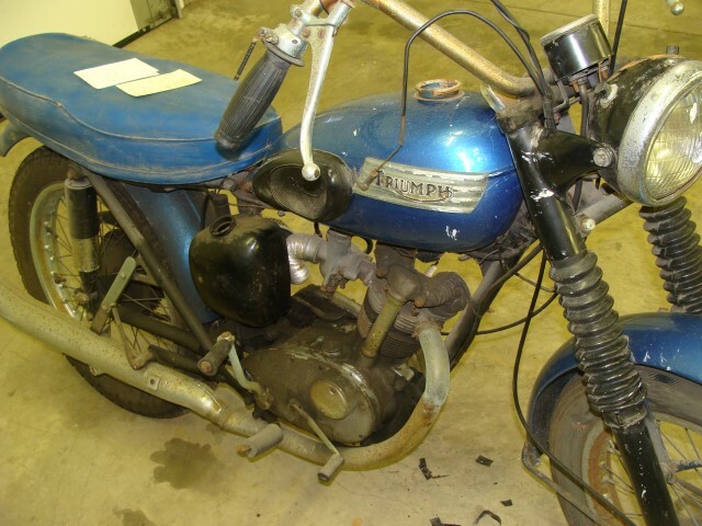

    Following a recent brief PM conversation with @Restorer Man I thought I'd show a couple of pictures of the current state of his restoration of the first of two Tiger Cubs he's working on. We were both having difficulty loading images into the PMs so I thought I'd give this a try anyway - keeps the sedation levels of the inmates here at a reasonable level, as well! The images are from his web site.
    Nice work, don'cha think?
  15. darkman
    7,653
    Very nice :)
  16. dilligaf
    Looking good :cool:

    There is (for me) ALWAYS something extra special about seeing an old nail of an early Triumph brought back to the kind of condition - and often BETTER - that it would have been in when stood on the showroom floor of Geoff Duke's shop in St. Helens or Victor Horsmans place in Liverpool! I guess that's just a personal nostalgia trip ..... but it's also about the immeasurable respect and admiration I have for people like you darkman, and Restorer Man and others who have the ability, determination and patience to start with something that resembles a junkyard reject and finish with something that looks better than showroom new condition - despite the enormous difficulties of finding good quality original or repro. parts. I stand .... well, actually, sit ..... in silent awe!
