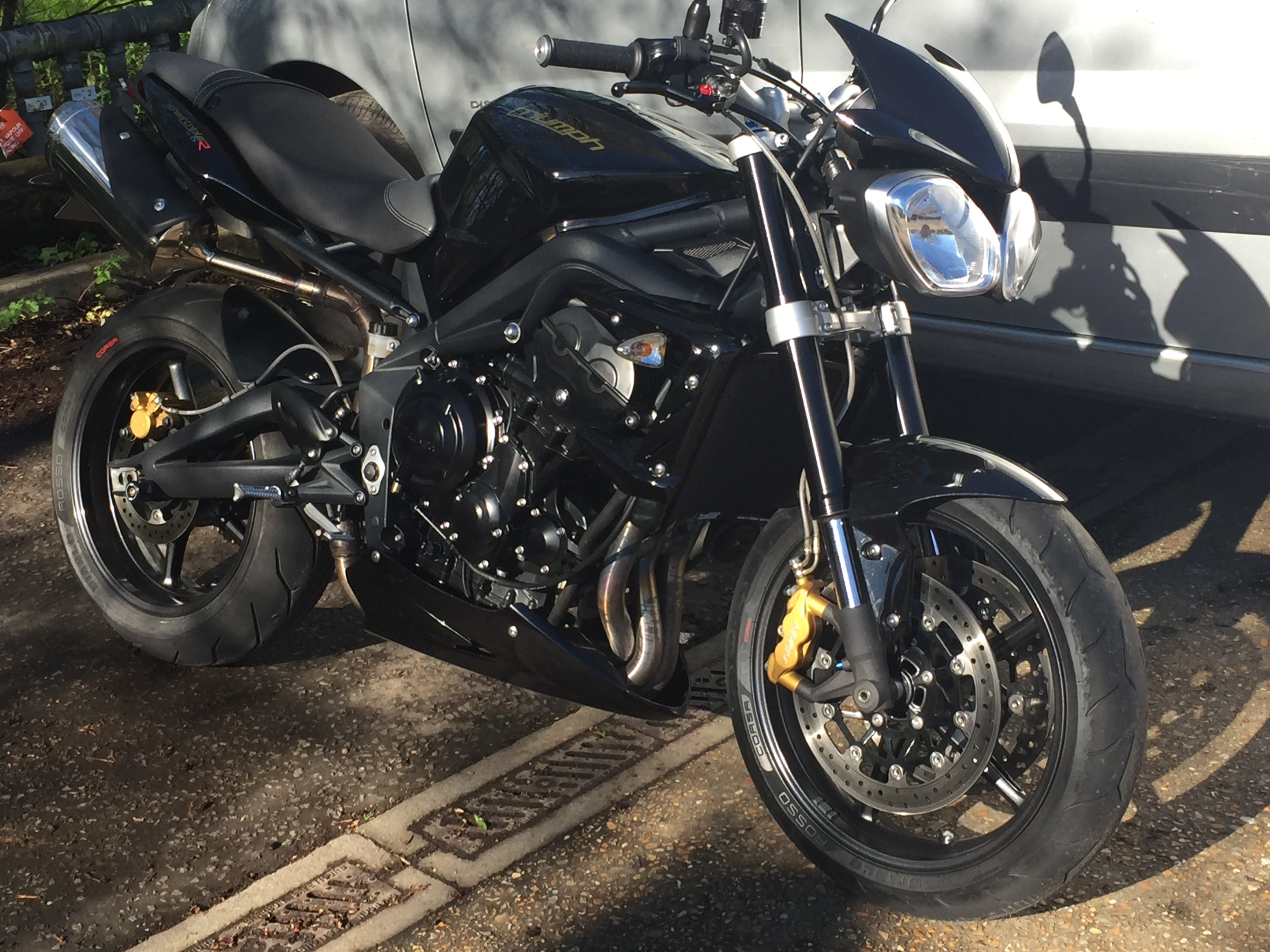

    I had a Street 675R first, then bought the 765RS, always said to anyone who'd listen that if you can get over the lack of bragging rights by not having a 'superbike' then you won't find a much better bike out there.
