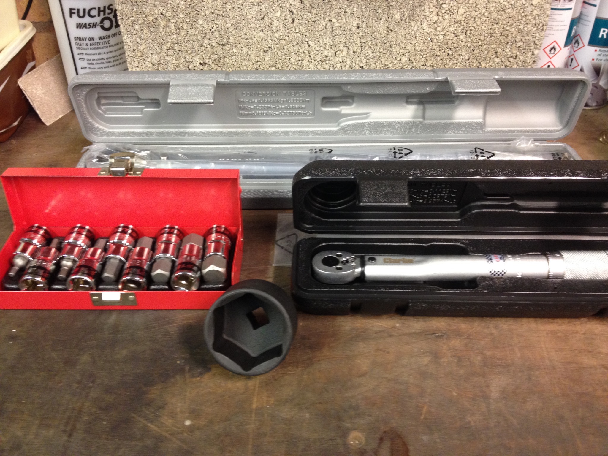

    image.jpeg Right all ready to get the wheels off, spent almost £100 and I haven't touched the bike yet lol

    They are an investment when you're doing your own maintenance. Buy quality tools and look after them n they will last you a very long time ;-)

    You'll save a ton in undamaged parts too

    Yeah nice to have the correct tools, couldn't stretch to expensive torque wrenches like norbar as recommended. But should be ok for what I want.

    Remember when you have finished with the torque wrench put it at the lowest setting for storage

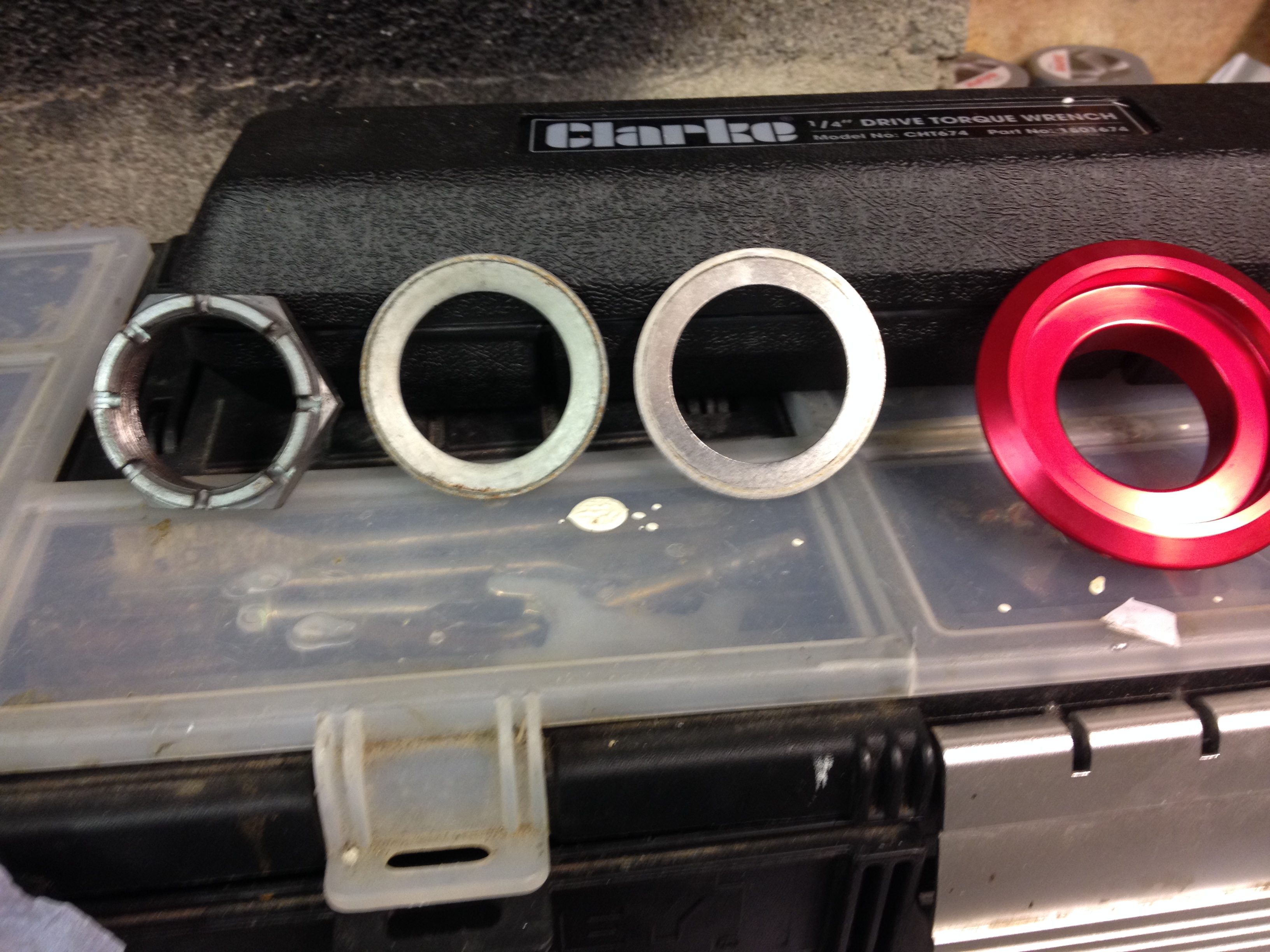

    Just taken the rear wheel off, when doing so, didn't notice what order the spacers came off.
    Think it's red anodised first then thin spacer then concave thick spacer and nut. With outer edge of concave spacer facing in???
  9. darkman
    7,661
    Tapered rounded edge facing the nut :)
  10. Taff Salmon
    Taff Salmon Active Member
    Aug 22, 2016
    77
    no
    You are correct
    Taff
  11. R_1000
    R_1000 Elite Member
    Sep 2, 2016
    1,476
    700
    UK, London
    I had the same issue then realised that conical washes acts like a spring. Just as Darkman & Taff said :)

    Amazing how many belleville washers are fitted the wrong way round.
  13. darkman
    7,661
    Its an old idea that was used years ago on some old wheel bearings on British bikes and were used to preload, you had to pack them with grease back then as they were open with no rubber seals like today and they called them dust covers :)

    well when the dealer fitted the new tyre they fitted the convex washer wrong way round first then flat then the nut
    in fairness it was a suzuki dealer
    now refitted the correct way round
