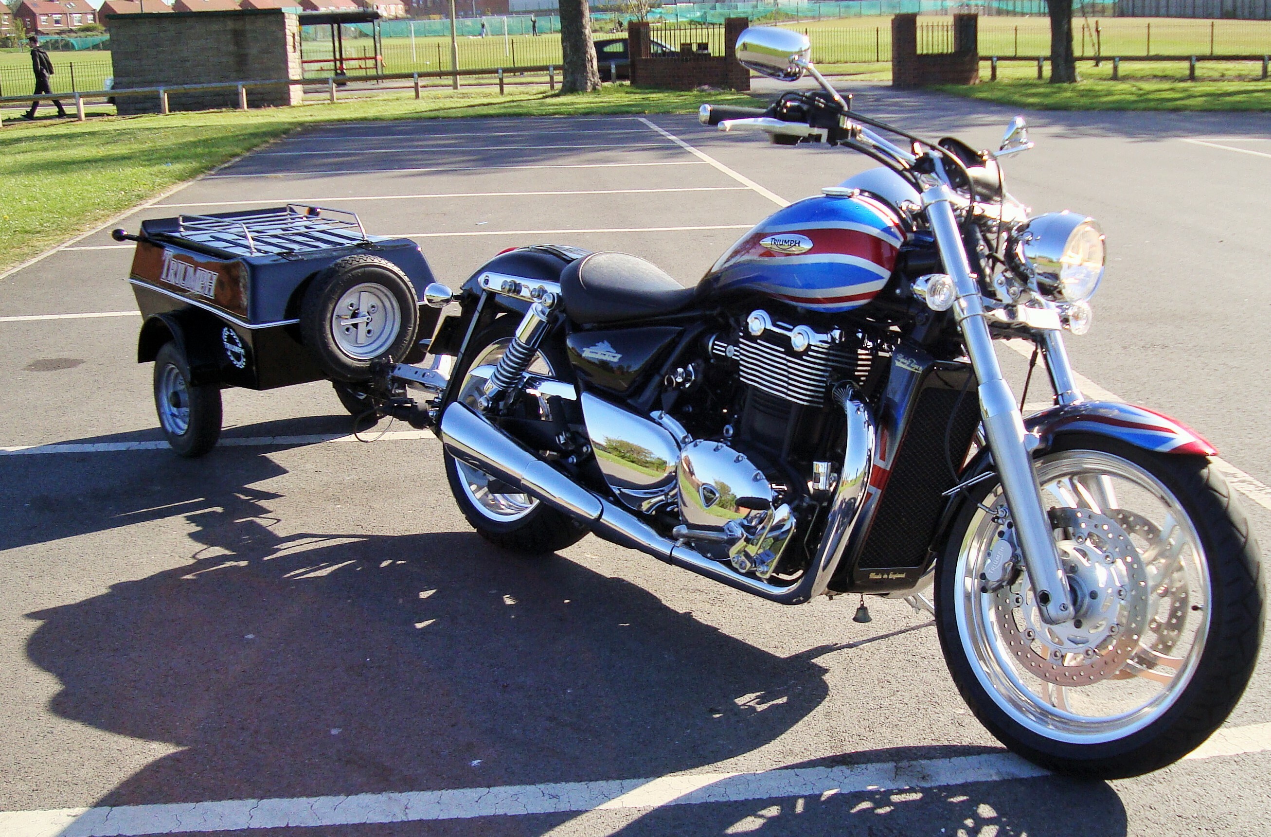

    What you don't Know Walob is I have a genny and dilligaf in the trailer,
    OH not forgetting Dilli's case of JD :p:p:p

    That is one beautiful looking machine Tez, it’s always nice looking at a bike in the summer when there’s no damp in the air! Dunno what part if the world you in (South Sheilds!! That must be freezing up there!!) but down Essex its bloody cold and damp!

    Many thanks walob, Yes bloody freezing up here in so - shields (Newcastle Upon Tyne), had snow last week but wasn't to bad, my bike is also wrapped up, well was until today unwrapped as messing with trailer lights, cold but enjoyable day in garage :D:D and success with new led trailer lights :D:D

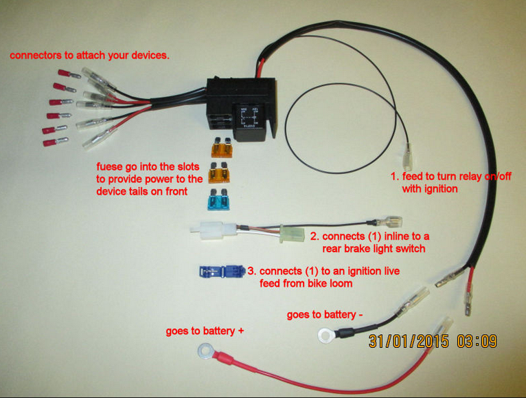

    One of the boys on the SV650 Forum had a gizmo made up and sold loads of them. Wired to the battery, relay switched on by an ignition live (taillight on SV), then three outputs to whatever you wanted. Had this on Sv , then the Gixxer, but no space on the America, plus never fitted heated grips. If I do get some heated grips for the Tuono, this will be part of the install.
    • Useful Useful x 3

    Thanks for the input on this mate but it looks more complicated than just the fuse box mod!! lol :eek:
