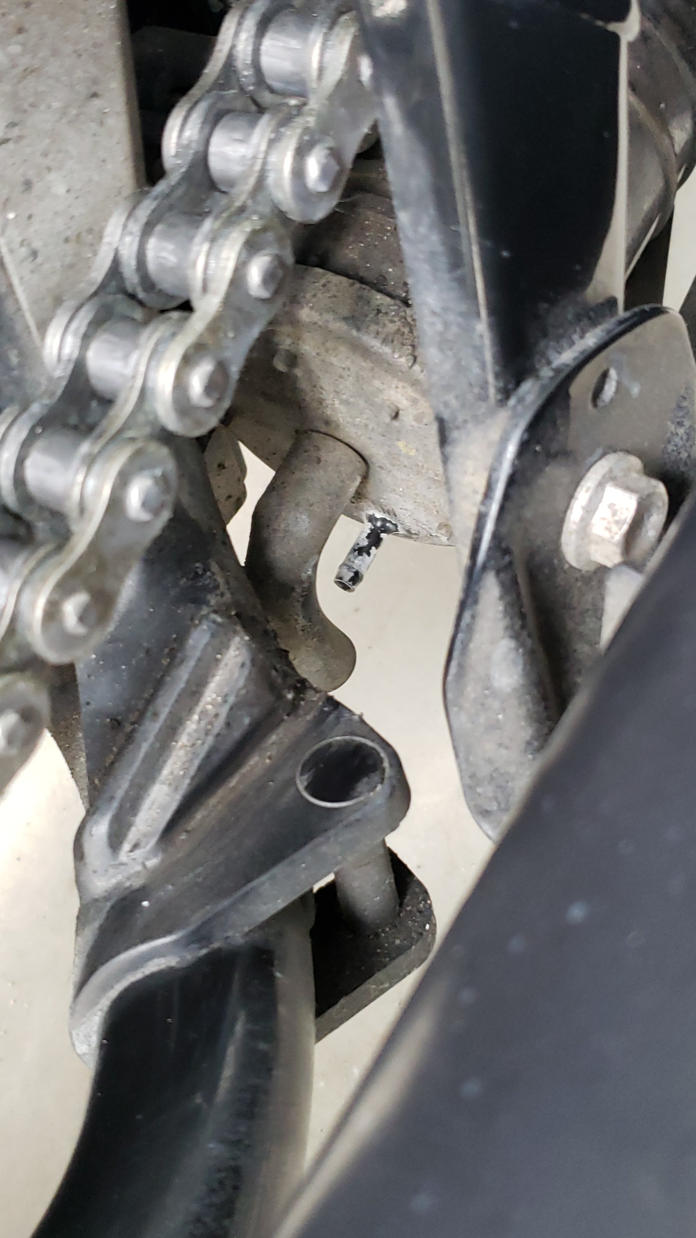

Hey everyone, just noticed this little pod thing with a little nipple at the bottom. It almost looks like that hose is supposed to loop around and connect to it but I just don't see why it would be designed that way. Do I connect the hose? Do I leave it hang? A little help for a newbie like me. Thanks.
Appears to be part of the Evap system to inhibit fuel vapour being released to atmosphere with a spigot on the carbon filter. https://www.worldoftriumph.com/collections/100081572-0-2?type=bonneville-bobber
It's the gas tank EVAP system , I know British Customs has a delete kit but it only works on European models.
