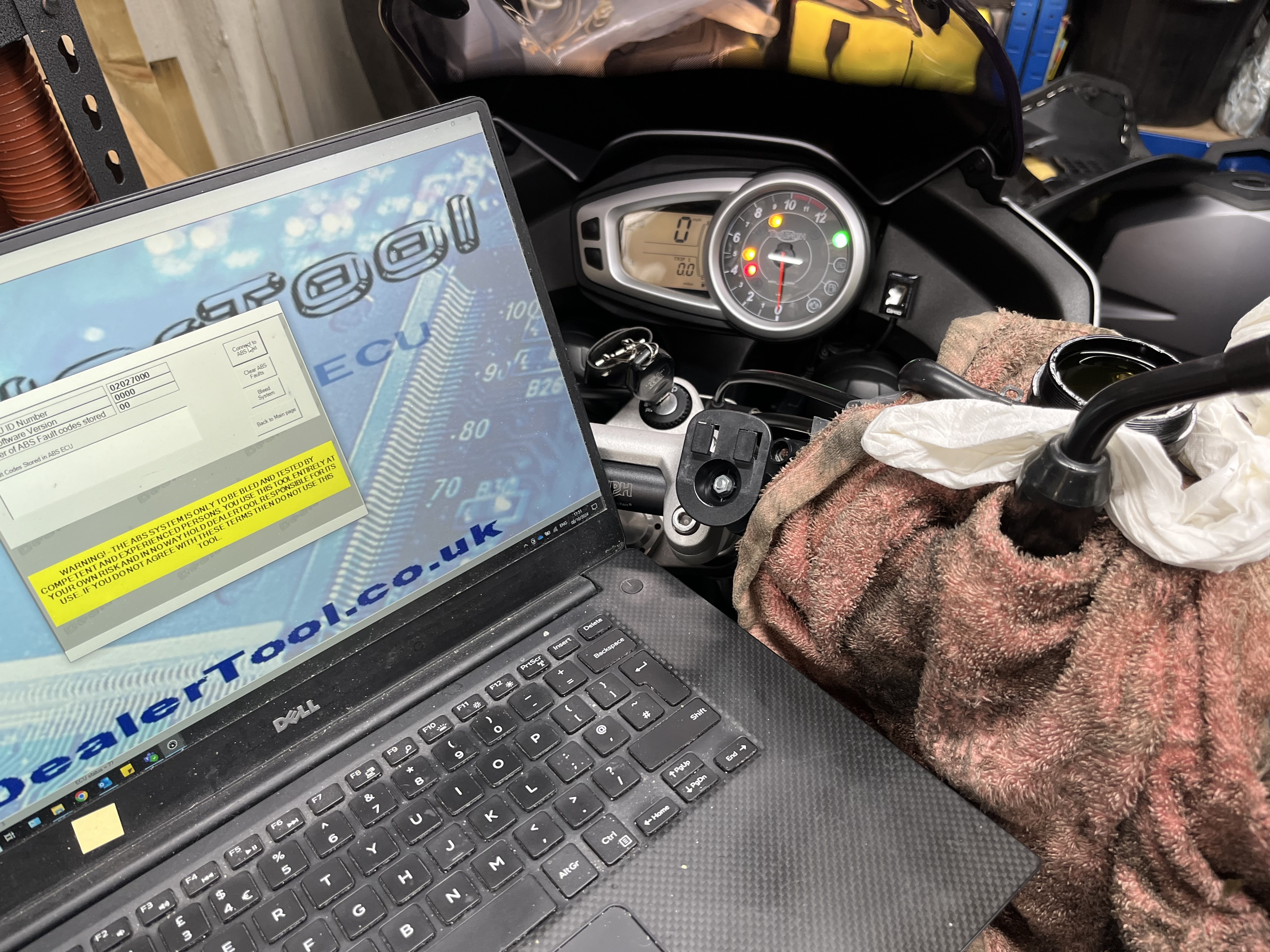

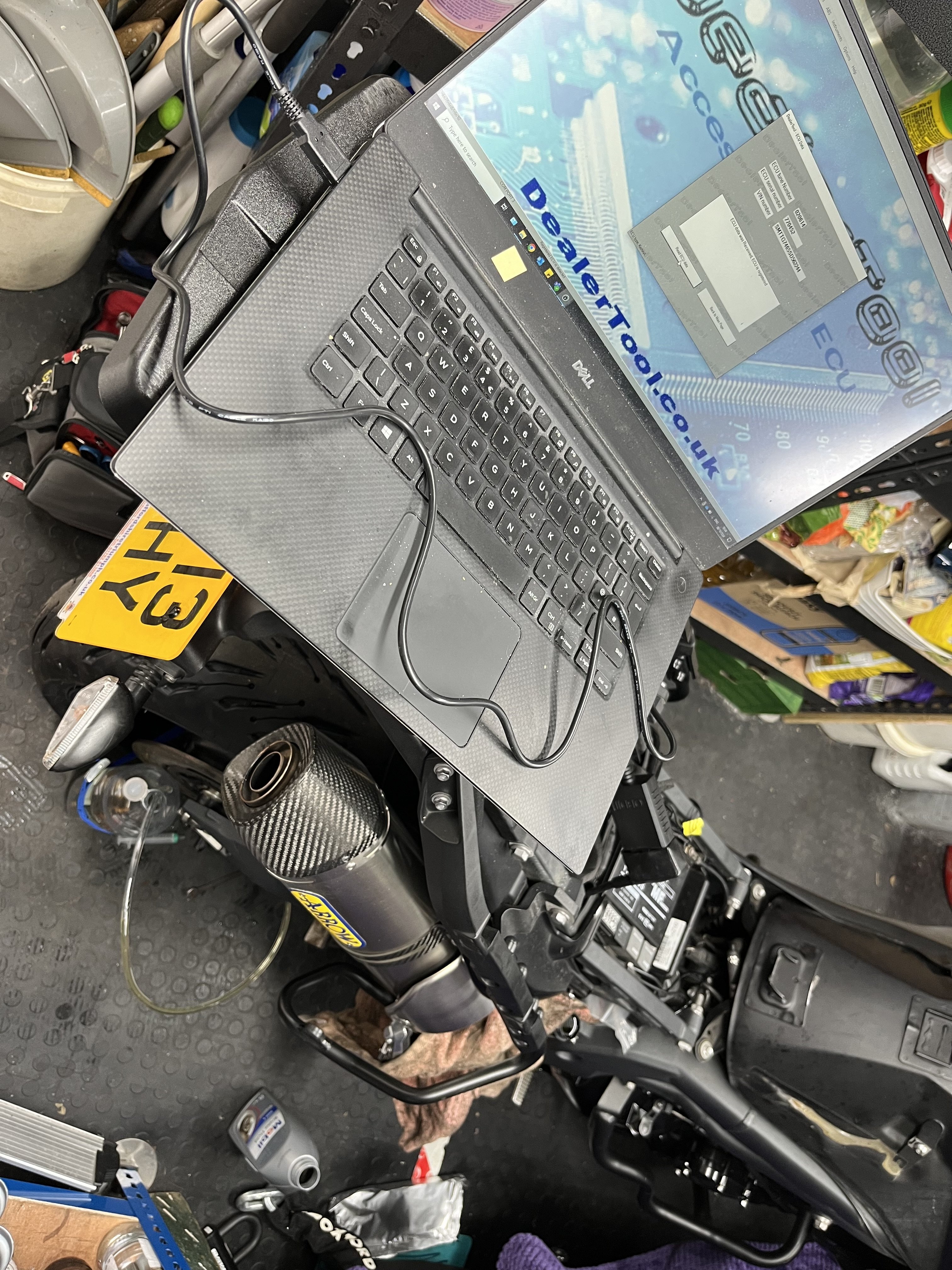

    Having done the brake pads I decided to do a fluid change (bought a Dealertool as it has the ABS) and got it sorted today. Easy enough and I reckon it’s been a long while since the ABS module has been bled.
    Did the rear first
    And then the front
    You actually bleed each system 3 times - normal first, then via the Dealertool and then normal again.

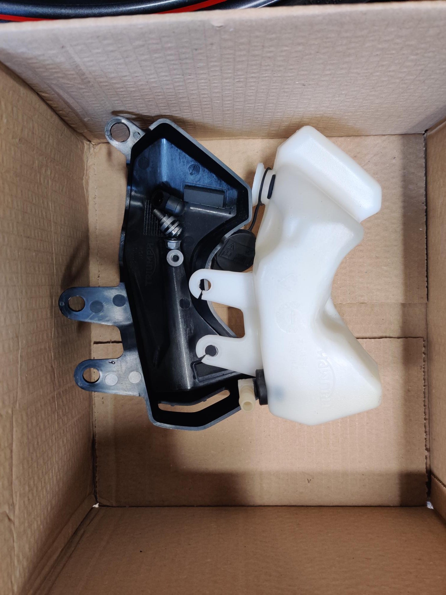

    A little more work today.

  10. Iceman
    Iceman Crème de la Crème
    Apr 19, 2020
    3,012
    Lancashire
    Another frustrating issue, my machine was serviced at my local Triumph Dealer whilst under warranty, thereafter I have maintained and serviced it myself. Upon removing the expansion tank I found the holes that secure it had a small section on each cut out, it wasn't from being overtightened at the factory and the plastic split, it had been cut, now I know something happened to the bike on it's first service as the Yoshimura link pipe was badly dented, I only found this out months later, the dealer denied being responsible (they fitted the exhaust brand new), I strongly suspect it had been dropped, as the left hand panel had been replaced. I used to trust this dealer but no longer. The moral is do it yourself and know the work is completed to a high standard.
  11. Iceman
    Apr 19, 2020
    3,012
    Lancashire
    Yes it's just one of those rare occasions that happen from time to time.
  12. Boothman
    Boothman Elite Member
    Jul 26, 2023
    1,135
    Wigan
    Why cut through the lugs? Doesn’t appear to be a wide enough gap to be able to slip over the fixing threads :eyes:. Most dealers are paying the minimum, charging the maximum and pushing through as much work as they can. Even if the techs know how to do it correctly, I suspect at least 9 times out of 10 they do the quickest job they can get away with.
  13. Iceman
    Apr 19, 2020
    3,012
    Lancashire
    Who knows, but the fact is someone did it and I very much doubt it came from the factory like that. The tank will pull over the fixing bolts, I did try it once I had removed it, and the plastic expanded no problem. My guess would be that it was removed for reasons related to the fall whilst in the workshop. However it is all supposition as only the technician really knows and it is clear they were never willing to own up in the first place. As an old school mechanic in a previous life I would never have dreamt of turning out poor work. Whilst a machine is under warranty my view is take it to a trusted independent workshop and keep the receipt and have the service book stamped, that way the warranty remains in place. Triumph have confirmed to me in an e mail, that if an individual owner self services their machine whilst under warranty, then it will be invalidated, immaterial if the owner is a qualified mechanic.
