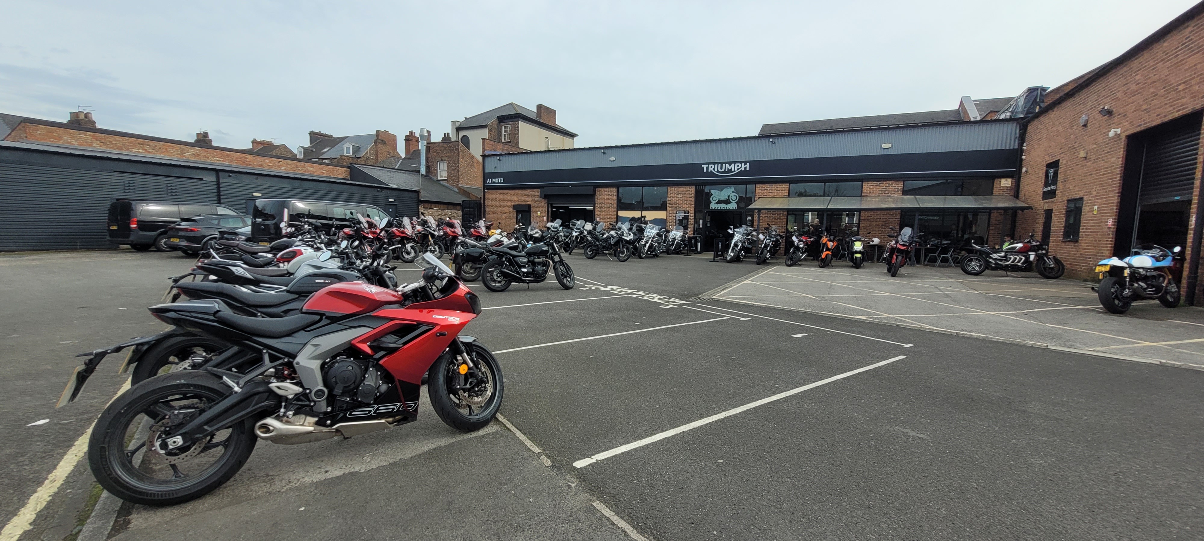

    Bought a bike off them many years ago when the shop was inside York city wall before they moved to their current premises. Got to know Darren quite well and was a regular visitor to A1. Definitely one of the better dealers.

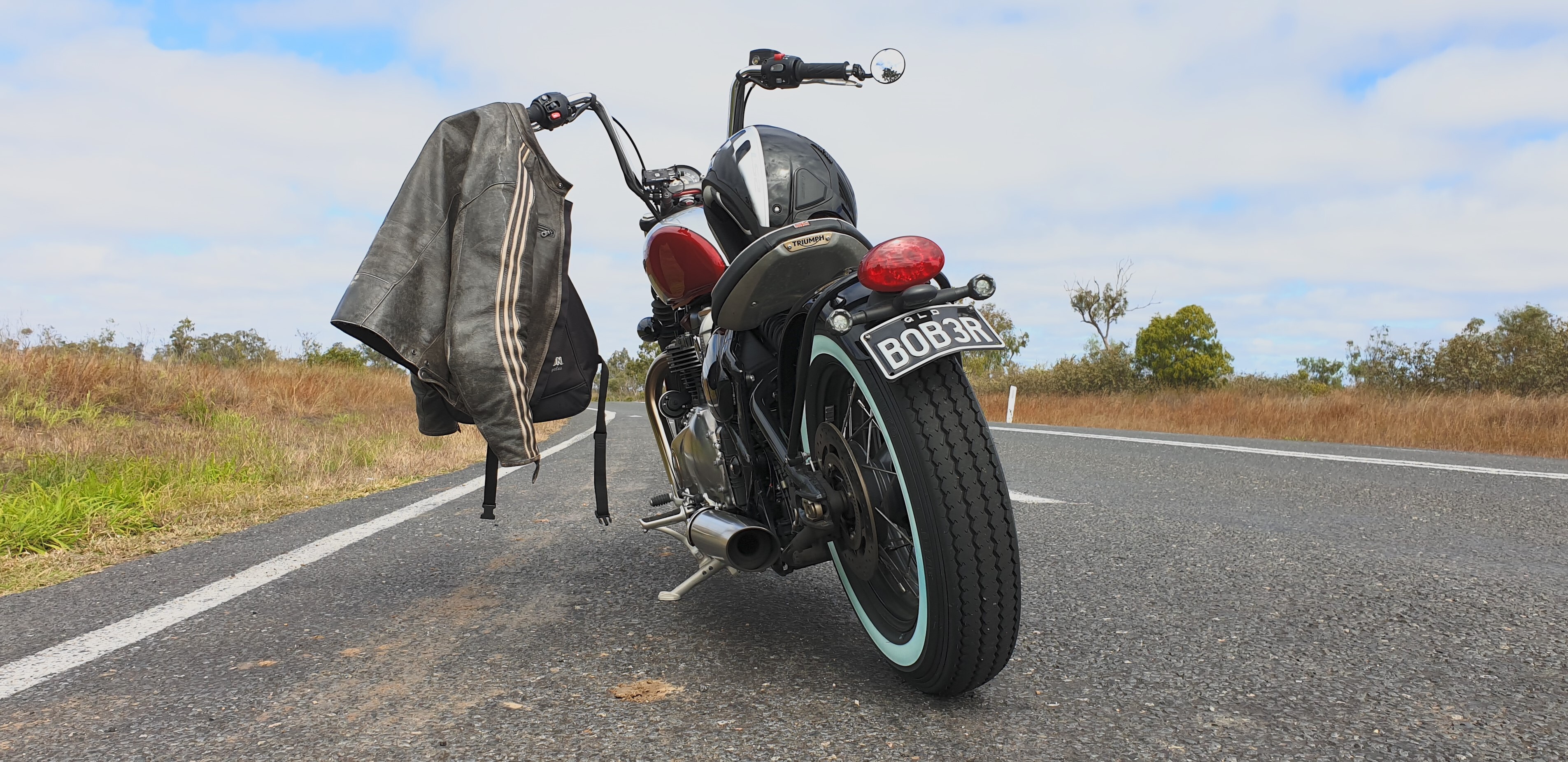

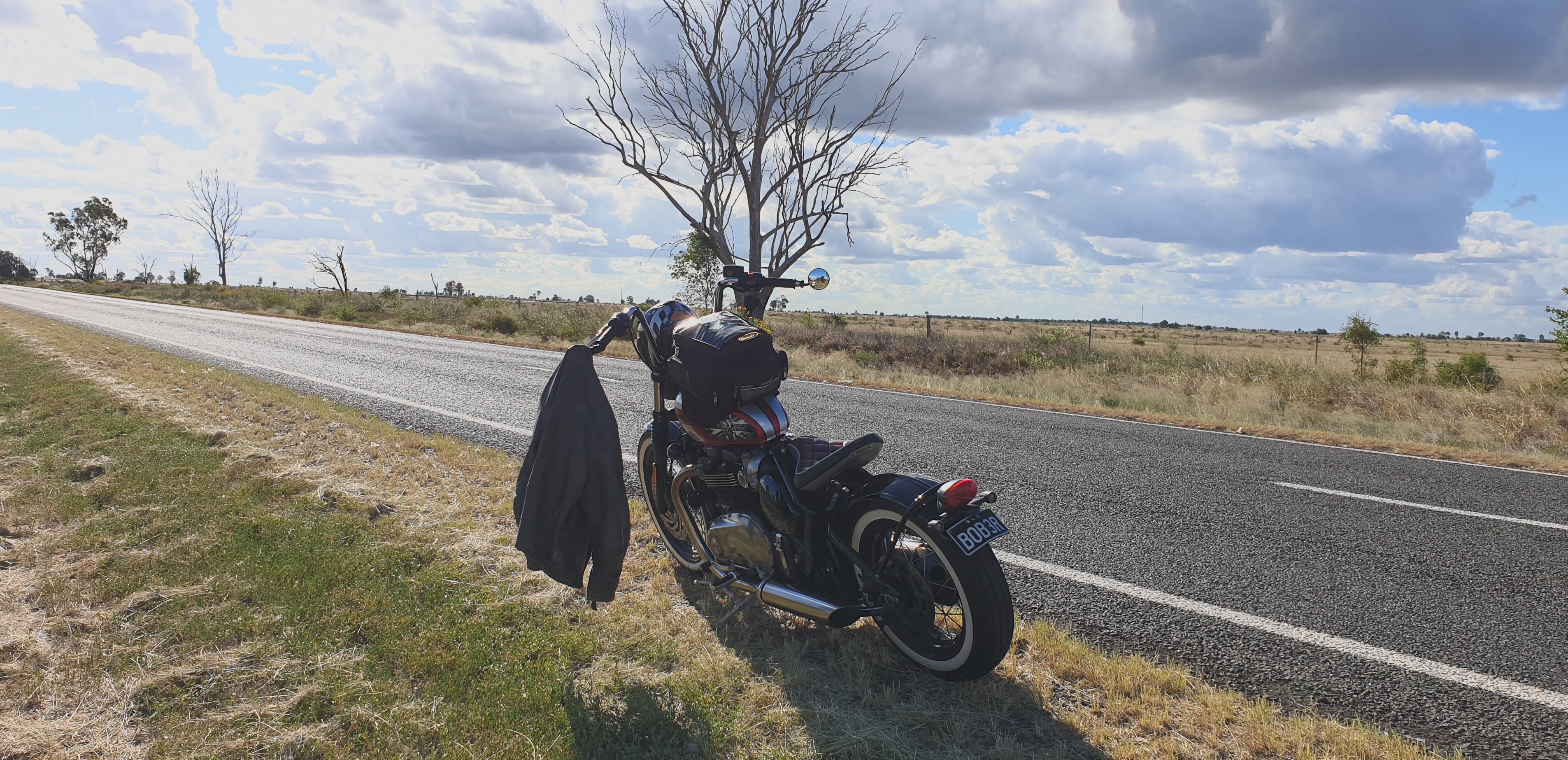

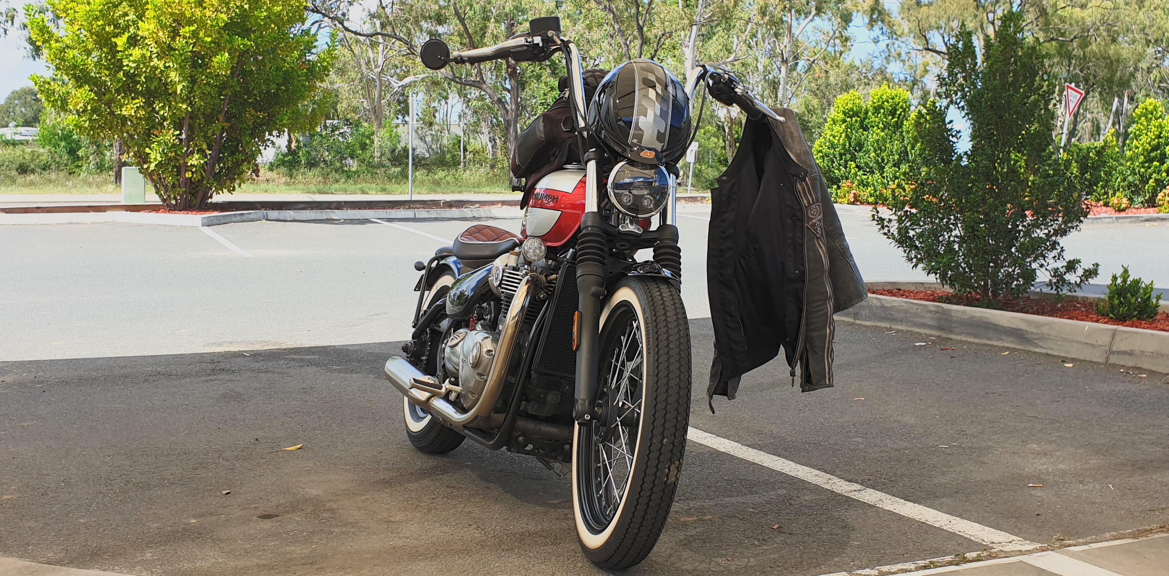

    Oot'n'aboot.
