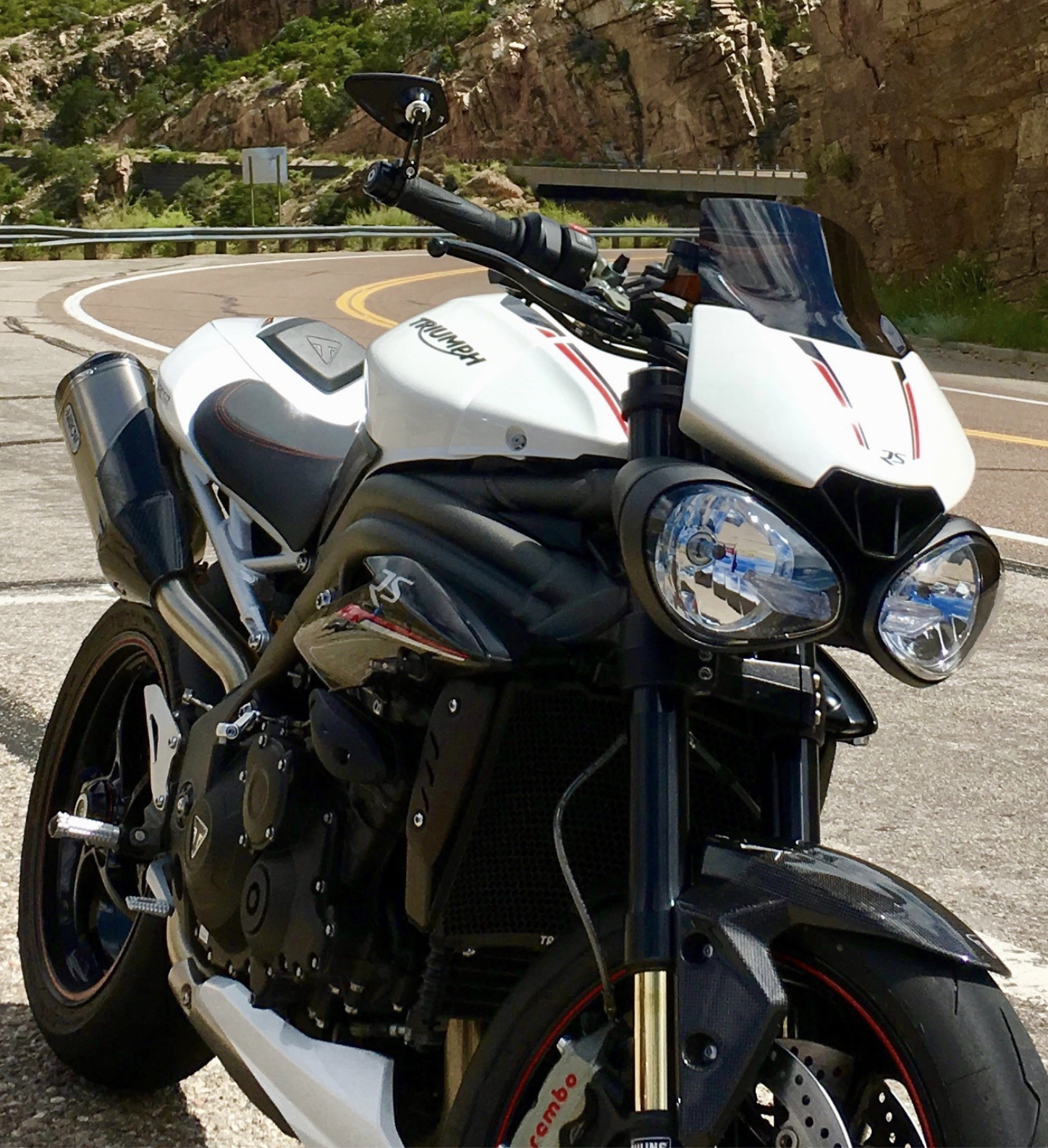

    I am obviously not @Jeff Standley @Wfc-james but have fitted a Powerbronze screen to my Street Triple R - it's slightly larger than the Triumph fly screen but not massive. I like the look of it on the bike and it does reduce the wind hitting me on my upper chest and send it up and over my head more. The change is not massive but I do enjoy the difference the screen has made and really like the look of it on the bike. I am shortish at around 167cm (5ft 5 - 6) and have a fairly forward lean on the bike due to my height in relation to the pegs and bars - I would imagine it would feel much different to a tall person who is positioned more upright on the Striple. @Helmut Visor says that he felt it on his lower - mid chest when he rode it before the screen was added and he is about 6ft 1 tall.

    @Wfc-james, I agree with @Mrs Visor and have the same screen. Powerbronze, on my Speed Triple RS. I really like it. This isn't the greatest photo of it (background noise) but I think you can get the idea. I like how it looks plus, as Mrs Visor said it reduces the wind hitting my on my upper chest and does divert some of it to the sides and over my head. For me the addition of the Powerbronze screen was worth the price. I'm about the same height as Mrs Visor or about an inch or so taller.

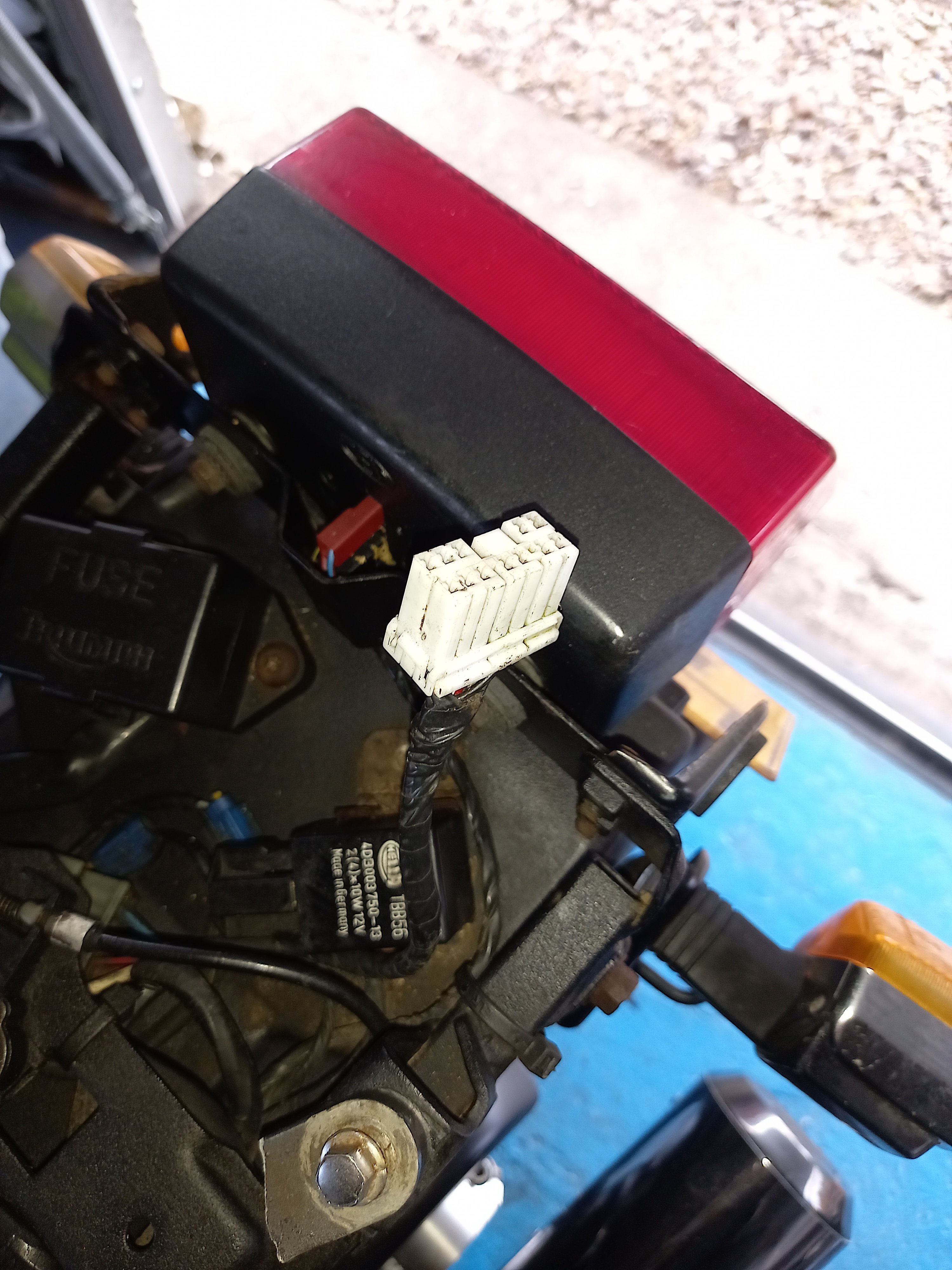

    I have a question for the good members, I have discovered a multi-plug at the back, there appears to be no mating plug, looked in the book of words to no avail, any ideas people

    Isn't that the plug used for diagnostic purposes?

    Thanks, hadn't thought of that right enough, restoring one of these machines is certainly a learning curve

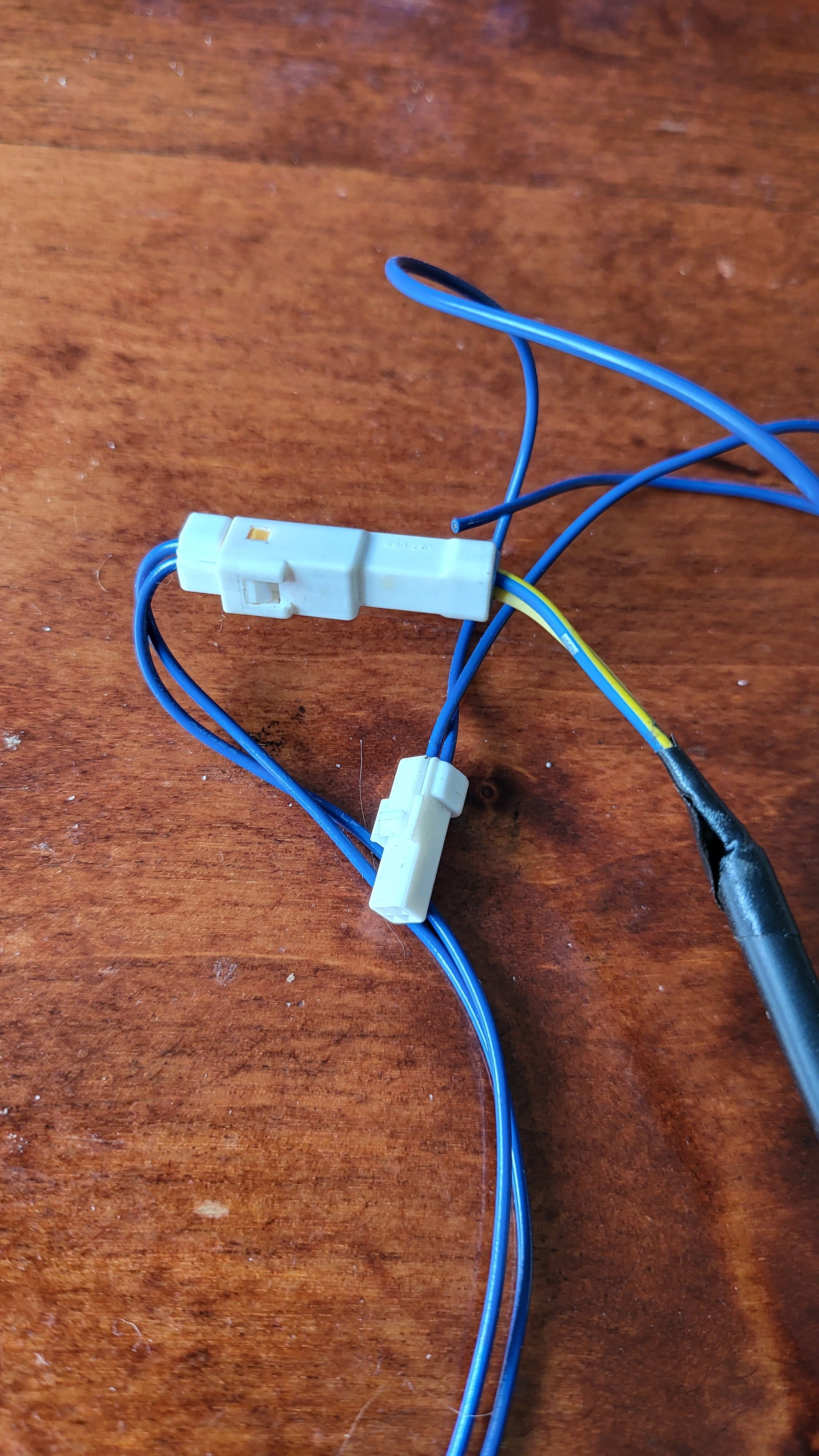

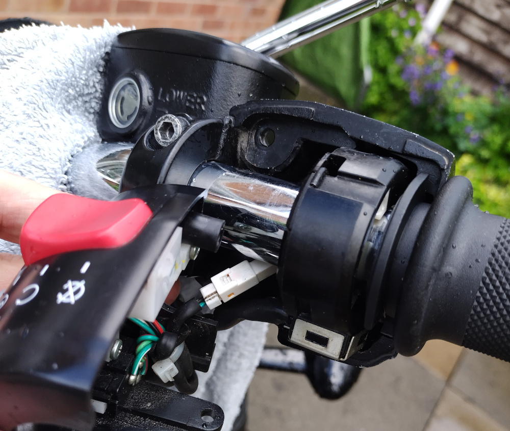

    Last week my right-hand heated grip stopped working and as Triumph only seem to sell them as a pair I had to fork out £210 :eek: They arrived today so I proceeded to fit the right one, only to realise as I was about to tighten up all the screws that I'd put the faulty one back on, doh! Then as I was in the middle of correcting this the heavens opened up and I was scrambling to find a plastic bag to stop the insides of the switchgear from getting wet. Finally after fitting them I checked the faulty one to see what had gone wrong, turns out the conductor in one of the wires had broken at the connector end. This is unsurprising as the cable is far too short and you have to pull it taught with long nosed pliers just to connect it up, really crap design...
    So, the grip is repairable, unfortunately I failed in getting the pins out the connector so couldn't do this now. What looks like the correct connector is out of stock everywhere (or rather the pins are) and on back order for October, so that's a project for another season.

    I have one of those connections that you are welcome to have. Pm me your address and I'll pop them in the post for you.

    Thanks very much for the kind offer :grinning: As I have new working grips I may hold out for getting new connector parts as I'd hoped to also use some highly flexible wire with them with the idea that would last longer. If getting parts look too tricky then I may well come back to you and take you up on your offer. Thanks again.
    Edit: It also just occurred to me that I may want to use wire with a high temperature insulation. The original wire looks different to the average stuff, with two layers and doesn't feel like PVC.
