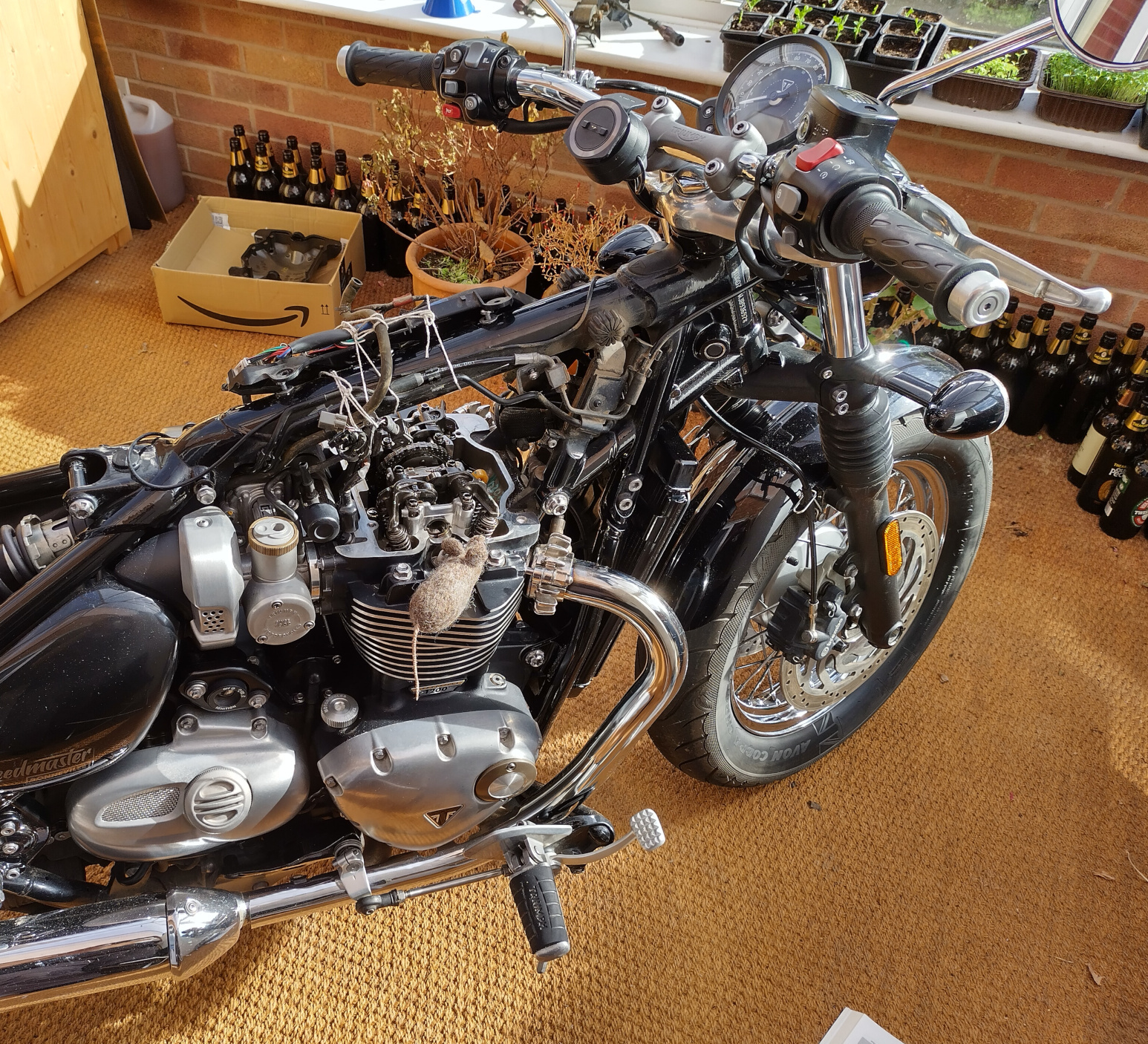

    That's what I did for checking valve clearances. But to check the timing you need to get alternator cover off to get to the timing hole which locks the crank shaft, so you can then check the cams are in the correct position relative to that. If I knew that timing hole was aligned with TDC then I could instead get a gauge down the spark plug hole to get pistons at TDC and check the cam timing without getting the alternator off.
    It's getting the alternator cover off that's the part of the service I'm dreading, as by all accounts it's a right pain to seal right when putting it back together (because of the rubber grommet where the alternator leads exit). In fact the factory got it wrong when they assembled my bike, giving me an oil leak in the first few hundred miles :(

  7. brown mouse
    brown mouse Elite Member
    Sep 15, 2018
    2,288
    943
    East Midlands, UK
    Triumph water-cooled twins have a slotted cam sprocket too. The service schedule has 'camshaft timing check' listed, not 'check/adjust' like valve clearances so unsure if bad timing means worn stuff needing replacement, or just adjust. Also, the service manuals doesn't mention a timing check procedure, just how to set timing when installing a sprocket, which I guess is same thing. Support guy at triumph confirmed that, though couldn't explain why the engine service kit they sell didn't include alternator gasket, just the cam cover one.

  11. brown mouse
    Sep 15, 2018
    2,288
    943
    East Midlands, UK
    Thanks, that's very interesting. BTW, I did start a thread a few days ago in the Technical Help part of the forum, which may be a better place for this conversation and not bore other people here with this? ;)
    I just added there that the Triumph service manual seems to say the timing slot on camshaft corresponds to TDC on cylinder one, and I can get that position via the spark plug hole, no need for removing alternator cover.

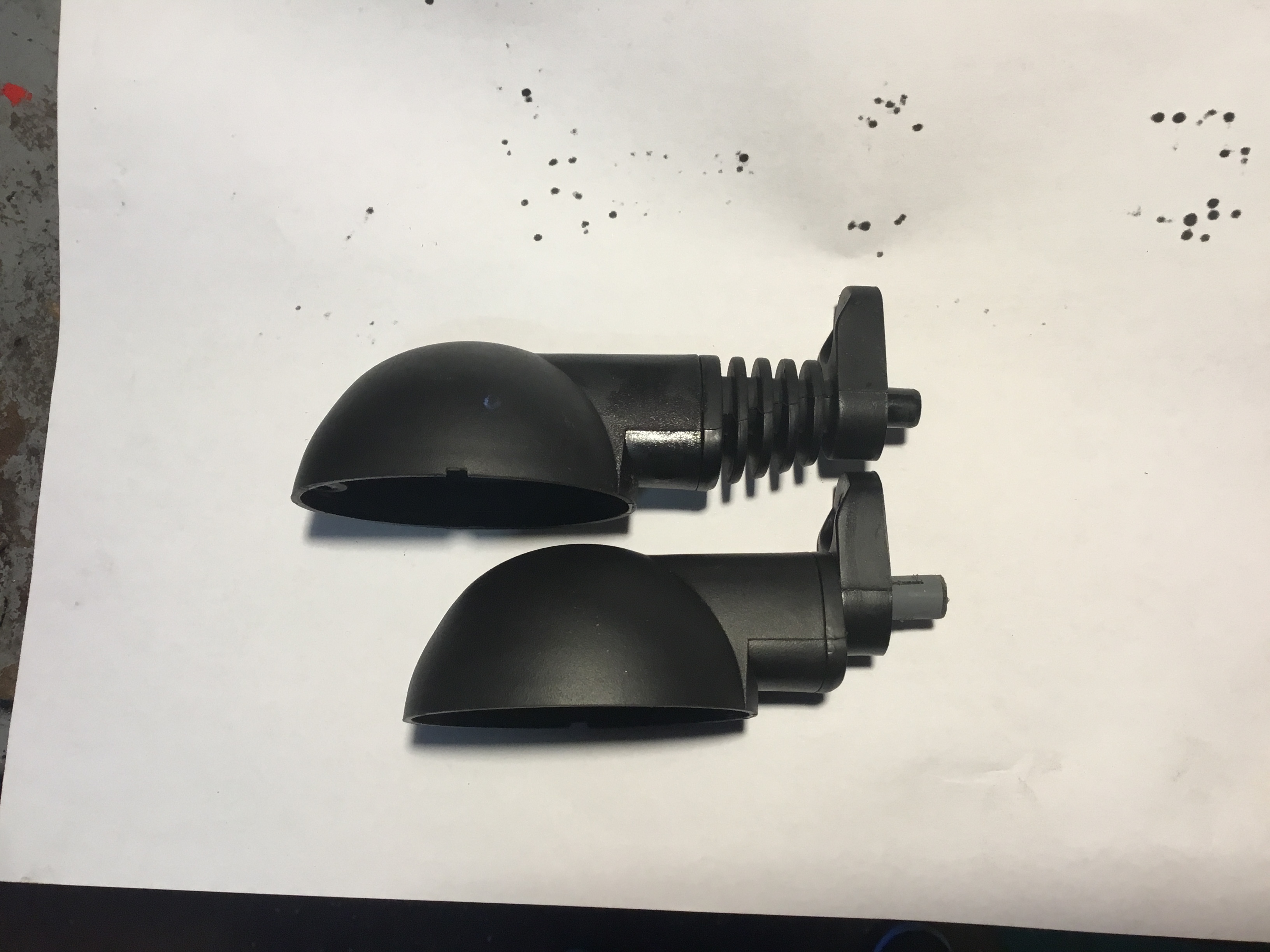

    Shortened the indicators on the Scrambler. I like the fact that they're quite large and bright for good visibility, personally I'm not a fan of those tiny smoked LED offerings, but they stick out quite a bit so I shortened them by about 1" which I think has improved things slightly.
    standard.....
    comparison....
    result, minus the barn door number plate...

  17. brown mouse
    Sep 15, 2018
    2,288
    943
    East Midlands, UK
    Day 3 of servicing. Alternator and rockers off to check timing, which looks OK. Laborious scraping of old gasket off. Then 3 of 4 rockers back on, with some smaller shims on one. Measured clearances and found the shims I hadn't changed had gone down, and the ones I'd changed for smaller sizes were still the same clearance :( (yes, I rotated engine loads to try and get things seated right).
    Called it a day and opened a beer :) Still waiting on more shims, so will be a few days before re-assembly).
