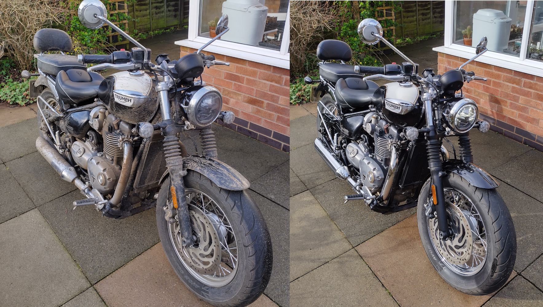

    After yesterday, had a bit of cleaning to do, a before and after...

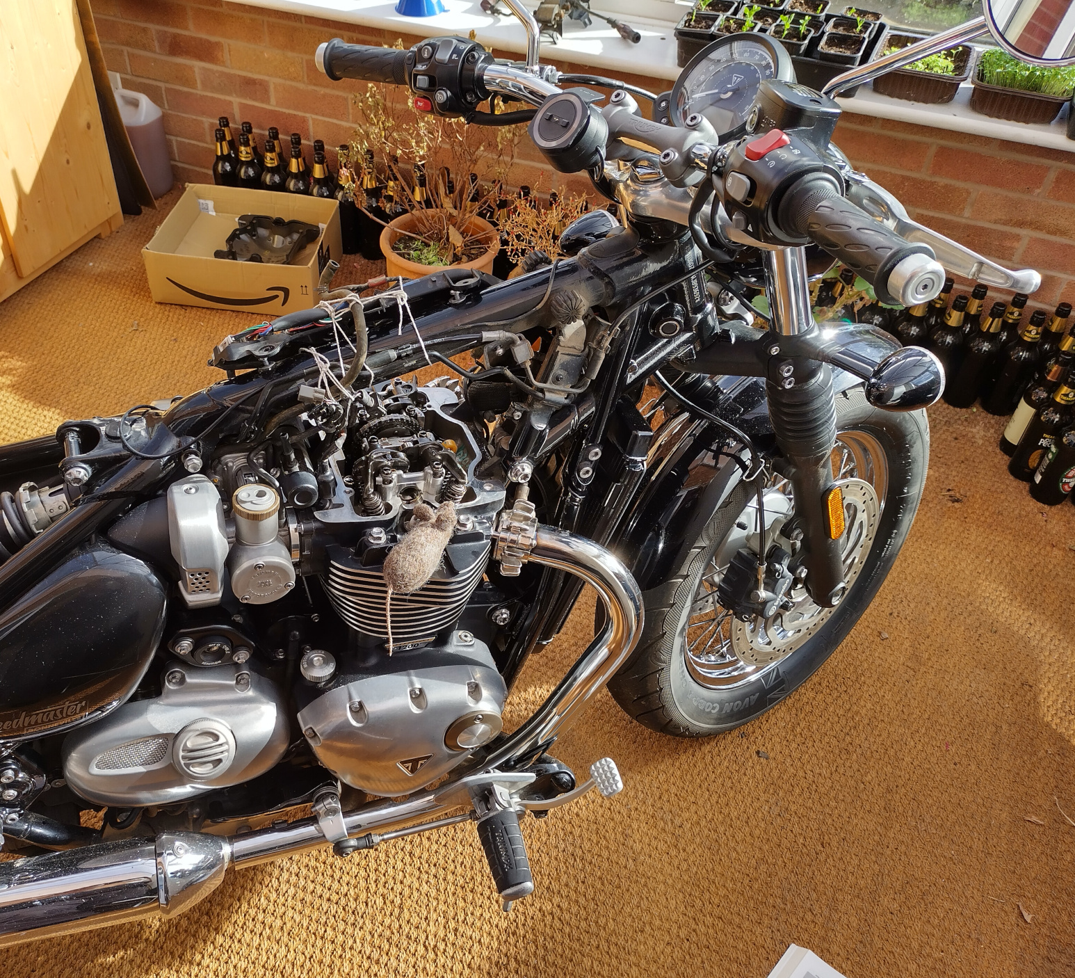

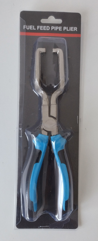

    Day two of servicing. Took me an hour to get petrol tank off because I couldn't work out how the wiring connectors came apart, plus trying to push in the clip on the fuel hose without the pliers that Amazon were meant to deliver yesterday. Then another two hours dismantling enough stuff to get cam cover off. Neither Haynes manual nor Triumph service manual quite had all the steps, and neither seemed to realise there's a wiring harness and holder in the way to get at the ignition coil mounting screws. Finally I got to the stage where I could measure the valve clearances, good job I've got tiny eyes to see those tiny clearances...
    Exhaust clearances were fine, inlet clearance on one side were just under spec, and on other side only just over. So plan on adjusting both. Put in another order with Fowlers, which unfortunately doesn't have much of the shim sizes in stock, so may have to try again, or elsewhere. At least the order will include alternator gasket and other bits I need for checking timing, so that's something I'll should be able to do over weekend.

    Those fuel hose clips can be a right bu@@er to undo. Not the best design, I don't think...

    Amazon just delivered the pliers I needed this morning, they seem to fit well to press in the buttons on either side of the connector (I tried it on the already disconnected hose). At least I have them for next time.

    I used these on the SS....
    https://www.ebay.co.uk/itm/SUZUKI-9...YABUSA-/274400574354?var=&hash=item3fe38c7b92
    I already had some circlip pliers with changeable jaws so I made some for the fuel hose clip out of some very stiff wire.
    Just put the bike in top, with the plugs out and turn the engine over with the rear wheel. Measure each valve clearance between the base circle of the cam and the shim (when the lobe of the cam is pointing away from the valve). Thats how I do mine, no need to bother removing engine covers etc.
