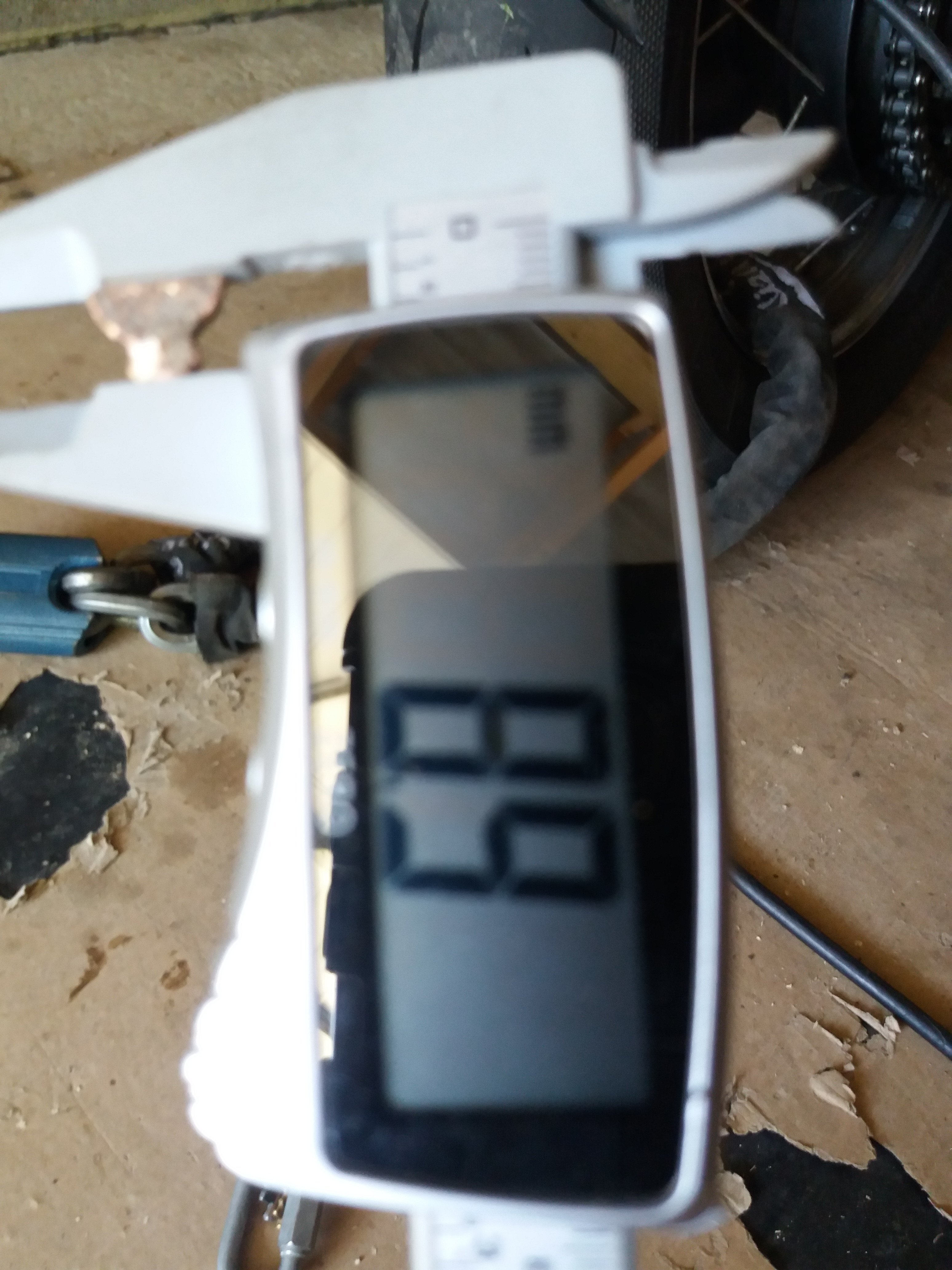

    Speedmaster adjuster bolts advice.
    I had my rear rear tyre replaced the other day as I picked up some road shrapnel, (a bit of a road worn key), and decided to change as sometimes take my other half in the back.
    I went for a ride and had a new noise coming from the back wheel. When I got home I jacked up the back and span the wheel, it all seemed ok apart from back disc rubbing slightly on pads.
    I checked bolt adjusters and the RHS was 11.1mm and the LHS was 11.8mm
    My question is would that make a difference to wheel alignment and cause the rubbing?
    ...and should any adjustment be done on the side stand or on a lift?
    The chain tension is within the given range.

    Perhaps this would be more appropriate in the 'Technical Help' forum, but answering here anyway...
    I would set the adjusters equal on both sides as a matter of course and check the torque setting when undoing axle to see if it was tightened correctly.
    Do you know adjusters matched before the wheel change? I can't see why they would have needed to be changed for tyre replacement, so perhaps the sliders aren't sitting flat on the adjuster bolts head?
    To answer your questions...
    I can imagine that with wheel axle being a little crooked that might cause brakes to rub, if say the caliper carrier was flush to the swingarm rather than the spacer in the wheel (though I find all my brakes rub a tiny bit anyway). I could also imagine things moving slightly under changing load causing some noise. Having said that, I'm just speculating here and the 0.7mm difference isn't massive.
    I don't think it should matter whether the bike is on a side stand or not when making adjustments. I personally use a rear paddock stand because that makes everything simpler (bike upright with no weight on wheel).

    Hermann - Yep, everything that Brown Mouse says.
    May be worth looking to see that your chain is running straight just to confirm everything is ok.
    I always put the bike up on something so that the rear wheel is running freely - paddock stand/jack/centrestand/bag of cement/pile of bricks etc. Do the chain adjustment in the normal manner by loosening axle nut, loosening both adjustment lock nuts and then using one of these - along with the measurements on the adjustment bolts and axle
    I use for all chain adjustments to ensure the rear sprocket aligns with the front sprocket. There are more expensive and more accurate measuring devices available but this will give you some peace of mind that the wheel is running true. Over...

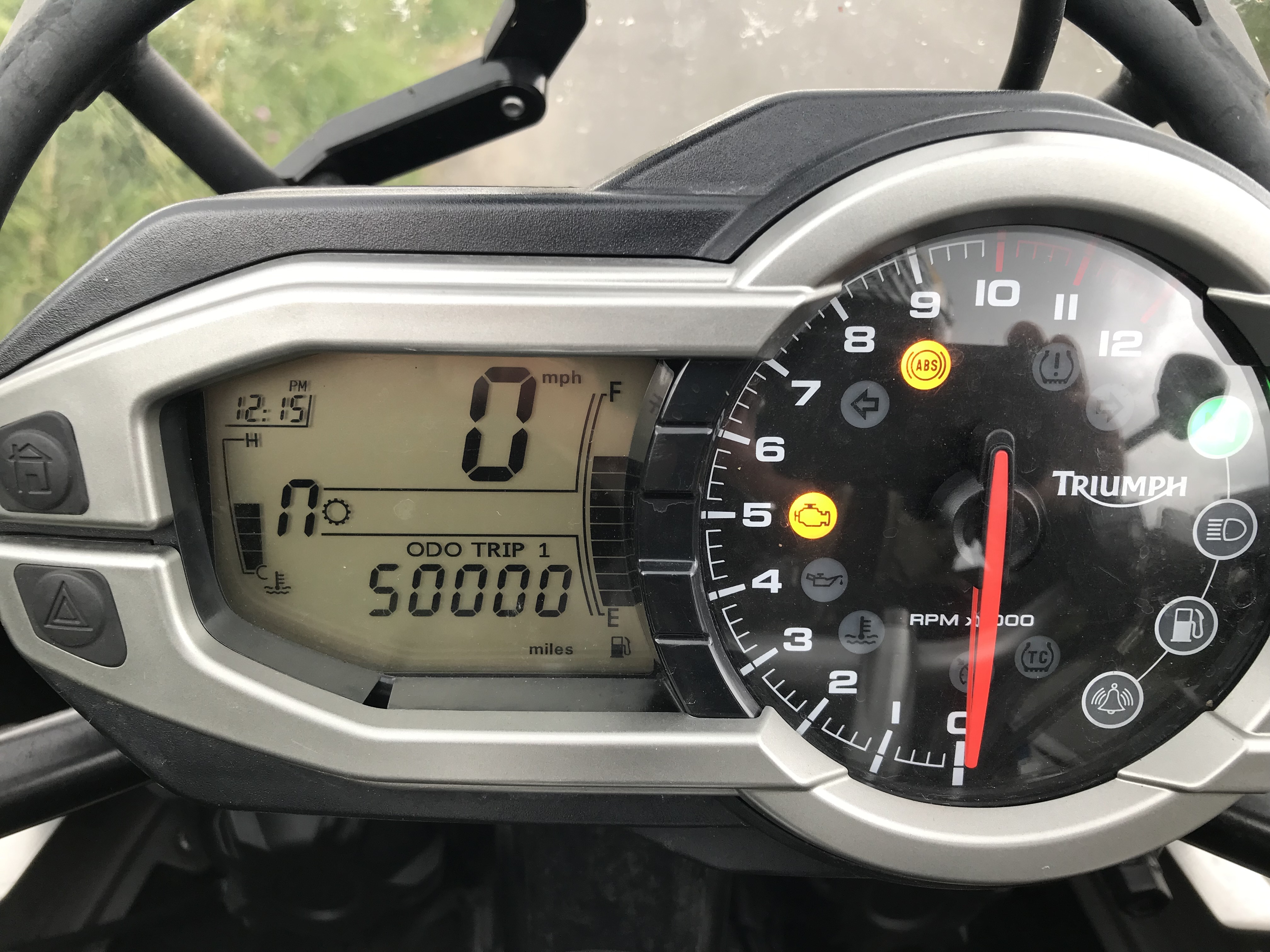

    A quick ride out into the Peak District which included my 50,000th mile on my Explorer.

    Thanks @brown mouse, yes sorry to 'jump in' but I was in the garage pondering my problem so was 'what have you been doing today'...
    To be honest I can't see that 0.7 mm would make that much difference but I think I will try to minimise that as much as possible and see if it helps.
    I didn't check before hand so no idea of pre tyre change values. I did check wheel axle bolt torque and did it to 110NM, although specified torque maybe this was a little too much so going to check that too. Thanks for your advice.
