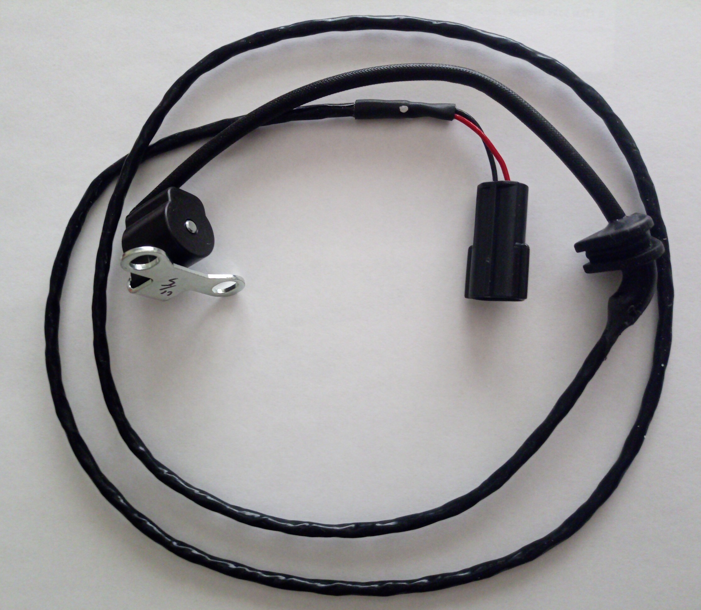

    Well might not be today ! But I will be doing the following Work on my America . The ignition timing pick up coil needs replacing (130,000 klms) so did ok there ! I have the parts ! And one of my air horns/tubes between air box and the throttle bodies is perished ! So two ways to tackle these , do two together , air tube is ordered. Pull air box out and have more access to wiring harness for pick up , do air tube at same time , but don't know when that part will arrive ! Or do pick up then ride until tube arrives . Been finding wear and tear age related problems as I pull down parts the last few weeks.

  15. Sprinter
    5,993
    Hi capt how do you know the ignition timing pick up coil needs replacing ?

    Went for a ride with SWMBO last weekend , ran fine all the way out to the Ettamoga pub in Cunderdin. On the return trip temperature in the mid 30's and just over half way home , the engine started to stutter , cutting in and out ! Changing speed or gears made no difference. When almost home and slowing right down, it stopped working.
    Thursday I borrowed a multi Meter , did checks , alternator windings ok , infinite resistance on all three windings - engine off , steady 50v AC on all three running, tested ignition coil pick up cold ok 500 odd ohms , hot almost full resistance , 1200 odd ohms on 2000 scale . IMG_20200111_105510_223.JPG IMG_20200111_105407_323.JPG
    New unit acquired yesterday.

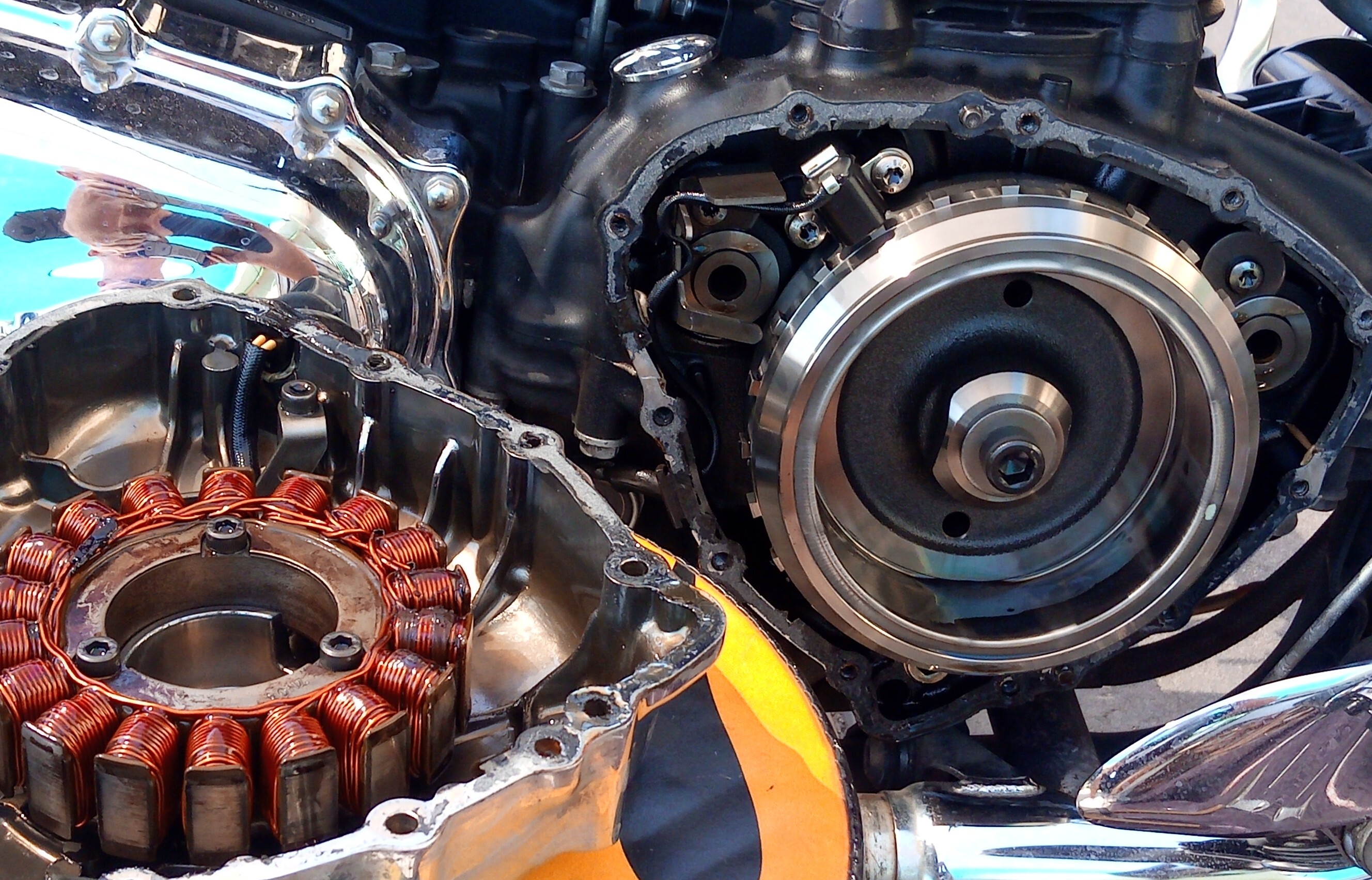

    The old insitu about to come out , picks taken about an hour ago. Break then back to it ! Granddaughters visiting this week , but they are out today until about 14:00 hrs , so just under 3 hrs to try finish it up :) :)

    Here's how I'm keeping the innards of the motor clear of old gasket scrapings. IMG_20200111_132553_448.JPG
    Plastic oil bottle cut one side out , oil or grease surface and push into the housing , plastic blocks scrapings falling into the workings and oily surface is sticky so fine particles adhere . Working outdoors on this.
