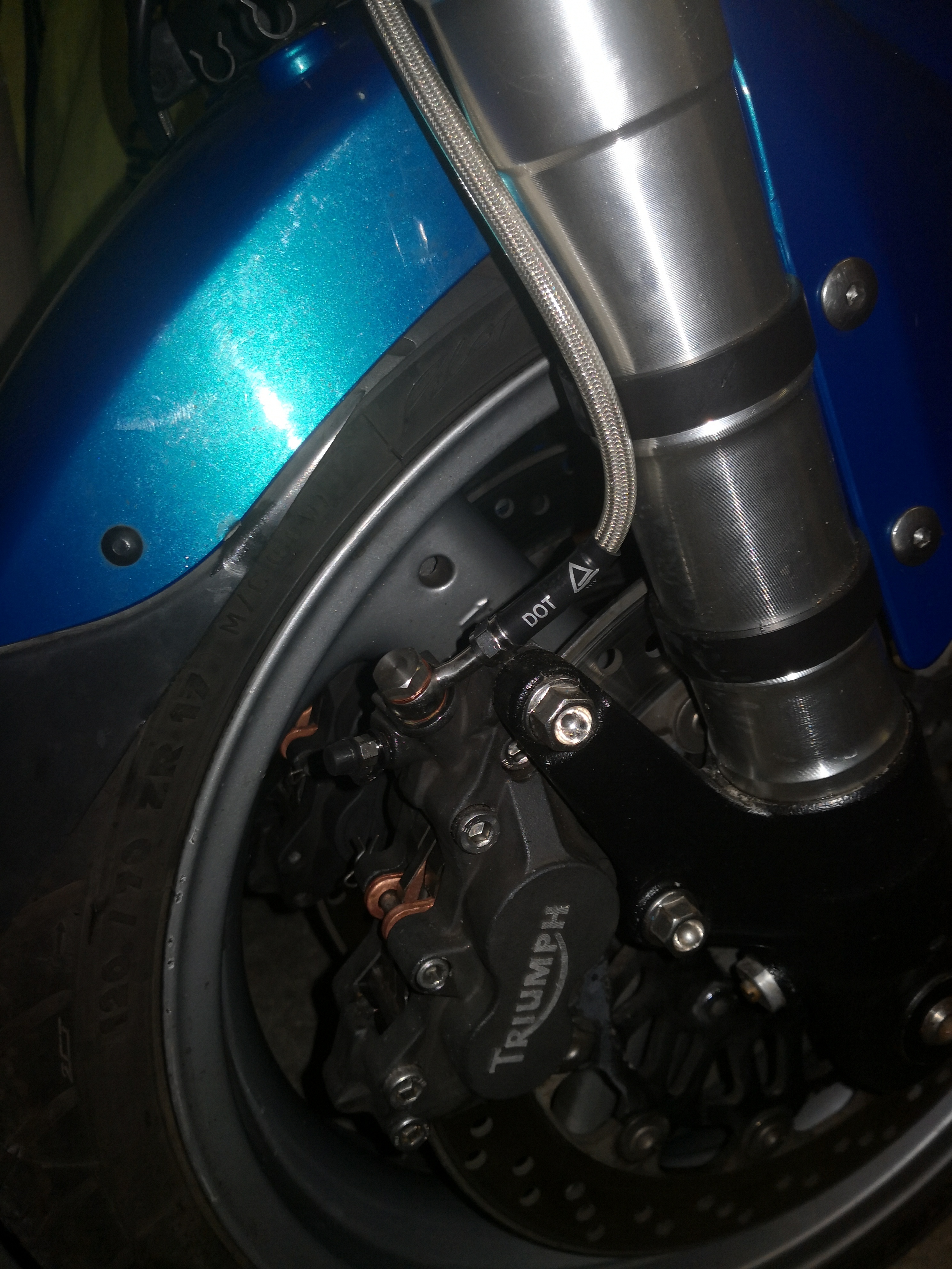

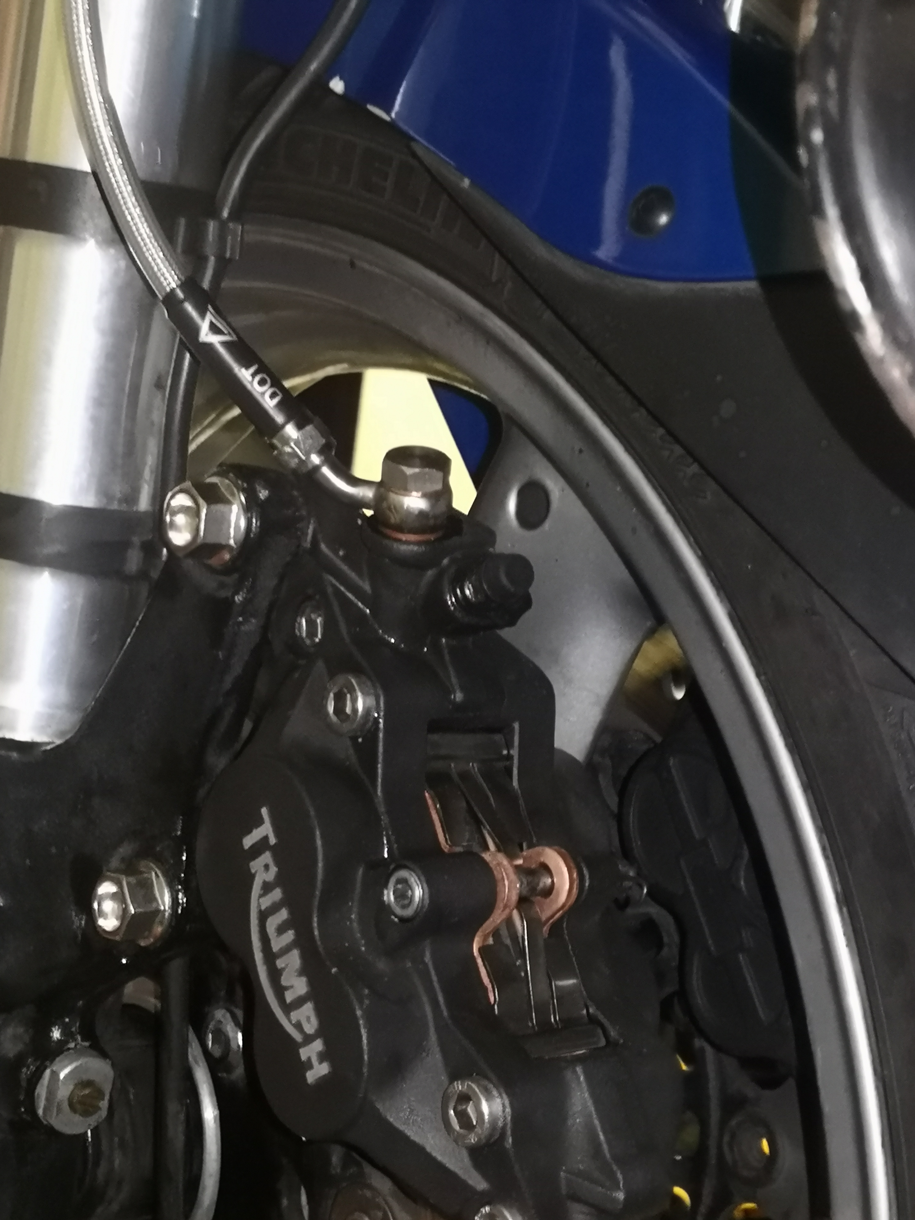

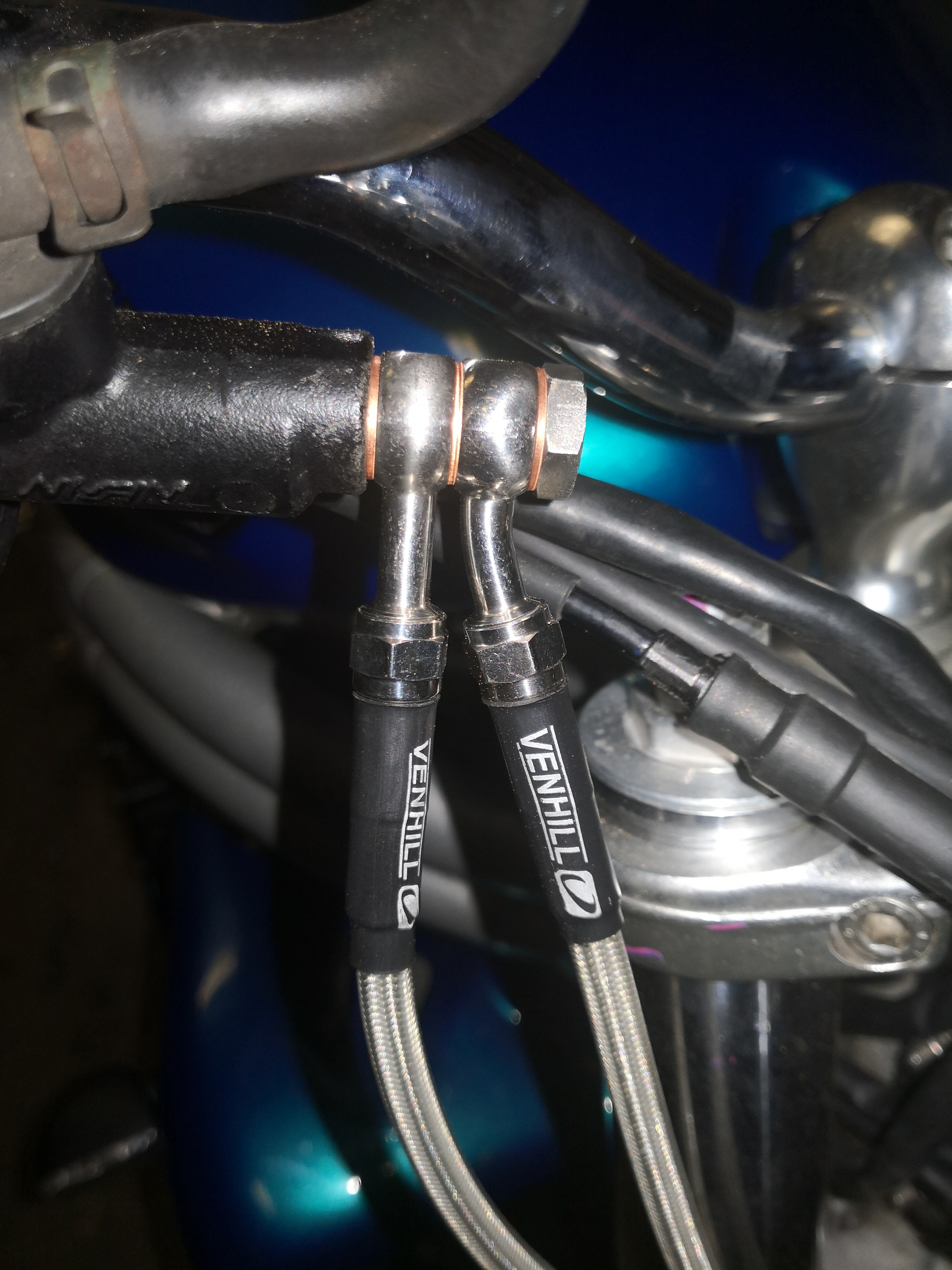

    In November I adjusted all the valve timings...then got busy refurbing all the brake calipers....then got even busier replacing all the brake hoses...
    After many weeks....everything went back together as it should...and my big beautiful burly blue bike coughed and spluttered and then ROARED in to life ... A welcome sound, and then a welcome ride out this afternoon.
    I got some fantastic brake hoses from Venhill Engineering, they really finish off my bike nicely.
    I am well chuffed!
    Thank you to all who have been with me on this odyssey - you know who you are!
    Safe riding all....

  10. DanielB
    DanielB Noble Member
    Jan 13, 2019
    887
    393
    Abingdon, Oxfordshire
    Oh, yes, sorry....

  13. DanielB
    Jan 13, 2019
    887
    393
    Ok, ok, I know how you're a sucker for a photo...
