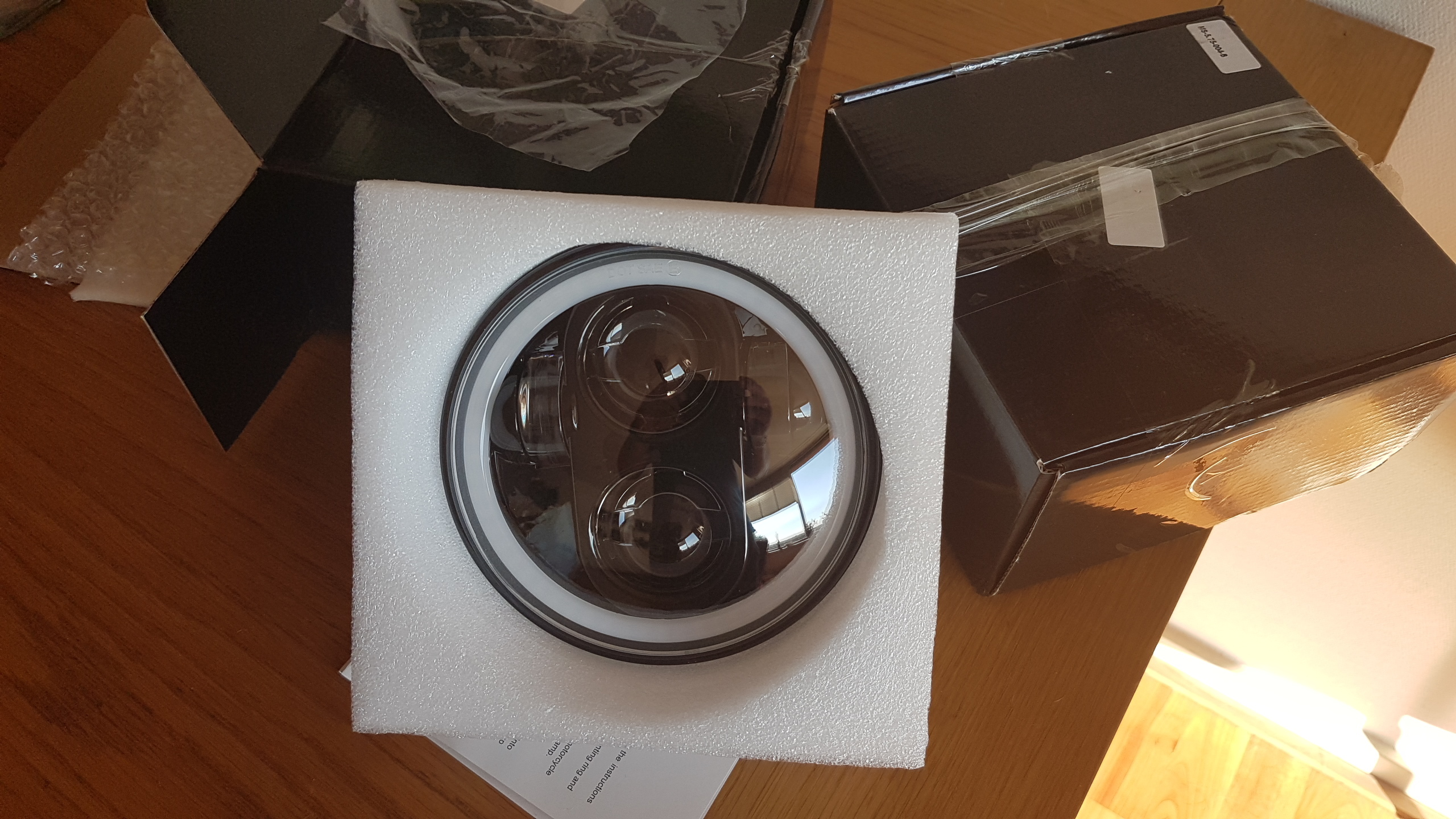

    I wired the parking light to the halo DRL, and added a switch to the dipped beam feed so I can run with DRL's only.
    The lip on the unit is quite thick but fits OK with deep rim, depends what you have (I found doesn't fit with Storm rims)

    I've got the standard 2005 bug eyes - so that should fit ok then?

    Can't say for sure as in my case I was converting from Dame Edna's on a 2015 bike.
    But have a look here, @Red Thunder has done the conversion on a 2010 bug eye with what looks to be similar units (looking at the packaging I would guess they're from the same manufacturer) and had no problems.

    Aye, I got a lovely pair off Amazon delivered same day
    Very easy to install in the chrome round headlight housing
    Had to raise the housing as they were pointing too low
    Very much worth the investment

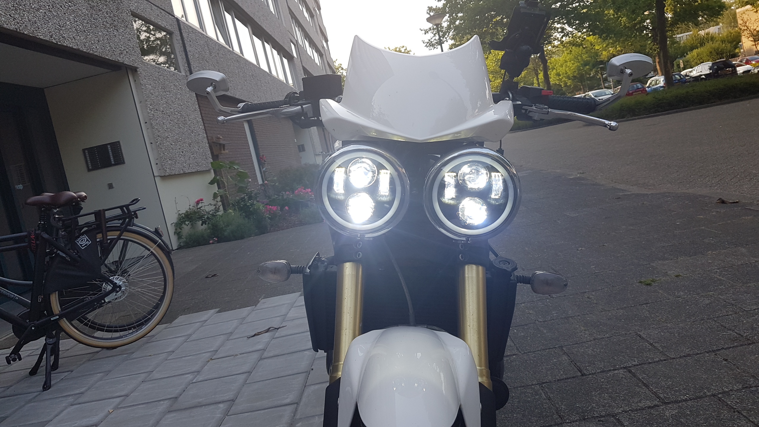

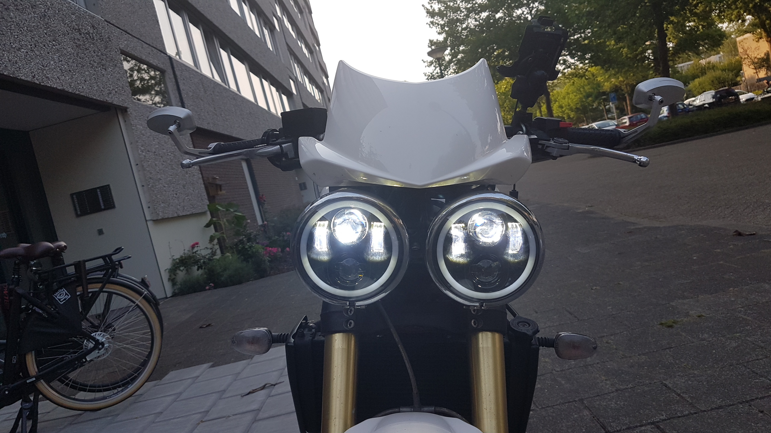

    Well, I've got them in. Bit of a fiddle, they wouldn't fit with the bracket in, so I left those out. Looks great, I think!
    Before
    Dipped

    @Col_C so I've got them in, but the outer ring doesn't light up. I suppose that's to do with the single red lead coming out of the assembly? The drl connction that's in the original assembly has a black and a yellow lead? I'm an absolute electrical noob I'm afraid.. can you enlighten me?

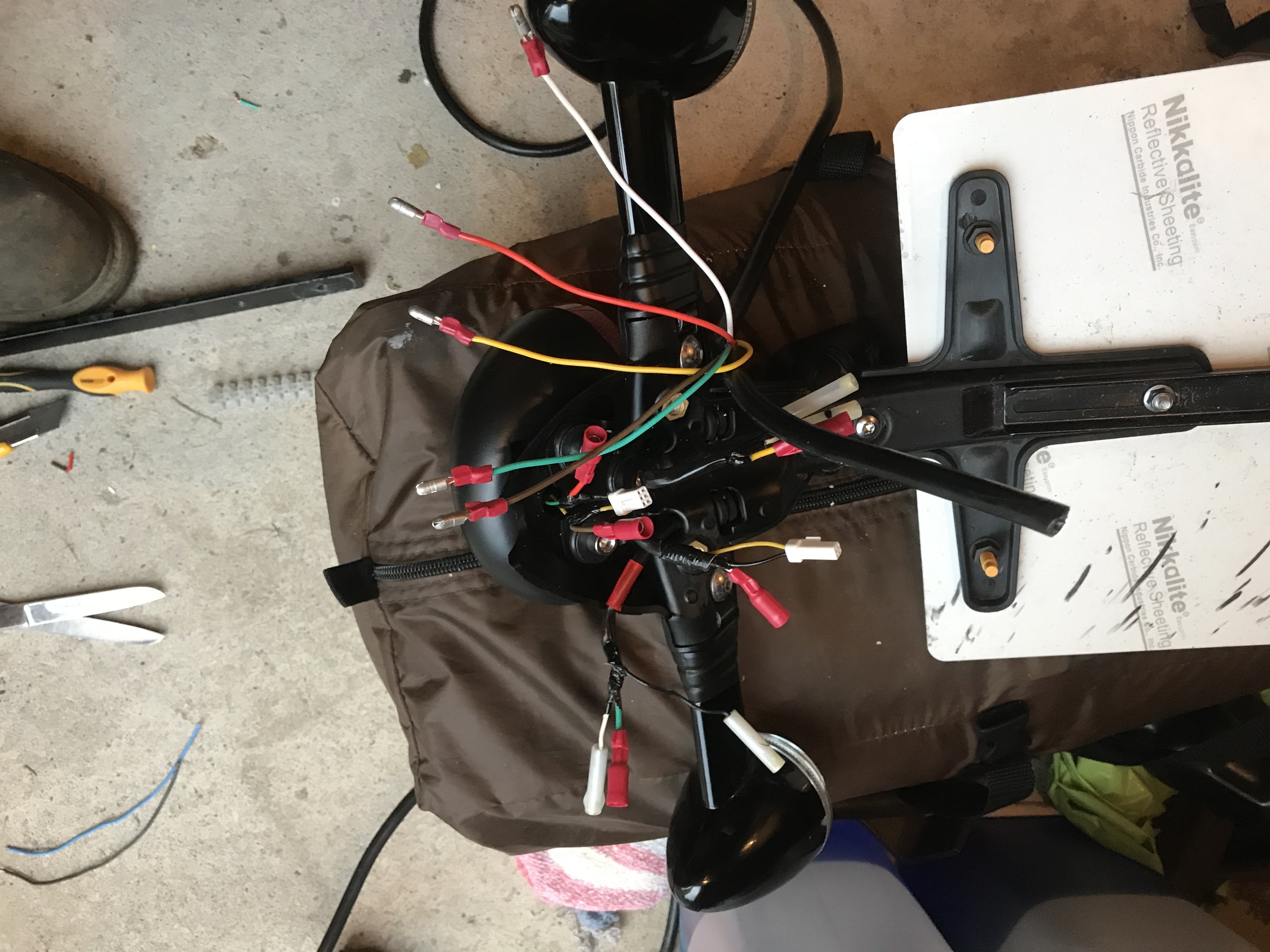

    :) Took a deep breath and went back in the garage tonight after tea :)
    Staying calm and cool :cool: I persevered and got the new LED lights to work with the lights on NUDGER :eek::grinning:
    Removed the wiring and removed the top box rack :)
    Refitted pillion seat and grab handle :)
    All back to standard for Saturday when NUDGER gets his heated handlebar grips fitted :)

    Yes, see my post on previous page of this thread, the lead that used to go to the side/parking light now needs to be connected to the single lead for the halo DRL. If you want to run with only the DRL's and no dip beam you would need to add a switch to the dip beam feed to disconnect that (assuming your bike always runs dip beam as standard)

    @Col_C, I'd seen your previous post - what I don't get is how to connect the parking lead to the drl. Can I just connect the black or yellow lead?

    Cut the park bulb holder off, put a spade connector on the yellow lead and plug the DRL lead into that. Black lead is -ve earth which you no longer need so just tape the end up.
