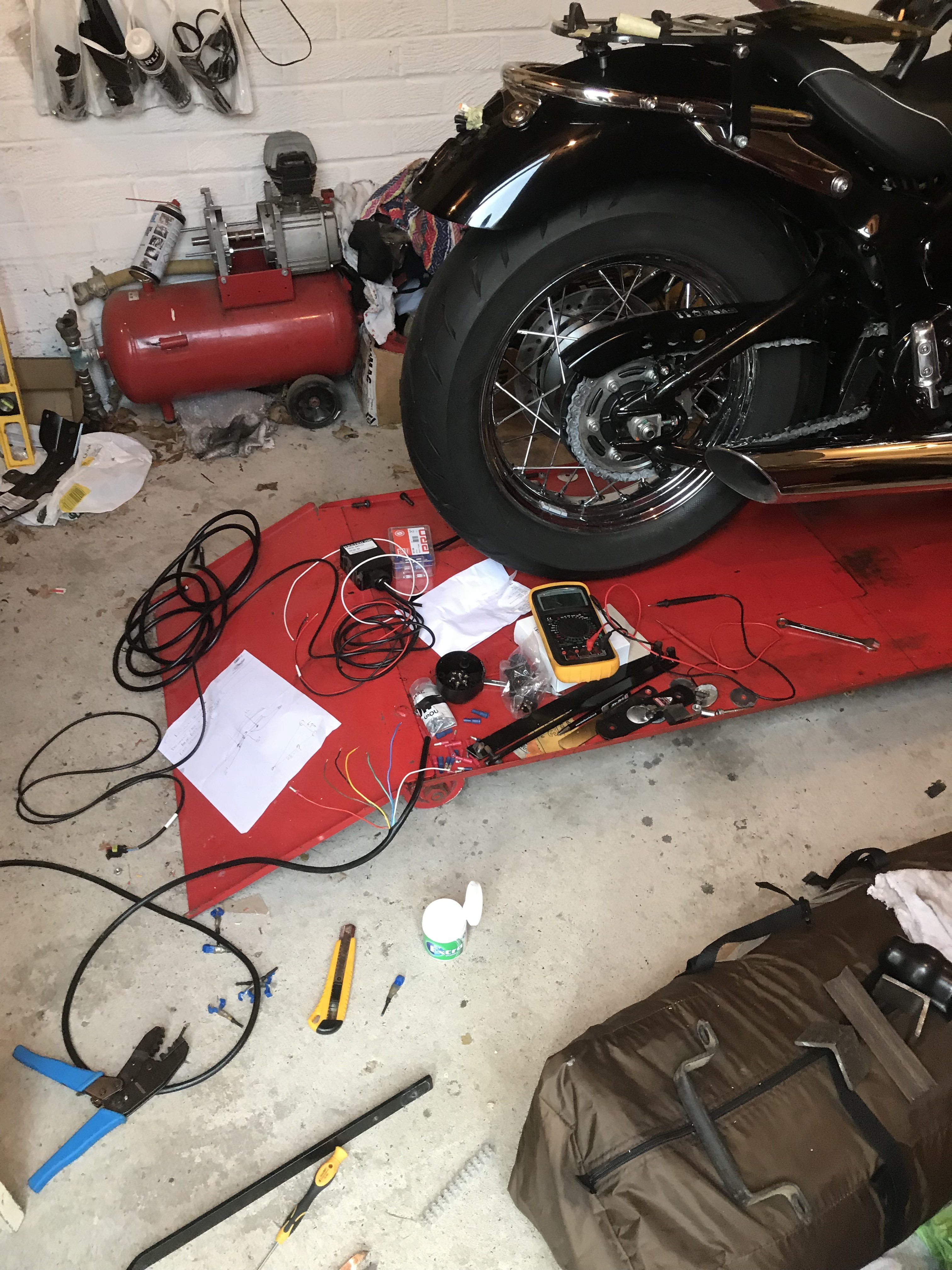

    Got myself a borrowed :rolleyes: LED trailer light cluster from work and set about trying to get it to work from NUDGERS electrical system :confused:
    Have had to remove the whole rear light/number plate assy to get at the wiring :(
    First of all I identified the earth on NUDGER which is BLACK :cool:
    The earth on the trailer lights is white :eek:
    Now comes the clever bit :grinning:
    I know the wiring colours for the trailer lights but not for NUDGER :(
    So I got two sewing needles from wor lass and attached one to the white earth on the trailer lights and stabbed it into NUDGERS earth wire :imp:
    Then took an educated guess and using the other needle attached it in turn to the wires on the trailer lights :confused:
    By stabbing the wiring on NUDGER and turning the ignition on I have identified all the wiring and have it marked up with masking tape :grinning:
    I’ve said it before...bloody wiggly amps is the work of the devil :imp:
    I’ll get there in the end...hopefully :confused:

    Behind the right hand side casing on my Tbird is a 5 pin plug that feeds the rear electrics on my bike, so was easy to identify using pretty much the same as you did, only difference mine was a test light with a needle sharp end and a crocodile clip to earth. just sliced each wire from there to my own plug direct to trailer plug.

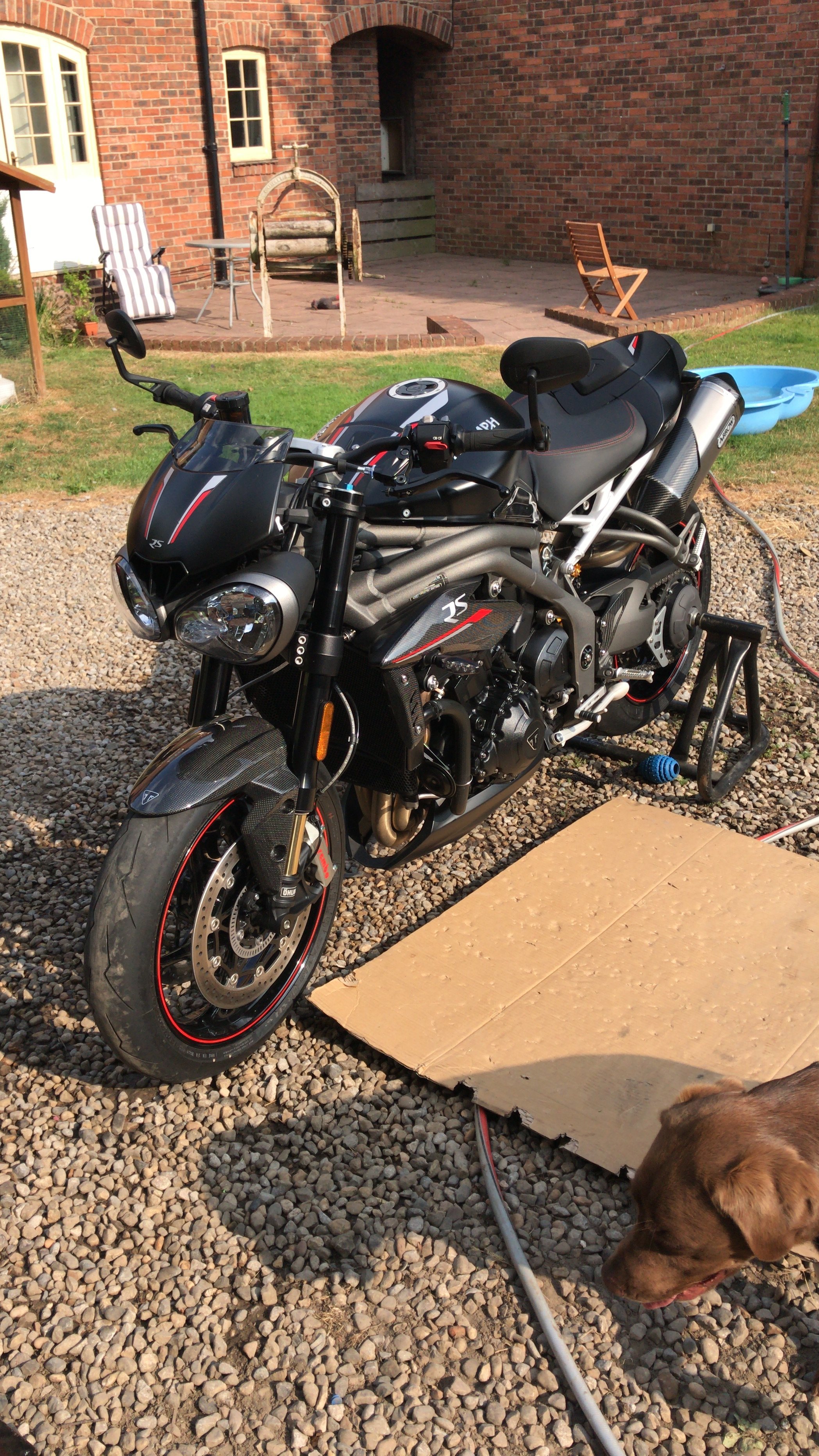

    Other than the above today, I changed the oil and brake fluid on my 2016 Speed Triple R, got the service light removed.
    Needs a final clean and she will be up for sale
    18,600 miles
    Comfort seat
    Triumph visor
    ZVMX heavy duty gold chain
    Excellent condition with full service history
    Just gotta work out a price to list it at

    :mad: Been to work all feckin day :mad:
    Half past seven now :(
    Still no further forward :mad:
    GRRRRRR :mad:
    Bloody wiggly amps I feckin hate them :mad:

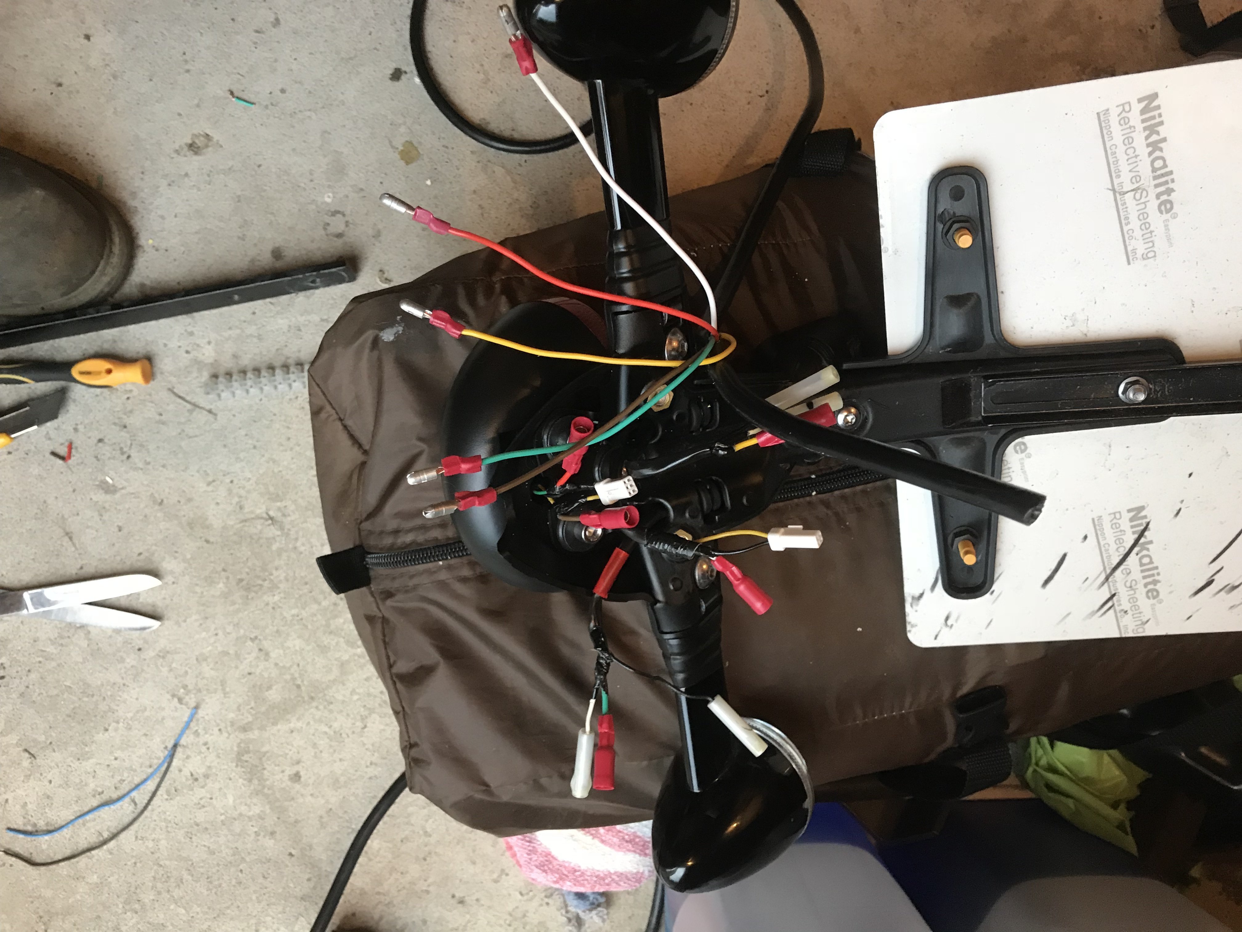

    :mad:GRRRRRR :mad:
    Started this bloody job at work today :pand invested some of my own money :eek: in some fancy connectors a bit like scotchlocks with a female connection that takes a spade connector :)
    Feckin useless things didn’t work :mad:
    Had to start all over again with bullet connectors :mad:
    :mad:Grrrrrr :mad:
    Bloody wiggly amps :mad: 873DA9B3-9123-4B68-A0E2-C879D30B245D.jpeg full day at work again tomorrow :(
    Then another night in the bloody garage :mad:
    :imp:It’s the work of the devil I tells ya :imp:
