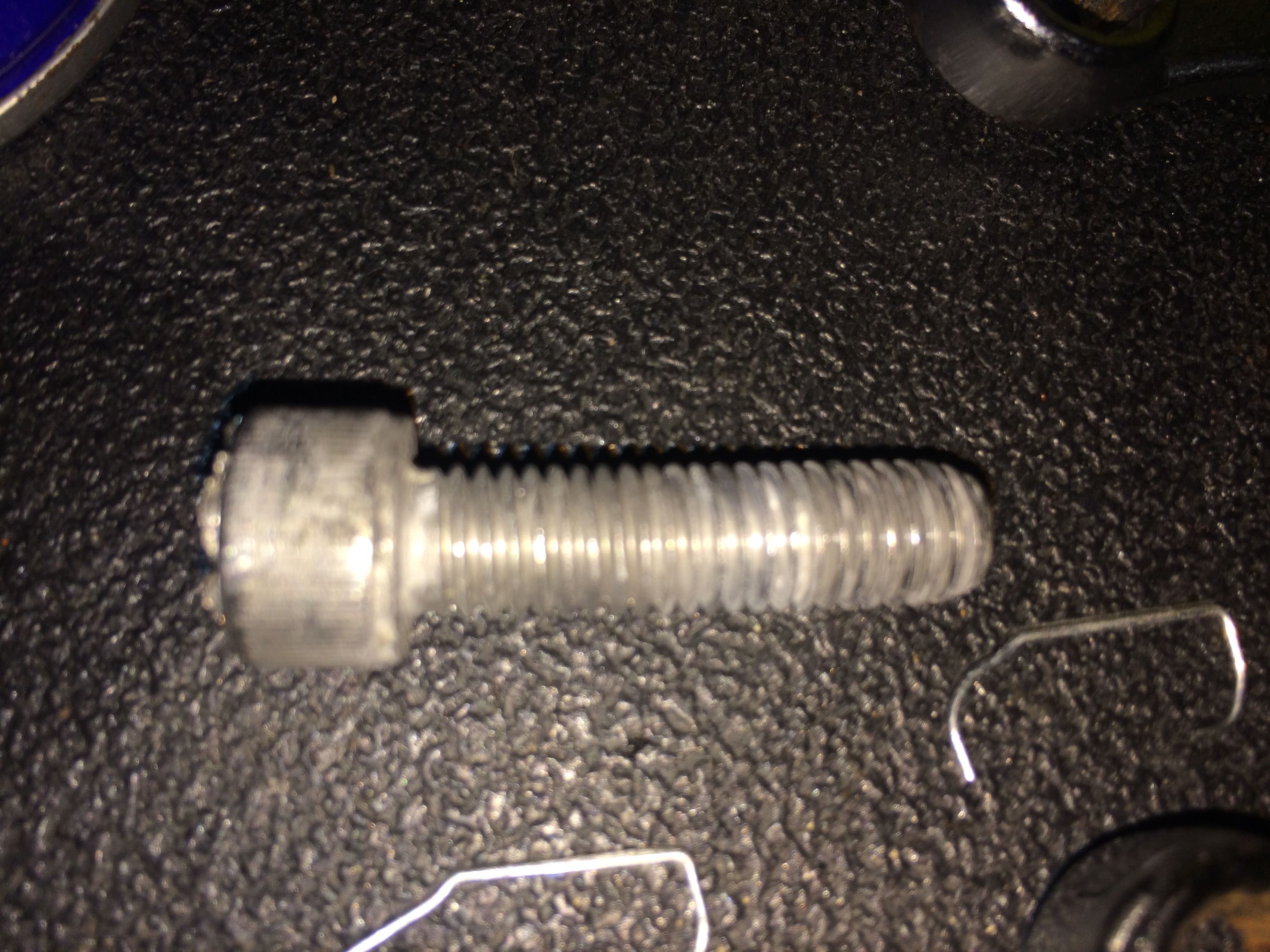

  8. Fourbears
    Fourbears Noble Member
    Dec 8, 2017
    505
    Norfolk

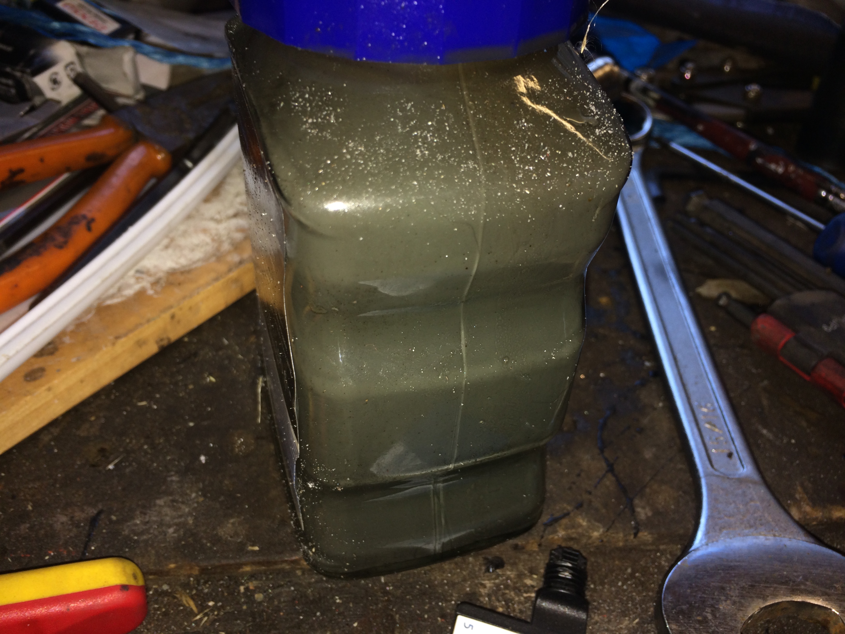

    Well I managed to get my stuck allen bolt out of the clamp. Helped by the impact driver I forgot I had, a T45 and a T50 torx bit. It was stuck because it is slightly bent!
    So I got the right fork leg out and have just got to get the seal out - it is fairly stubborn at the moment! The fork oil was rather grubby though and I'm sure it is not meant to be that colour!
  9. Sprinter
    5,993
    Good job put something on the bolts when they go in copperslip or threadlock blue not alot just a prophylactic layer.
  10. Rudeboy
    Rudeboy Senior Member
    May 2, 2017
    402
    Bristol
    Welldone Fourbears for getting that bolt out it looks well mashed up as long as the fork yoke/clamp saved
  11. Fourbears
    Dec 8, 2017
    505
    Norfolk
    Yep clamp saved thank goodness! And was going to Copaslip the new one - especially as they are over £6 a pop! The others will get the same treatment too.

  18. capt
    capt Elite Member
    May 8, 2016
    3,052
    western Australia
    I've done my fork oil's on several bike's I have owned, the oil that came out always seems to be about that colour ! I think it's because the stantions are hard chrome and nikasil plated and the lower fork legs are Aluminum Alloy, if you leave the oil change's go for Too long the oils are like black water !!

    don't forget if you use a lubricant on the threads you'll need about 20% less Torks ;)
