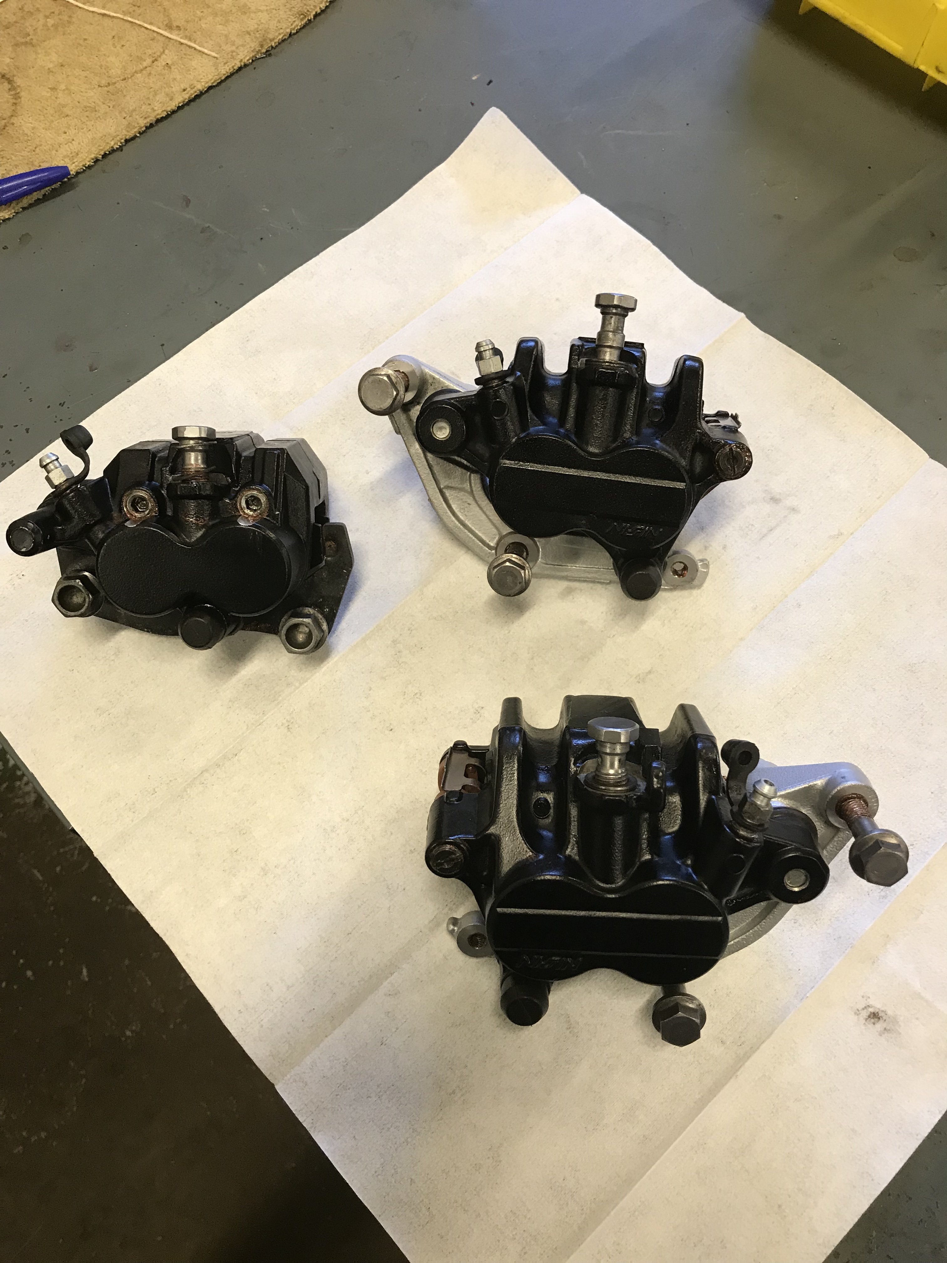

  1. dilligaf
    The pistons I removed with pliers :eek: shock/horror :eek:
    I know someone here will be horrified at that but if you take your time it can be done without damaging the piston :)
    Other bikes I’ve worked on have had gouges out of them where too much pressure or even mole grips have been used :(
    I have in the past used compressed air to remove pistons :)
    A few months ago I had a pair of four pot callipers in work doing them for a mate and they were seized solid :(
    Got the pistons moving by putting a grease gun on the bleed nipple after opening it slightly and pumping them up until they moved :)

    Should only be removed using compressed air or inside out grips from within the calliper pistons
  4. dilligaf
    There’s many many ways to get them out :rolleyes:
    Compressed air or internal grips are great if you’ve access to them :)
    But they don’t always work :(
  5. Sprinter
    I tried a pliers, only I am to heavy handed,the grease guns clever.
    I have a small bolt, I tighten a nut onto, then slip on a ring spanner.
    I put this inside the piston then slacken the nut until it pushes against the sides of the piston then pull using the ring spanner,
  6. Sprinter
    I bought internal grips and they didnt work for me, best is using the brake systm to push then out if you have enough slack ones
  7. thebiglad
    5,072
    I must be honest mate but I don't understand why you didn't use the bike's hydraulic system to push out the pistons. Remove the pads from both calipers, then using the brake lever just push them out. No pliers/grips or anything else.
  8. Ken walburn
    Ken walburn Noble Member
    Jun 28, 2017
    889
    Fine with a single piston calliper, unlikely to work with twin or triple piston set up
    once pressure lost that's it
  9. thebiglad
    5,072
    You just hold the two pistons equal in both calipers, a charming assistant does the pumping until they are all ready to plop out.
  10. Sprinter
    If you remove the pads and push the pistons all out to the max, by blocking the easily moved ones until they are all at max. They will pop out easily,all of them.
  11. dilligaf
    Because the bikes at home and I’m doing this at work :(
    Anyway there’s no fun doing it the easy way :p

    TBH it could be argued that if you are renewing pistons, as long as you do not damage calliper bores, it doesn't really matter how you remove pistons coz you are throwing away anyway

  15. dilligaf
    All diddley diddley done :) D5809823-F9A7-4151-9A19-AA8168121D01.jpeg time to get back to doing my Pyro Directional Apertures :p
