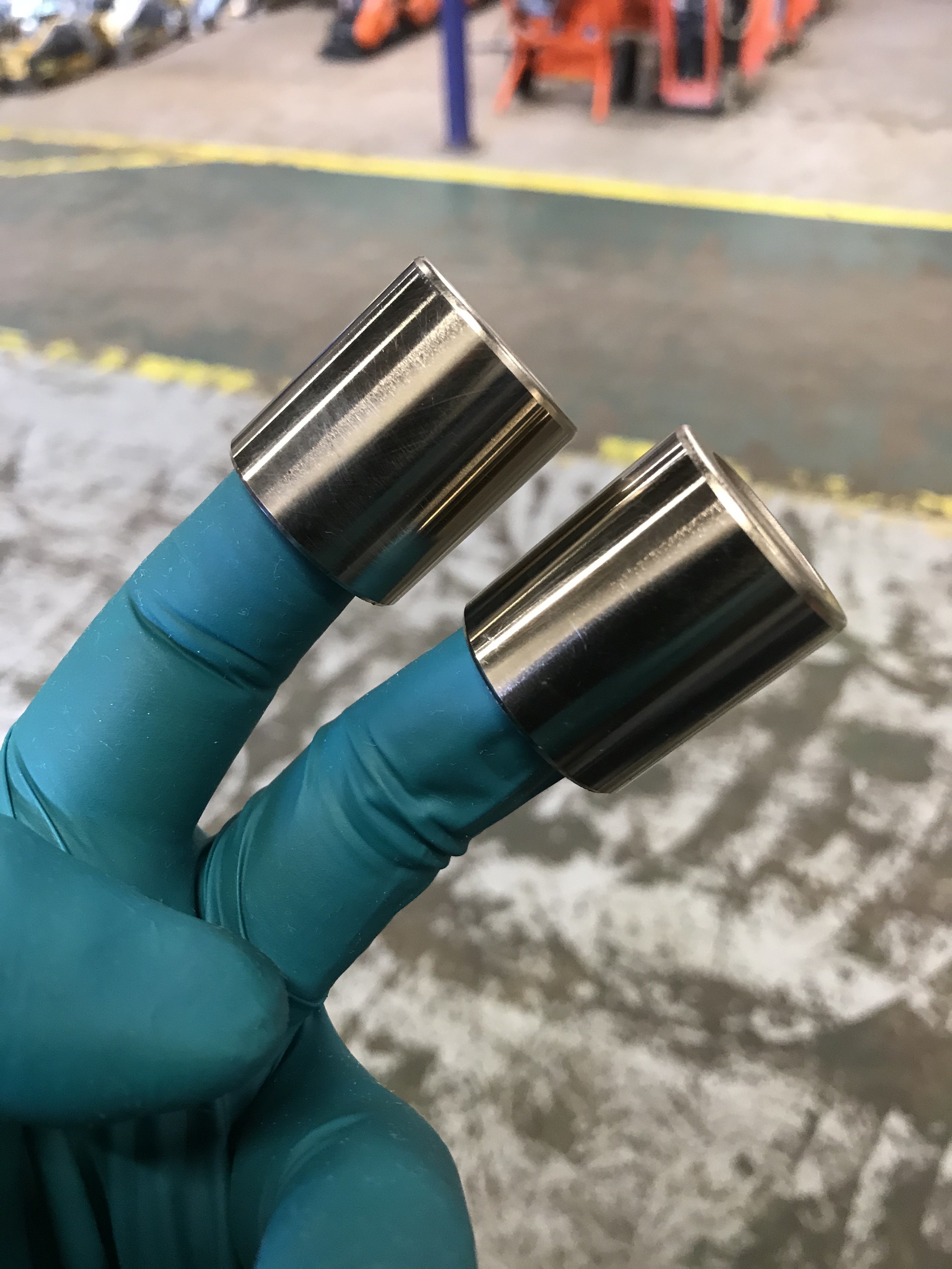

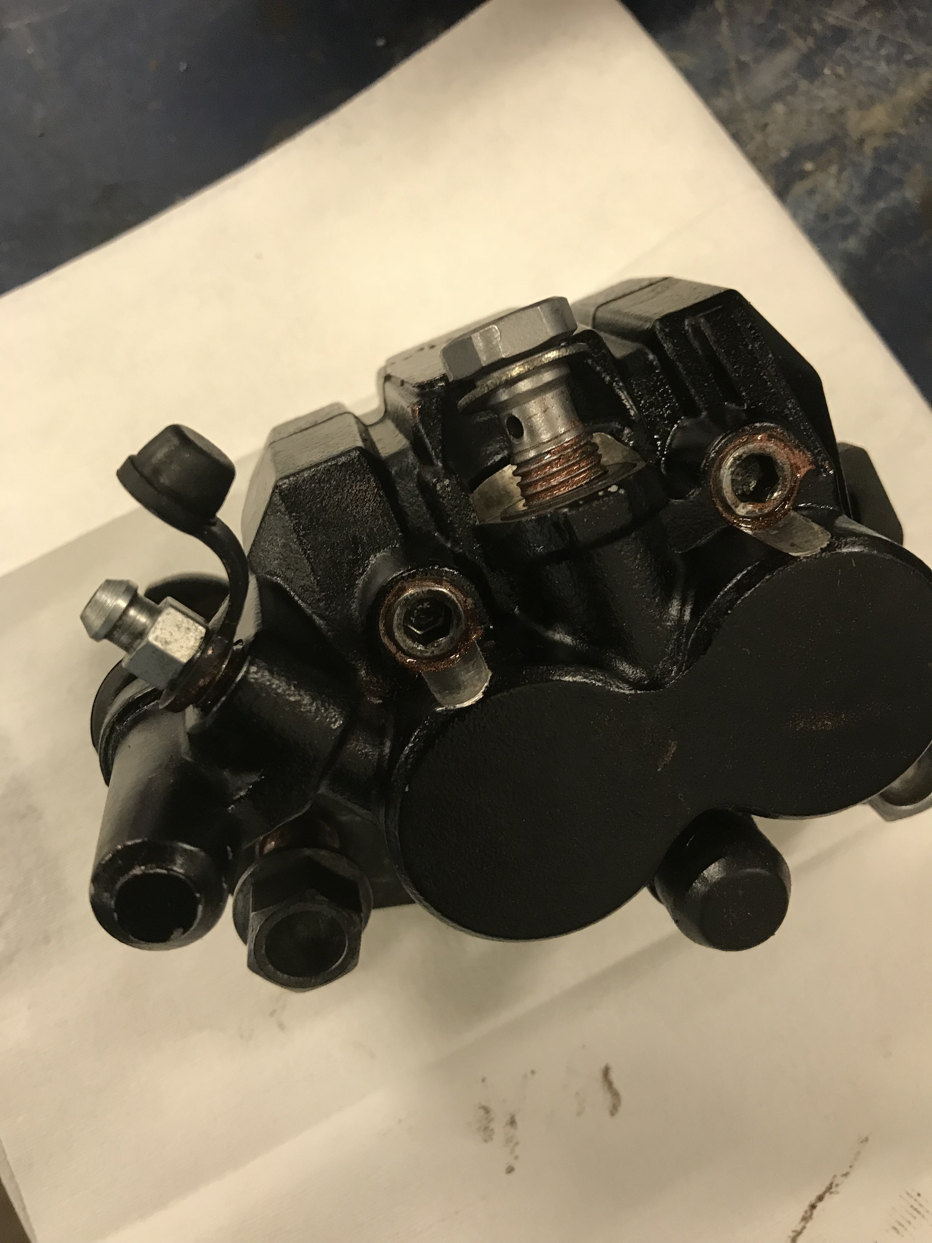

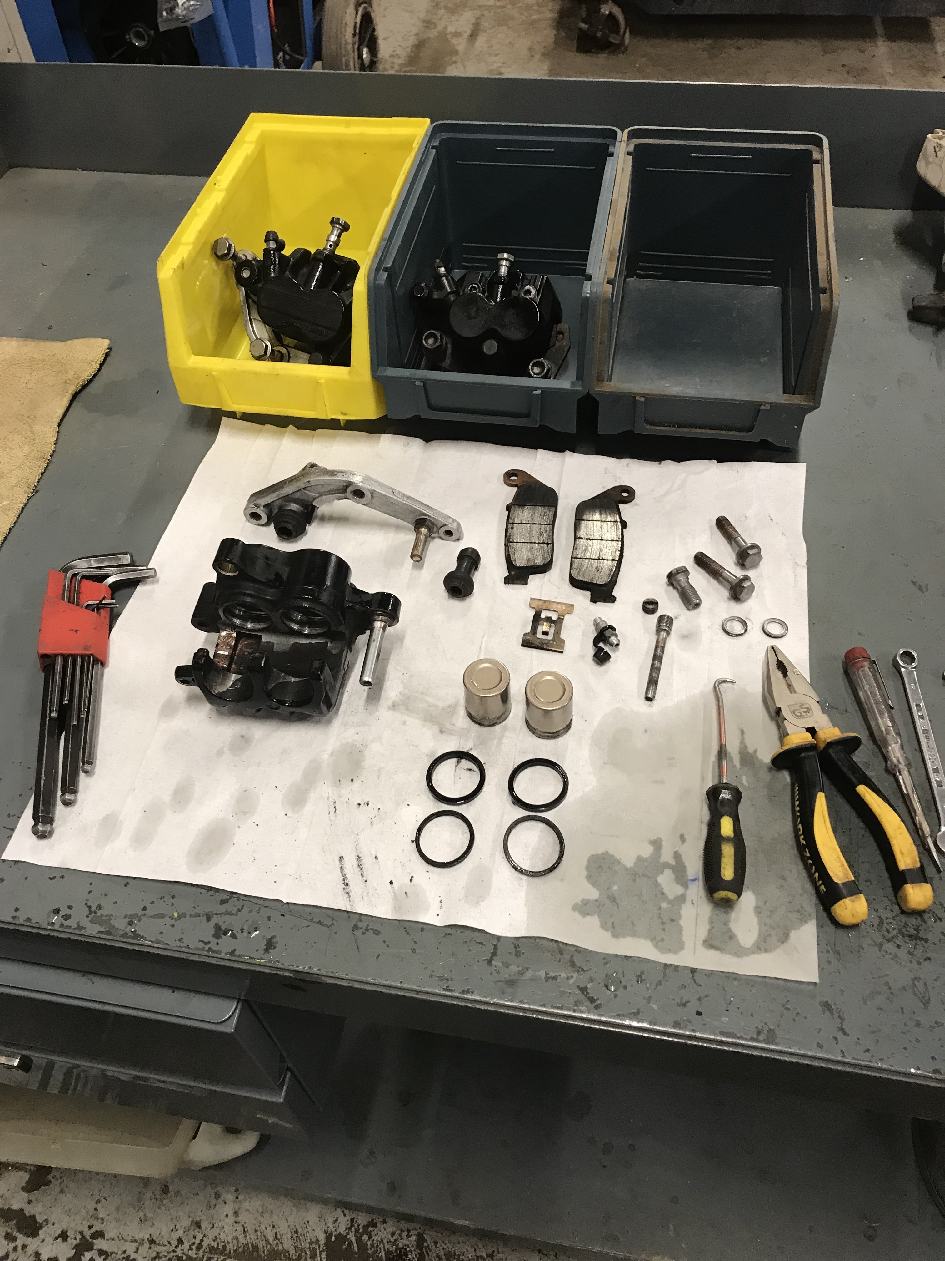

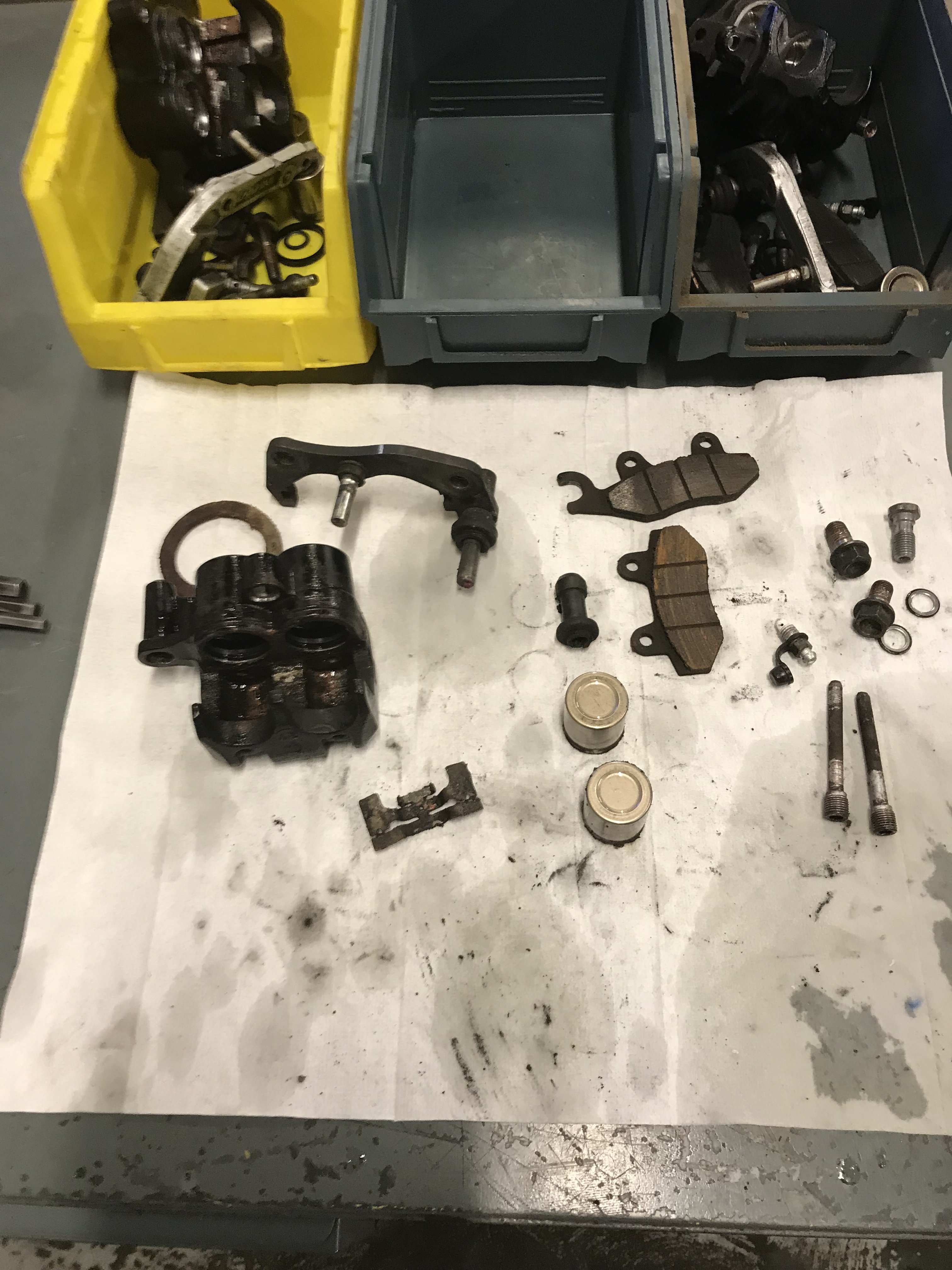

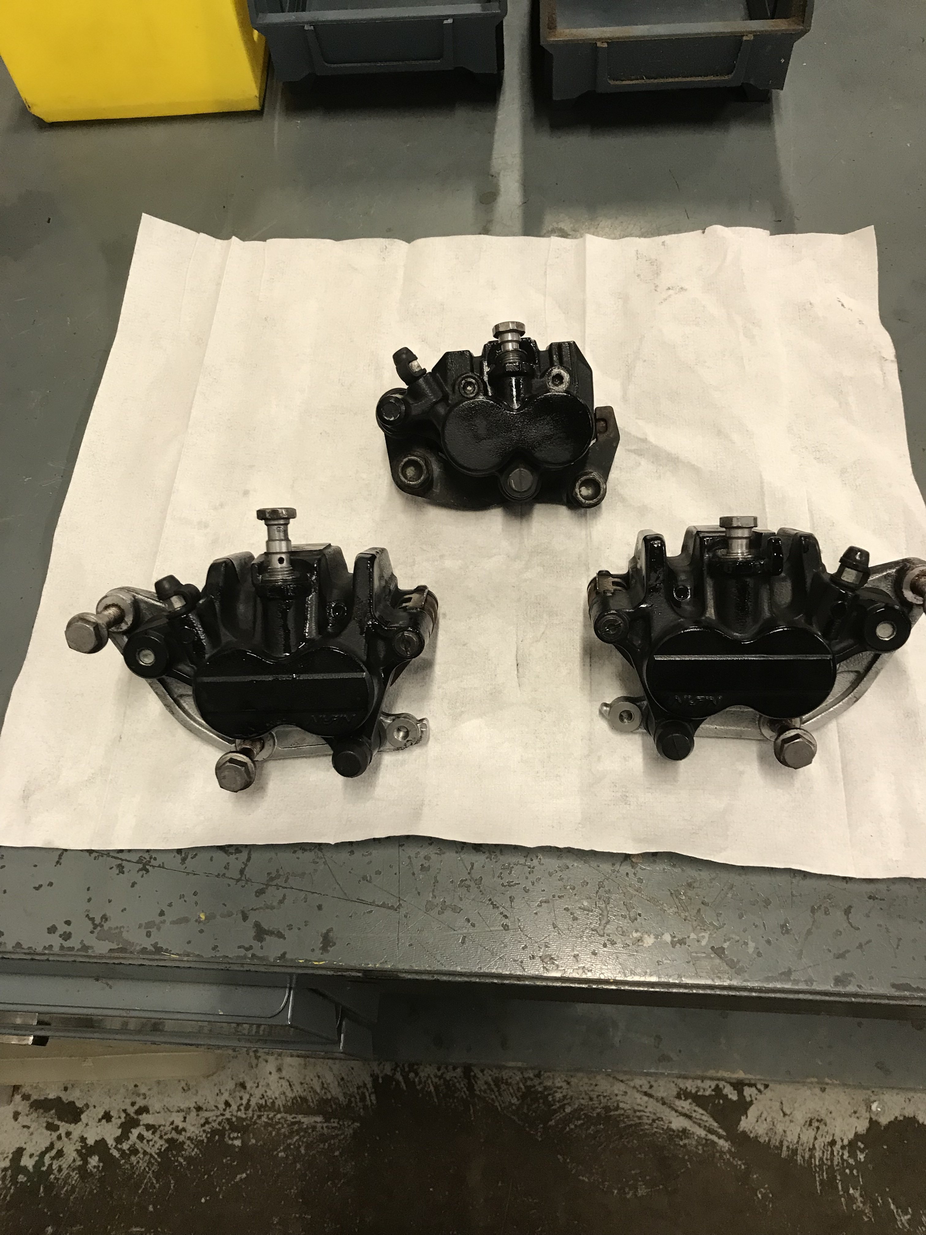

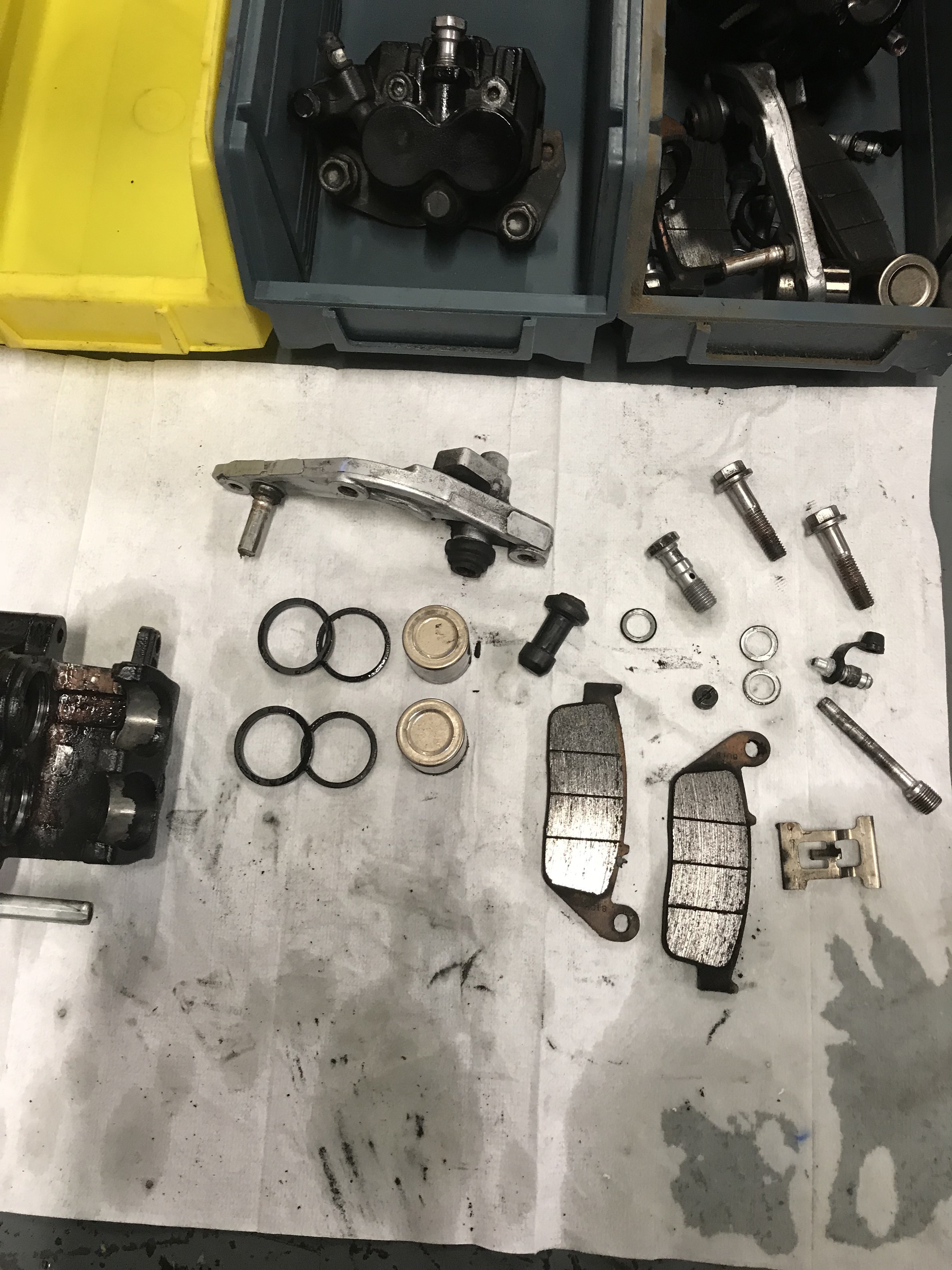

    Took the calipers off my BPOS last night and brought them in for an overhaul :) 3699902A-A751-4964-9DEF-47769A50F88D.jpeg front R/H stripped down....easy :) 123D2E9E-68F9-4FBD-B9DA-658EC0AFFFAA.jpeg front L/H stripped down...not so easy :confused: one piston was a bit of a bugger to remove DDEEA3D3-BE2E-4530-9EC1-F9BF182868B2.jpeg rear stripped down...what a right bloody carry on that was :(...both pins seized :mad:...lots of heat and WD40 and eventually got them out :)
    Both pistons tight as feck :mad: but got there in the end :) DD523D77-523D-43B9-9463-A9E94F152323.jpeg right.....time for a sandwich and a cup of coffee ;)

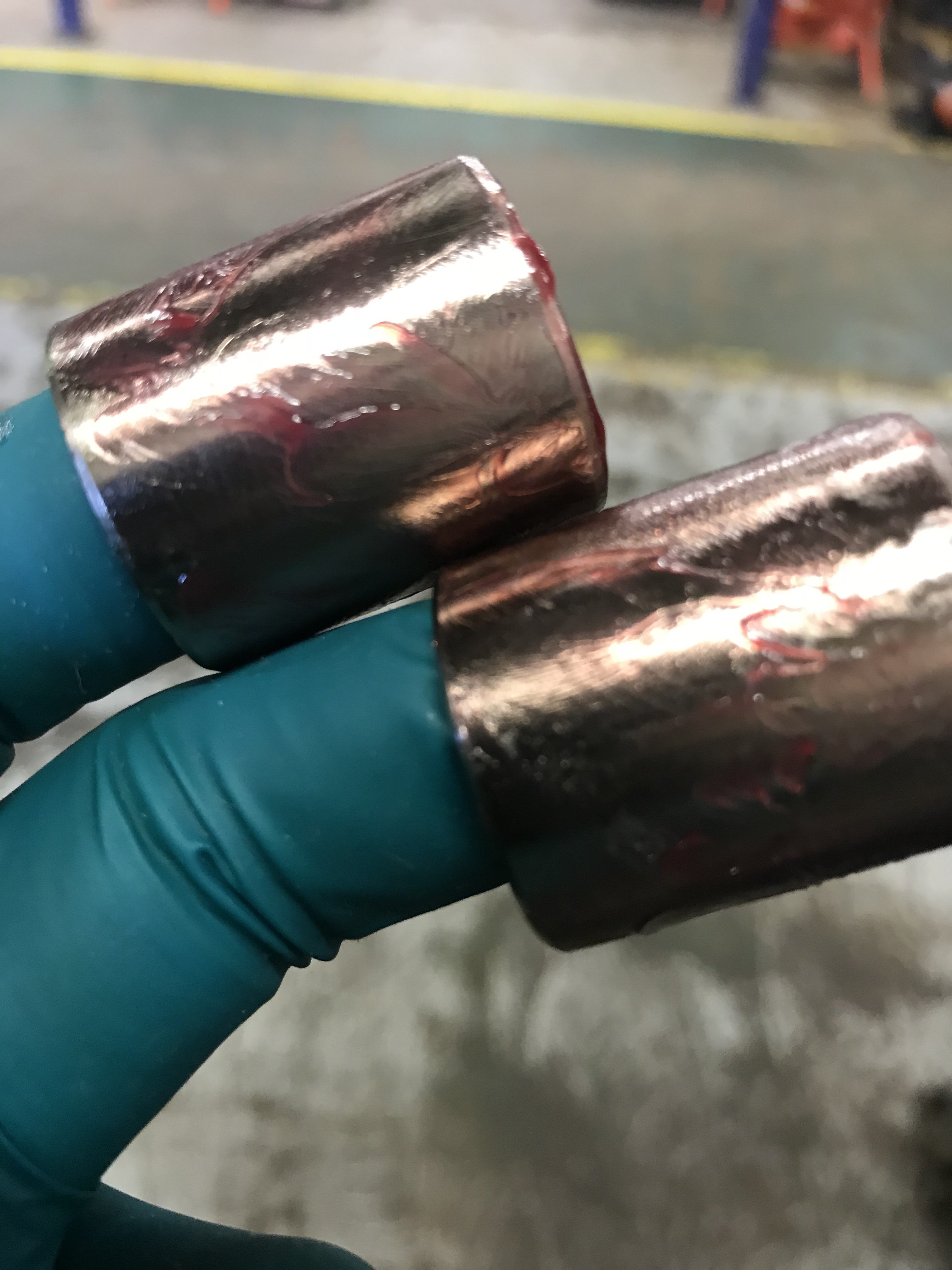

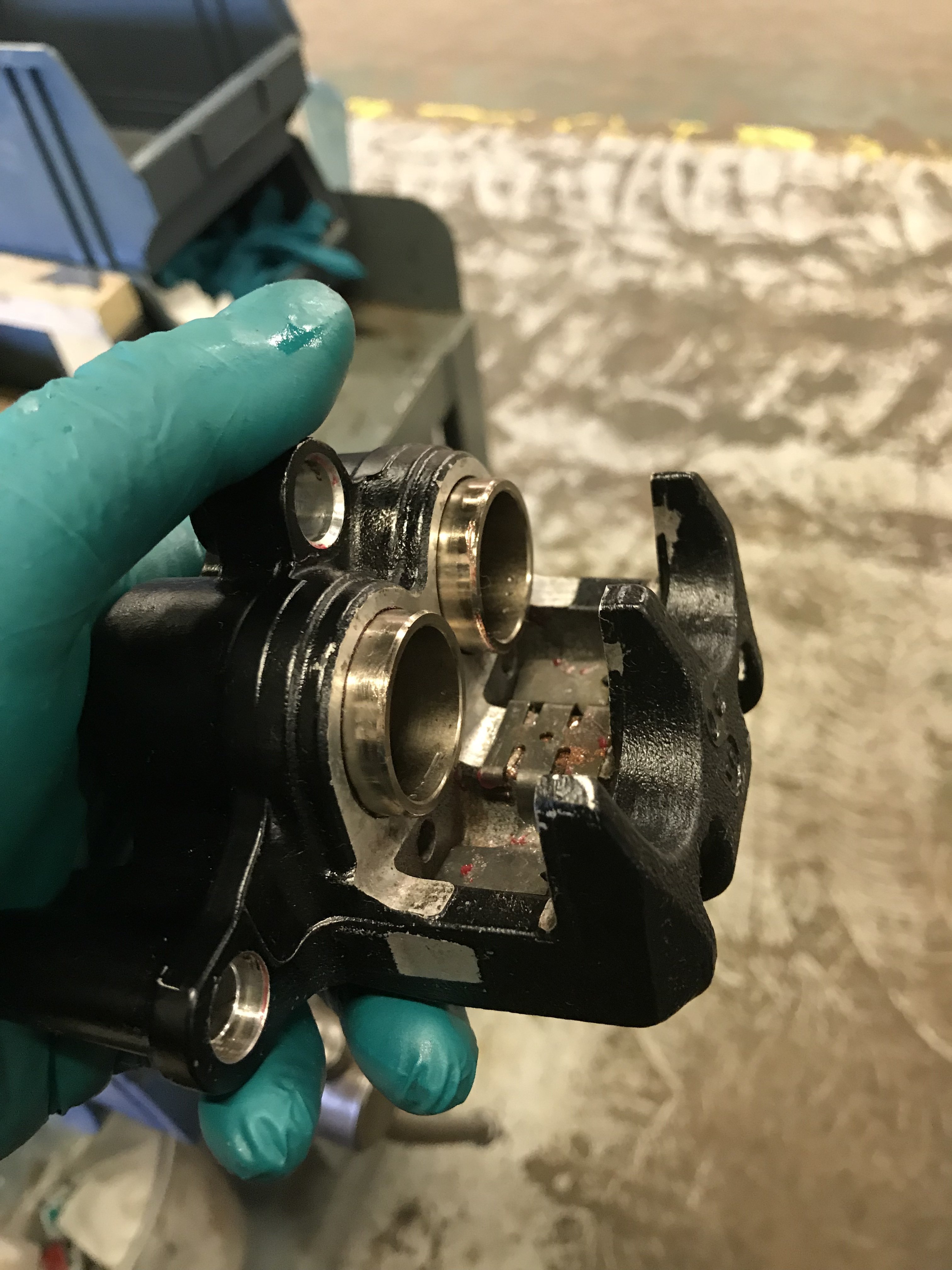

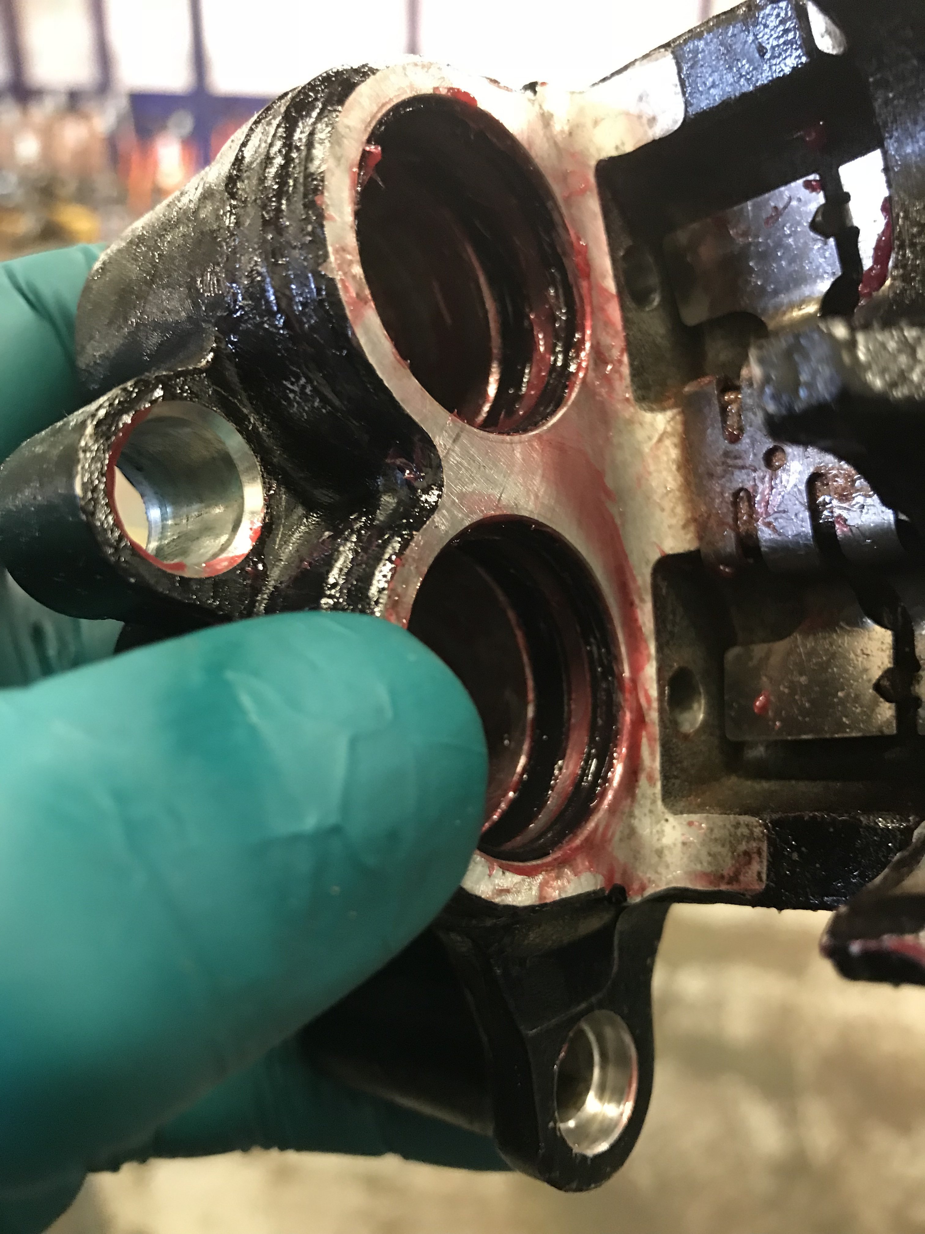

    Bores cleaned seals cleaned....all lubed up with red rubber brake grease :) 841C8F84-03EF-4D18-996A-8B678762B693.jpeg pistons came up like new:) D7861FF3-3272-4A81-AE0A-75A977098D9B.jpeg bit more lube to help with penetration :eek:

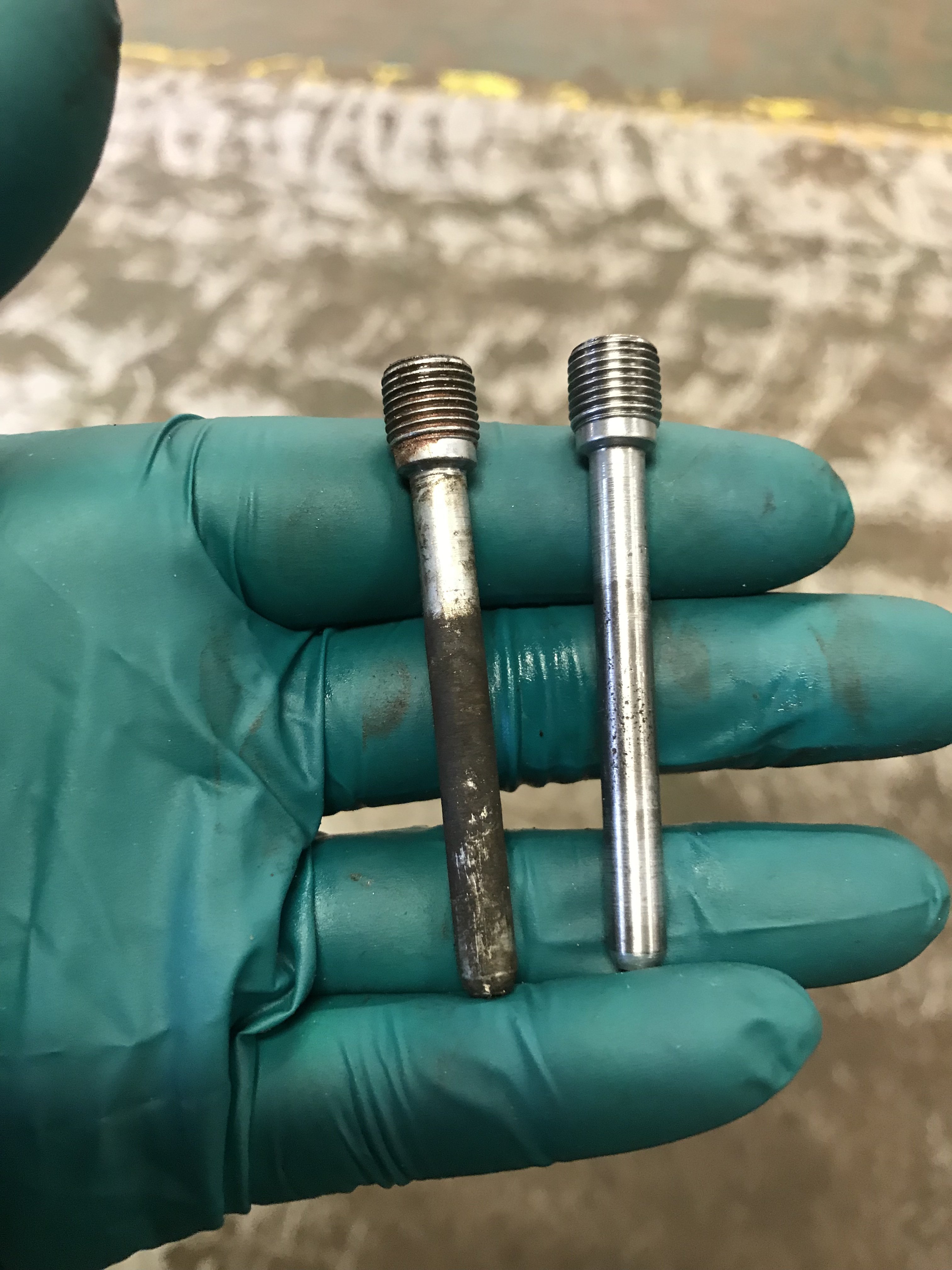

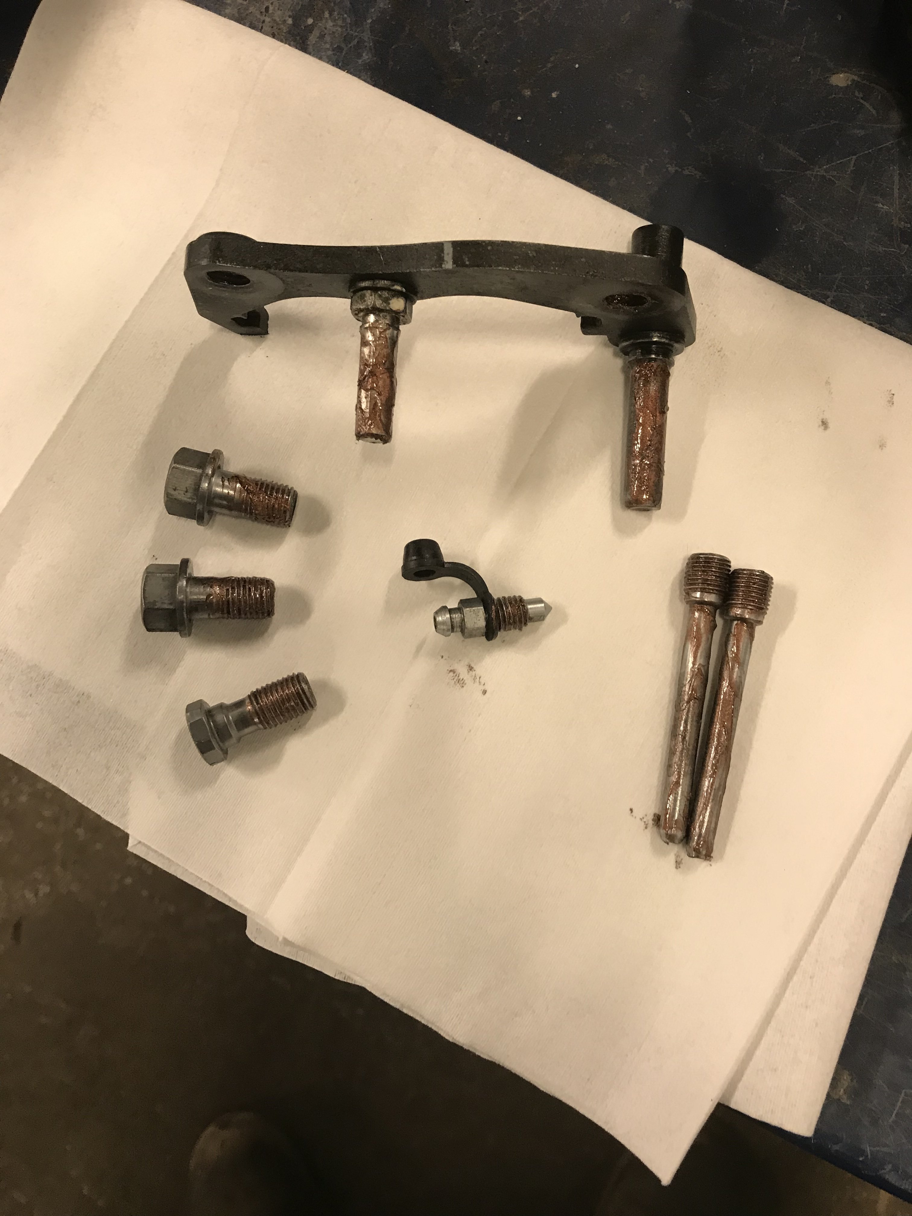

    Ooooer Mrs:rolleyes: and back in the calliper 411B4A23-02F7-44D5-B806-7AC96D867F9D.jpeg before and after cleaning the pins

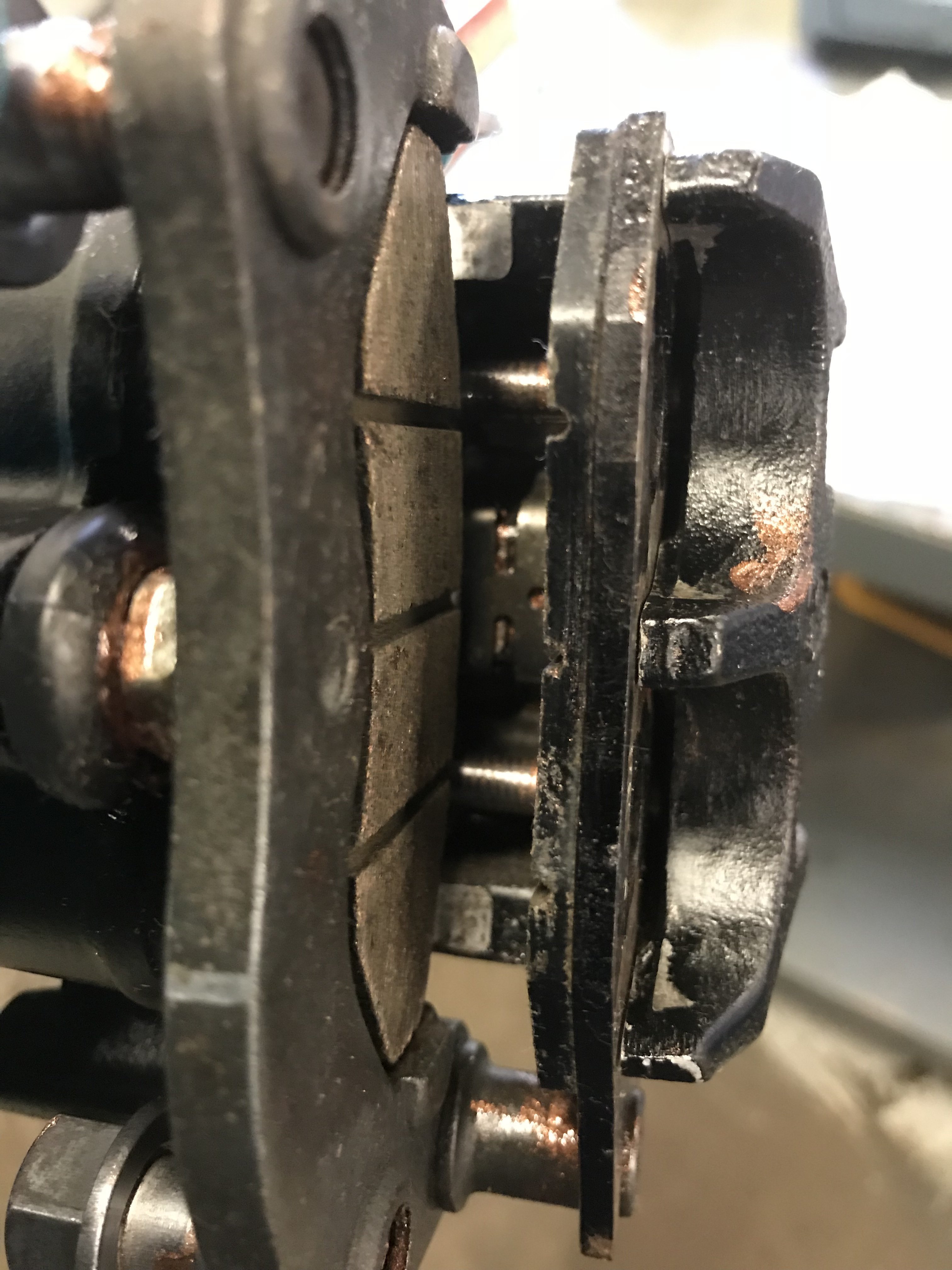

    No wonder they were a bugger to get out :mad: 8465D25C-FBE4-46E0-A870-89C165A25DBE.jpeg cleaned everything else and copper slip where needed :) 1EDEBBC1-E454-4F88-B1EA-1867A303AA7F.jpeg all done :cool: 5D71B1DC-8E92-4005-99E2-AD9A77A00187.jpeg 520FA38F-C67E-4B3C-B00A-C7B5F7A77E10.jpeg this is the rear calliper....got the two front ones to do next...exactly the same process so won’t bore you with pictures and I’ve just found out that we’re finishing work early these few days :) so I better have a tidy up and another coffee :p

    Them pins are a PITA. I actually pull them out every 3 moths or so to polish and apply some light copper grease (am a bit paranoid that it'll end up on the pads).
    I would have expected to remain nice and smooth a bit longer!

    Great job, how did you remove the pistons, did you use air? those pins are a pain. Im with Mischa, I get them out about three times a year for a clean and just to free them. Peace of mind when they re done,:).

    Replace the pins with stainless or Ti versions...... problem solved.
    SS about a £10, Ti £20
  20. dilligaf
    I think most of the time this type of pin gets over tightened and without copper slip on the threads or the pin itself :(
    Definitely no sign of copper slip on these ones :mad:
    Little tip for you after you’ve put them back is to get some silicone sealer and fill the Allen key hole and a smear round the top where the thread is so as to stop dampness getting in:)
    Next time you need to take them out you can easily pick it away with a small screwdriver or even your finger nail :)
