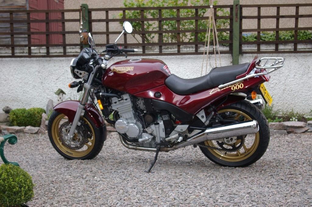

    trdent 900 mot may 17,new tyres,new battery,brakes rebuilt with new seals ,front forks rebuilt with new seals ,new chain and sprockets,new timing chain at 30000 miles
    the headlight looks like a replacement, nice bike only I should be going newer not older
    1500 ono
    NICE BIKE he said thinking...stop me

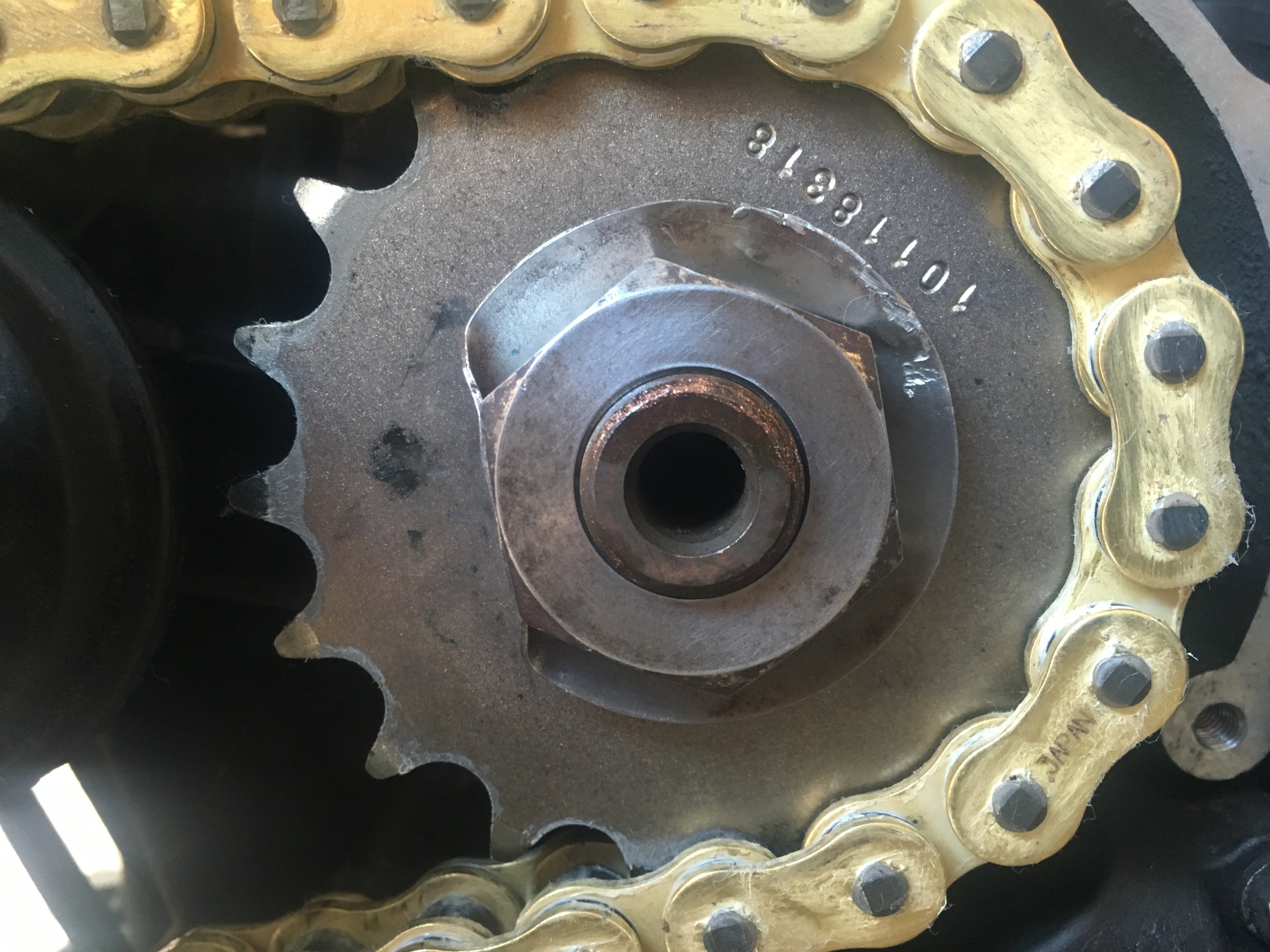

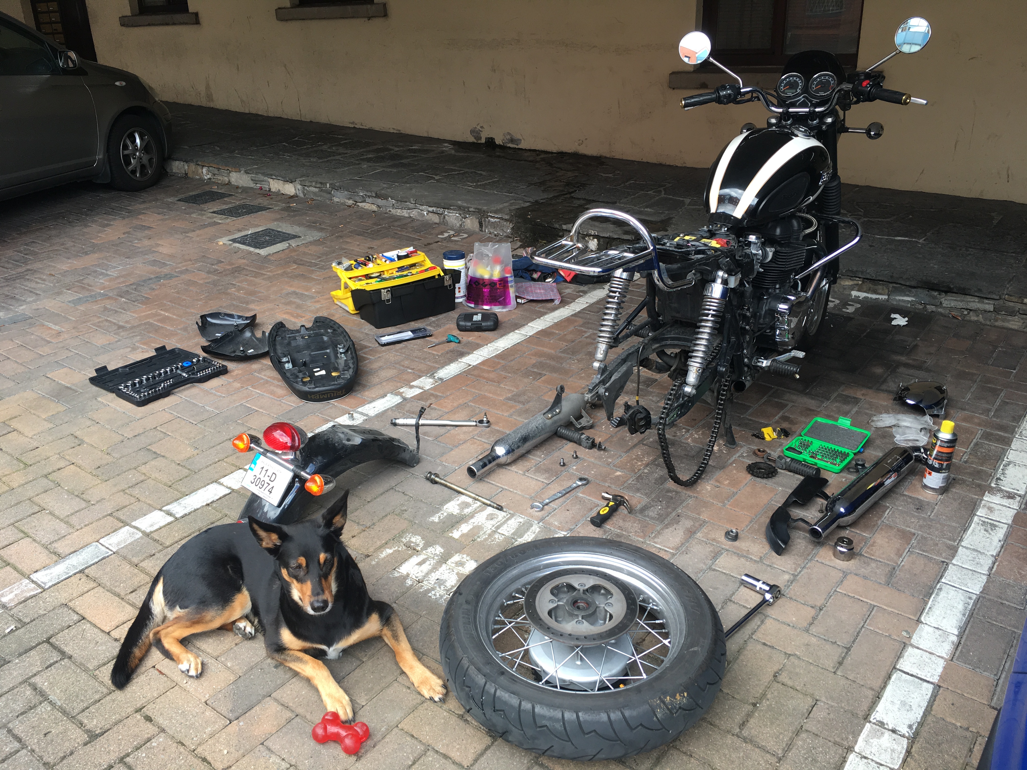

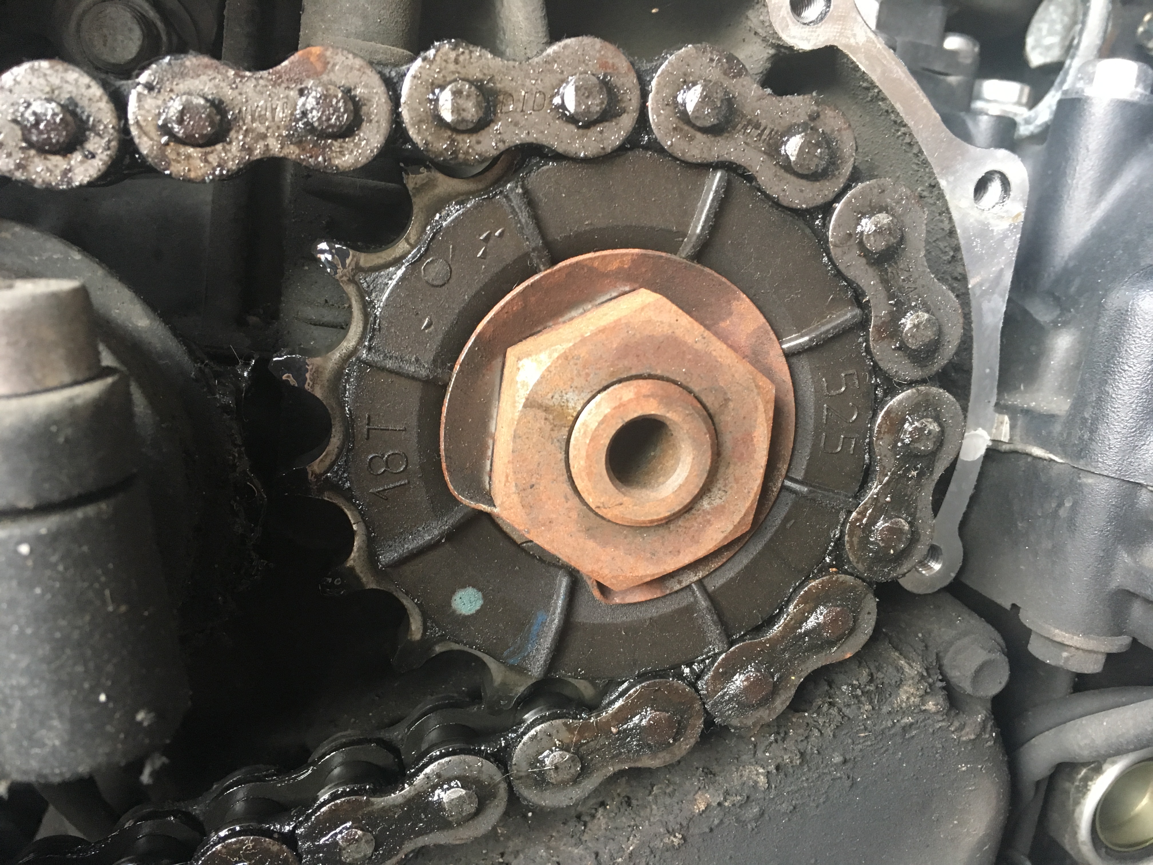

    Changed chain and sprockets on the Widow as planned. That was hard work, fellas. I did get everything off fairly easily:
    The state of my old front sprocket nut was appalling (yes, that's rust):

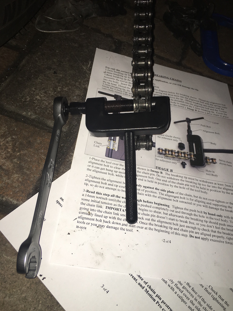

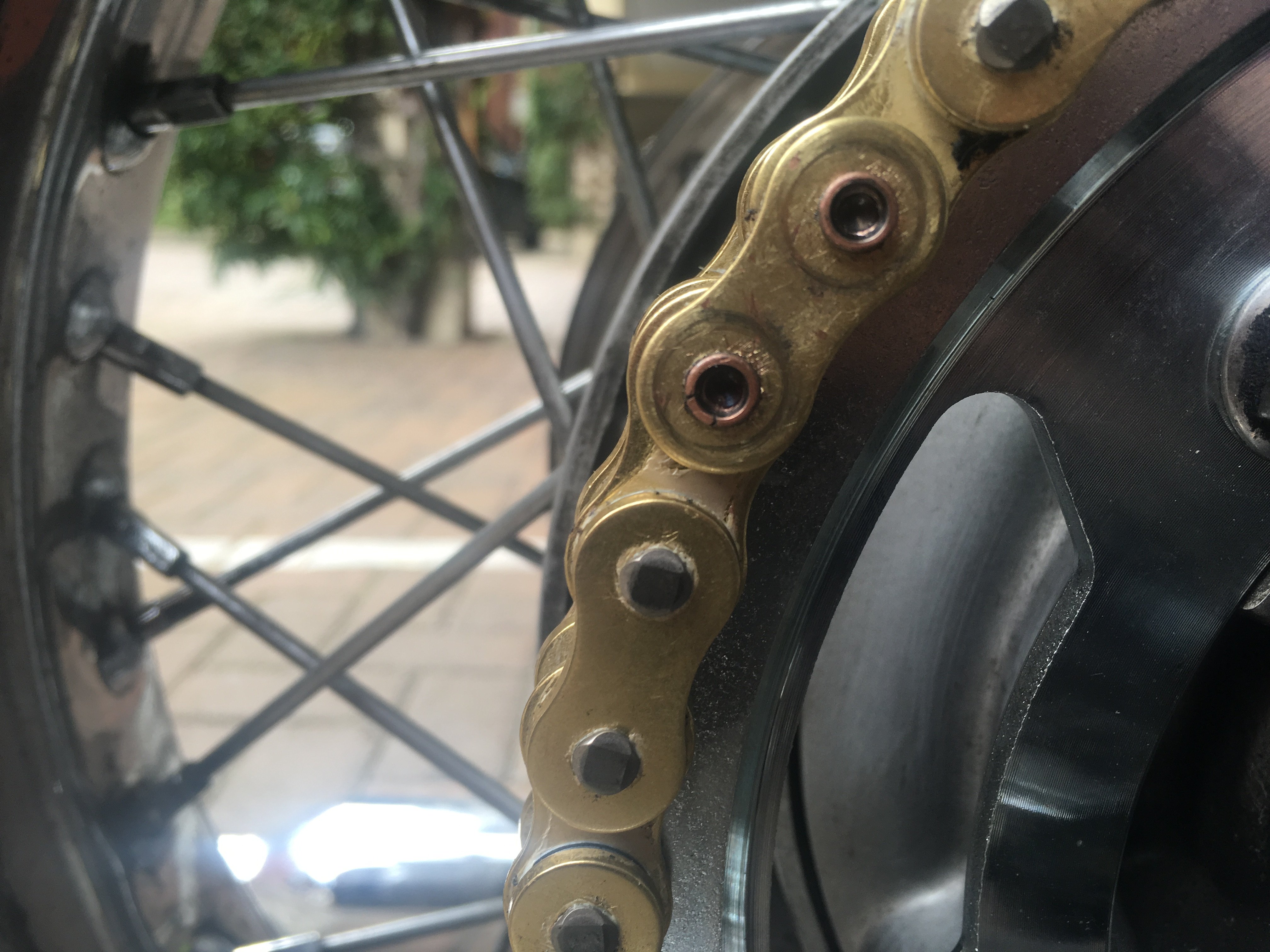

    Breaking the old chain was easier than expected, but pressing the plates and riveting the master link of the new chain was challenging to say the least (the guys at triumphrat do have a phenomenally good tutorial). I did break the break pin and the riveting anvil of my chain tool - it seems to happen to everyone that does it!

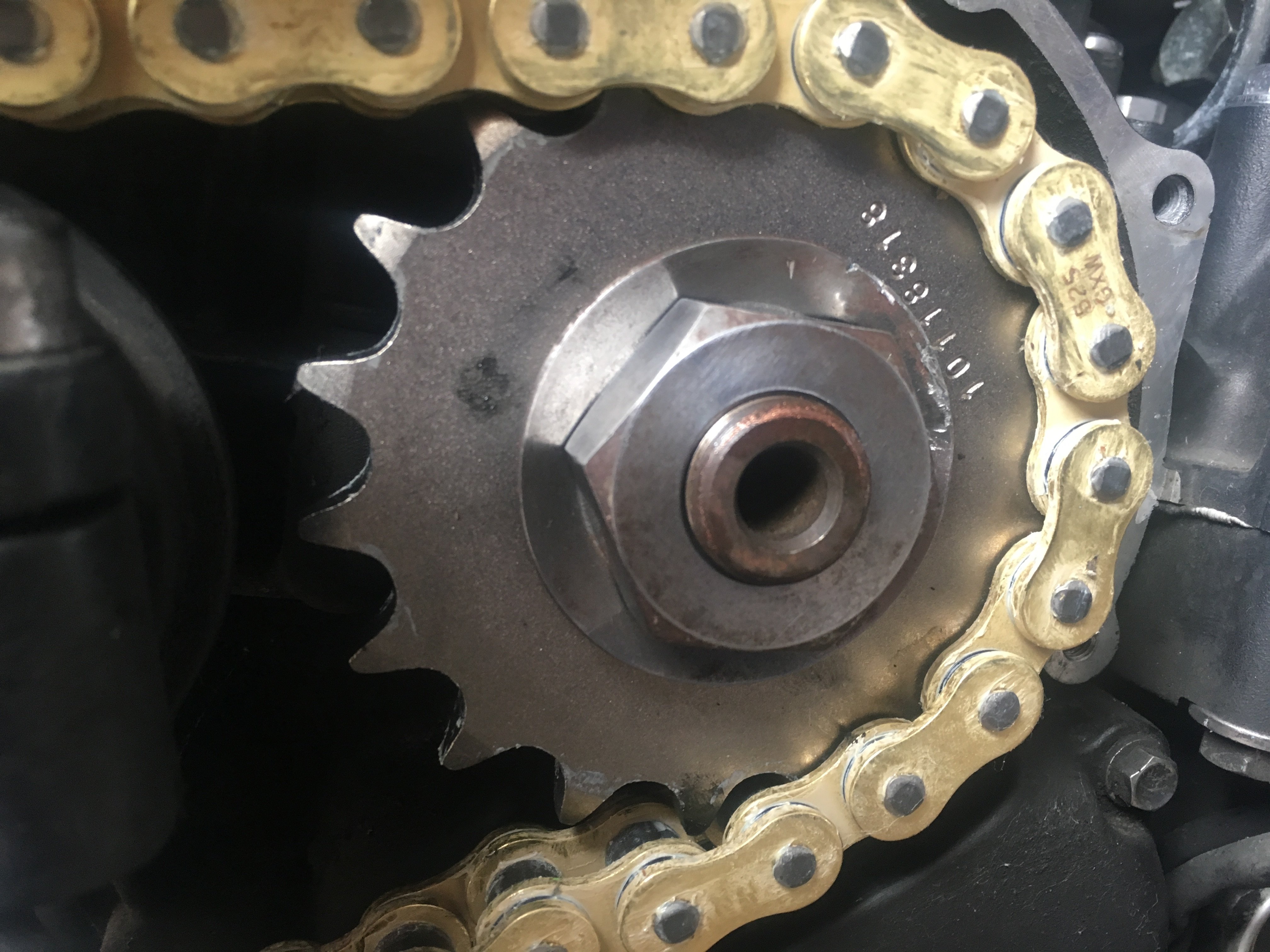

    It took a lot of work, but my front sprocket is spotless:
    I worked through Saturday night, and again today the whole afternoon. Everything *seems* to be done properly and holding in place, to be tested tomorrow morning. I will be a very stressed rider for a couple of weeks, until I'm certain that riveted link holds!

    Rivet looks fine, did you remember to bend the back washer to the nut on the front sprocket.? ( just checking:rolleyes:)
    All looks good.well done Mischa

    Thanks Wayne! Aye, did that. I used the same washer, although bent on a different side. Seems to be holding up nicely so far, and the "lumpy" feel off the chain in neutral seems to be gone. Overall quite happy, provided it holds!

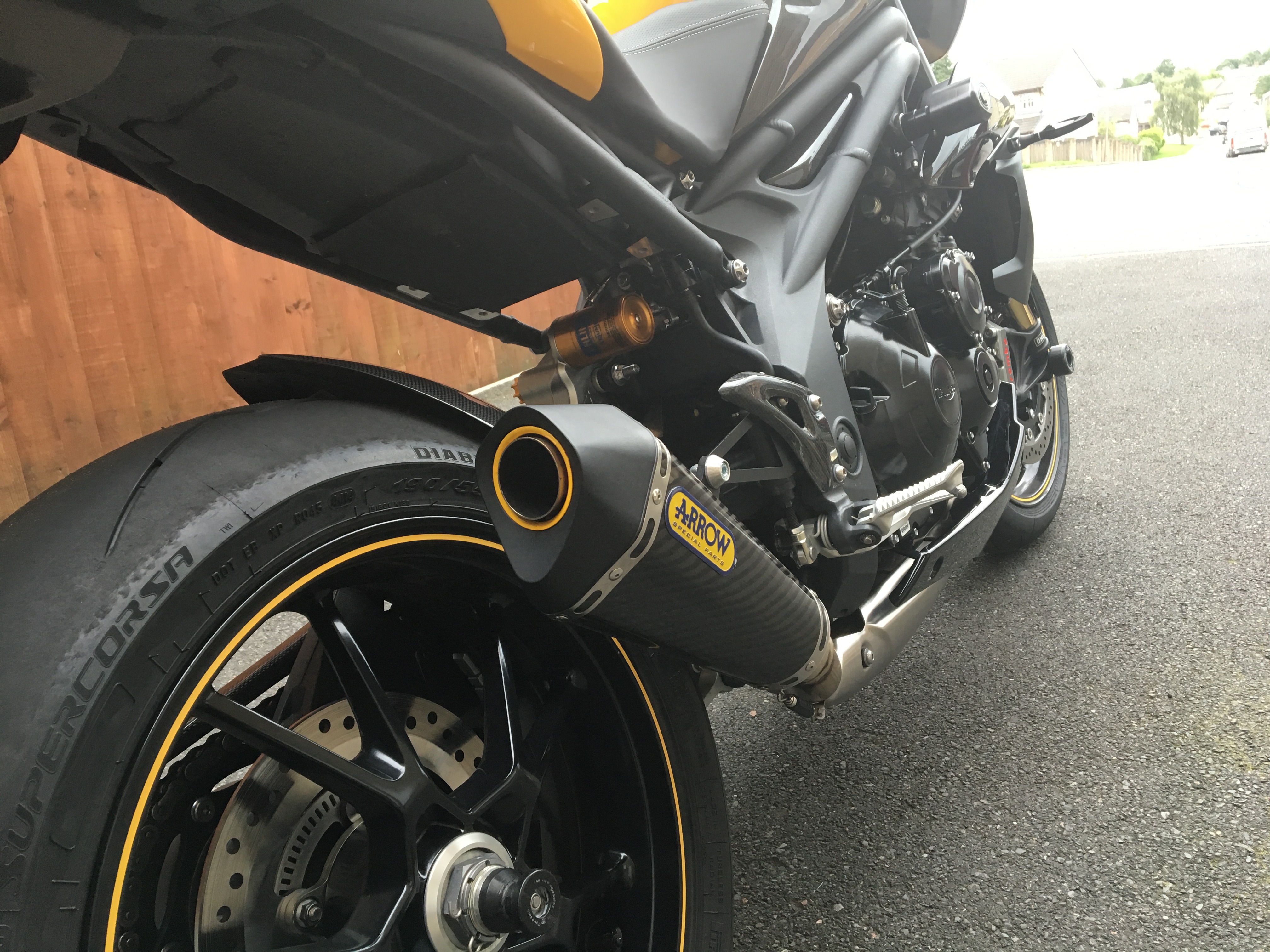

    Evening all...
    This evening I painted out the red ring around the exit hole of my scorpion serket carbon exhaust. I think you can guess the colour...;)
    Yeah, I know the can is a scorpion, but the red and silver sticker just didn't cut it for me, hence the beautiful yellow Arrow plate. ;) I think it brings everything "together".

    Wasp! I think that now counts as a fetish:)
