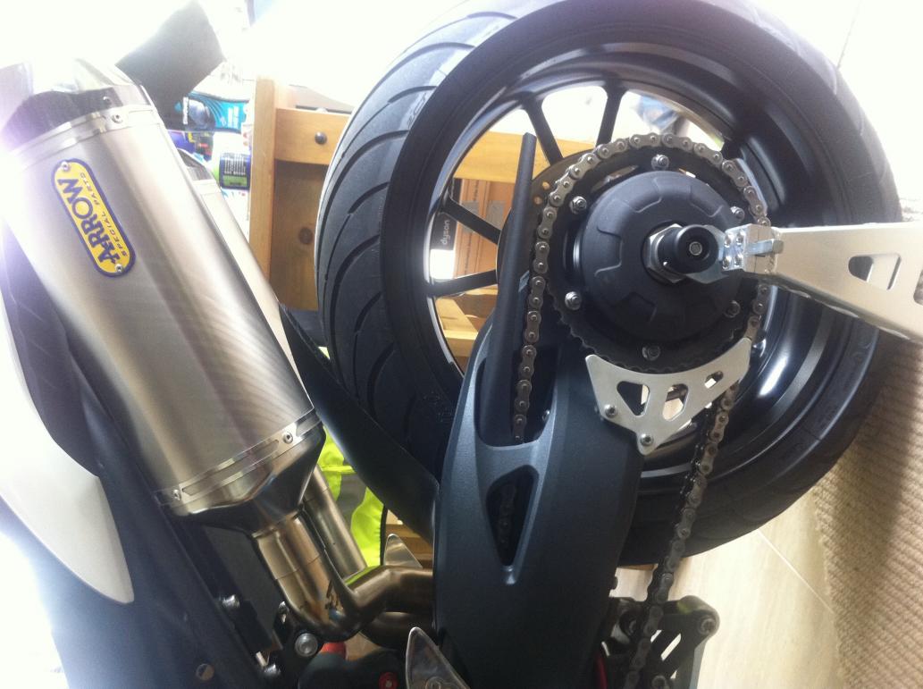

    SB how do I get this freakin Back wheel out of the way???
  2. Screwball
    Screwball Active Member
    Mar 21, 2013
    1,017
    36
    Place bike on lift...
    Get C spanner out from under seat...
    At rear of swing arm is a 17mm bolt.. Undo this bolt.
    Use C spanner to wind wheel in, u may need tourch to see where to fit C spanner or look in manual.
    I had to turn the wheel to help do the adjustment..
    Wind wheel all the way in , chain become very loose. Pull chain off to the side...
    Once chain off you can then wind the wheel all the way to the rear...

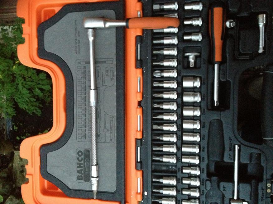

    You will need a very long reach torx screw driver with possibly flexible reach....
    Undo screws as required to remove hugger...
    I'll post picture..

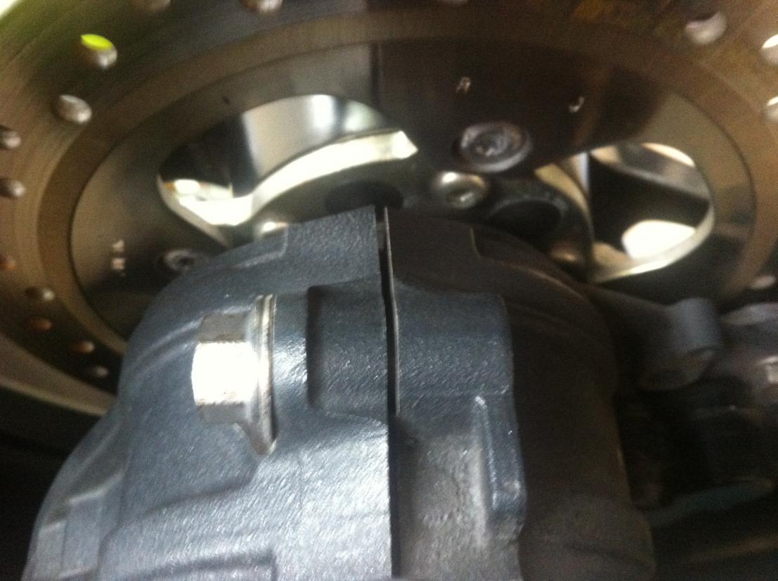

    There is the bolt... And if you look closely you can see the toothed Adjuster you have to try and get on....

    And if you have something like this it may help...
  9. JimDiesel
    JimDiesel Member
    Feb 27, 2013
    450
    16
    Nottingham
    LMAO I wish..... When you say tighten everything up, that can only be the 17mm bolt right? Is there a torque setting for that one?

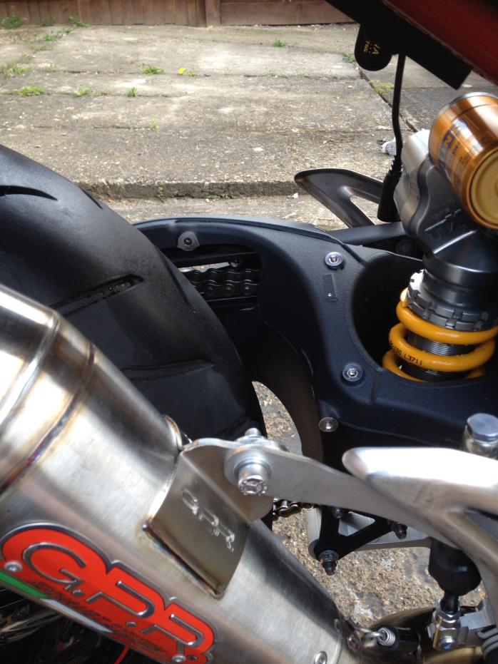

    Ok Finally done the Bugger Hugger!!
    It wasn't without trauma though..... So fitted it once, managed to get that pain in the ass bolt back in, all others back in, but it just didnt sit quite right, the lip that meets the swing arm was proud by about 2mm, so off it all come this morning as last night I'd had enough and got stuck into the beer and Ciggies (No FAG's PIG).
    Dug my battery drill out of the cutlery draw (Man Cave as you know is my kitchen), slotted the hole a little on the pain in the ass fixing point, carefully so as not split or break it, Nice!:upyeah:
    Right now fit it back on bike, starting with pain in the ass bolt, gently tighten.. CRACK!! The freakin lug on the hugger where the pain in the ass bolt fixes through in now in three freakin bits!!!:mad: FEK!!!
    Off it comes again, super glue to the rescue and a nylon washer glued into place to reinforce, ciggy break whilst it dries.....
    Ok, back to it, return the Bugger Hugger to the bike for the third time, gently gently tighten the pain in the ass bolt...... done, right now to put the last three bolts back..... Eh, wheres the third gone??? Still in the hole under the hugger where I had put it back when i took the hugger of !!!! FEK Fek FEK!!!:mad::mad:
    Off it comes again, all bolts removed and accounted for, back goes on the Bugger Hugger.... Gently gently the Not so pain in the ass bolt goes on tight (Easy now I have done it so many times), all the other 3 bolts in and tightened and the Bugger Hugger is Hugging nicley!! :upyeah:
    Ok so time to clean the sprocket and chain whilst they are separated....
    Wind the wheel all the way in with that feking C cshaped spanner shite.... God only the Japs could of come up with that idea... Every freaking knuckle now skinned... chain on, wind the wheel out checking play, 20-25mm looking good, tighten the 17mm bolt back to a torque setting of as I was informed TIGHT!

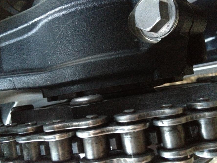

    Job done, ciggy then think, erm need to check play in chain whilst sat on the bike.... so I sit on it backwards (Like one of those trixters that stunt their bikes), take it off side stand, weight on bike tapemeasure in hand, leaning down.... Oh fek.... nearly dropped the bike... lesson learned, leave side stand down just in case.... hmm only about 15mm slack with me on it, probably not full weight either...
    Should I slacken it off a bit??
    Also having tightened the 17mm bolt there is still a gap between the upper and lower section of the swing arm at the bolt position, Is this normal SB?
    Having done all that it looks the danglies.... However, that is if you stick your head right in between the twin arrows... thanks to them you can hardly see it.... Right I am definitely gonna advertise these arrow cans this week (Or the week after..)....
    Thanks SB for your help and CC for the Satin fix :upyeah:
