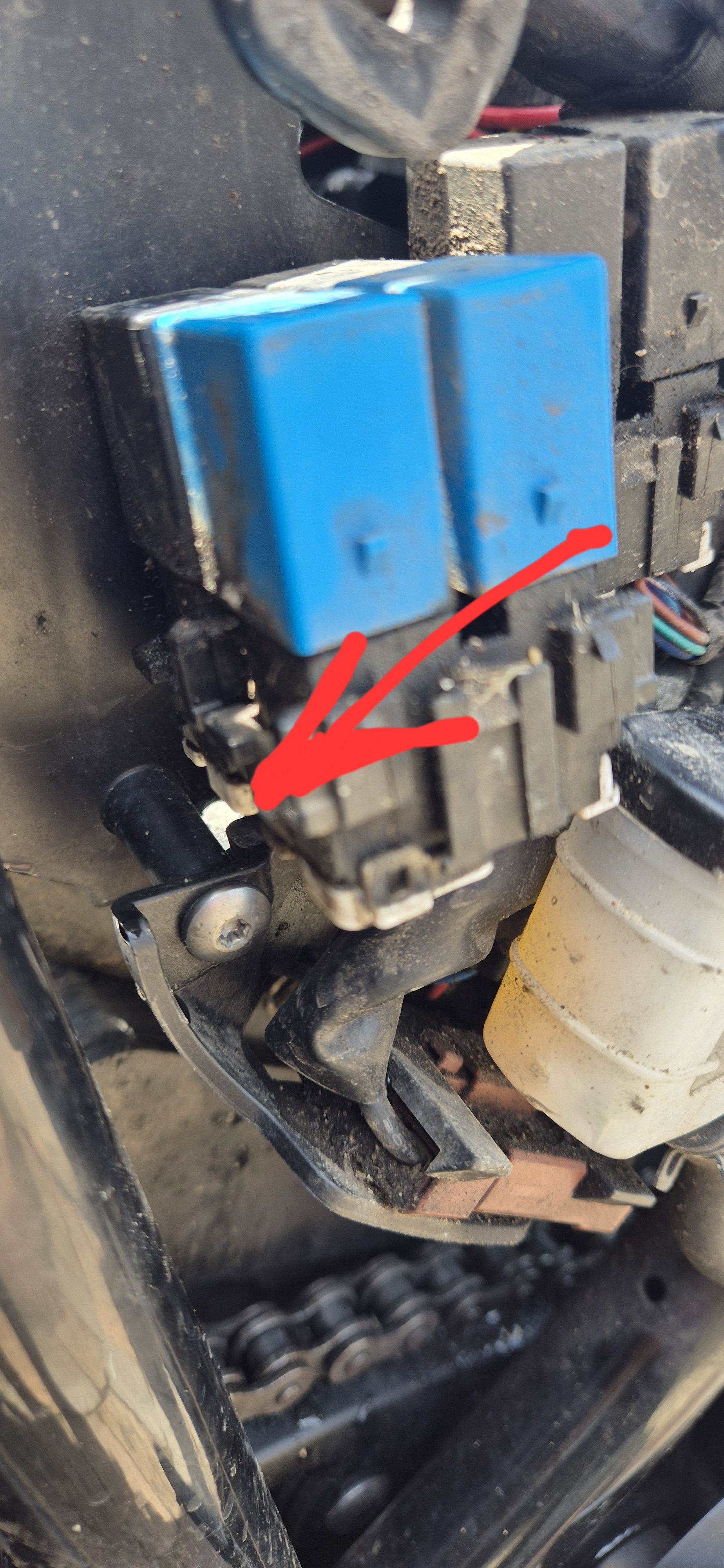

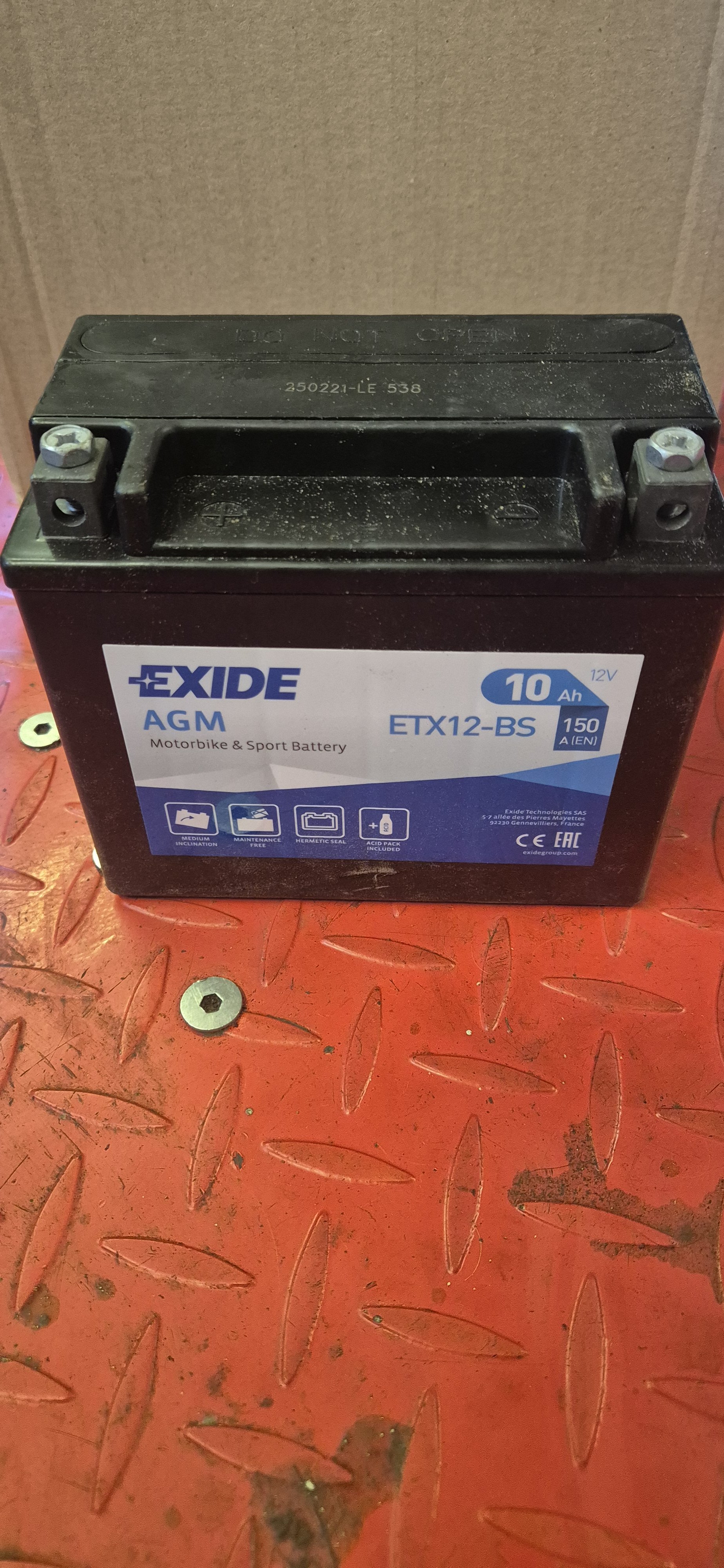

    So today wasn't quite as planned.....
    Up reasonably early, mot booked in for 09.00. Bike out of the workshop and myself then kitted out, helmet on, ready to go.
    Press starter ....... nothing, absolutely nothing!
    :eek:
    Dash lit, sidestand up, starter, no show. Umm : unamused:
    Ok, so no mot today.
    Workshop reopened and voltmeter says 9.7 volts :worried:
    Optimate after 10 minutes shows red light on .... err cell failure quite possible I start thinking, new battery required and start again ( pun intended :blush:).
    A quick ride out in the car and problem sorted for £35.

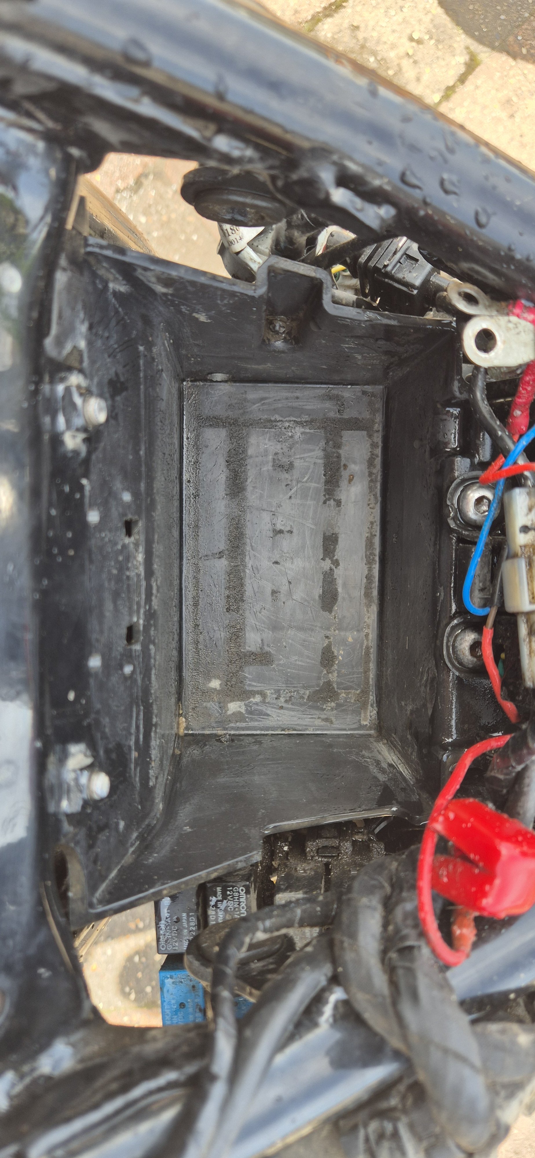

    So arrive home with the new battery, "I'll have this done in a quarter of an hour", I think I said to myself :joy:
    Who are you kidding?
    The battery, after removing a few ancillary bits and the ecu, was absolutely solid :confused:
    It was like it had been put in onto a bed of "no nails" :worried:
    The battery trough had built up with mud off the back wheel and packed the battery in tightly, as in solid!.

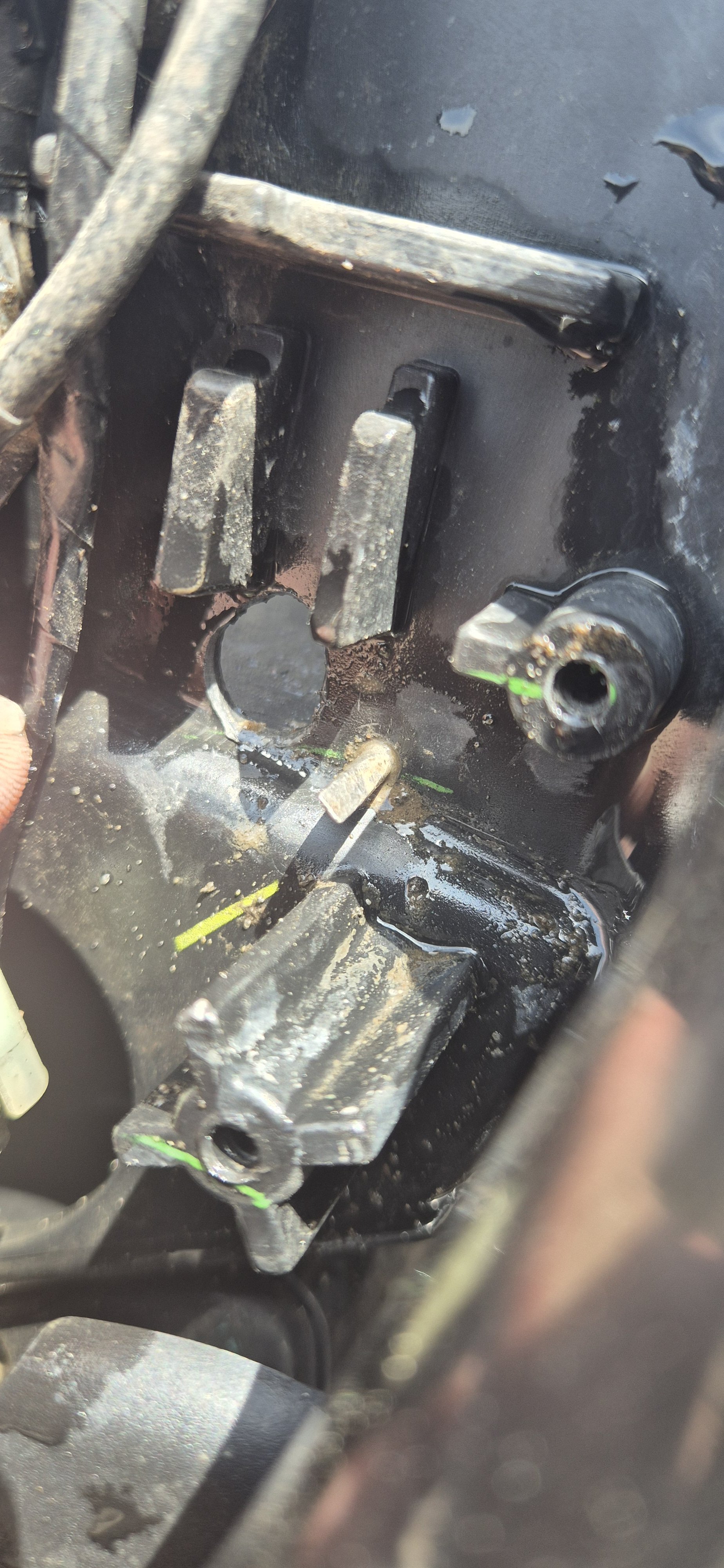

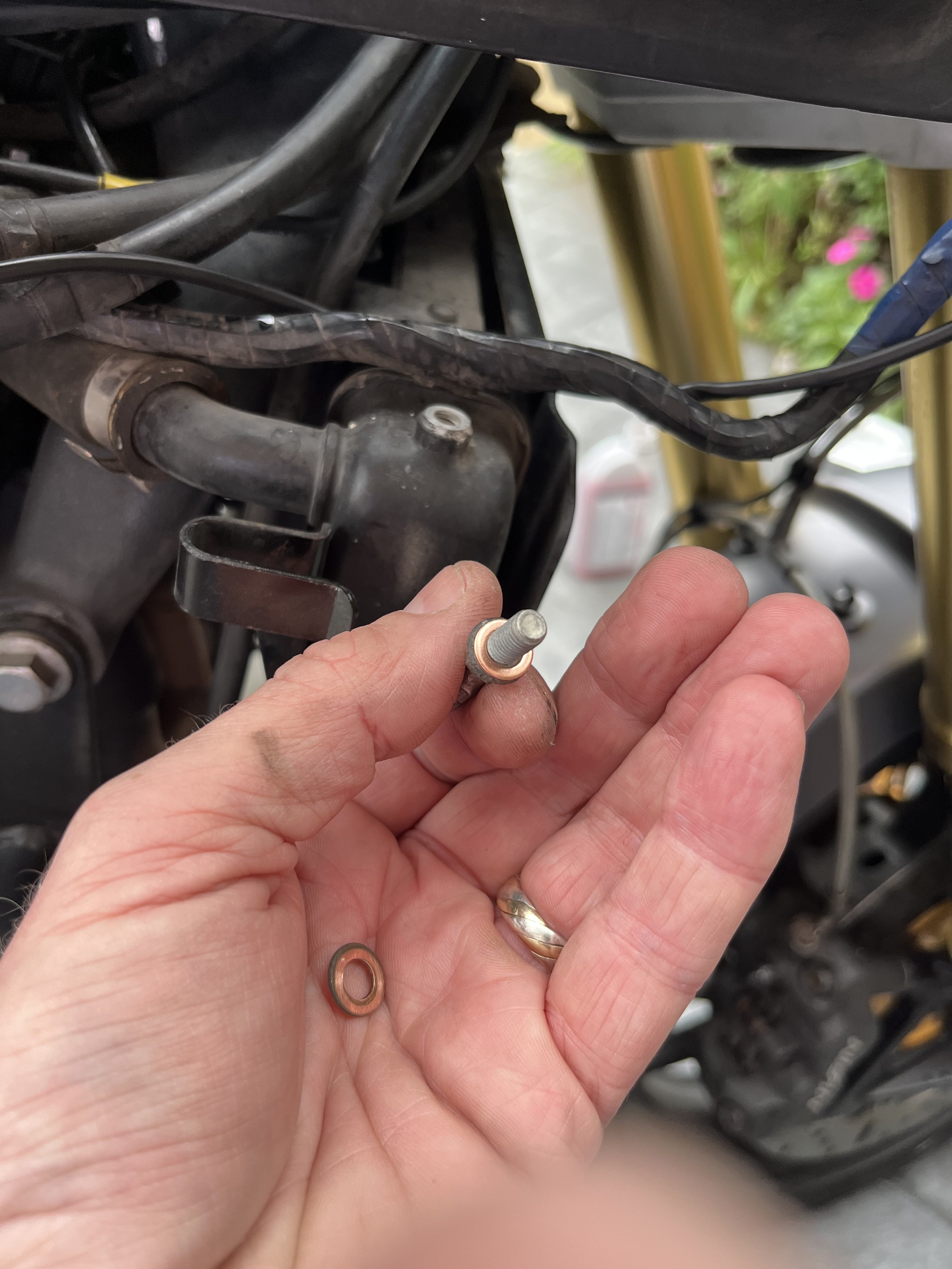

    So whilst the battery is out let's look at the drainage.
    What a joke Triumph, a crappy little 3 or 4 mm hole in one corner.
    Now if reading this and planning on doing similar, bear in mind the plastic battery trough, airbox, electrics tidy is quite complex.
    DO NOT DRILL DRAIN HOLES THROUGH THE BOTTOM OF THE BATTERY TRAY!!!
    That will only empty water into the airbox :rolleyes:
    The screwdriver head is the pathetic drain hole provided by Triumph :(
    Note the new, more generous, aperture next to it. This is the nearside and the factory drainhole wasn't even apparent until I'd drilled mine, as the buildup of crud had totally hidden it.
    This is the offside behind the relay block.
    And this is the newly cleaned perch for the new battery.

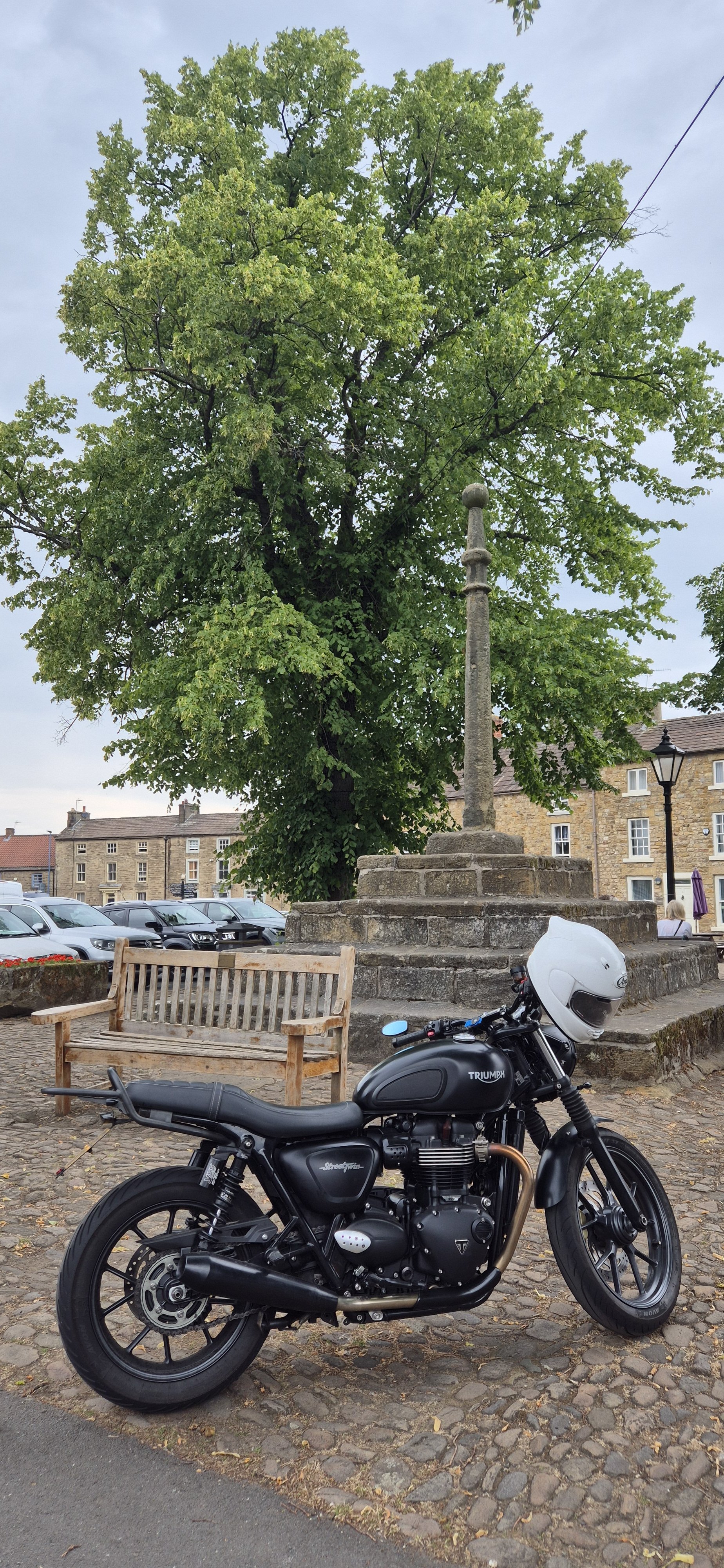

    And eventually we set off for a nice run up to Masham for dinner.
    A nice panini and tea with the wife having a bacon sandwich, good food at Johnny Bagdads ;)
    A steady wander through the lanes back to home, 104 miles covered with no issues, and the dash claims 70.4 mpg :eek:
  13. Pegscraper
    Pegscraper Elite Member
    Jun 12, 2020
    3,783
    Top design there Triumph! :joy:
    How does water and road crud even get into the battery box in the first place?
  14. Eldon
    Eldon Crème de la Crème
    8,923
    The rear mudguard area isn't fully sealed and road grit/dirt, will find a way with the spray off the rear tyre.
    Nature will find a way to get in to human created things, it's then up to the designers experience to give it a way out, something I learnt many years ago.
    The best thing I did in my Landrover days, was going around the chassis with a 20mm holesaw providing proper drainage holes. After any muddy days, or periodically, I'd literally jetwash the 5hit out of it and so avoid festering corrosion. ;)
