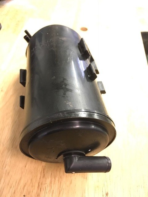

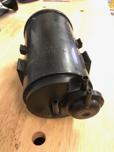

    Hi.
    New here to the forum.
    This may be a dumb question.
    Can someone please tell me what this item is on my 2016 Thruxton air cooled 900?
    I assume a part of the emissions equipment. It is located in front of the rear tire at the bottom of the frame. It had three hoses going into it.
    Interestingly, it says Honda on it. I was mounting a centerstand and I had to remove the cable ties holding it in place to move it a bit to clear the U-bracket that goes from the frame to the spring to the centerstand.
    I just thought I would see if the bike started without it and it seemed to run fine. I did not plug the hoses. Can I run the bike without it? Is it going to create a problem? Should I plug the hoses?
    Thank you in advance.
    Marty

  3. crispey
    7,212
    It's an evap system, U.K. Bikes don't have them but all USA bikes have them as it's California spec. Have a look here for a thread about it

  5. crispey
    7,212
    Here's another thread.
    I'm sure there's quite a few more, removing them doesn't seem to be a problem. Depends on how tidy you want it looking down there

  7. Retired Phil
    Jun 22, 2017
    211
    San Rafael
    In the US that is a charcoal canister that is part of the emissions system. Fuel vapors are captured and cleansed and reburned into the motor. You can plug it off and it won’t hurt anything. And before anyone says that’s irresponsible a bikes emissions in nothing compared to trucks and industry.
