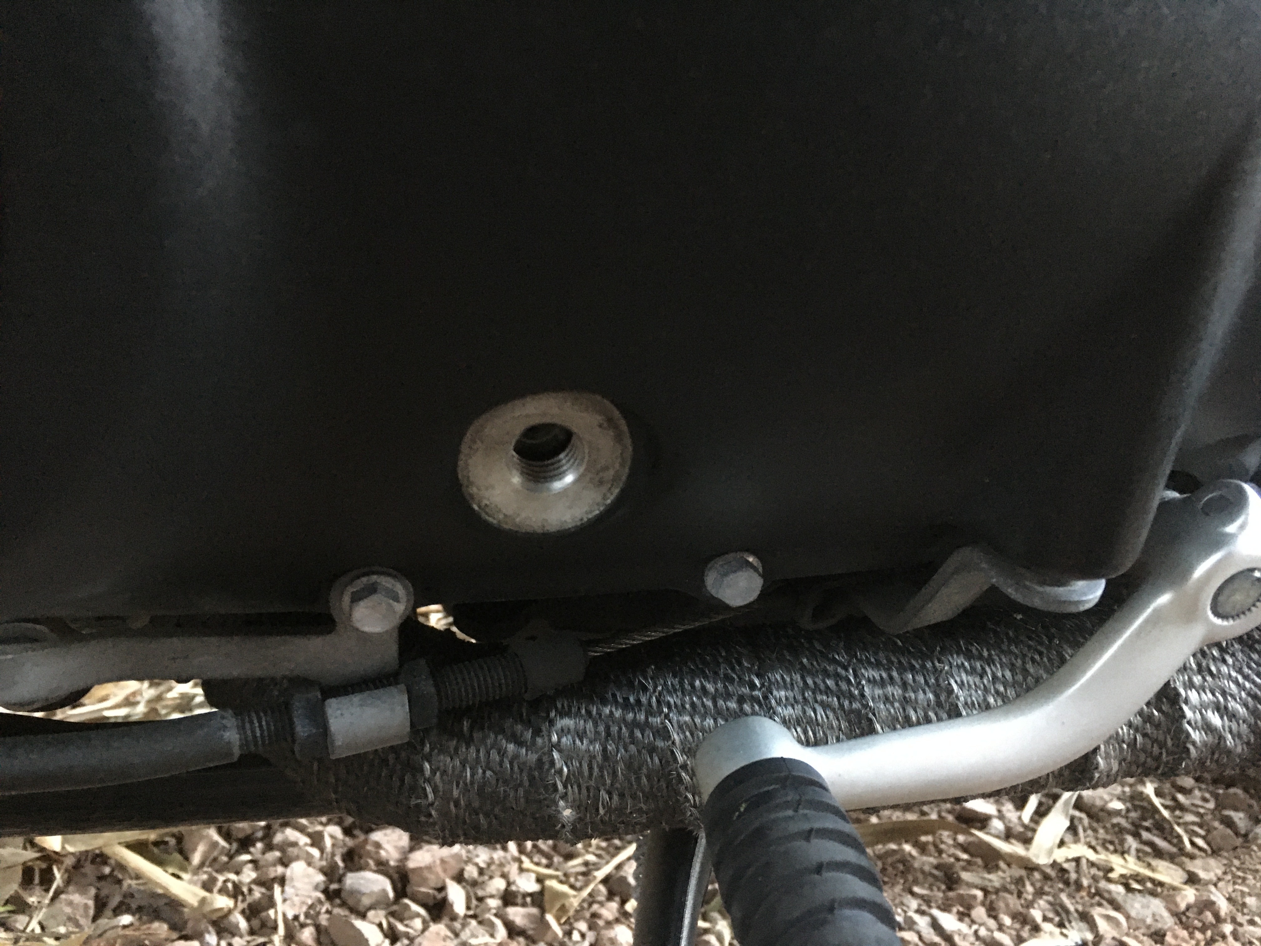

    I'm sure this has been answered many times already however I don't know how to search for it, I tried searching for that bolt near the gear shift lever. So there's a bolt that is missing on my bike, however when I look in the hole with a torch it doesn't go anywhere it's just a bolt hole. It's not mentioned in the owners manual, that I can find anyway.

    What kind of motorcycle?

    It's a Street Twin. Yes Part 10 is a bolt, I can see that's missing but it's just a bolt plugging a blind hole!! Why. What is the purpose, maybe there's some sort of factory sensor that can be screwed in?

    I think it is to keep that threaded hole blocked off.

    No part 10 is a PLUG to plug the hole, Ours is not to reason why, the manufacture has decreed that a plug should go there, it may be of use on another model but has no detrimental effect on your bike so simply plug it and ride, speak to your local Triumph dealer things like that on other machines where like level plugs for oil or as you say some sort of sensor but the parts list kindly shown by @Callumity simply show's a PLUG

    Actually came across someone wanting to know what that bolt was for on the Thruxton facebook page as it was missing from their brand new Thruxton. A few folks commented that it was a common problem for it to go missing and that it's 'blind'. It also mentions that in some casings it's a plastic 'dummy' bolt and in one comment a fellow says it was intended for access to adjust the rear balancer shaft. Take your pick from that but the consensus anyway is that it's purely cosmetic.

    Just had to get a roadworthy and the mechanic thought he spied another hex bolt in there and proffered that it may be part of the clutch adjustment?

    You can find lots of these threaded holes in machinery. They are mounting holes for frames / machinery used during manufacture. They are usually placed so that they can be utilised to hold components further down the assembly line. Some cannot be used for that and end up with a bolt or grub screw to hide them.

    @covid-21 I have found the answer! (and I don't even own a 1200 powered trumpet) It is indeed a cover for access to an allen bolt which allows you to adjust the rear balancer dead shaft. You can see it here http://thruxton.sobell.net/ then go to the index and select balancer- balancer shafts dynamic adjustment

    A lot of them are for machines to be able to manipulate / hold castings during manufacture. If they are designed properly they are utilised for other purposes further along during the build, looks like this is being used to access an adjustment screw, can you see the adjuster inside it?

    If you follow the link I posted above and then go to balancer/balancer shafts dynamic adjustment and scroll down you will see the layout. The Rear Balancer shaft protrudes (with sealing rings) into a pocket in the left engine cover which is covered with the 'bolt' in question which is described as the 'clutch cover plug'. You undo a locking screw on the other end of the shaft which is found hidden down inside the right hand side of the engine below the oil filler cap and then adjust the adjuster screw hidden under the 'Clutch cover plug' to adjust the rear balancer shaft.
