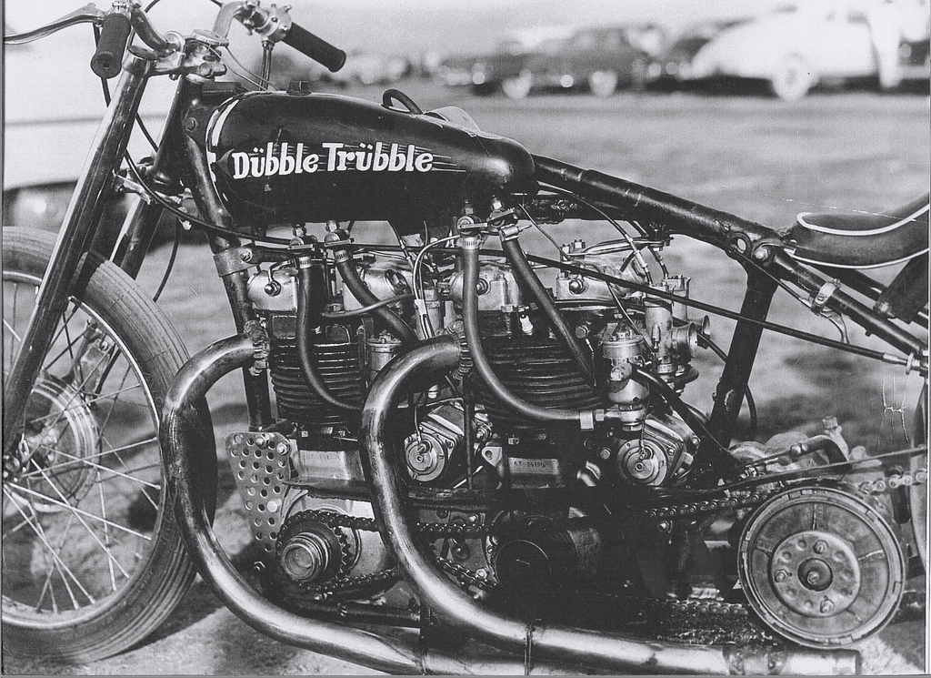

    Ah, those were the days when nitro and twin engines were the top fuel beasts. The twin engined Westlake 'Hobbit' saw off the twin engined Harley 'Goliath' from over the pond. But I'm sure I remember John Hobbs' Westlake breaking down just prior to the final. Twin engined Nortons 'Pegasus' and 'Hogslayer' were around in those days too.
    But I think this was the first
    Twin Thunderbird 1950s - Von Dutch did the lettering on the tank hence the umlaut - good for 140s on the strip, over 150 on the salt flats. Sorry a bit off thread :).....Over

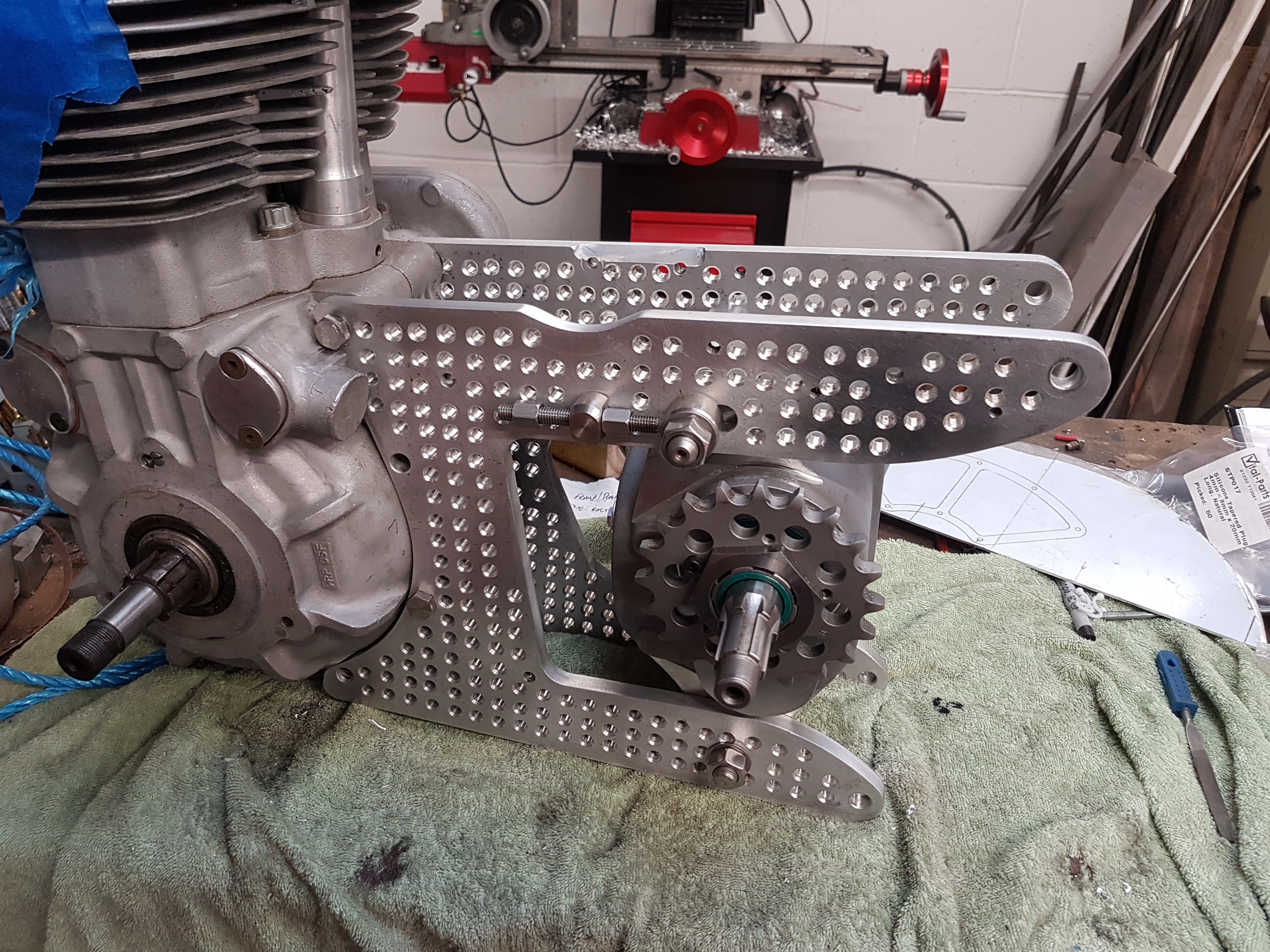

    This weeks progress consisted of stripping the bike for various coatings, paint, polishing etc plus finessing all the various brackets, plates, bushings etc. I dont particularly like the polishing part but needs must! Once they are polished they shall be coated in ceramic clear. Engine cradle plates were drilled to add a little more lightness,

    They look pretty substantial, Dural I take it? How thick are they?

    My preferance was to use 6082 in the T6 condition. This grade gives excellent strength combined with good corroson resistance and machinability. "Dural" comes form the 2000 series (copper) which has similar strength properties but poor corrosion resistance x10mm thick. Rigidity is always a plus imho.

    Crikey, 10 mm was that because you wanted to make a feature of the drilling?
    I have yet to start the refurbishment on my old pre unit Tbird but when I do ally engine plates would be nice but maintaining the finish is going to be a pain so will probably go A2 or A4 SS if available.
    I did smile at “adding lightness”, wasn’t that a Colin Chapman turn of phrase?

    One of the main goals with my builds is to achieve as much rigidity as possible with the least amount of weight...PWR is all important. I could have lightened them quite a lot more by scalloping while still maintaing the strength against the forces applied....might still do that by the time final build is in progress!
    Materials incl polished ally can now be adequately protected using clear Cerakote...good wearing surface and much easier to clean. I am having my new brakes etc cerakoted as the means of protecting magenesium available is very poor nowadays as "proper" chromating is no longer allowed. TS Engineering are very good at mix/matching cerakote to your spec...talk to Simon, he's a very helpful gent.
    I have followed Colin's ethos since I first started building race cars including his "no washers" rule although I do use them on alloys. The aviation industry has some fantastic fasteners without weight nowadays...K nuts for example. I use various types of these and AN bolts quite a lot.
