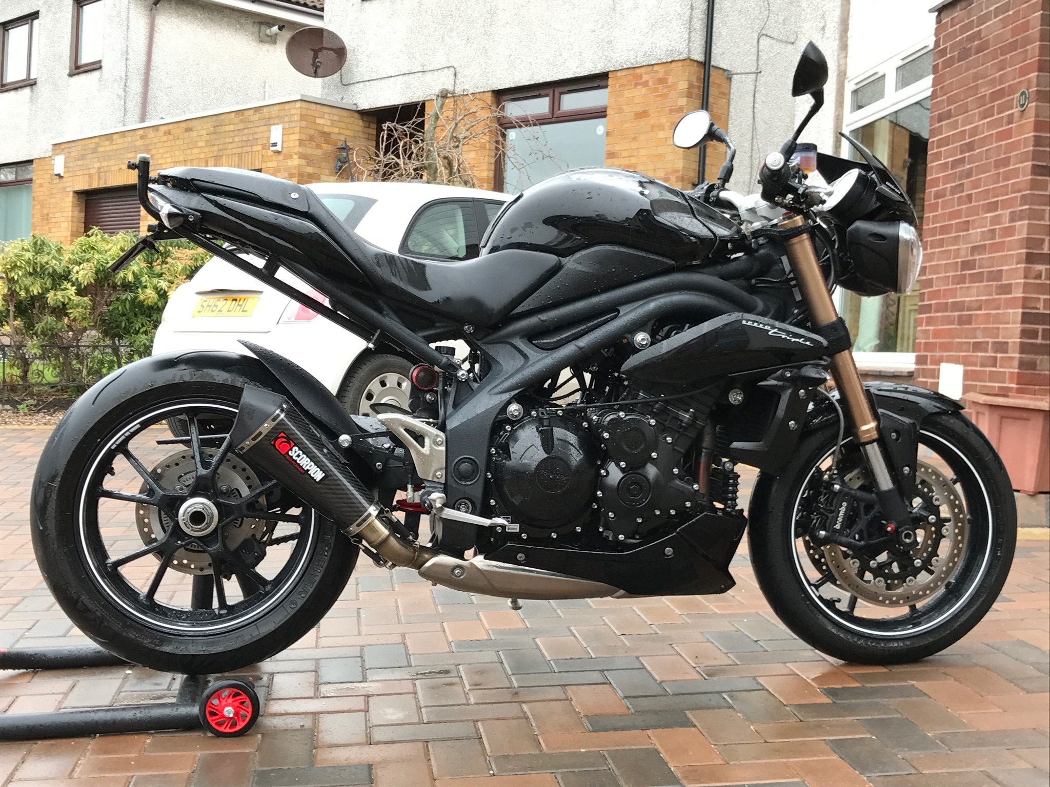

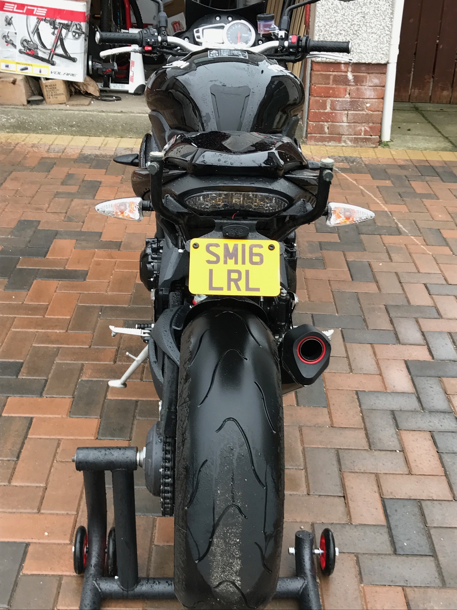

    Hi here’s a couple of pictures of my 94 with an r&g tail tidy and the brackets for my Ventura rack. I canny see past the Ventura system.
    Ali

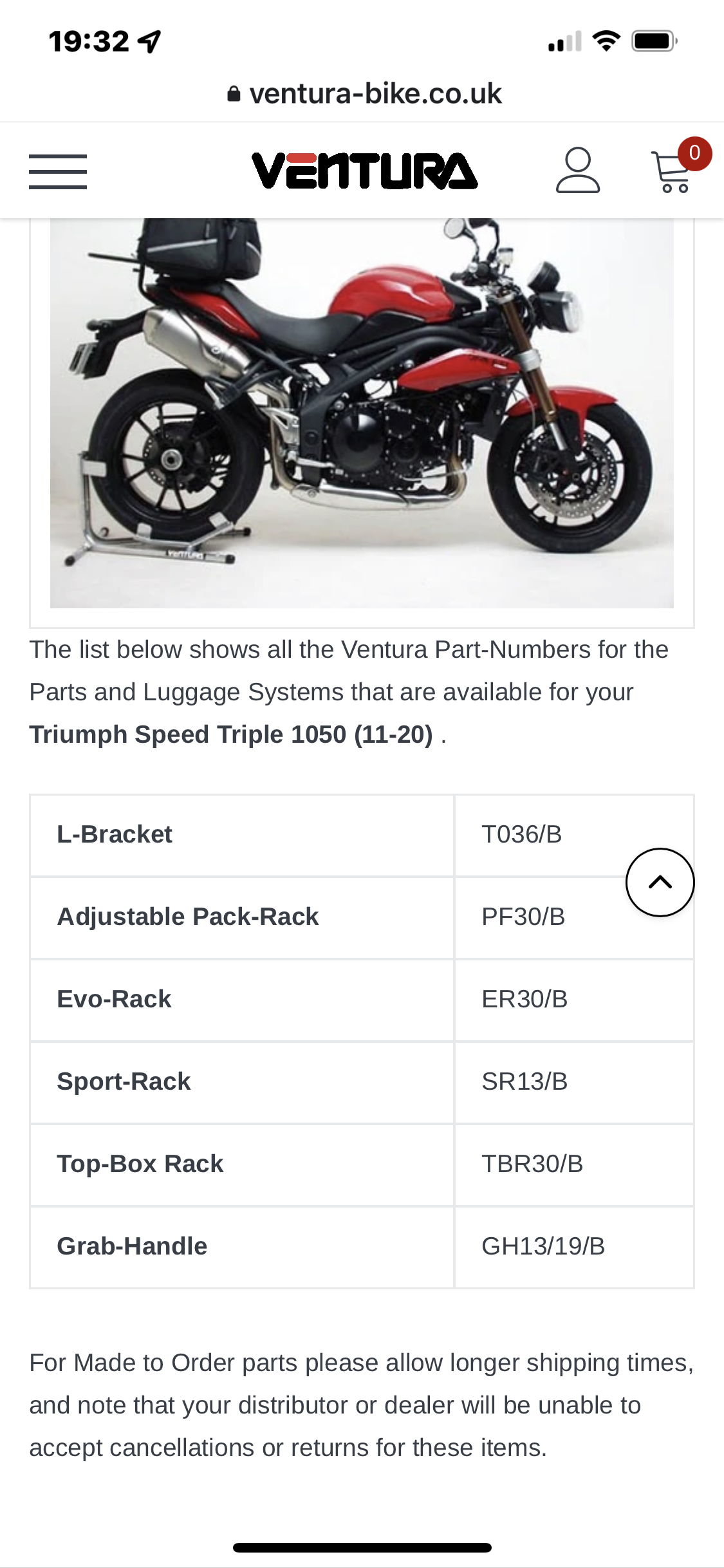

    Hi, apologies for the spam (did look but didn't find definitive answer); has anyone fitted Ventura to their 1050RS (2018 -) with stock Arrows still fitted?
    I have the old PF30 rack and it looks like its too wide, so as minimum I guess the new style one with the "adjustable" base pivots is needed.
    If not, anyone used the Hepco and Becker sport rack which fits instead of the pillion seat?
    Thanks!

    Many thanks, saw this too, still not found a single image of one on a later 1050RS with Arrows...
    Also does it require the rack with the pivoting base feet?
    SW-Motech is an option - I could probably also adapt a hoop so the Ventura bags work - not a fan of fugly brackets where I can avoid them mind.
    Thanks.
