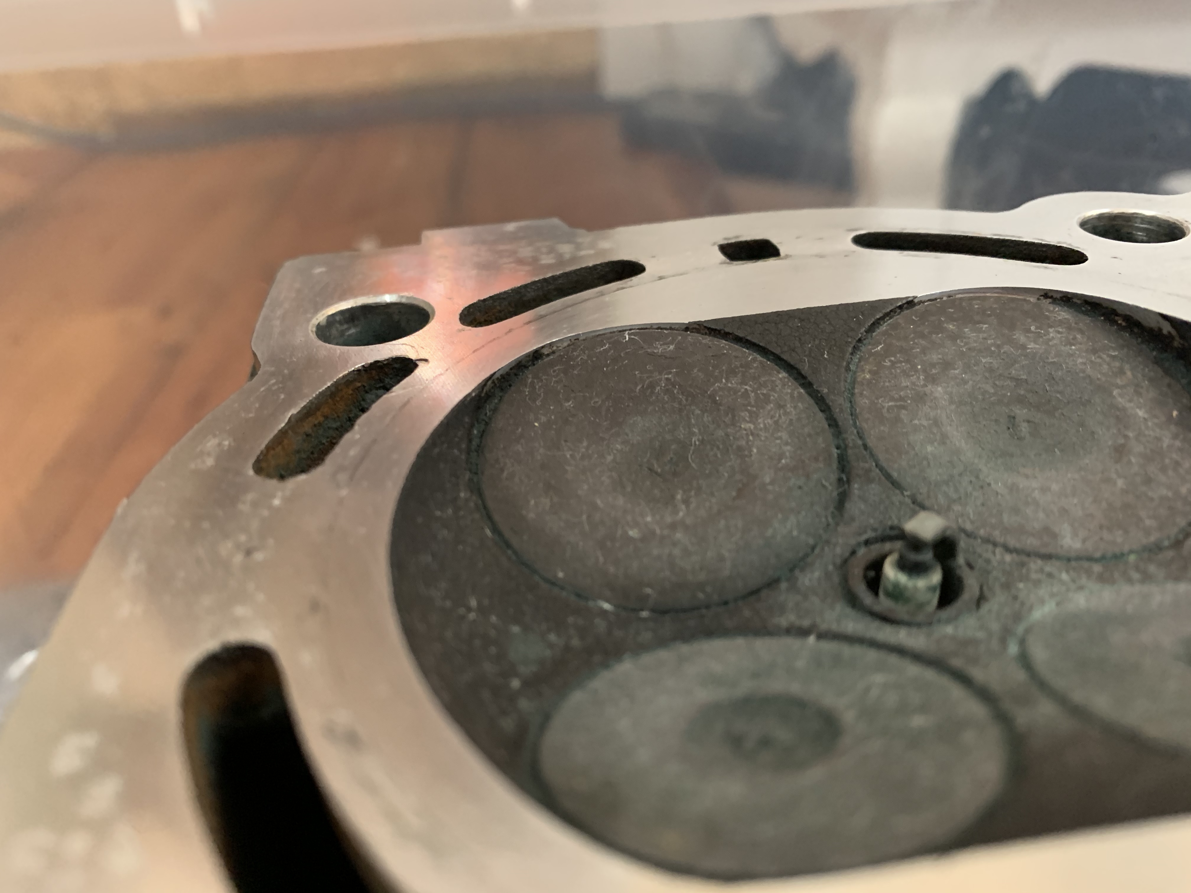

    It's difficult from just looking at the photos, that said it appears you have not cleaned the head up as yet, is that's the case it appears the head has been skimmed before, in your position I would remove the valves and clean up the head, look for any cracks, at times it's not easy with the eye, use a large magnifying glass if you have one, it's not as silly as it sounds, if you lived nearer I could get a friend to "crack test" it for you FOC, check it though before you carry out any work i.e. cutting the valve seats and lapping them in, it has been leaking water into the engine though that's apparent from the photos. If the head has any damage at all it will become economically unviable to carry on, therefore look for a good second hand one, they come on the market frequently and fairly cheap, and if that proves to be the case strip it, use the stem seals in the head kit and build it up. Skimming the head to maximum only raises the compression slightly, it makes little difference to the timing, things like failing to demagnetisie say the crank after a re grind does alter the timing though. It sounds like you are going about things in a really good methodical way and all credit to you for perseverance, like you say you'll learn an awful lot along the way as well. Keep posting updates, it's great to hear.

    I am not familiar with this engine but by looking at the valves it must have dished piston crowns and yes I would also agree that the head has been skimmed, you can clean the combustion chamber up of just leave it as is but obviously give it a good wash/degrease, then just lap the valves in with some fine grinding paste but if they are badly pitted you will either need them recut of some corse paste and patience.
    If you haven't touched the barrels yet hen as iceman said leave it be you can gauge the liner wear by looking to see or run your finger nail up the top of the bore and see if there is any sign of a lip it should be very minimal with modern materials, and you will see the carbon but scape some away and look again but i don't see there would be any appreciable wear with that sort of mileage unless oil changes have been badly neglected.

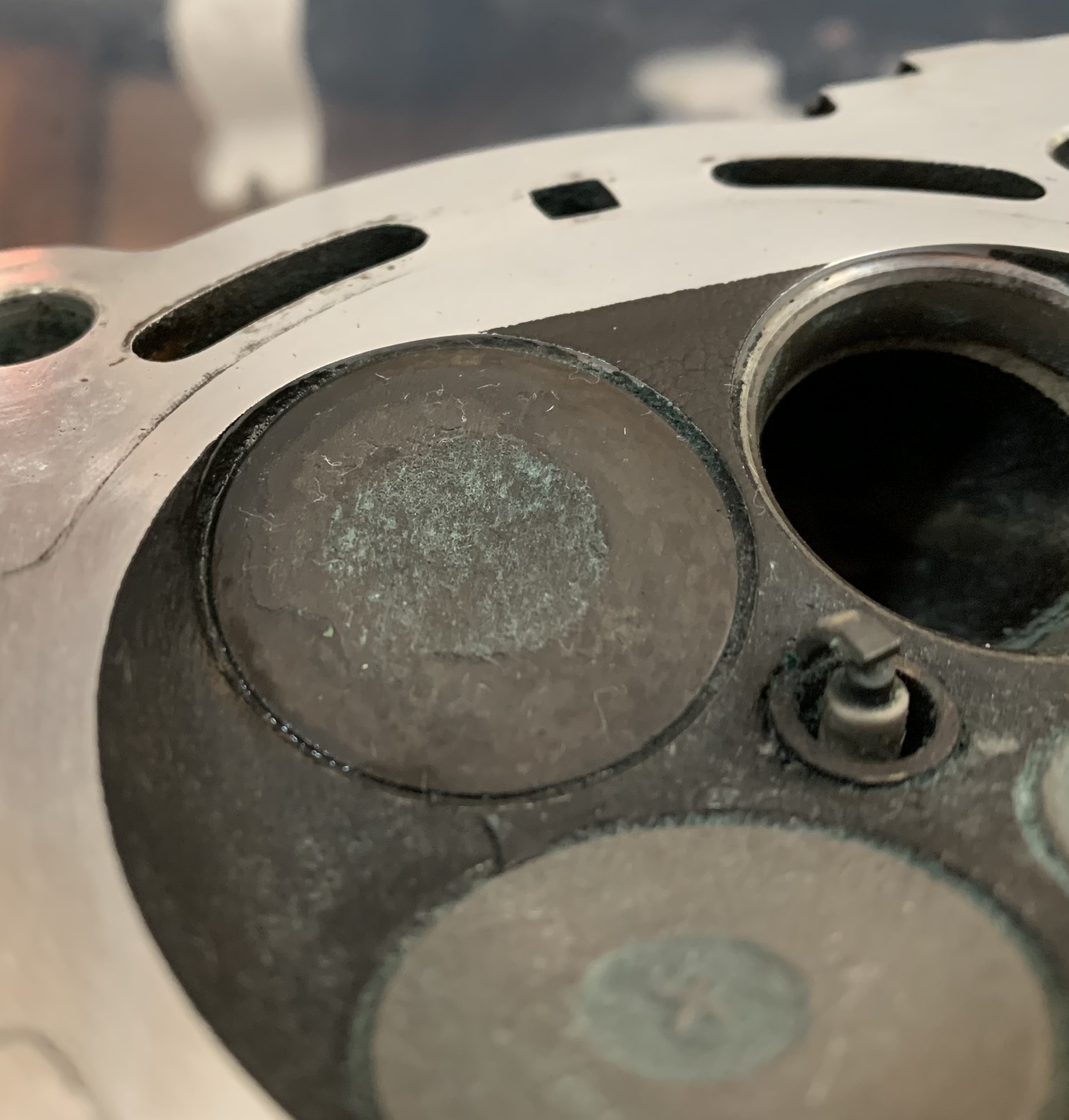

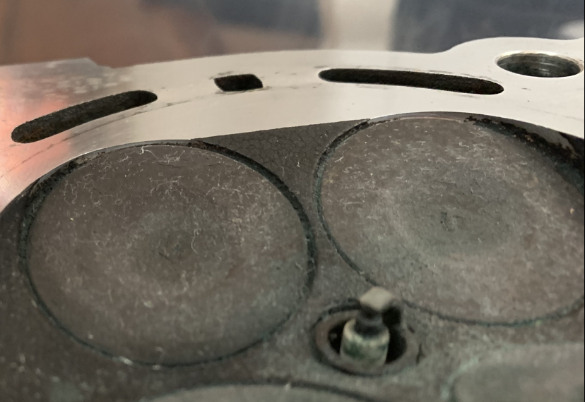

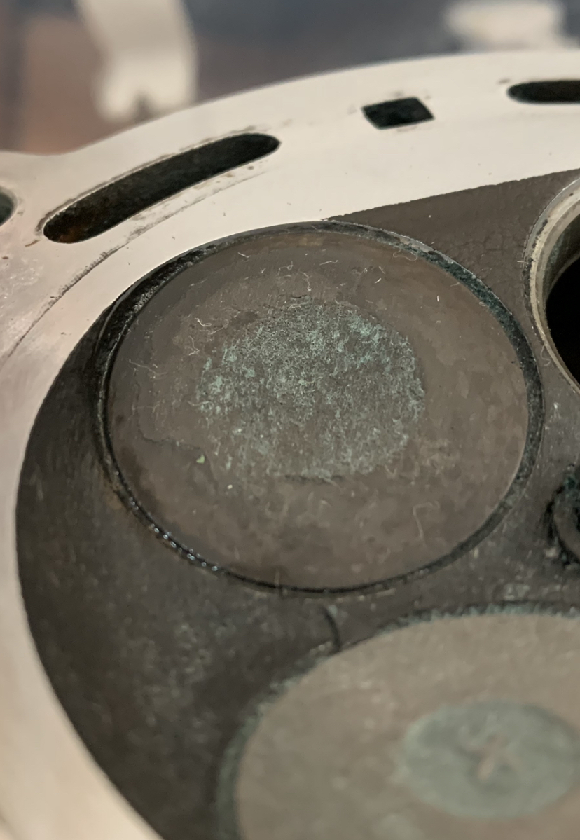

  9. Yorkshireman
    3,404
    Good advice I’d say there from @Iceman and @Tricky-Dicky. Is that a crack between the inlet and exhaust valves in pics 2&3? I can see you’ve taken one of the valves out already but I’d be tempted to put a few ccs of petrol over those valves and check for leaks before going much further.

    @Tricky-Dicky that looks like a fantastic product. I read the download and it looks easy enough to use but, after @Yorkshireman ‘s beady eye, and my morning scare, which had me hot out of bed to check it (fortunately not a crack, though - see same shot below), I’ve booked the head in for a pressure test and clean (apparently steam cleaned as part of the pressure test) at Avonmouth, Bristol (£48). The piston crowns are dished as you say...I’ll definitely be lapping the valves in...thanks for all your info and advice.
