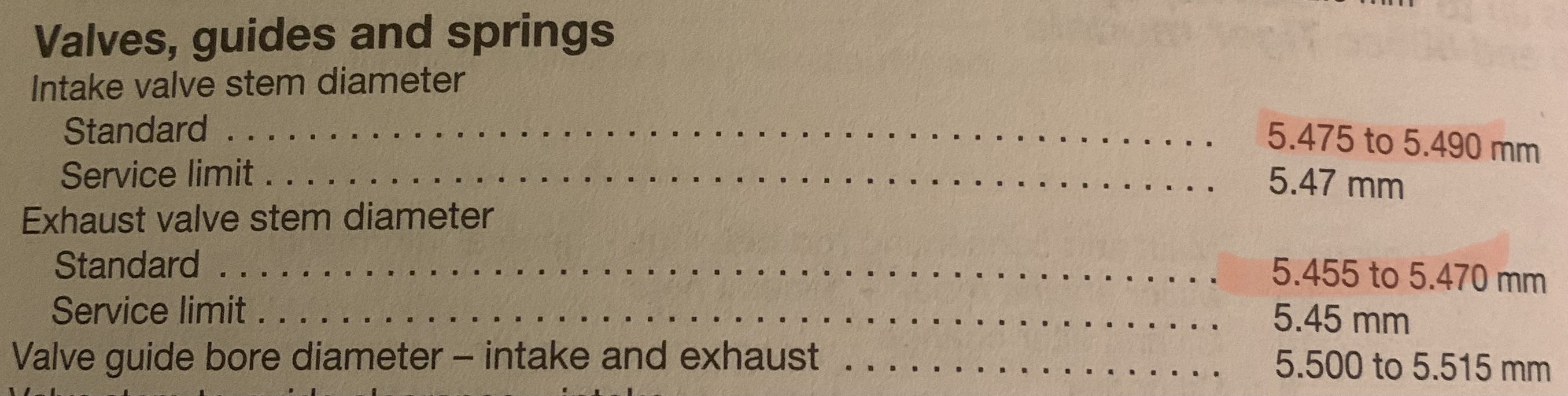

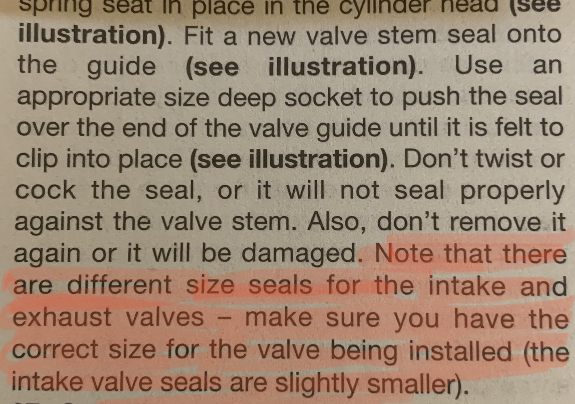

    Just realised I’m going to need 12 valve stem oil seals!
    Triumph original around £12 each (ouch)...other options on eBay £3 each, as pictured below!
    Any experiences with non-original seals welcome, but...and here’s the question:
    In the Haynes Manual is says ‘note, the seals are different sizes for the inlet and exhaust valves!’ However, WOT and Fowler’s and the eBay listing only appear to offer 1 size?
    What’s the consensus out there?

    The eBay seller has said the seals are to fit valves of 5.5mm
    Not sure where that leaves me with the Haynes Manual reporting as below, and the parts diagram from WoT and Fowlers only showing 1 type of seal?

    With the tiny difference between the stem dia i would suspect they have taken the one size fits all approach with the stem seals as they are stretchy anyway so doubt it would make any difference.

    That would definitely make sense, just odd that the Haynes manual draws attention to there being 2 sizes, albeit that they describe them wrongly when saying the inlets are slightly smaller? Very strange!

    Norfolk UK
    Well its literally 9 thou difference so making a seal with that tolerance is not going to be easy so if it was me i really wouldn't worry about it ...don't know why Haynes are bothering as I doubt there will be any actual difference in the size of the genuine seals even if they say there is....just maybe the price.;)
