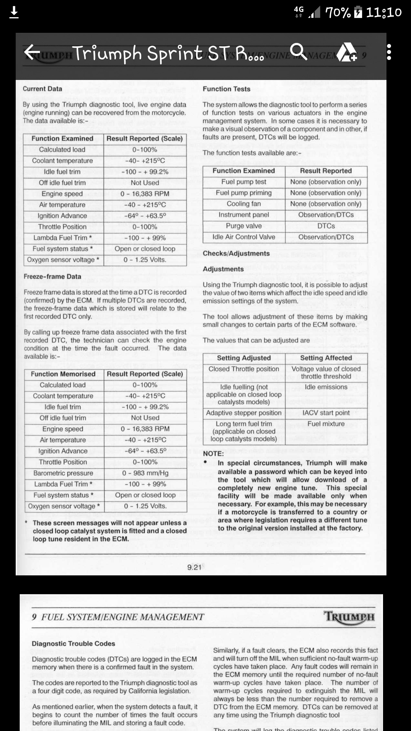

    Looking at the workshop manual for yours the triumph tool resets the IACV/Idle control valve and re-teaches the ECU where closed throttle is....Whereas on mine you have to get the TPS set at a certain value....
    Read the table bottom right....
