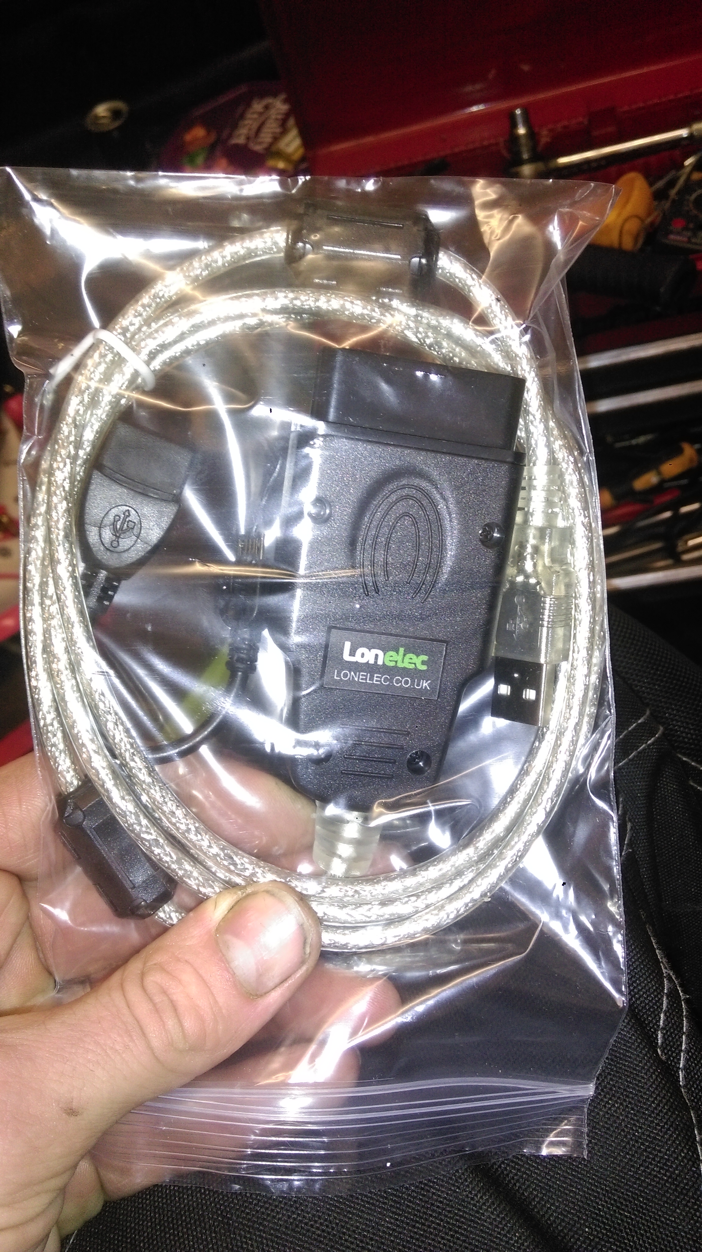

    Best thing is I bought the lonlec cable
